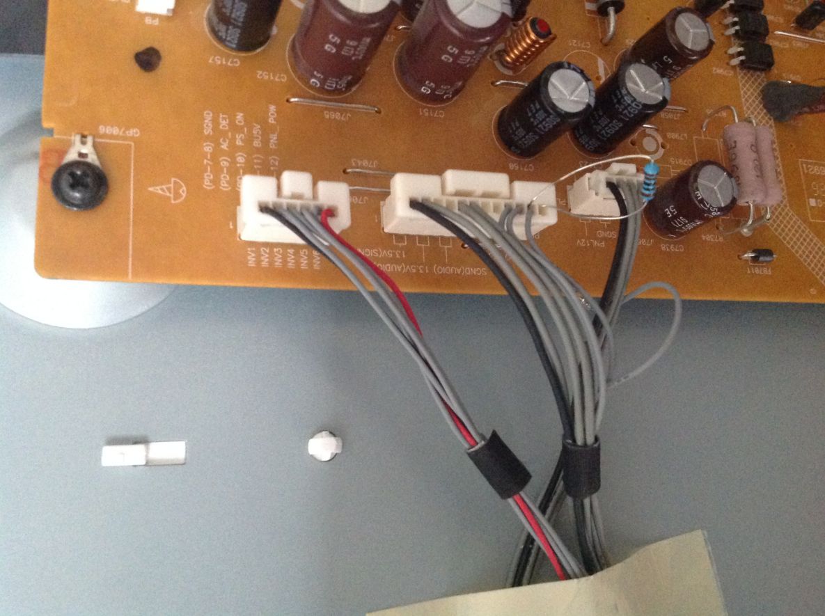

                  You have to disconnect just that PNL_PWR wire from the connector. The resistor will be be 470~1K resistor between BU5V and the PNL_PWR pin, that way if every thing else are OK then you should get the TV to function in test mode then you can find out later why the PNL_PWR is stuck low.

                        No, unfortunately. i disconnected the PNL_POW and put the pull up resistor, fire up the tv and still hear the relay clicking no picture no back light.i forced the tv to power up ( vol+, channel- while plugging the power cord) i had the same result black picture and no backlight, but i had the 12V to the TCON board, so the power supply seems to work ok.
                        the only thing that bugs me if i have problem with the main board why i dont have a back-light? this is by far the most complicated repair that i came across.
                        i saw a thread on this forum, a guy had a similar problem like mine and turned out the the microprocessor heat sink was grounding out some other components, but checked mine and it seems far from the components underneath.

                            here's a picture of the left hand side of the PSB:
                            the first connector marked INV1 to INV6 ( Pin1 to Pin5 the pins are 0V whatever the tv is on or off).Pin6 is 0v when tv is off and goes to 3V when tv is on.
                            the second connector voltages are listed in my older post.
                            the third connector is PLN 12V with the pull up resistor is giving power to the tcon board.
                            i have attached a close up picture of the connectors

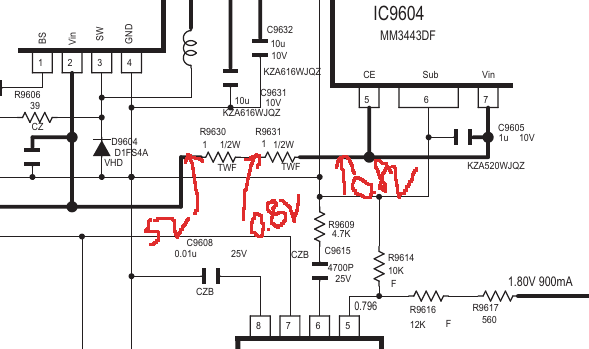

                                          i did a little bit of troubleshooting this evening and found something interesting.
                                          see attached image.
                                          there's some thing wrong with the resistor R9630,it's 1ohm resistor and it's taking 4.2v of voltage drop.i measured it's resistance and i found 140kohm.the other resistor is measuring 1ohm as expected.clearly,there's a problem with it.now need to find a resistor and replace it.
                                          to be continued...
