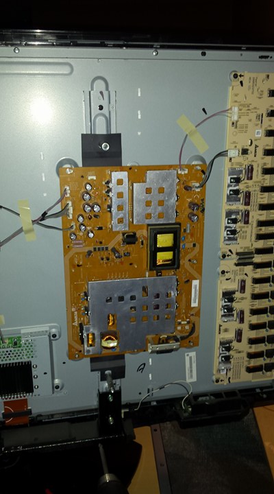

    Hi

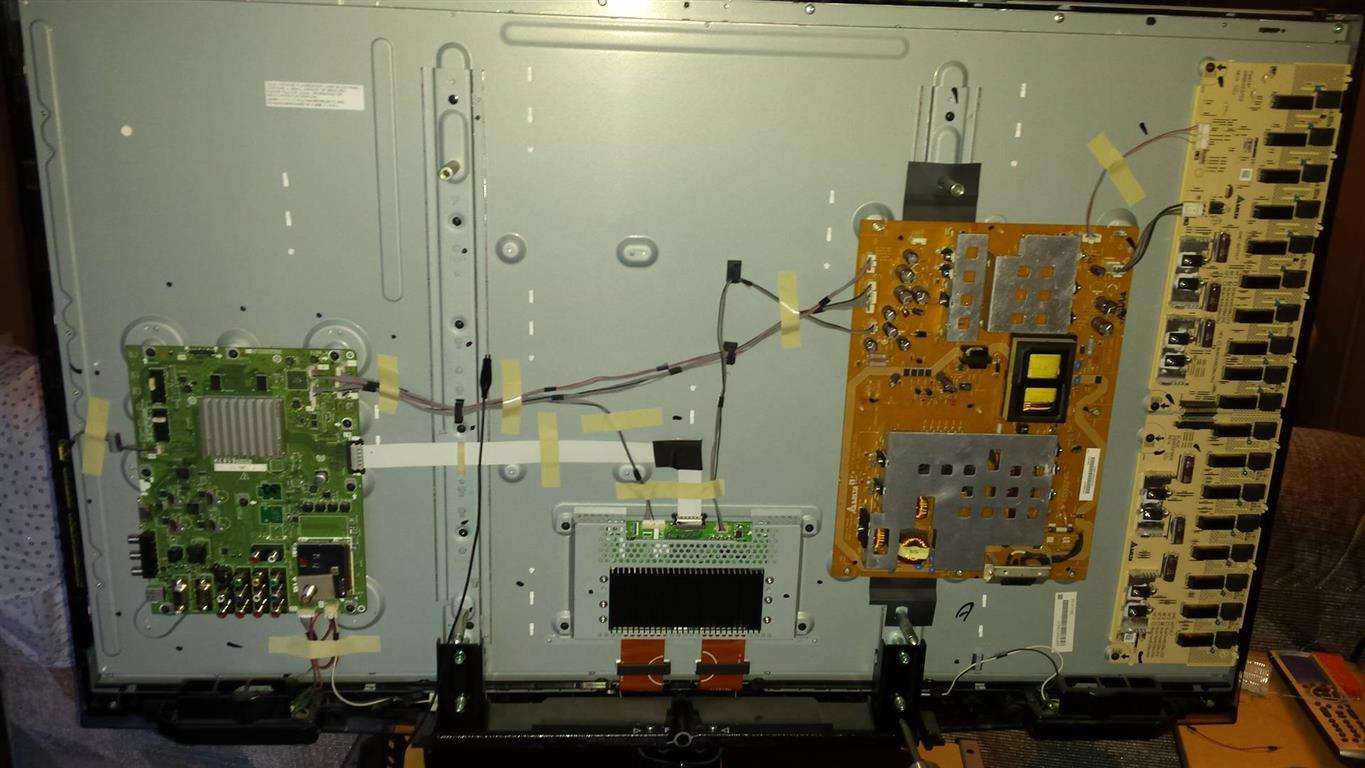

    i have a non working SHARP LC46E77UN.when plugged to the power the power light turns on then i hear relay clicking sound, the tv stays black non back-light and after a minute or so, the OPC and Power light blink together 1 time, then The power light blinks 2 more time and the cycle repeats.
    i downloaded the service manual (page 61) and its says if the power light blinks 3 times,then there's a bad communication with the main CPU.
    i took the TV apart and i forced the TV to start ( vol+ and channel down and plugging the power cable in same time) and measured the voltages on the power board (model : RDENCA336WJQZ),all the voltages were ok expect the PLN 12V(the connector in left had side ( goes to the tcon board).
    I also took the power supply board out and verified all the MOSFET, diodes and resistors and i didn't found any suspicious components.i also check the ESR of some caps and they are ok.
    so to summarize, the blinking code says there's a problem with the main board and the logic says there's something wrong with the power supply ( there no voltage at all that goes to the Tcon board)
    i have uploaded the tv service manual.can someone help me to fix the problem.

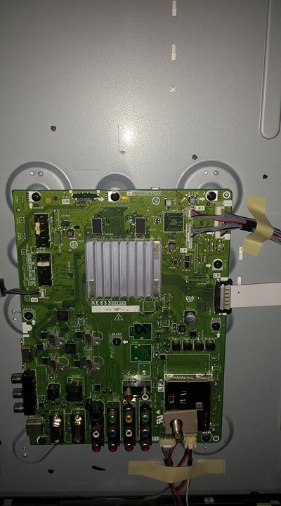

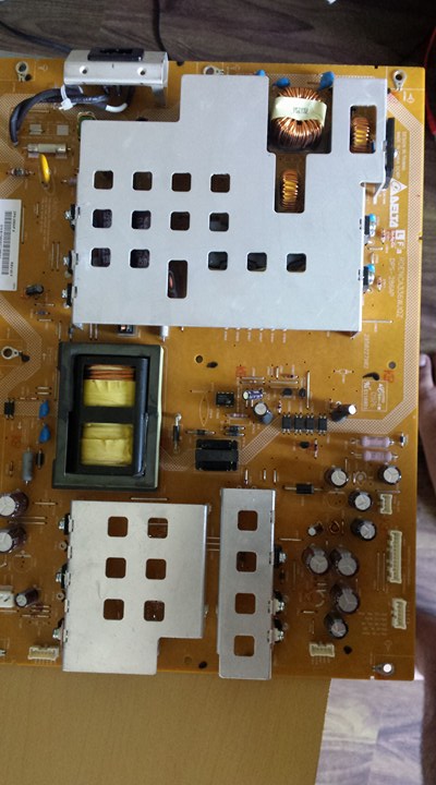

        Need some pictures of all boards and back of tv

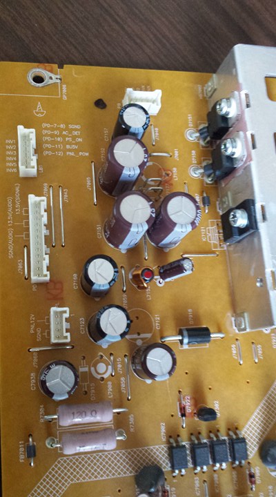

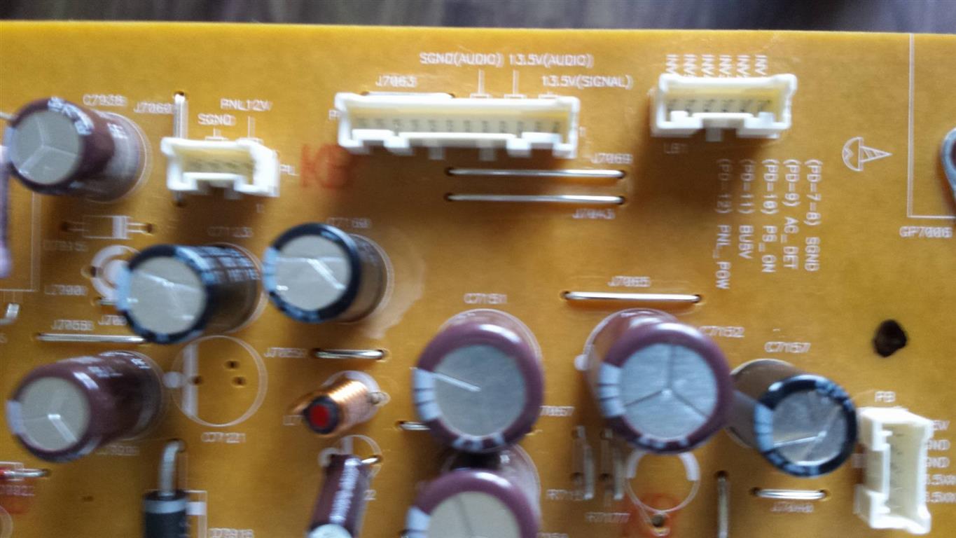

              Re: SHARP LC46E77UN just power light on
              Hi once again
              THere's 2 connectors that goes from the PSB to the mainboard and 1 connector thtat goes from the PSB to the TCON board.
              here's a summary of all the voltages i measured:

              There's another 6 pins connectors that goes from PSB to mainboard market INV1 to INV6.When the tv is off all of them are 0v and when tv is ON all the pins are 0V expect INV6 is 3v.
              The 4 pins connectors that goes from the PSB to the TCON board:

              I don't have the PSB schematics, but a traced down the PNL12 it coming from a 4 pins SHARP voltage regulator part number pq30rv31 i was lucky enough to find a couple of them in my storage box.i replaced it, but no luck i still have the same problem.

                Appears your problem is with main board

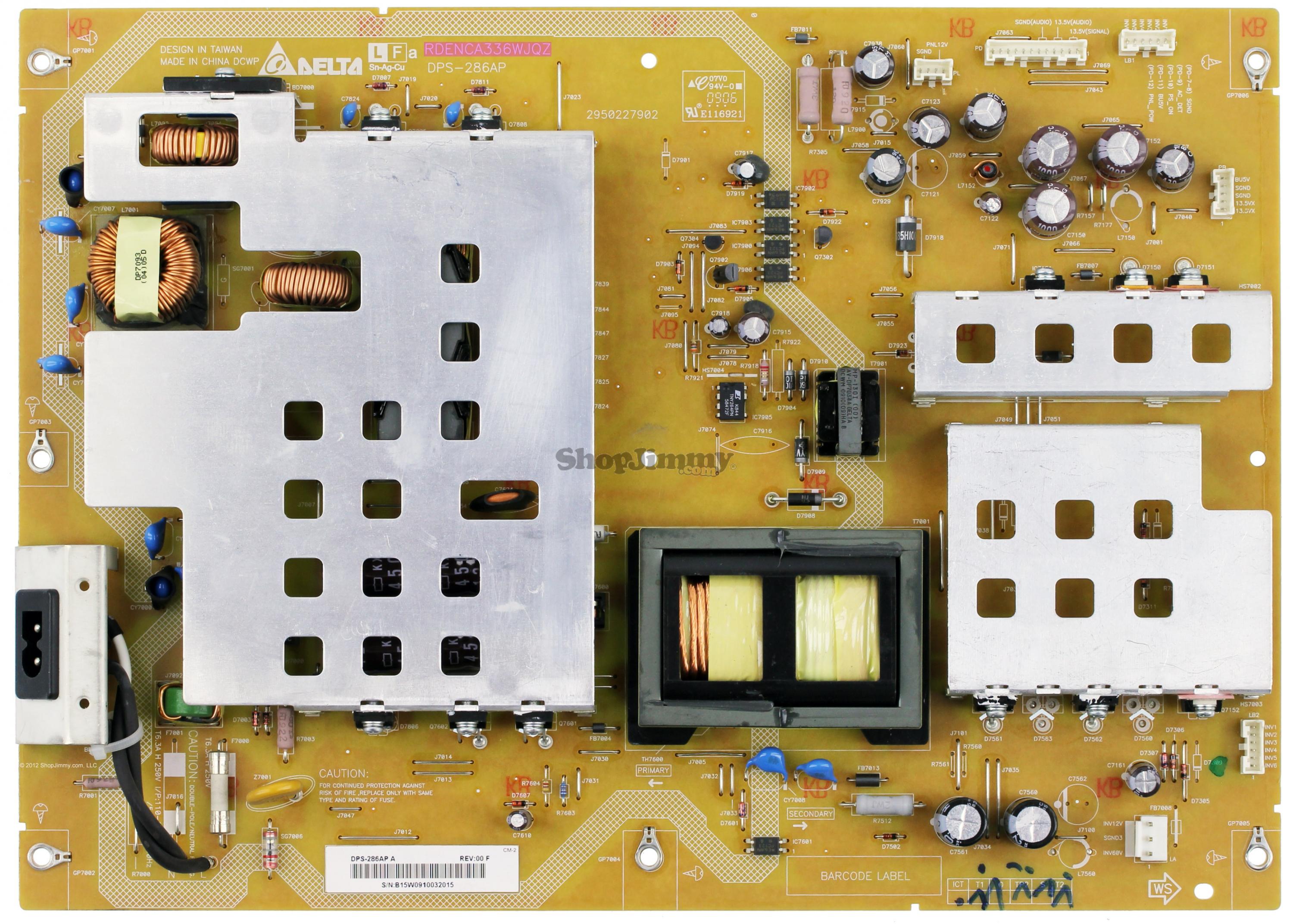

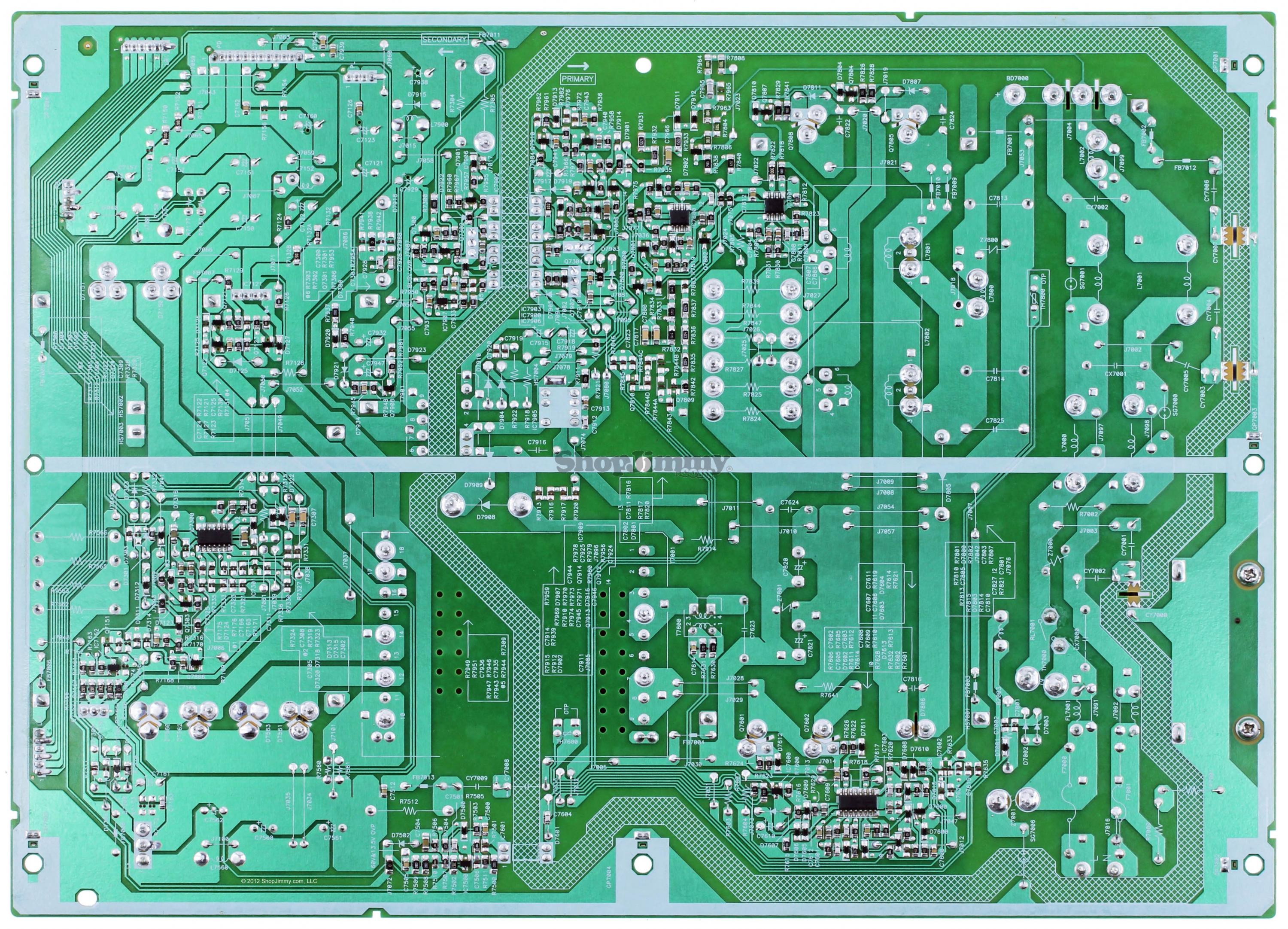

                    Sharp RDENCA336WJQZ (DPS-286AP, DPS-286AP A) Power Supply Unit
                    http://www.shopjimmy.com/sharp-rdenc...pply-unit.htm#
                    Pictures provided by shojimmy.
