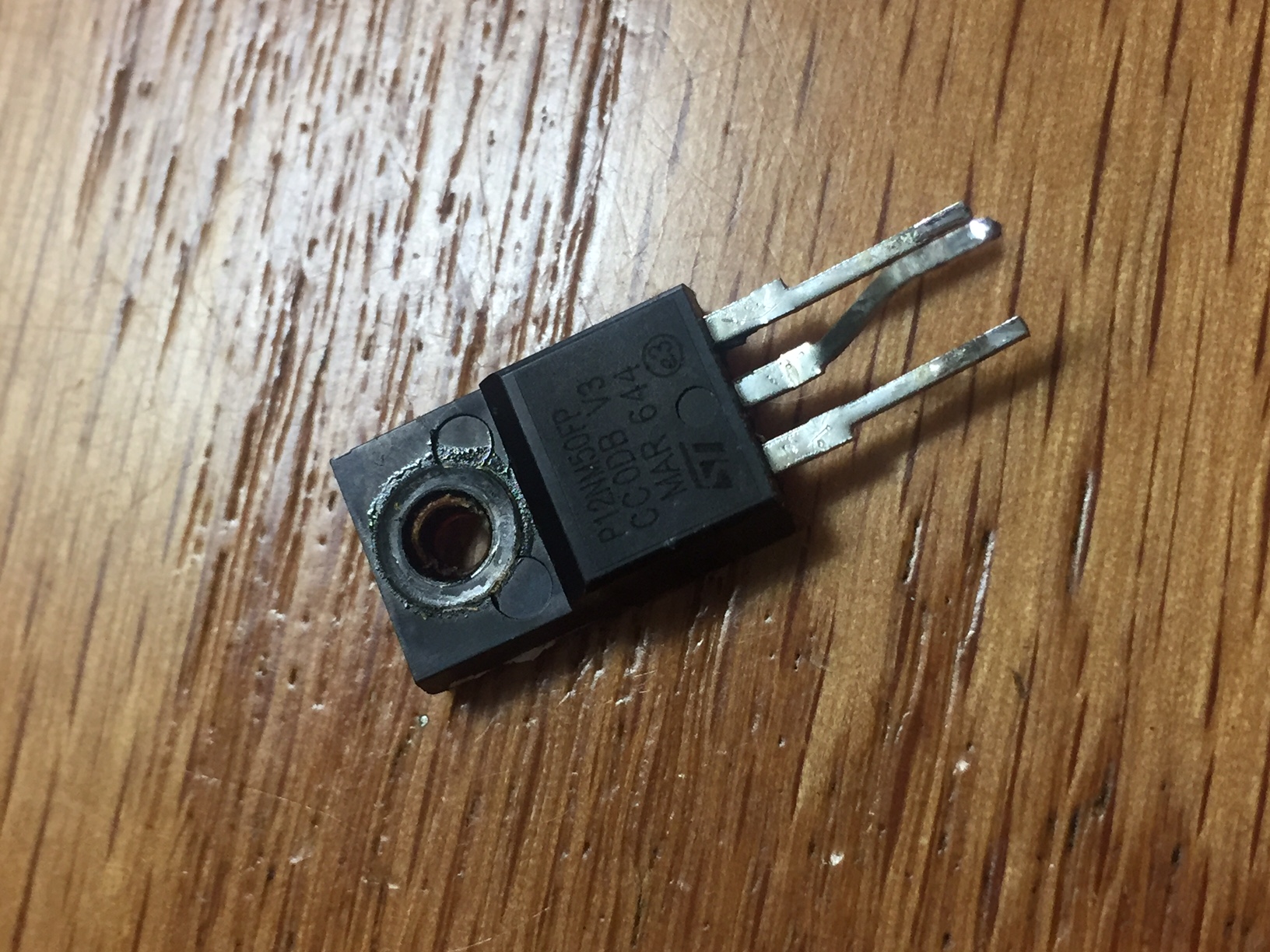

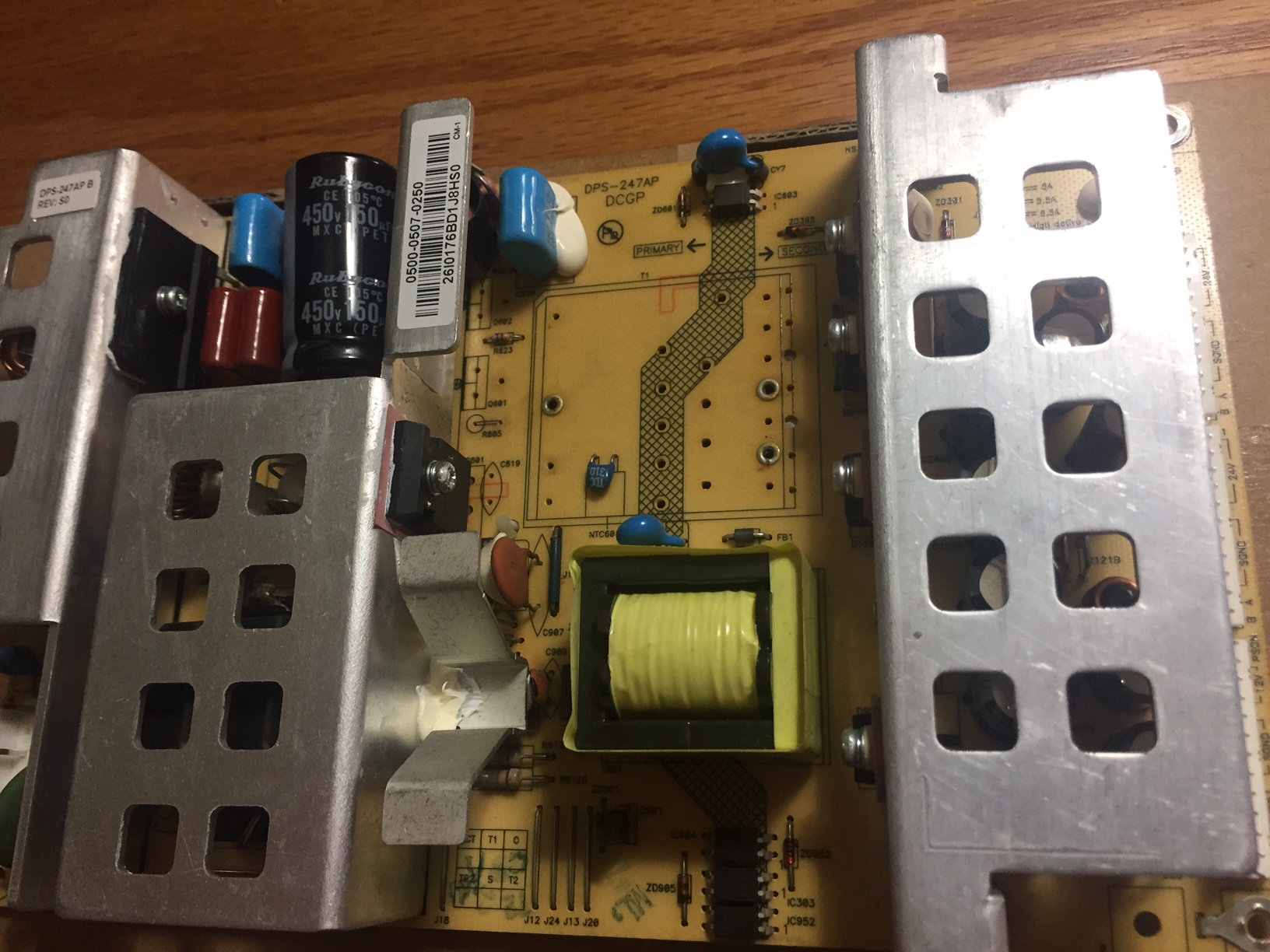

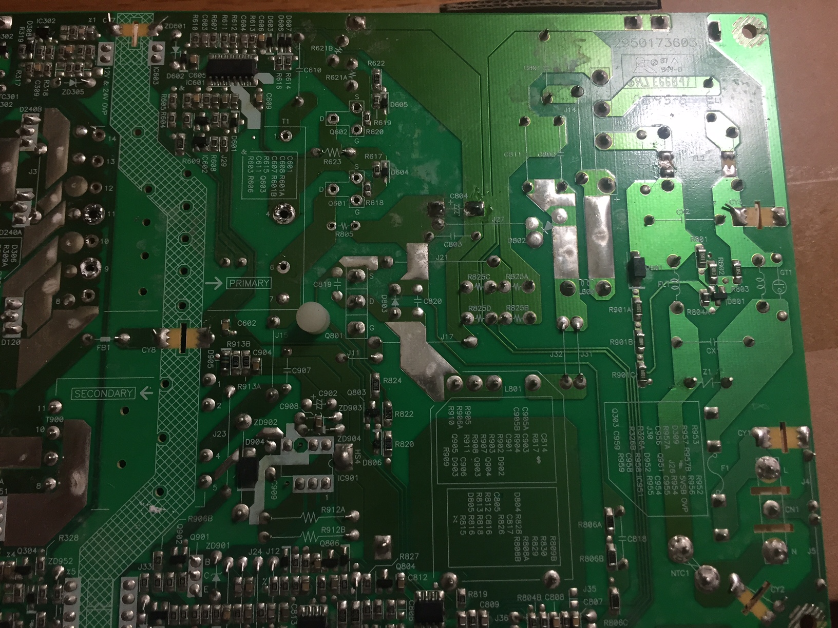

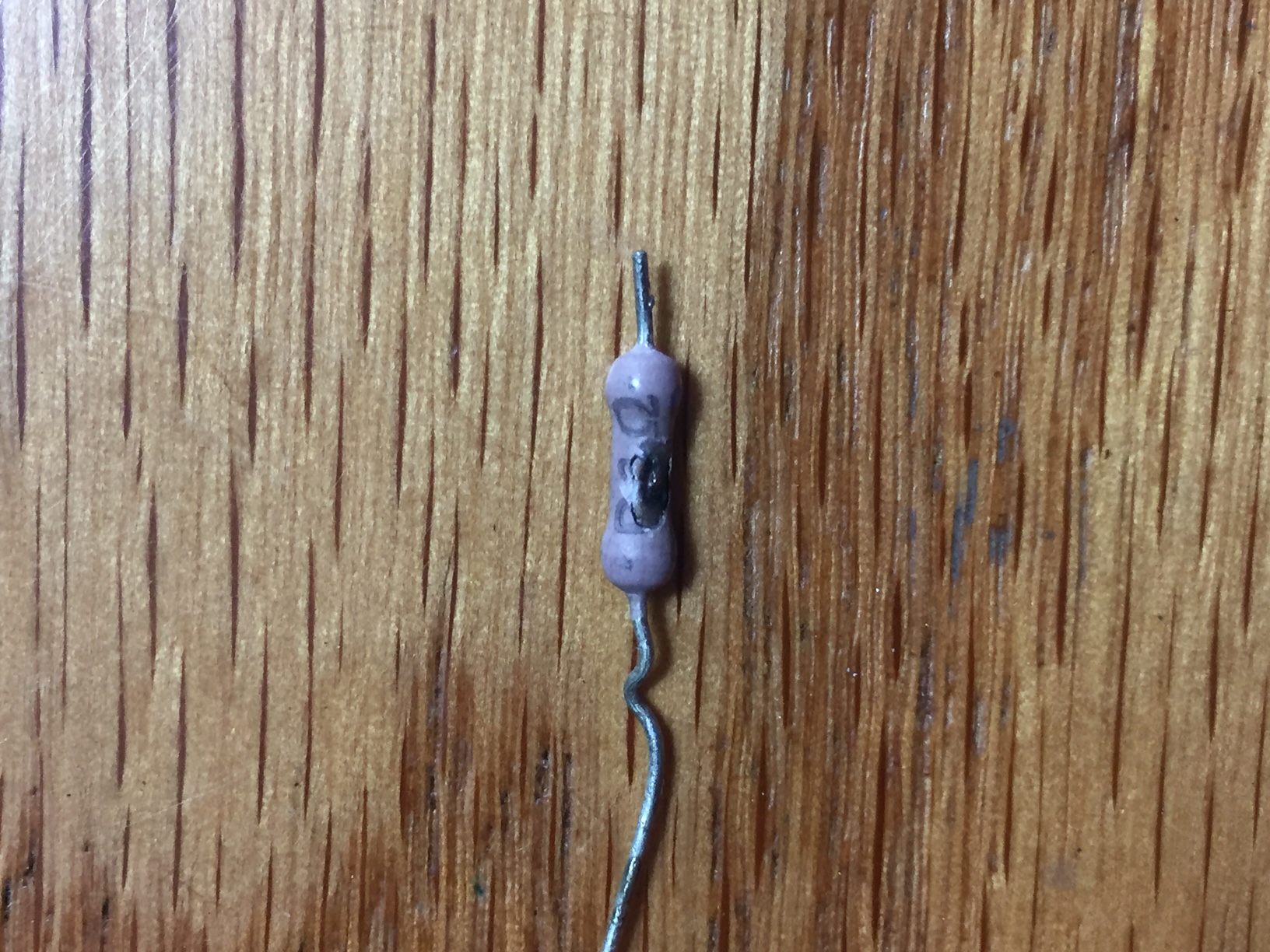

visio vx37l resistor indentity help
+ More Options
Latest Activity
  • tw2005
    replied
    Re: visio vx37l resistor indentity help
    Originally posted by jiroy
    Yes , It is labeled R3Ω ,so it's 0.3 Ω. You're a winner ..
    Do you have a live one in captivity to refer to? LOL.
    Leave a comment:
  • jiroy
    replied
    Re: visio vx37l resistor indentity help
    Originally posted by tw2005
    R805 I would say.
    I'll have a guess. First symbol is looking like a R so 0.? And the number has a curve so I'm thinking a 2 or 3. I'm going with 3 So 0.3 ohm.
    Let me know what the prize is if I'm correct.
    Yes , It is labeled R3Ω ,so it's 0.3 Ω. You're a winner ..
    Leave a comment:
  • tw2005
    replied
    Re: visio vx37l resistor indentity help
    Originally posted by jiroy
    Can you put a picture and some mark on the location of this F1J ?
    R805 I would say.
    I'll have a guess. First symbol is looking like a R so 0.? And the number has a curve so I'm thinking a 2 or 3. I'm going with 3 So 0.3 ohm.
    Let me know what the prize is if I'm correct.
    Leave a comment:
  • jiroy
    replied
    Re: visio vx37l resistor indentity help
    Can you put a picture and some mark on the location of this F1J ?
    Leave a comment:
  • sdinelli
    replied
    Re: visio vx37l resistor indentity help
    Originally posted by budm
    That is the fusible resistor, probably <1 Ohm range.
    thank you
    would you be able to recommend a replacement?
    Leave a comment:
    replied
    Re: visio vx37l resistor indentity help
    That is the fusible resistor, probably <1 Ohm range.
    Leave a comment:
  • sdinelli
    started a topic visio vx37l resistor indentity help
    visio vx37l resistor indentity help
    tv model: vx37lhdtv20A
    power supply: DPS-247APB
    no standby power
    found two transistors shorted all ways (model STP12NM50FP )
    found one resistor burned up
    resistor Is burned right where the ohm is printed and I cant read it.
    I need help trying to figure out the value.
    It says "F1J' and also what looks like some symbol &"60B"
    The resistor goes from the positive side of main filter cap and connects to the drain of one of the blown transistors as well as one leg of a transformer
    PLease help If possible
  • mikey5791
    Need help to replace burned resistor in 350w atx psu
    by mikey5791
    Hi to all forum members,
    Got this faulty 350 watt atx psu dirt cheap from a local online seller as i am keen to use it as a learning tool to repair faulty power supply.
    The faulty part is quite obvious from the burn area near the 16pin KA7500 BD pwm. The fuse is still intact with good continuity.
    Upon power on ac, there is 5vdc standby power on cathode of diode D14 and about 10vdc on cathode of diode D13.(This should be the aux power to generate the 12v and 5v rail.)
    Initially i replace the two burned resistors near my marked red arrow to 200 ohm resistor...
    12-26-2024, 04:55 AM
  • jinu_j
    Dell 2209WA - power supply - Fusible Resistor replacement
    by jinu_j
    Hi
    I am trying to repair an ancient Dell 2209WA Monitor which suddenly shut off with a pop sound. On investigation found that one of the fusible resistors had blown. Further investigation identified multiple components as faulty because of which the fusible resistor blew. Please refer the attached circuit diagram showing the components that were found to be damaged.
    1. FR950 - blown fusible resistor - 0.2 Ohm 1W
    2. Q950 - shorted Q950 MOSFET - 650V 10A N Channel Mosfet
    3. R835 - Blown Resistor - 20KOhm SMD resistor
    4. D930 - Shorted Schottkey Diode...
    05-03-2025, 10:51 PM
  • MidnightRoller
    Can a resistor lose resistance after hot air?
    by MidnightRoller
    I am curious if a 0402 resistor could go from 43 ohm to 0. In electronics class and my experience a resistor can degrade and gain resistance all the way up to not being able to conduct at all. I have never heard of a resistor decreasing in resistance and becoming 0 ohm or a dead short… that's not the direction they fail… or so I thought.
    I was attempting to remove a wson8 chip on an iMac motherboard and it required a lot of heat, on one side of the chip were 3 0402 resistors that were very close. I popped the chip out unintentionally out of the tweezers and sent those resistors...
    02-02-2022, 11:46 PM
  • artvandalai
    What resistor ohm will work better to repair this waterpik?
    by artvandalai
    The resistor on this waterpik blew. I changed it with the a similar spec 47ohm 2 watt yageo resistor but it still keeps blowing the resistor. Checking with the multimeter the motor, capacitor, diodes, and thermal fuse all checked normal. Will a higher ohm resistor work better? What ohm resistor will work better to repair this waterpik? This video is showing the repair with a 56 ohm resistor https://www.youtube.com/watch?v=_J7_rV7ui1Y
    01-05-2025, 04:10 PM
  • chth96
    Is it okay to replace 1/2 watt resistor with 1 watt resistor in AC/DC adapter?
    by chth96
    I have purchased an 100-240v AC/5v 2a DC adaptor from aliexpress,and a month ago It smelled burning when I plugin it powerstrip.
    Since then, This AC/DC adaptor have been out of order.
    But A few days ago,I replace 0.5 watt resistor with 1 watt resistor(1ohm) in this adapter.
    After replacing resistor,It succeed to recharge all of android phone.And When I measure voltage on the two pins of USB port,It shows 5.5v
    Is it okay to replace 1/2 watt resistor with 1 watt resistor in AC/DC adapter?
    And Is there any possibility that it will suddenly explode as well as to be out...
    12-03-2023, 04:40 AM
