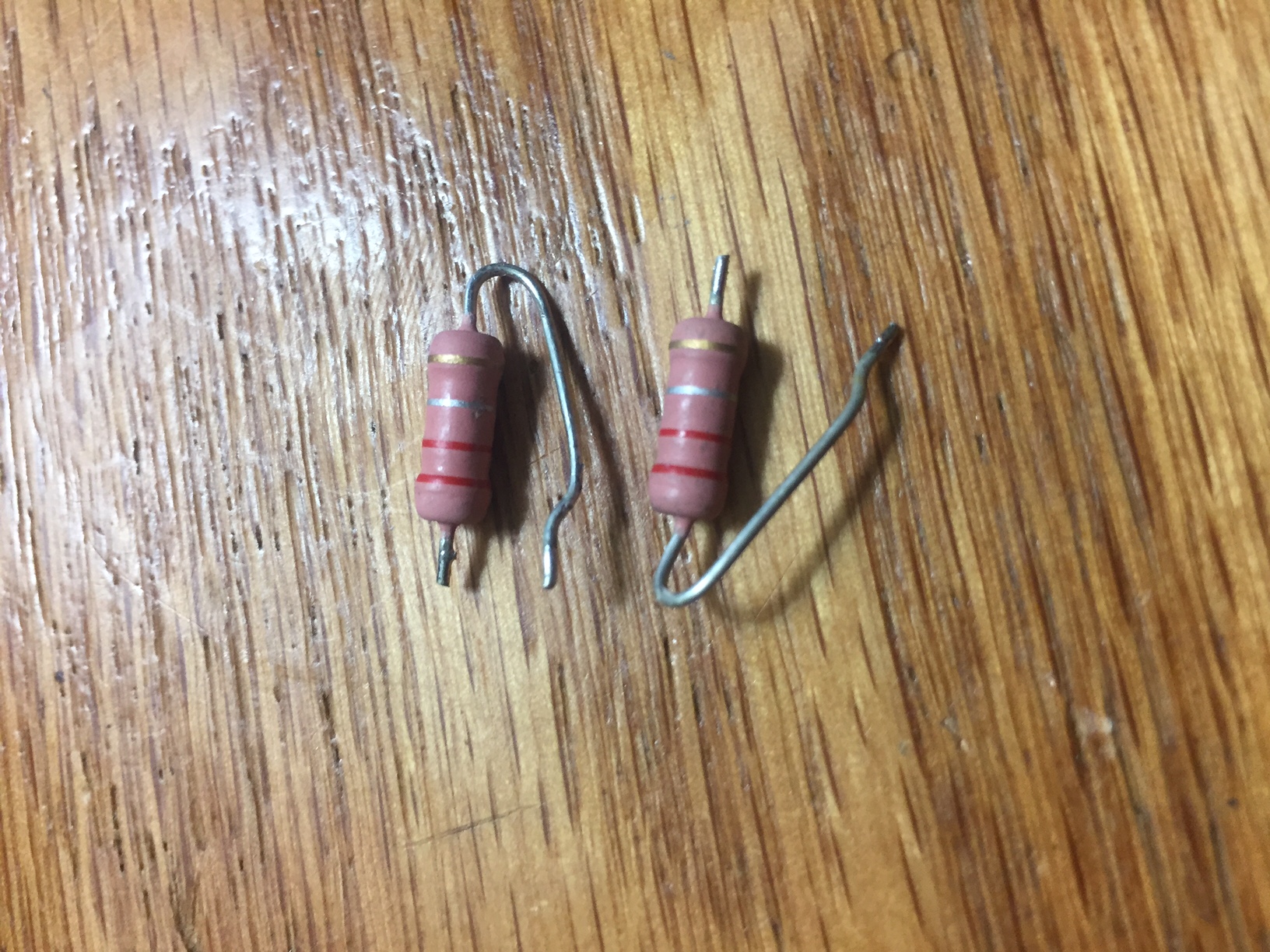

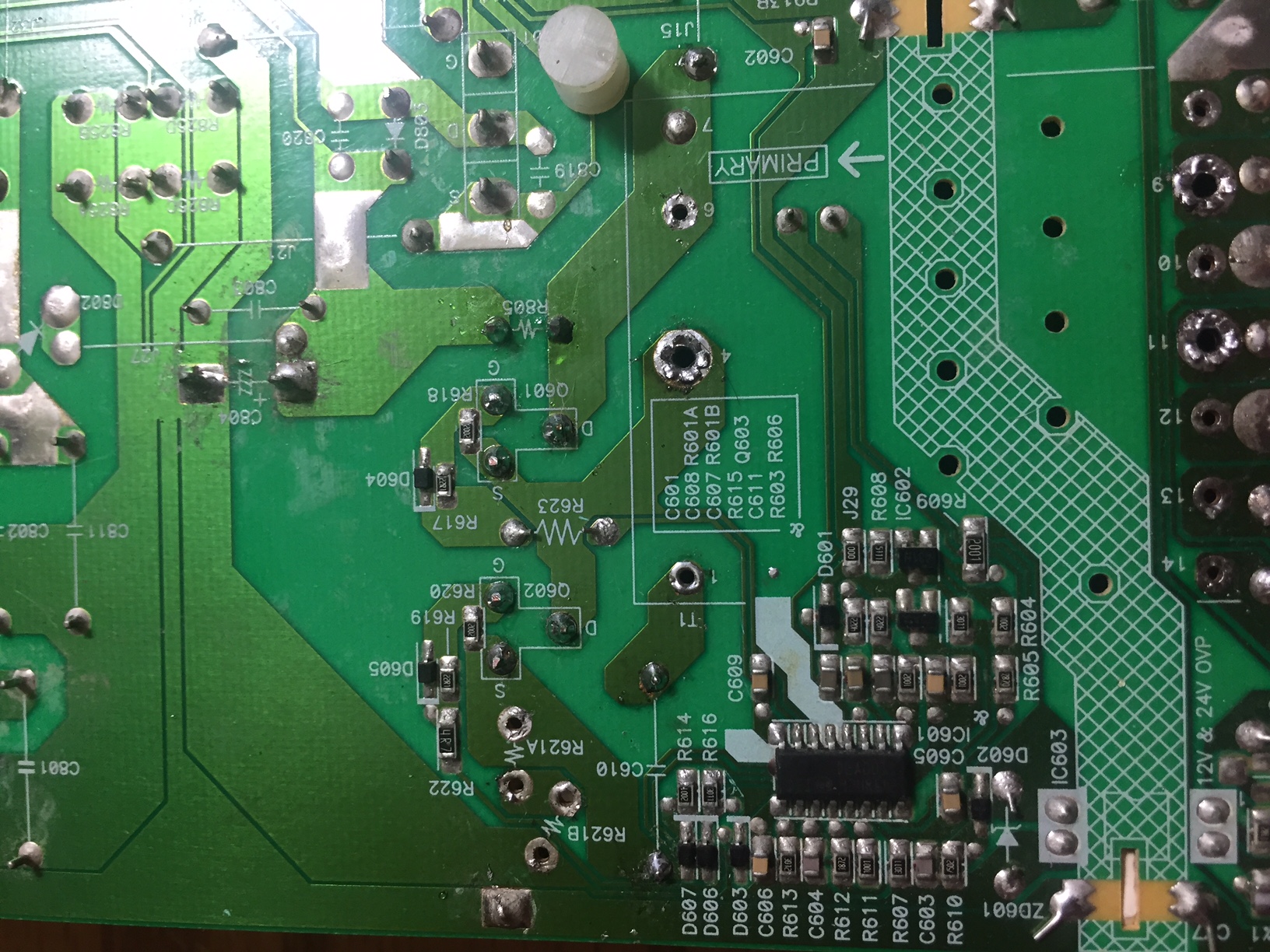

visio vx37l resistor indentity help
+ More Options
Latest Activity
    replied
    Re: visio vx37l resistor indentity help
    Thanks for the follow-up on the repair.
    Leave a comment:
  • sdinelli
    replied
    Re: visio vx37l resistor indentity help
    well finally had time to get the part and replace the 16pin IC.
    and guess what it works!
    Feels good.
    thank you everyone for your assistance
    Leave a comment:
  • sdinelli
    replied
    Re: visio vx37l resistor indentity help
    UGH I'm pissed I got all the parts and installed everything. when I got to the IC it turned out I ordered the 16-DIP and not the surface mount. gerr
    Should have just bought the board for 35$
    Leave a comment:
    replied
    Re: visio vx37l resistor indentity help
    I would replace both MOSFETs since they work together.
    Leave a comment:
  • sdinelli
    replied
    Re: visio vx37l resistor indentity help
    Welp, The one mosfet is bad. doesn't turn on. the other I was able to turn off and on.
    Will order:
    x2 .22ohm resistor
    x1 4.7ohm smc resistor
    x1 IC L6598
    x1 MOSFET (STP12NM50FP)
    Will report back when installed and tested
    Leave a comment:
  • sdinelli
    replied
    Re: visio vx37l resistor indentity help
    Originally posted by budm
    I asked about how you test the IC in post 36, and you reply "LOL oops i already tested it. nothing blew up." in post 37.
    Bottom line: replace the IC beside the MOSFETs +any damaged Gate drive network.
    I shouldn't have used the word tested.
    I just meant I turned it on and nothing blew up.
    All I really know about the IC is that I have 10.66V on pin 12(Vs) I think that's above the threshold to turn it on.
    I didn't have the schematic when I was poking around.
    So ill should pull the mosfets to Test them and see if I need some or not right?
    Leave a comment:
    replied
    Re: visio vx37l resistor indentity help
    I asked about how you test the IC in post 36, and you reply "LOL oops i already tested it. nothing blew up." in post 37.
    Bottom line: replace the IC beside the MOSFETs +any damaged Gate drive network.
    Leave a comment:
  • sdinelli
    replied
    Re: visio vx37l resistor indentity help
    Originally posted by budm
    How did you test the IC? If one of the output stuck high then one of the MOSFET will be fully on and when the other out put goes hing then you will have two MOSFETs conduct at the same time which will be bad news for the new MOSFETs. You do not want half- bridge drive circuit to have two MOSFETs on at the same time. The resistor/diode network will be damaged when the 400VDC from the Drain pin is dumped through the GATE and the output Gate drive of the IC. When you find bad GATE resistor that is a sure sign of damaged Gate drive output.
    "measuring the voltage drop from Gate to source in circuit i get .056V. On the other mosfet i get OL." That means the Voltage was too high for the meter to display the Voltage reading.
    I tested the mosfets in circuit, black lead on source red lead on gate, then switched them. got .56V both directions. I also measured it in ohms and got around 60ohms.
    Ialso tested with black lead on source and red lead on drain and got ~.500V
    reverse biased I got OL.
    The other one, I got OL in all directions other than drain to source, which I got ~.500V drop.
    Do I need to test these out of circuit to be sure?
    obviously I need to replace 4.7ohm resistior, two .22ohm resistors and ic601
    Last edited by sdinelli; 07-27-2017, 07:18 AM.
    Leave a comment:
    replied
    Re: visio vx37l resistor indentity help
    Originally posted by sdinelli
    LOL oops i already tested it. nothing blew up.
    I found another blown resistor on the gate.. R622 4.7ohm.
    its reading OL
    The one right by it is a 22r1(R619) and that's good
    The 4.7ohm resistor(R623) on the other gate is still good.
    it seems the only trace leading directly to the IC with out passing through another component is pin 14. labeled "OUT- high side driver reference"
    How did you test the IC? If one of the output stuck high then one of the MOSFET will be fully on and when the other out put goes hing then you will have two MOSFETs conduct at the same time which will be bad news for the new MOSFETs. You do not want half- bridge drive circuit to have two MOSFETs on at the same time. The resistor/diode network will be damaged when the 400VDC from the Drain pin is dumped through the GATE and the output Gate drive of the IC. When you find bad GATE resistor that is a sure sign of damaged Gate drive output.
    "measuring the voltage drop from Gate to source in circuit i get .056V. On the other mosfet i get OL." That means the Voltage was too high for the meter to display the Voltage reading.
    Last edited by budm; 07-26-2017, 10:31 PM.
    Leave a comment:
  • sdinelli
    replied
    Re: visio vx37l resistor indentity help
    actually.. when i first replaced the mosfets and powered up the unit. i did here a buz coming from that area.
    I never heard it again other times when powering up.
    measuring the voltage drop from Gate to source in circuit i get .056V
    On the other mosfet i get OL.
    Leave a comment:
  • sdinelli
    replied
    Re: visio vx37l resistor indentity help
    Originally posted by budm
    That IC601 is probably has blown Gate drive outputs when MOSFET's went out. I would not take a chance on a new pair of MOSFET's without replacing the IC at the same time.
    LOL oops i already tested it. nothing blew up.
    I found another blown resistor on the gate.. R622 4.7ohm.
    its reading OL
    The one right by it is a 22r1(R619) and that's good
    The 4.7ohm resistor(R623) on the other gate is still good.
    it seems the only trace leading directly to the IC with out passing through another component is pin 14. labeled "OUT- high side driver reference"
    Last edited by sdinelli; 07-26-2017, 09:14 PM.
    Leave a comment:
    replied
    Re: visio vx37l resistor indentity help
    That IC601 is probably has blown Gate drive outputs when MOSFET's went out. I would not take a chance on a new pair of MOSFET's without replacing the IC at the same time.
    Leave a comment:
  • sdinelli
    replied
    Re: visio vx37l resistor indentity help
    Originally posted by budm
    They are 0.22 Ohms.
    For them to go open circuit or high resistance like that the MOSFETs are probably bad, or the Gate drive stuck high instead of switching.
    Fusible resistor R805 which feeds the supply Voltage from the main cap to the transformer primay is still good?
    both MOSFETs were blown open.
    and R805 was burnt up.
    Replaced all 3 and not getting voltage on the Gates, which is when i found these two resistors...
    Do you think replacing these two will more than likely fix the issue or do you think the surge took out the IC601?? i was going to replace the ic with thishttp://www.st.com/content/ccc/resour...CD00001777.pdf
    R623 is good and the two 20Kohm resistors connecting the gate and source are also good
    Leave a comment:
    replied
    Re: visio vx37l resistor indentity help
    They are 0.22 Ohms.
    For them to go open circuit or high resistance like that the MOSFETs are probably bad, or the Gate drive stuck high instead of switching.
    So the Fusible resistor R805 which feeds the supply Voltage from the main cap to the transformer primary is still good?
    Last edited by budm; 07-26-2017, 08:30 PM.
    Leave a comment:
  • sdinelli
    replied
    Re: visio vx37l resistor indentity help
    what are these two resistors values support to be??
    I pulled them and R621B tested 34.5ohms and R621A tested 1.945Mohms
    From what colors i see they should be .22ohms right?
    What function do these resistors perform? I see they connect the source to the ground.
    Leave a comment:
  • sdinelli
    replied
    Re: visio vx37l resistor indentity help
    testing with the transformer removed resulted in no change.
    http://html.alldatasheet.com/html-pd...3/2/L6598.html
    Based on this schematic
    pin 12/Vs = 10.66Vdc
    pin15/HVG = is what traces to the gate. very sporadic like a short to ground but with flashs of a low voltage such as .4vdc
    Leave a comment:
  • sdinelli
    replied
    Re: visio vx37l resistor indentity help
    ohhh right the ones attached to the heatsinks. duh
    Leave a comment:
  • sdinelli
    replied
    Re: visio vx37l resistor indentity help
    c610 = .021uf/21.9nf ESR 80ohm
    Which diodes are you referring to? the surface mount ones or the zener's on the front?
    Leave a comment:
    replied
    Re: visio vx37l resistor indentity help
    Those are the Gate discharge diodes. I am talking about the rectifier diodes in the cold side for this 12V/24 power supply section.
    Leave a comment:
  • sdinelli
    replied
    Re: visio vx37l resistor indentity help
    D604 & D605 (attached to the gate of both transistors) both measure a voltage drop of.021Vdc both ways. but theyre also run parallel to a 22.1ohm resistor. which tests good.
    Does this sound fishy?
    both diodes labeled 5Dx
    Leave a comment:
  • mikey5791
    Need help to replace burned resistor in 350w atx psu
    by mikey5791
    Hi to all forum members,
    Got this faulty 350 watt atx psu dirt cheap from a local online seller as i am keen to use it as a learning tool to repair faulty power supply.
    The faulty part is quite obvious from the burn area near the 16pin KA7500 BD pwm. The fuse is still intact with good continuity.
    Upon power on ac, there is 5vdc standby power on cathode of diode D14 and about 10vdc on cathode of diode D13.(This should be the aux power to generate the 12v and 5v rail.)
    Initially i replace the two burned resistors near my marked red arrow to 200 ohm resistor...
    12-26-2024, 04:55 AM
  • jinu_j
    Dell 2209WA - power supply - Fusible Resistor replacement
    by jinu_j
    Hi
    I am trying to repair an ancient Dell 2209WA Monitor which suddenly shut off with a pop sound. On investigation found that one of the fusible resistors had blown. Further investigation identified multiple components as faulty because of which the fusible resistor blew. Please refer the attached circuit diagram showing the components that were found to be damaged.
    1. FR950 - blown fusible resistor - 0.2 Ohm 1W
    2. Q950 - shorted Q950 MOSFET - 650V 10A N Channel Mosfet
    3. R835 - Blown Resistor - 20KOhm SMD resistor
    4. D930 - Shorted Schottkey Diode...
    05-03-2025, 10:51 PM
  • MidnightRoller
    Can a resistor lose resistance after hot air?
    by MidnightRoller
    I am curious if a 0402 resistor could go from 43 ohm to 0. In electronics class and my experience a resistor can degrade and gain resistance all the way up to not being able to conduct at all. I have never heard of a resistor decreasing in resistance and becoming 0 ohm or a dead short… that's not the direction they fail… or so I thought.
    I was attempting to remove a wson8 chip on an iMac motherboard and it required a lot of heat, on one side of the chip were 3 0402 resistors that were very close. I popped the chip out unintentionally out of the tweezers and sent those resistors...
    02-02-2022, 11:46 PM
  • artvandalai
    What resistor ohm will work better to repair this waterpik?
    by artvandalai
    The resistor on this waterpik blew. I changed it with the a similar spec 47ohm 2 watt yageo resistor but it still keeps blowing the resistor. Checking with the multimeter the motor, capacitor, diodes, and thermal fuse all checked normal. Will a higher ohm resistor work better? What ohm resistor will work better to repair this waterpik? This video is showing the repair with a 56 ohm resistor https://www.youtube.com/watch?v=_J7_rV7ui1Y
    01-05-2025, 04:10 PM
  • chth96
    Is it okay to replace 1/2 watt resistor with 1 watt resistor in AC/DC adapter?
    by chth96
    I have purchased an 100-240v AC/5v 2a DC adaptor from aliexpress,and a month ago It smelled burning when I plugin it powerstrip.
    Since then, This AC/DC adaptor have been out of order.
    But A few days ago,I replace 0.5 watt resistor with 1 watt resistor(1ohm) in this adapter.
    After replacing resistor,It succeed to recharge all of android phone.And When I measure voltage on the two pins of USB port,It shows 5.5v
    Is it okay to replace 1/2 watt resistor with 1 watt resistor in AC/DC adapter?
    And Is there any possibility that it will suddenly explode as well as to be out...
    12-03-2023, 04:40 AM
