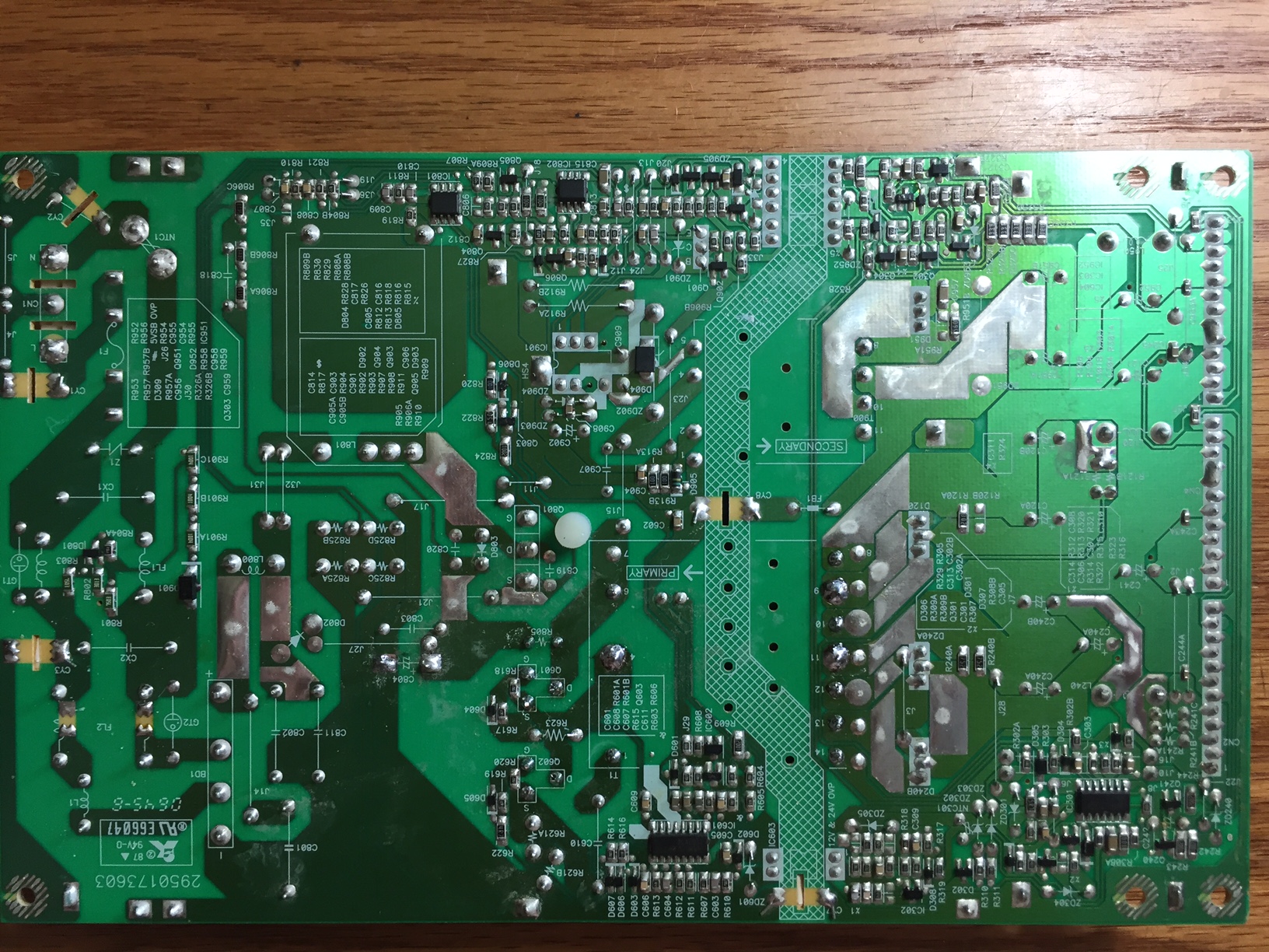

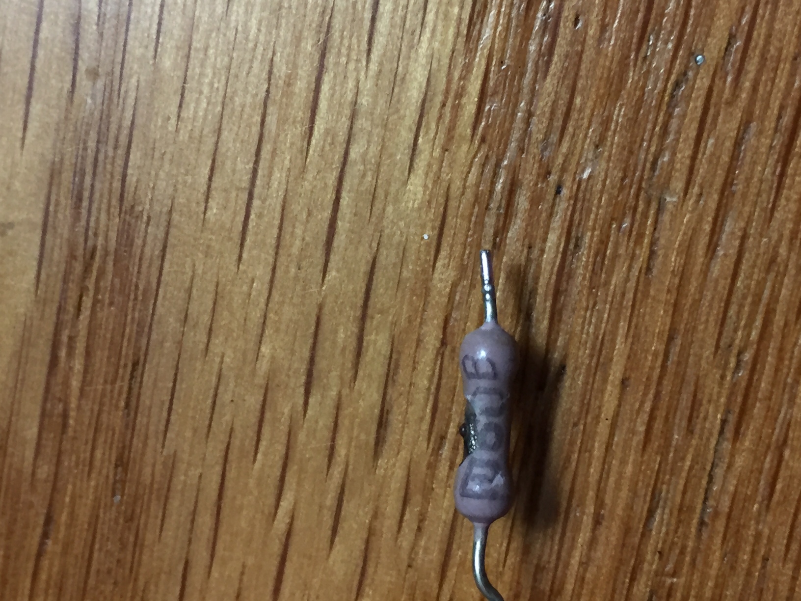

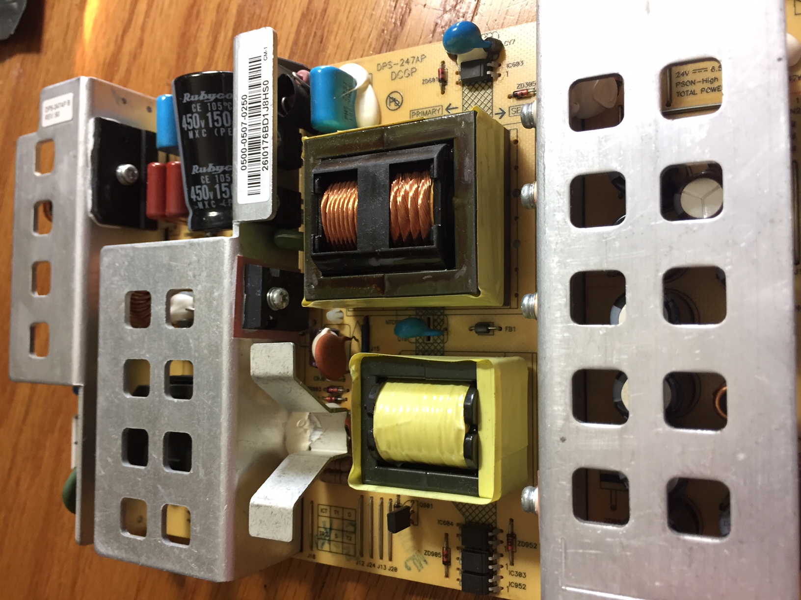

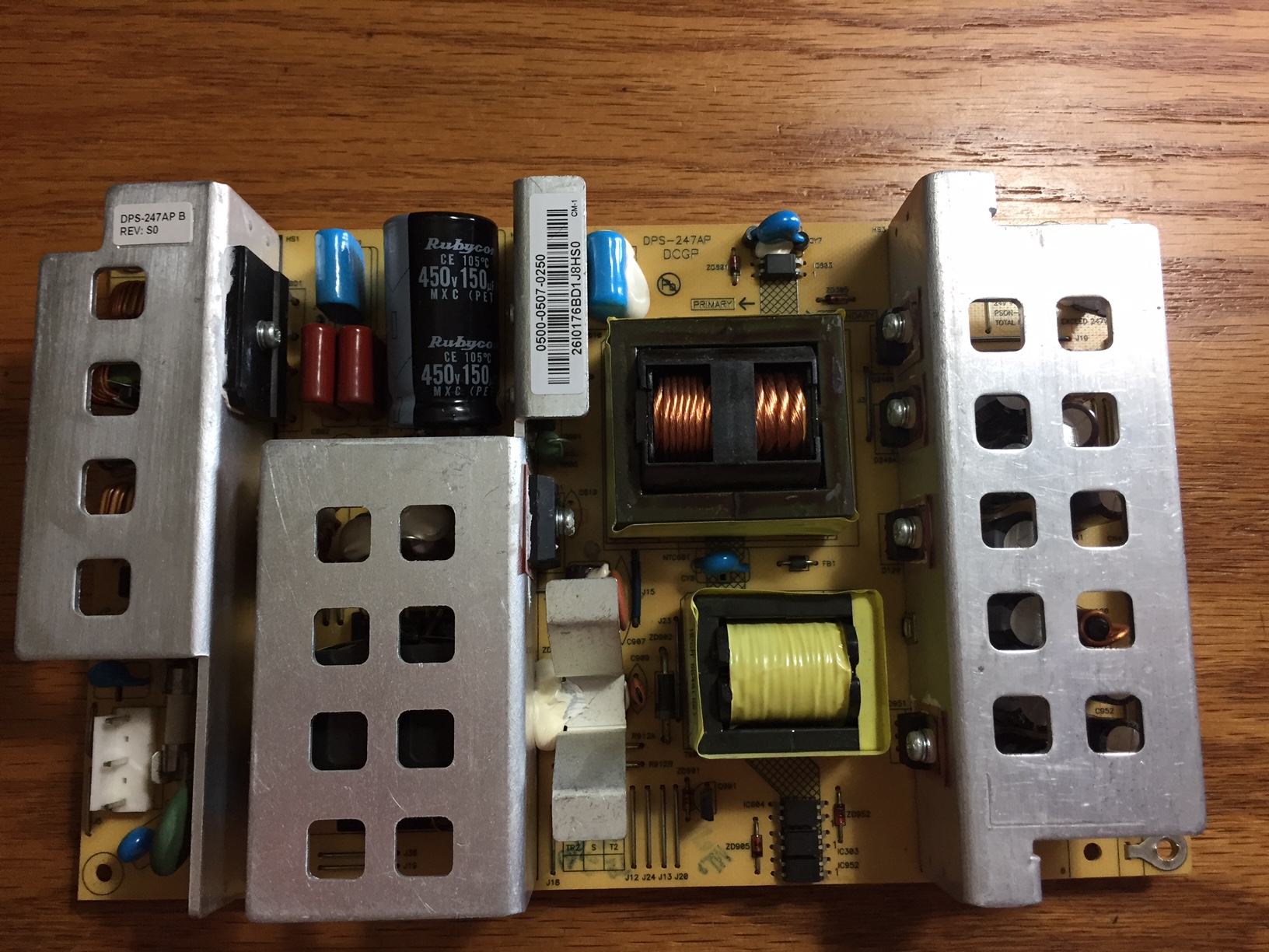

visio vx37l resistor indentity help
    replied
    Re: visio vx37l resistor indentity help
    "223J: 1000VHoX:" 0.022uf +/- 5% (J), 1000V rating. You need to remove it to check the capacitance.
    BTW, you did verify that the diodes on the cold side for the 12V and 24V are OK, right?
    DLA001D SMPS IC.
    One of these threads should show info about the DLA001D:
    https://www.badcaps.net/forum/search...archid=9081622
    Leave a comment:
  • sdinelli
    replied
    Re: visio vx37l resistor indentity help
    I'm not sure how to test c610. its labeled "phs 223J: 1000VHoX:"
    I cant find the schematic on the IC its labeled "DLA00LD(or DLA001D) DEI 92UR642"
    My recent tests have been with only the one cable that turns on the tv.(cn3)
    Leave a comment:
    replied
    Re: visio vx37l resistor indentity help
    C610 is OK?
    Look up spec of SMPS IC601 which drives the two MOSFETs fo r that T1 Transformer to see if you do have VCC to run the IC or not.
    BTW, you indicate no 12V/24V, is that without having the 24V cable going to the inverter board?
    Last edited by budm; 07-15-2017, 04:53 PM.
    Leave a comment:
  • sdinelli
    replied
    Re: visio vx37l resistor indentity help
    I had removed the transformer to gain access to the blown transistors. should i remove the transformer and test?
    The problem seems to be I'm getting voltage at the drain(406Vdc) but i need 3-5Vdc at the gate that I'm not getting. It gives a quick flash ranging anywhere between .4Vdc and 2vDC.
    I traced this reading to the IC pin. (IC601)
    Leave a comment:
    replied
    Re: visio vx37l resistor indentity help
    BTW, I need better straight shot pictures of the WHOLE top and bottom side of that power supply board. Also did you remove one of the power transformer T1 as shown in post#1? That transformer is for 12V/24V power supplies.
    This looks to be your PS board:
    http://www.shopjimmy.com/vizio-0500-...upply-unit.htm
    Vizio 0500-0507-0250 (DPS-247APB) Power Supply Unit.
    Last edited by budm; 07-15-2017, 03:09 PM.
    Leave a comment:
    replied
    Re: visio vx37l resistor indentity help
    Skip this reply one due to your recent update on the DCV of the main filter cap.
    Last edited by budm; 07-15-2017, 03:02 PM.
    Leave a comment:
  • sdinelli
    replied
    Re: visio vx37l resistor indentity help
    OK I don't know why I was getting those reading before but i teste dit again and I'm getting 162Vdc across the filter cap in standby( which is PFC correct?) and then bumbs up to 406Vdc when i push the power button.
    something is up with the transistor circuit.
    Reference the second picture at the top. top of the board
    Leave a comment:
  • sdinelli
    replied
    Re: visio vx37l resistor indentity help
    ummm soo yeah using the negative leg of main filter cap got me 528Vdc on the cathode of that diode. and 406Vdc on the anode.
    I don't get it.
    With the device in standby i have 194Vdc on the cathode of the diode
    Last edited by sdinelli; 07-15-2017, 10:23 AM.
    Leave a comment:
  • sdinelli
    replied
    Re: visio vx37l resistor indentity help
    Thank you for the info guys. hot and cold sides confuse me
    Leave a comment:
    replied
    Re: visio vx37l resistor indentity help
    Originally posted by attainteddragon
    a diode will block ac, so when checking voltages on the cathode, you test in dc.
    It will block half the cycle of the feeding AC in rectifying circuit.
    http://www.visionics.a.se/html/curri...ectifier1.html
    Leave a comment:
  • attainteddragon
    replied
    Re: visio vx37l resistor indentity help
    a diode will block ac, so when checking voltages on the cathode, you test in dc.
    Leave a comment:
    replied
    Re: visio vx37l resistor indentity help
    Negative leg of the main filter cap is the GND ref. for the primary side of the circuit.
    Leave a comment:
  • sdinelli
    replied
    Re: visio vx37l resistor indentity help
    yeah I thought it sounded high. lol should I be using the negative side of the main cap?
    should I measure ac or dc?
    Leave a comment:
    replied
    Re: visio vx37l resistor indentity help
    Sounds like using the wrong GND Ref. for the meter.
    Leave a comment:
  • dskall
    replied
    Re: visio vx37l resistor indentity help
    472v seems rather high
    Leave a comment:
  • sdinelli
    replied
    Re: visio vx37l resistor indentity help
    SO I replaced the 2 transistors and the resistor.
    Now I have standby
    psON is up at 4.6V and visio turns from amber to white
    BUT I'm only getting about 1-2V on my 12V and 24V
    I checked and I'm getting 472Vdc on the big diode (ZD902) behind the transformer in the picture.
    Any suggestions?
    Also, theres a faint buzzing coming from the new transistors I installed. doesnt that mean the voltage is too low or something?
    Last edited by sdinelli; 07-09-2017, 08:20 PM.
    Leave a comment:
  • sdinelli
    replied
    Re: visio vx37l resistor indentity help
    sorry for being MIA. Busy Weekend.
    Now that you say it. I think you all are right.
    For the next $million question..........
    How far do you think the damage went?
    I have R623 reading 4.8ohms
    R621A = 24.6ohms
    R62B = 15.7ohms
    R618 & R620 (resistors between source and gate) are 20kohms
    reading 19.93ohm and 20ohms
    What else should I check?
    what are the chances the surge blew back into IC 601
    thanks for the help amigos
    Leave a comment:
  • jiroy
    replied
    Re: visio vx37l resistor indentity help
    Originally posted by tw2005
    I'm not the original poster.Not after one, I just wanted to know if you had one of these boards and confirmed it was that .
    You seemed very certain.
    Ah well ; No , i don't have the board , but i have the schematic , and frankly , this one came with many restrictions and warnings considering publishing . That's all..
    Leave a comment:
  • tw2005
    replied
    Re: visio vx37l resistor indentity help
    Originally posted by jiroy
    In my stock of used parts , i'm sure i can find a dozen , but still , Lebanon is very far , unless you wanna wait ..
    In case you didn't find it , i'm ready , send me your E-mail
    I'm not the original poster.Not after one, I just wanted to know if you had one of these boards and confirmed it was that .
    You seemed very certain.
    Leave a comment:
  • jiroy
    replied
    Re: visio vx37l resistor indentity help
    Originally posted by tw2005
    Do you have a live one in captivity to refer to? LOL.
    In my stock of used parts , i'm sure i can find a dozen , but still , Lebanon is very far , unless you wanna wait ..
    In case you didn't find it , i'm ready , send me your E-mail
    Leave a comment:
  • mikey5791
    Need help to replace burned resistor in 350w atx psu
    by mikey5791
    Hi to all forum members,
    Got this faulty 350 watt atx psu dirt cheap from a local online seller as i am keen to use it as a learning tool to repair faulty power supply.
    The faulty part is quite obvious from the burn area near the 16pin KA7500 BD pwm. The fuse is still intact with good continuity.
    Upon power on ac, there is 5vdc standby power on cathode of diode D14 and about 10vdc on cathode of diode D13.(This should be the aux power to generate the 12v and 5v rail.)
    Initially i replace the two burned resistors near my marked red arrow to 200 ohm resistor...
    12-26-2024, 04:55 AM
  • jinu_j
    Dell 2209WA - power supply - Fusible Resistor replacement
    by jinu_j
    Hi
    I am trying to repair an ancient Dell 2209WA Monitor which suddenly shut off with a pop sound. On investigation found that one of the fusible resistors had blown. Further investigation identified multiple components as faulty because of which the fusible resistor blew. Please refer the attached circuit diagram showing the components that were found to be damaged.
    1. FR950 - blown fusible resistor - 0.2 Ohm 1W
    2. Q950 - shorted Q950 MOSFET - 650V 10A N Channel Mosfet
    3. R835 - Blown Resistor - 20KOhm SMD resistor
    4. D930 - Shorted Schottkey Diode...
    05-03-2025, 10:51 PM
  • MidnightRoller
    Can a resistor lose resistance after hot air?
    by MidnightRoller
    I am curious if a 0402 resistor could go from 43 ohm to 0. In electronics class and my experience a resistor can degrade and gain resistance all the way up to not being able to conduct at all. I have never heard of a resistor decreasing in resistance and becoming 0 ohm or a dead short… that's not the direction they fail… or so I thought.
    I was attempting to remove a wson8 chip on an iMac motherboard and it required a lot of heat, on one side of the chip were 3 0402 resistors that were very close. I popped the chip out unintentionally out of the tweezers and sent those resistors...
    02-02-2022, 11:46 PM
  • artvandalai
    What resistor ohm will work better to repair this waterpik?
    by artvandalai
    The resistor on this waterpik blew. I changed it with the a similar spec 47ohm 2 watt yageo resistor but it still keeps blowing the resistor. Checking with the multimeter the motor, capacitor, diodes, and thermal fuse all checked normal. Will a higher ohm resistor work better? What ohm resistor will work better to repair this waterpik? This video is showing the repair with a 56 ohm resistor https://www.youtube.com/watch?v=_J7_rV7ui1Y
    01-05-2025, 04:10 PM
  • chth96
    Is it okay to replace 1/2 watt resistor with 1 watt resistor in AC/DC adapter?
    by chth96
    I have purchased an 100-240v AC/5v 2a DC adaptor from aliexpress,and a month ago It smelled burning when I plugin it powerstrip.
    Since then, This AC/DC adaptor have been out of order.
    But A few days ago,I replace 0.5 watt resistor with 1 watt resistor(1ohm) in this adapter.
    After replacing resistor,It succeed to recharge all of android phone.And When I measure voltage on the two pins of USB port,It shows 5.5v
    Is it okay to replace 1/2 watt resistor with 1 watt resistor in AC/DC adapter?
    And Is there any possibility that it will suddenly explode as well as to be out...
    12-03-2023, 04:40 AM
