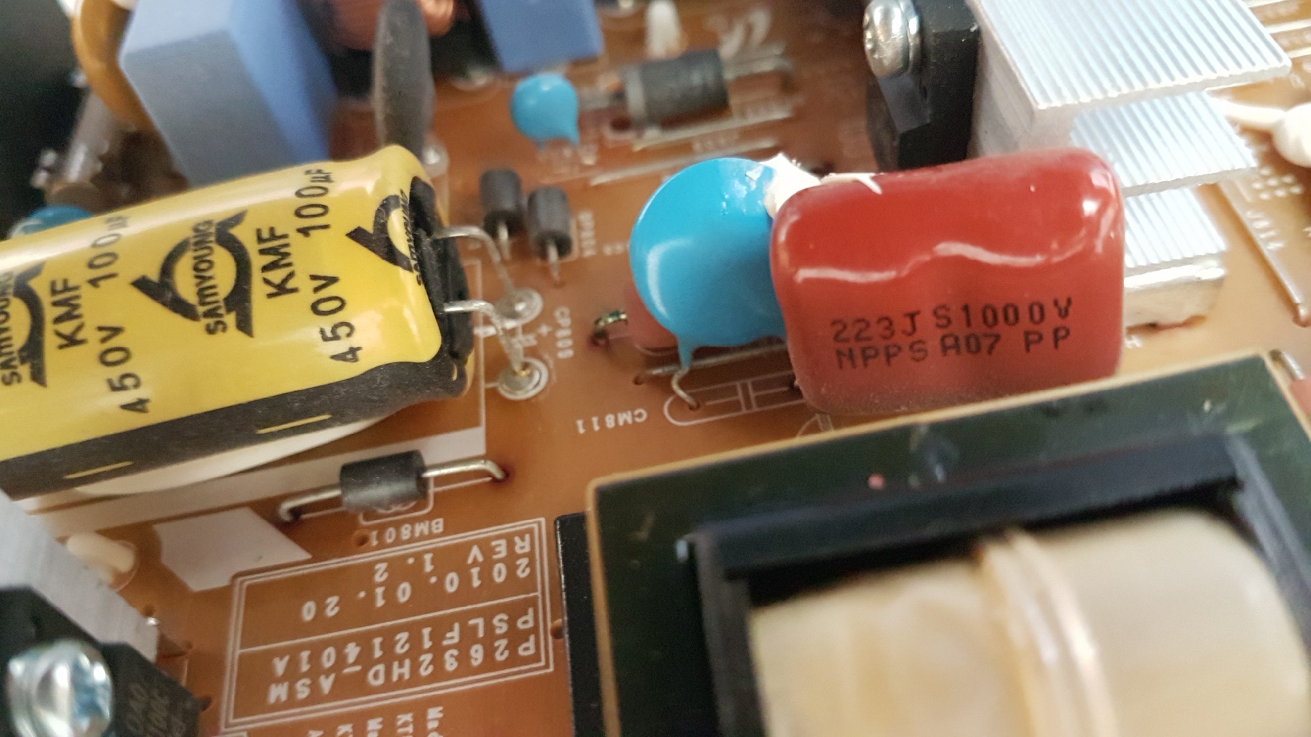

    I'm wanting to repair multiple Samsung LA32C400 TVs. (Shares the same PSU as LE32C450)
    Most have the same fault as described by the OP in the thread above.
    I have not tested the actual psu boards but doning one from a fully working set does do the trick.
    PSU board is again the BN440033A version (not B).
    Soooooooo,
    Q1) Is it safe to assume that the same brown poly cap as shown by martino is the one to attack on each of these faulty sets?

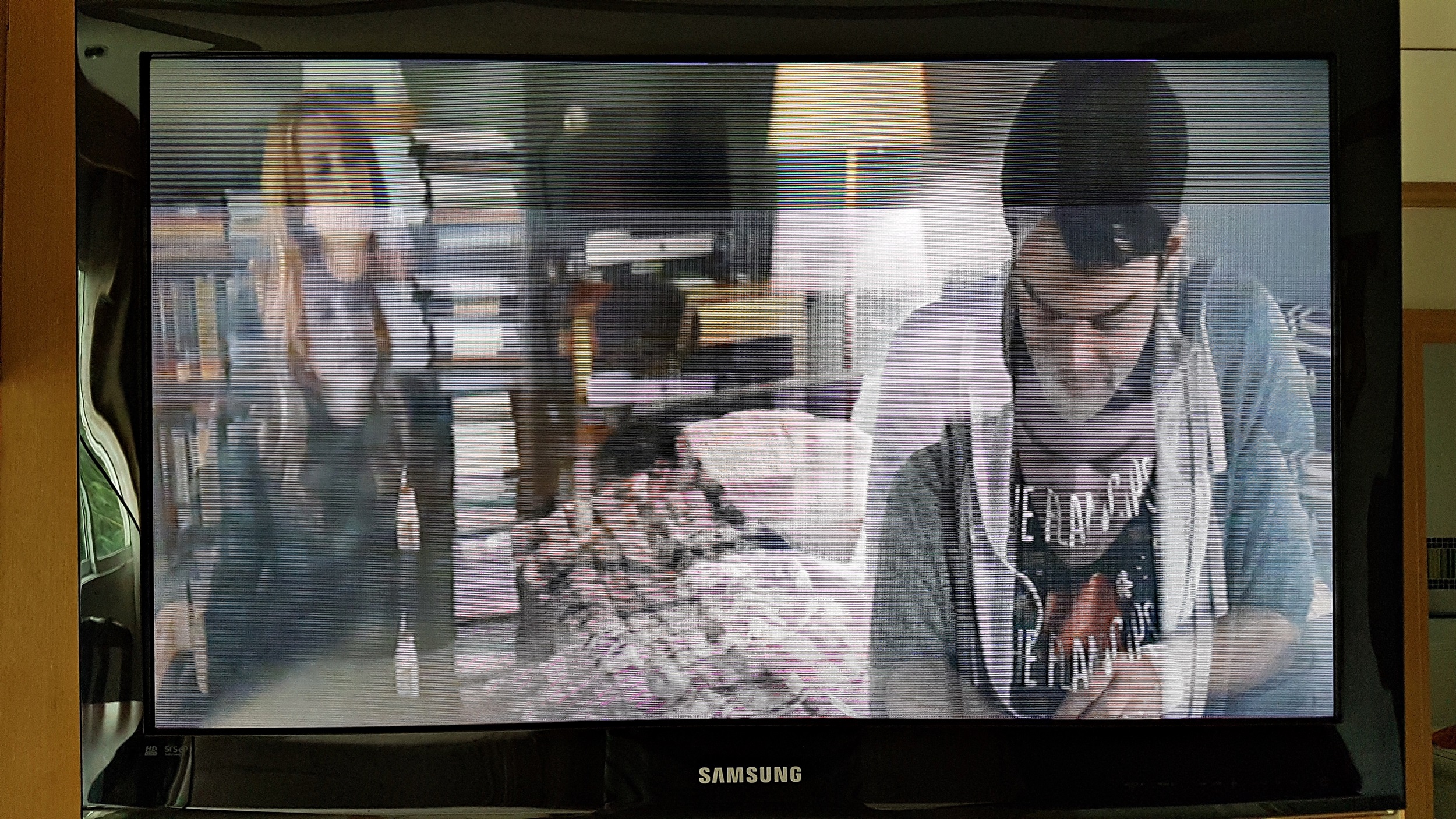

    Q2) Another set comes on fine but once warmed for a minute or so has horizontal "interference" lines along the top third of the screen. What should I be looking at to fault find this?
    Many thanks.

    Re: Samsung LA32C400 stuck in standby, red light on.
    A1) Can you do a self-test on the PSU using the car bulbs as dummy loads? If that works then I would still go ahead and replace the brown poly cap then go on to suspect the Main Bd.
    A2) Lines on the screen most likely bad tab bonds or perhaps either the cut-off or the bypass method may be applicable.
    Please post some clearly focused close up pictures of the screen problem and the PSU, so the experts can help you better.

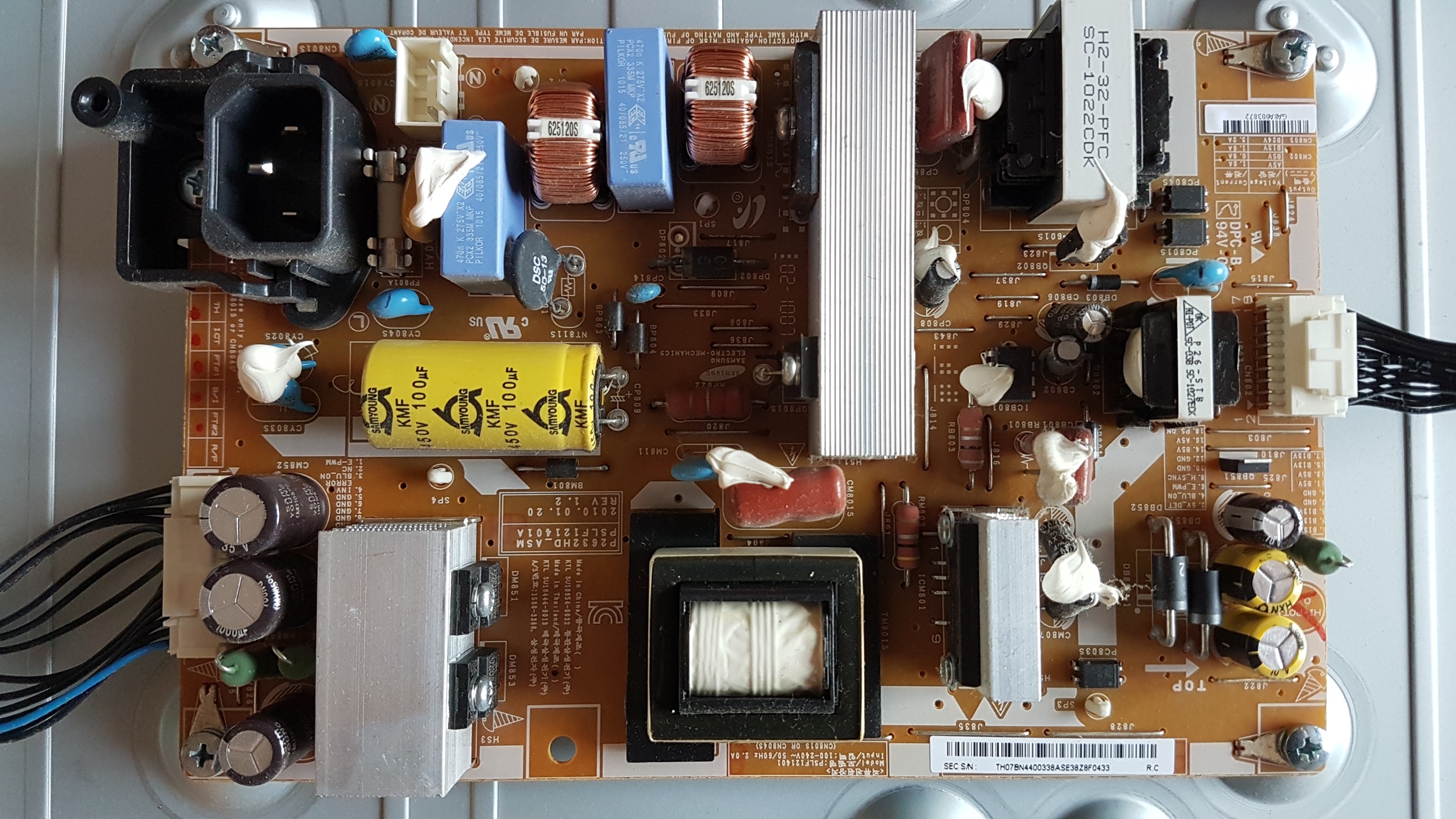

        I can answer just one point right this minute which is a photo of the psu. I'll follow up with more.
          Can we see higher res pictures of that power supply board and also the whole back of the TV showing all the boards.

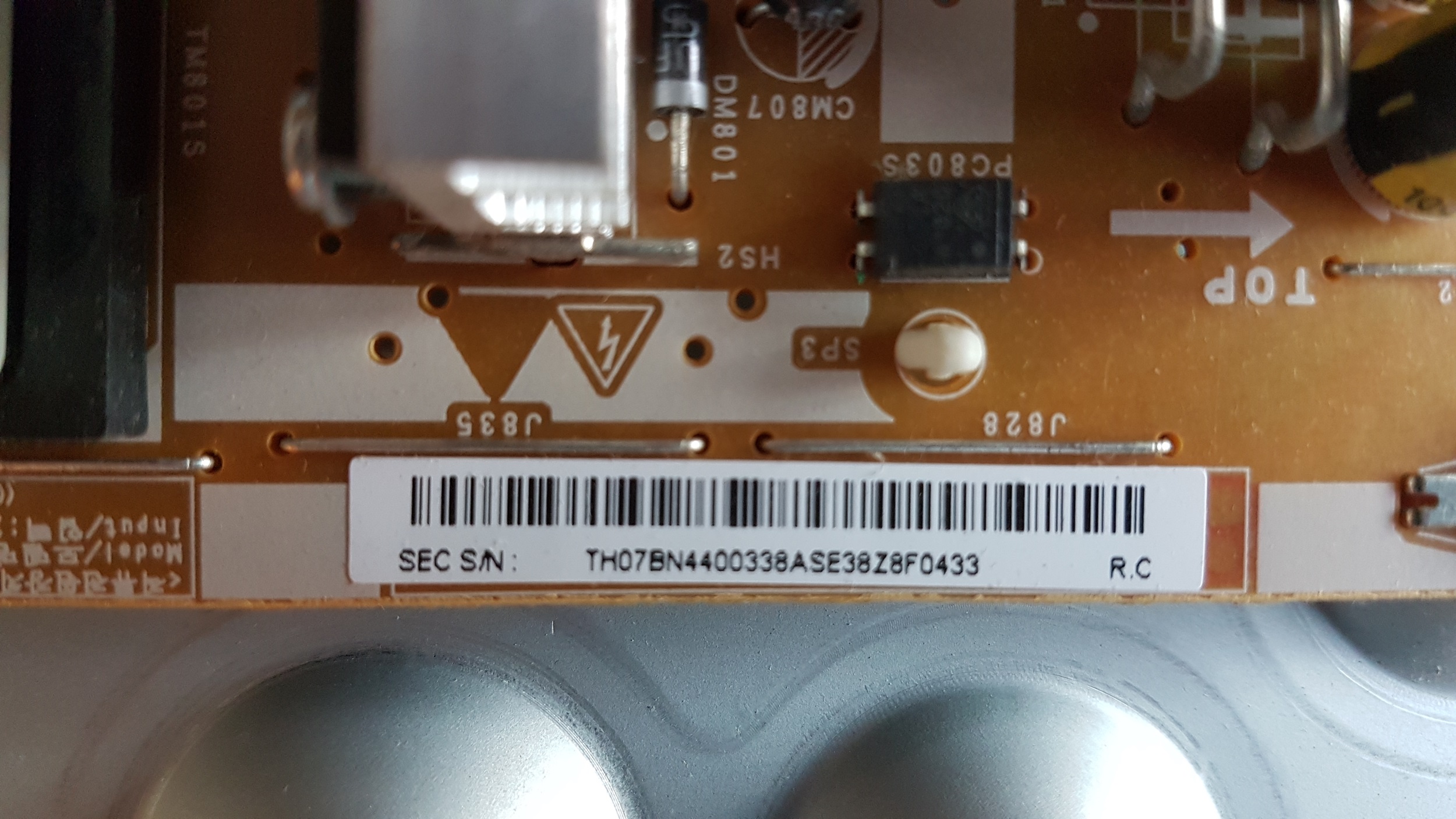

          I cannot read the board P/N. BN44-??????
          "BN440033A version (not B)" as posted is not valid number.
          I cannot read the labels for each pin of the connectors or the Voltage charts as printed on the board either.

            Ah, looks like my phone and PB defaulted to low res, try again.

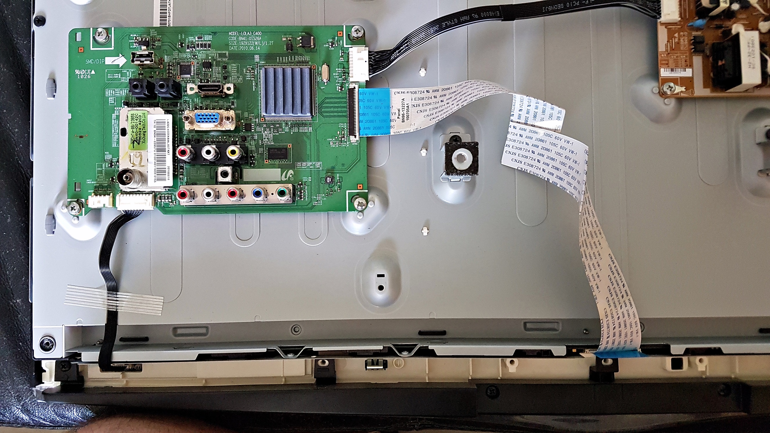

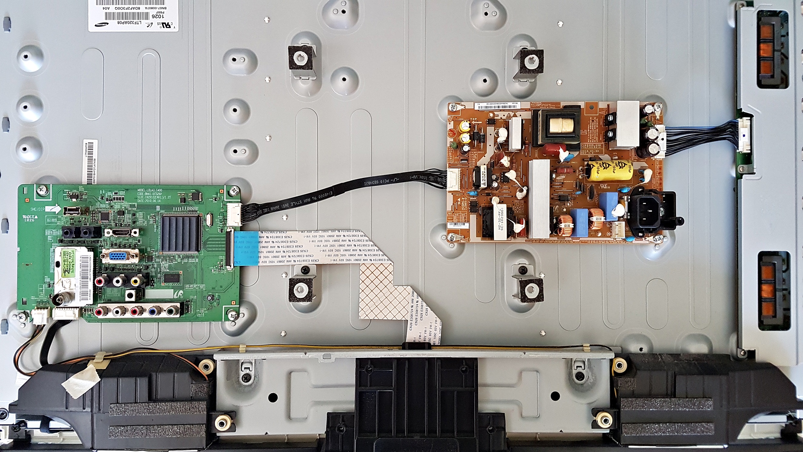

              How about the pictures of the whole backside of the TV showing all the boards?
              So the power supply board is BN44-00338A.

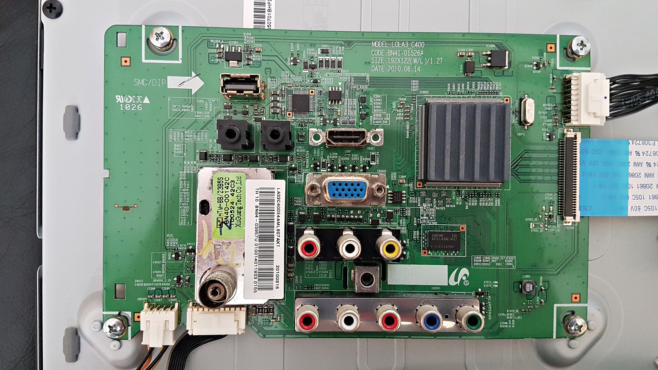

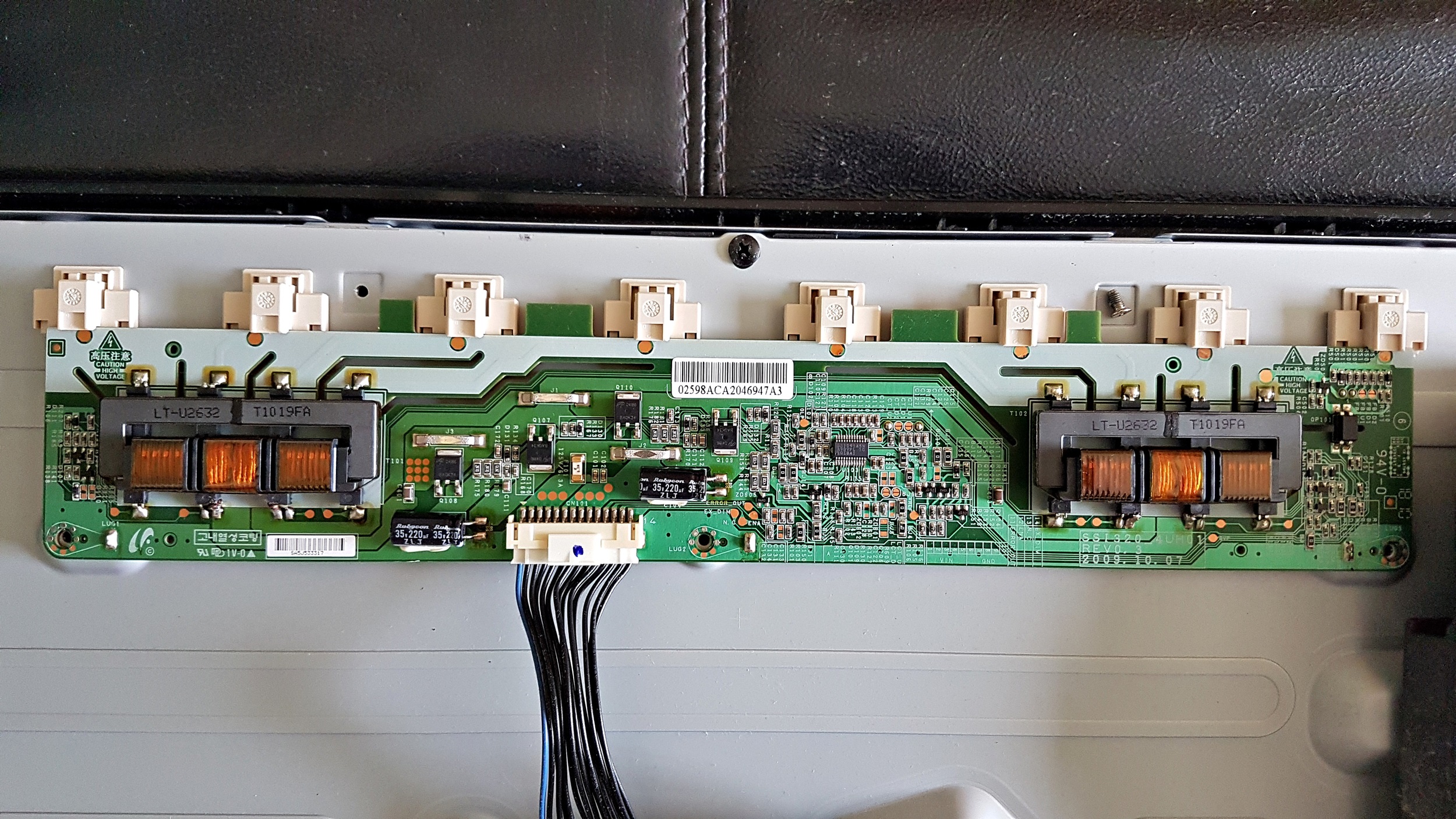

                  Here are the rest of the photos as requested.
                  Thanks to vr69 for the schematic.
                  Control board
                  Inverter board
                  Then finally the screen shot from my Q2

                      "A2) Lines on the screen most likely bad tab bonds"
                      What's the method for checking the tab bonds?
                      "or perhaps either the cut-off or the bypass method may be applicable."
                      Could you explain or link to these methods please.

                        As your tv has the lcd panel pcb and tab bonds at the bottom of the tv theres also a chance someone has used cleaner on the screen and possibly damaged the tab bonds im also not sure if a main board bga chip can cause this issue hopefully a more experienced member will confirm the video i linked shows bad tab bond issues but these i notice all have vertical lines your has horizontal lines i know budm has fixed his own samsung tvs with tab bond issues maybe he can advise you
                        https://www.youtube.com/watch?v=j7vl7-vZEL8

                          I'll be giving that a go the first chance I get on the single TV with the lines and double image.

                            double imaging can be caused by tab bonds, so it could be panel.
                              Ok, I gave the connecting ribbon my best shot for curing double image and lines but no matter what I did there was absolutely no difference, better or worse.
                              On this model set there is no separate TCON board that devides the screen into two halves with a ribbon for each. Therefore, I was trying this on the single ribbon leading directly to the board attached to the bottom edge of the screen.

                              I have confirmed the brown poly on the PSU boards as being a 1000v 22nf 5% (223J).
