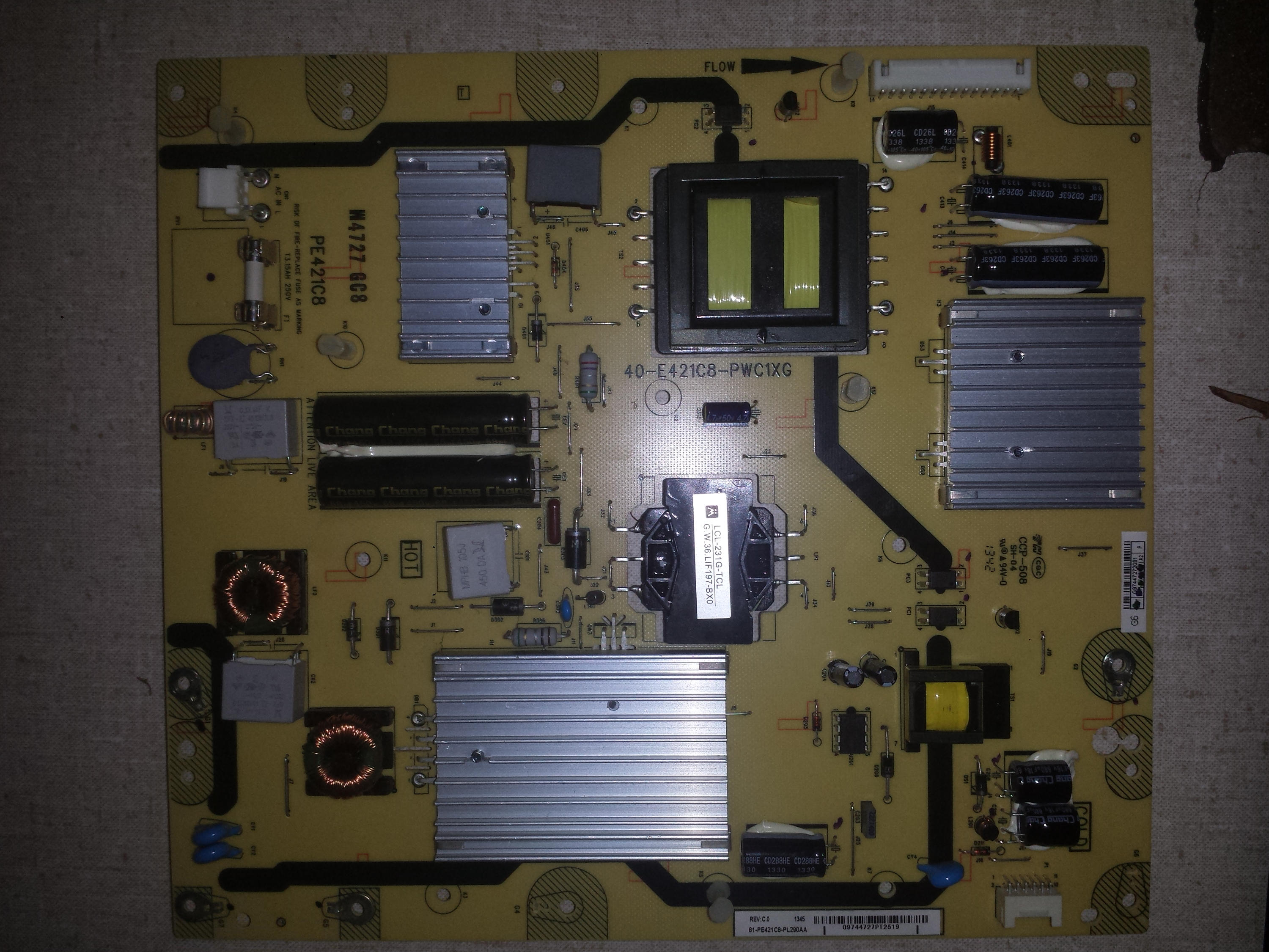

    Symptoms: not turning on.
    PSU: 81-PE421C8-PL290AA REV:C.0 1345
    MAIN: 08-T51F102-MA200AA / 4A-LCD50E-CM1GTA / 08-T51F102-MA300AA / GLZ112791B / 20112053MA0394 / 40-MT51EU-MAE2HG
    Filter Cap Voltage: 393.1V
    BL_ON = 0v
    P_ON = 3.2v
    A_DIM = 0v
    GND = 0v
    24v = 0v
    24v = 0v
    P_DIM = 0v
    GND = 0v
    3.3VSB = 3.3v
    GND = 0v
    GND = 0v
    24V= 0V
    Have tried jumping PS_ON and 3.3VSB same results. Not sure if I would be wasting my time with a recap.
    Did recap 50v 4.7uf cap.
    PFC voltage seems fine.

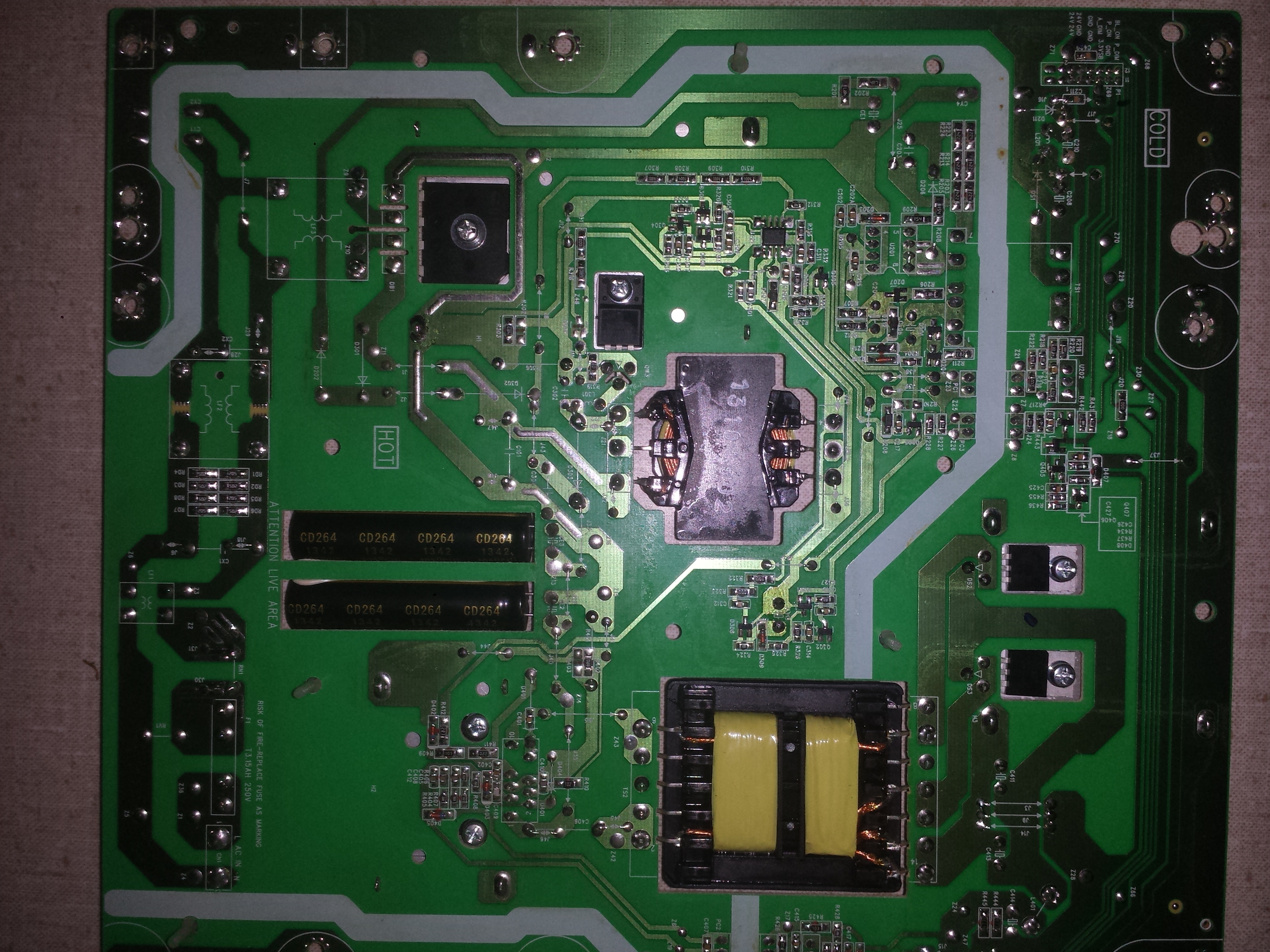

          Here is a photo of the PSU best photo I could get.

              Re: TCL - L50E3020FS not turning on
              Power supply schematic available if you would like to download it.
              https://www.scribd.com/doc/316392645...1C8-PWE1XG-pdf

                      Check your voltages around U401 especially C406, DS2 & DS3. The chip drives the transformer to derive the 24V secondary supply.
                            The PS-ON is working fine otherwise you will not have that PFC Boosted Voltage of 393VDC as reported in post 1.
                            So you need to find out the 24V SMPS U401 has VCC at pin 7 for it to run or not.
                            Also disconnect the load form the 24Vdc out connector to see if the 24V will come up.
                            BTW, the main board is not sending the BL-ON and the Dim signals either.
                                The thing is when you have all the connector back in place you do have the PS-ON but not the BL-ON or the dimming signals which indicates that you also have main board problem, but then it can be due to no 24V so those two signals may be locked out.
                                At this point, it is the 24V power supply section that needs to fixed first.
                                16V for VCC may be OK but I do not know until we get the spec sheet of that U401 to find what the minimum Voltage requirement is.
                                I see the gray rectangular cap laying on its side next to the heatsink of the U401, lift one leg off the board and check its capacitance and report what the Value of that cap is as measured and as printed on the cap. You may have bad U401 also.
                                Did you already check the caps and diodes on the cold side of that 24V supply? Also check the small lytics cap laying on its side next to that 24V transformer.
                                      Hey checked my voltages around C406 and it came back with 390v's
                                      DS2v & DS3 had no voltage in these places. on pin 1 and pin 3. so i would assume pin 2 to have no voltage either.
                                      Is this a bad transformer as its looking that way now.
