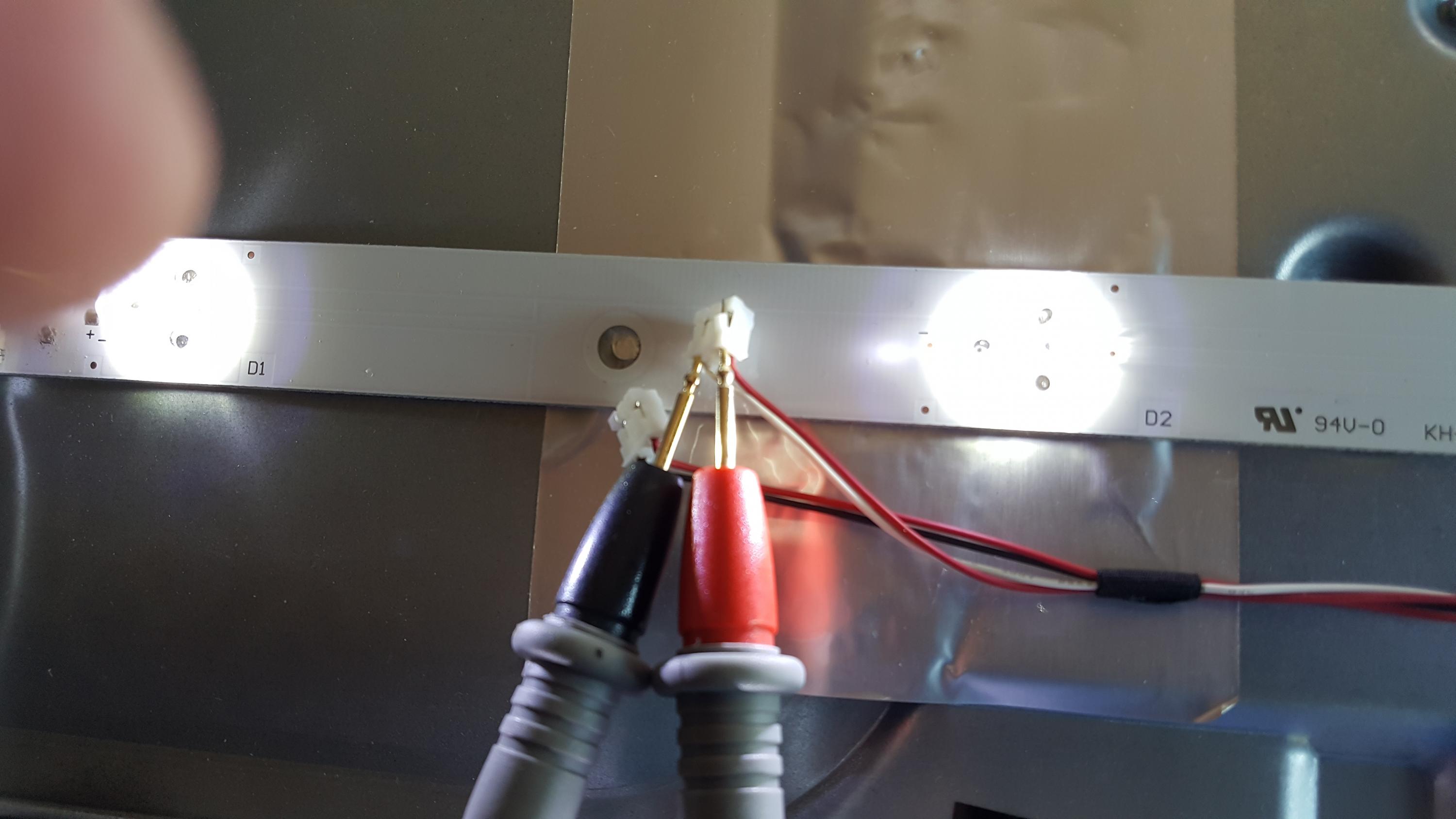

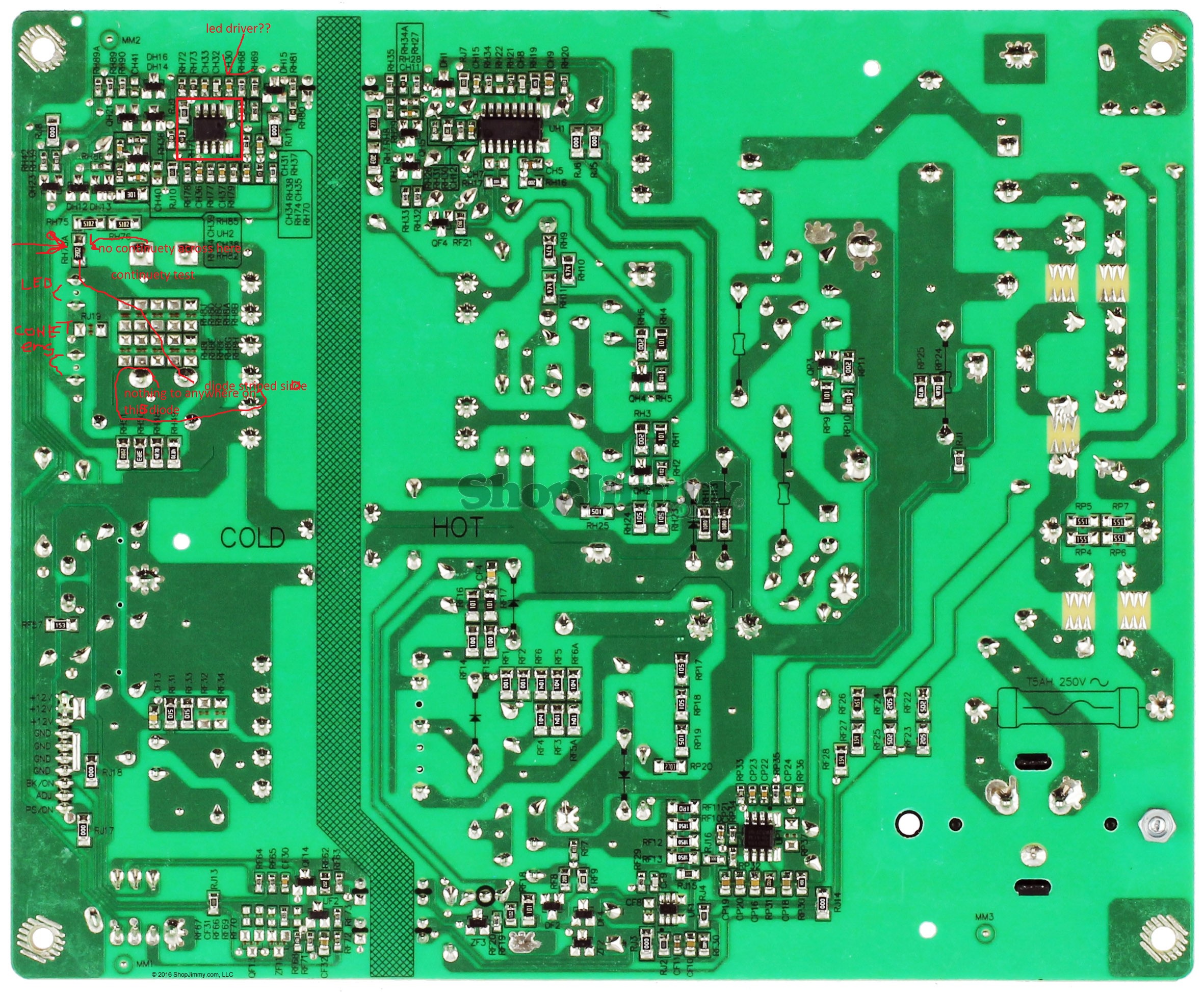

      Re: Hitachi LE55A6R9 LED Issue or?
      Originally posted by LITEZONER
      well this thing is wearing me out, Led tester on red and black string wires all led's light up, no voltage coming from terminal with red/blk wires, so i think LED driver circuit not working, checked all voltages across terminal plug and get all 12V and 3V working fine, Not sure what to check next.,
      Are the two diode connected to the led output connector. They may be connected via 0 ohm resistors. Cannot tell from the pictures but you say you have no voltage on the red/black wires but 267V on the diodes which I would have though would be the led supply.

          #44
          I get continuity at the depicted places, not sure about 0 ohm resistors not even sure why there would be such a thing as a 0 ohm resistor???
          39 Soldering Iron burns And Counting

                • jetadm123
                  • 2169
                  #48
                  0 ohm resistors are generally used as a jumper.

                        #51
                        chassis ground-/ pos + to terminals
                        Top red wire = 267 V
                        Blck wire = 187 V
                        Red wire = 187 V
                        White wire = 0 V
                        The LED string with Red/White wire does not look right. Did you use the LED tester to test both LED strings by applying the tester to each LED connector?

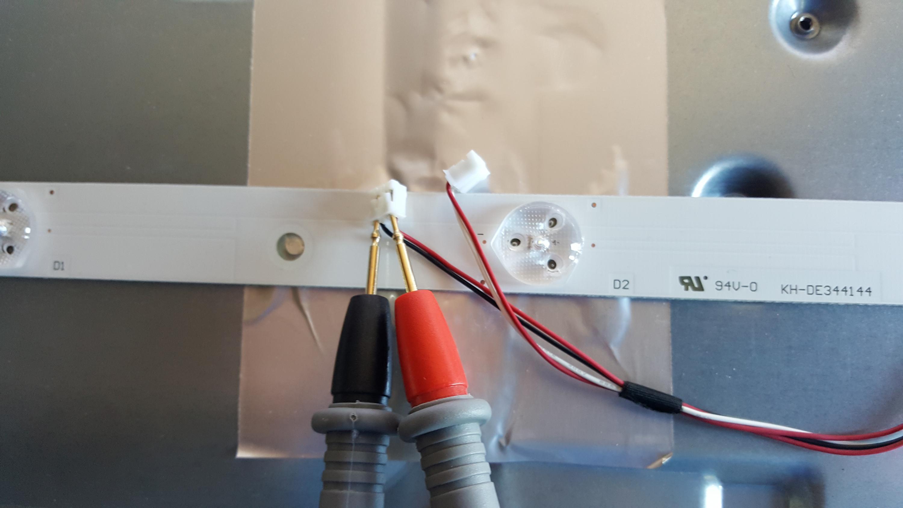

                          #52
                          I put POS+ and NEG- across red and black, and panel lights up??? should I test each wire with ground to chassis?

                              #54
                              But how about the second LED string, the one connected to the Red (Anode) and White (Cathode) Wires?

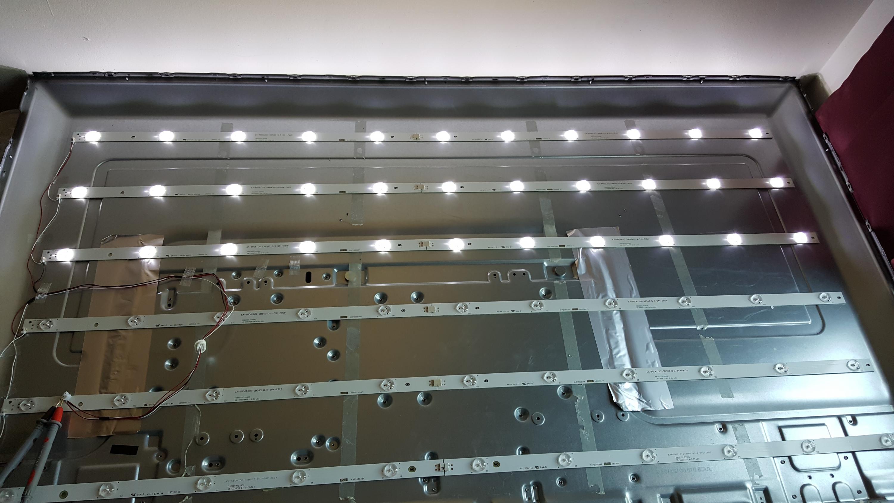

                                • LITEZONER
                                  GO BOLTS!
                                  • Mar 2010
                                  • 223
                                  #56
                                  whole panel lights up only with led tester probes on red and black wires, red and white does nothing when led tester probes are placed on these two
                                    #57
                                    Well, that means the LED string connected to the RED/WHITE wires is dead, you have two LED strings connected in series as you can see how they are connected by looking at the bottom side of the board where the two LED connectors are.
                                    https://www.badcaps.net/forum/attach...5&d=1498188398

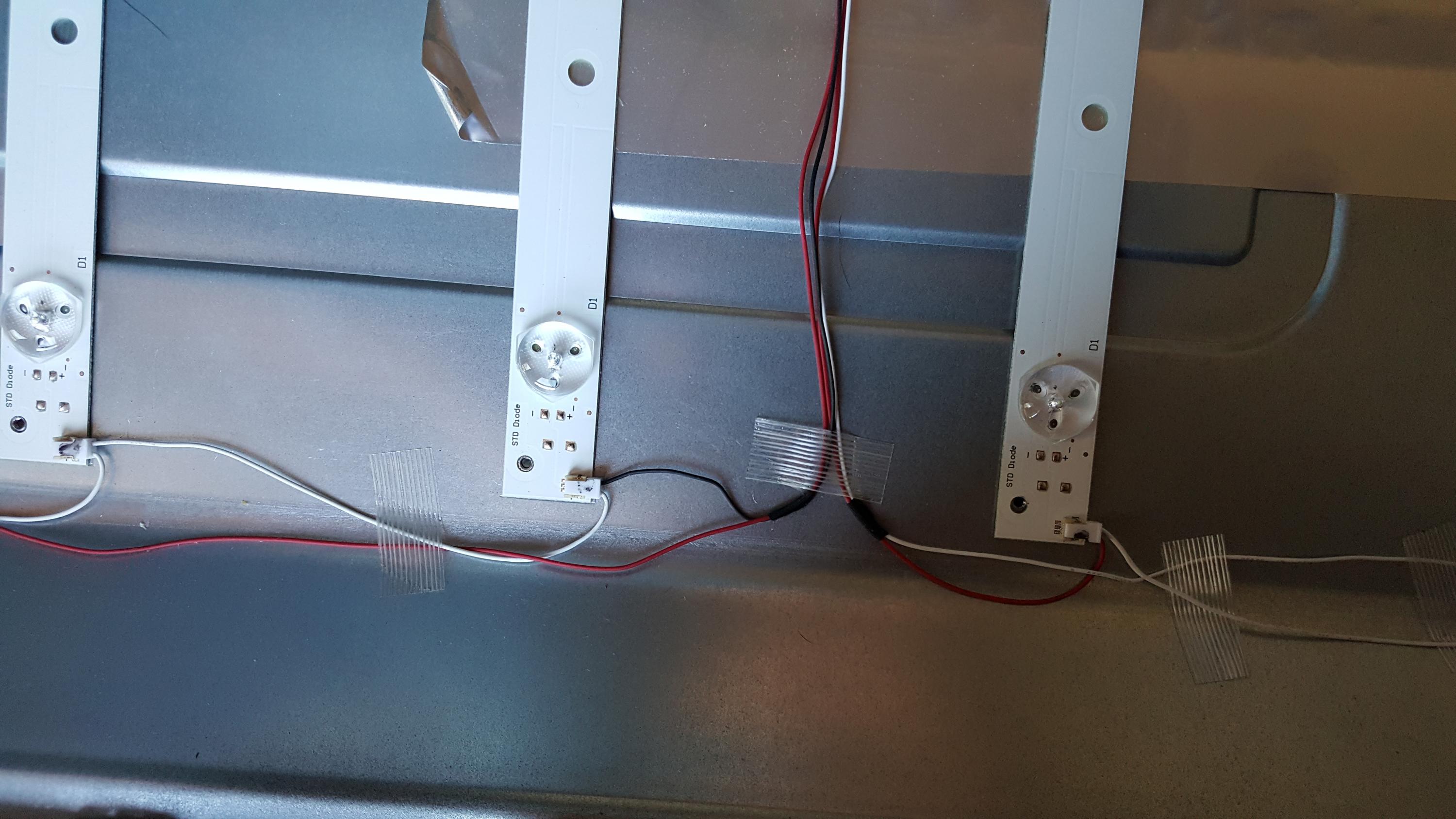

                                        #59
                                        I wanted to show how these wires R/B and R/W go to the led's

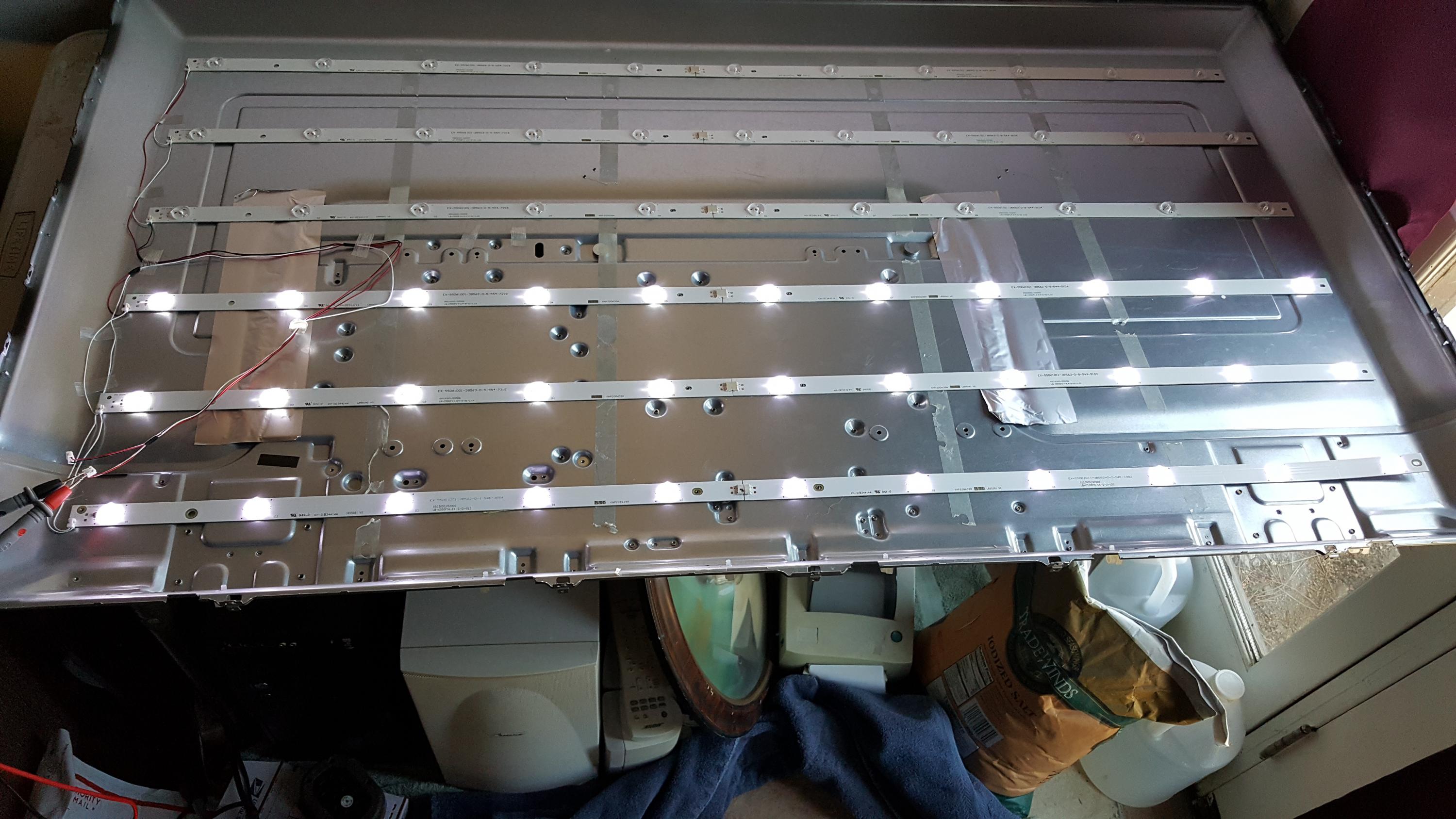

                                        • LITEZONER
                                          GO BOLTS!
                                          • Mar 2010
                                          • 223
                                          #60
                                          well perplexed a bit, every led on the string that would not light tested good individually, but the string would not light as a whole, I replaced it with a used one i had from the old set, now were cooking i think, will post final results when assembled and working. remember, this was a brand new set of LED strips ordered from a reputable company, SJ, Lesson here, TEST,TEST,TEST, even if it is brand new, it would have taking me a few seconds to check this before spending all the time. trying to figure this thing out, assembly, disassembly, and wasting other folks time as well. Valuable lesson learned here.
