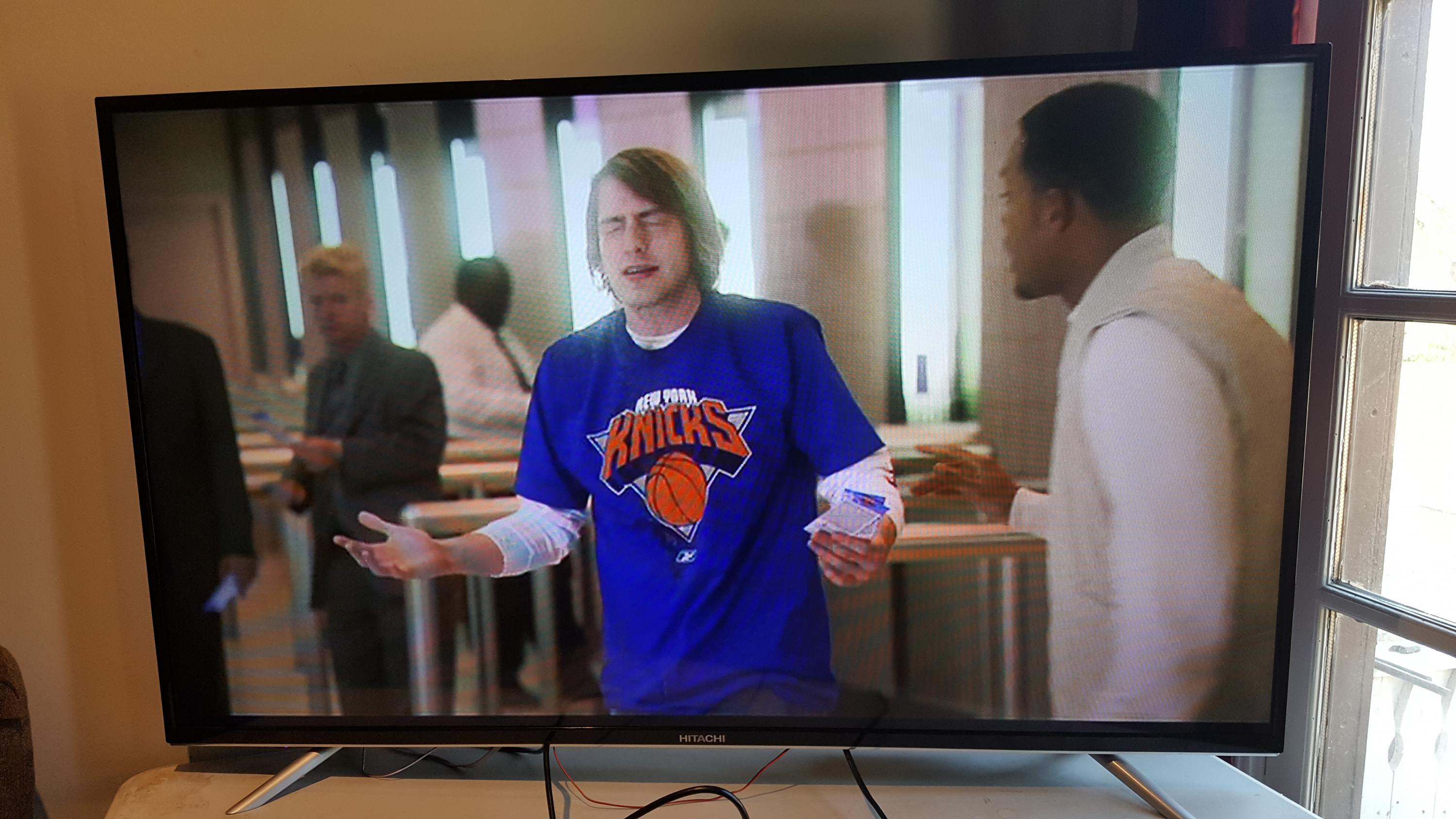

    Re: Hitachi LE55A6R9 LED Issue or?
    PS Pretty good pictures right? LOL
    39 Soldering Iron burns And Counting

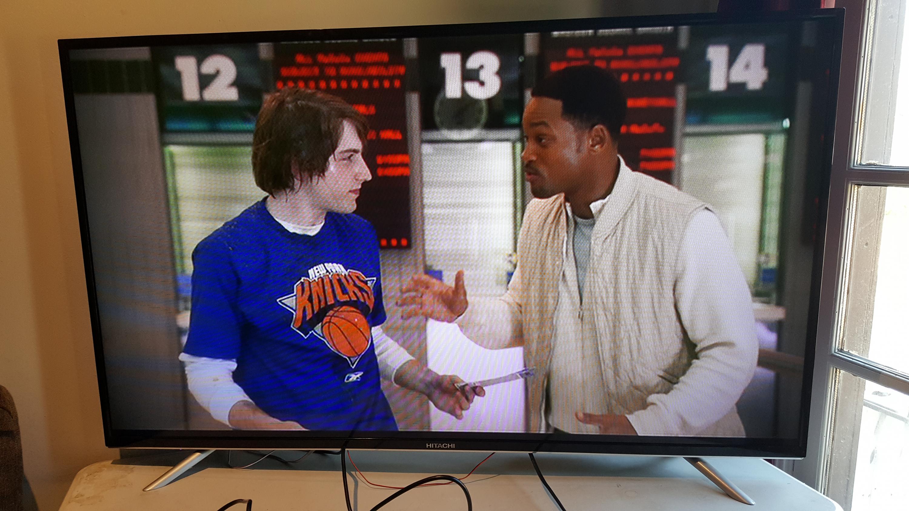

      #62
      1/2 hour in.
        #63
        The new set of the LED may have bad solder joints on the connector pins that join the two strip together.
        Glad to see it is working.
