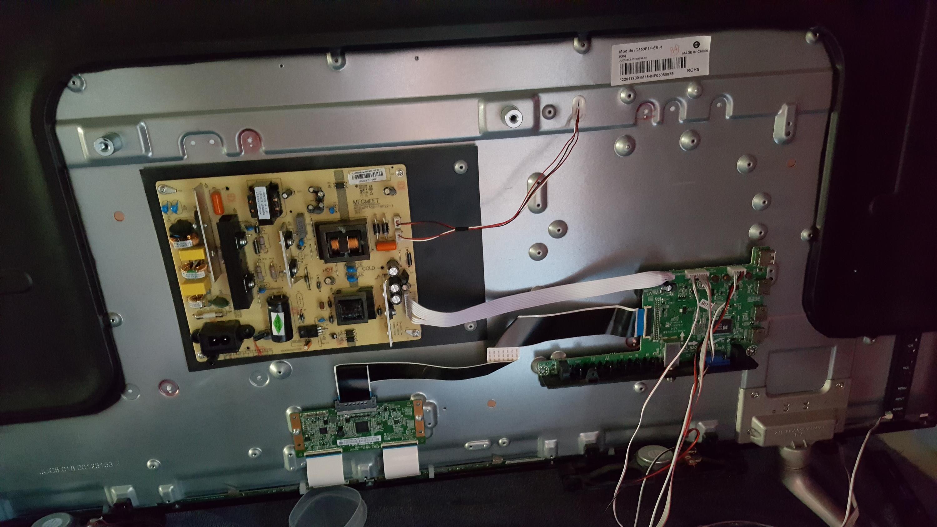

Hitachi LE55A6R9 LED Issue or?
  • LITEZONER
    GO BOLTS!
    • Mar 2010
    • 223

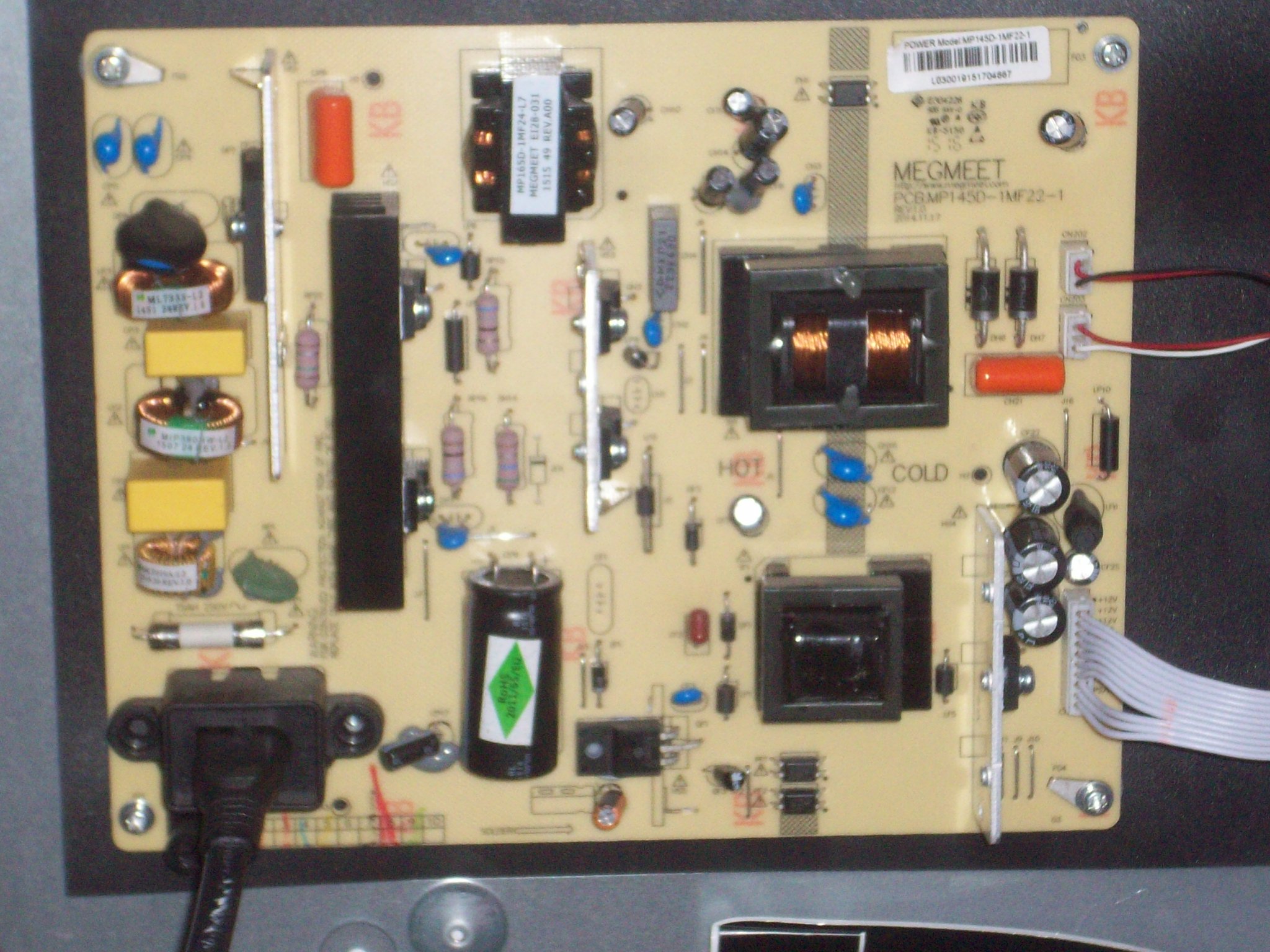

    Re: Hitachi LE55A6R9 LED Issue or?
    starting strings do not light up, they are the ones with the A7, if i disconnect the trailing string the trailing string will light up by it self, but the leading strip, the one with the connector to Power board will not light up as a string, only when i test each LED individually they will light up, so the A7 is blocking current to the entire string, Only the trailing string will light up all by it self with the tester, the leading string will not.
    39 Soldering Iron burns And Counting
    • dick_barton
      • Aug 2015
      • 6642
      • Wales
      If you test using your meter set in diode mode ( --!<!-- ) does A7 look like a diode. High one way, 0.5 the other way?
      • LITEZONER
        GO BOLTS!
        • Mar 2010
        • 223
        yes testing in correct polarity I get a high reading, I reverse the leads and get an open, this seems normal to me for a diode?
        • dick_barton
          • Aug 2015
          • 6642
          • Wales
          No. If it was a diode you should read 0.5 (approx) showing on your meter if it is set to diode mode when the probes are across it in one direction but high/open when you swap the probes.

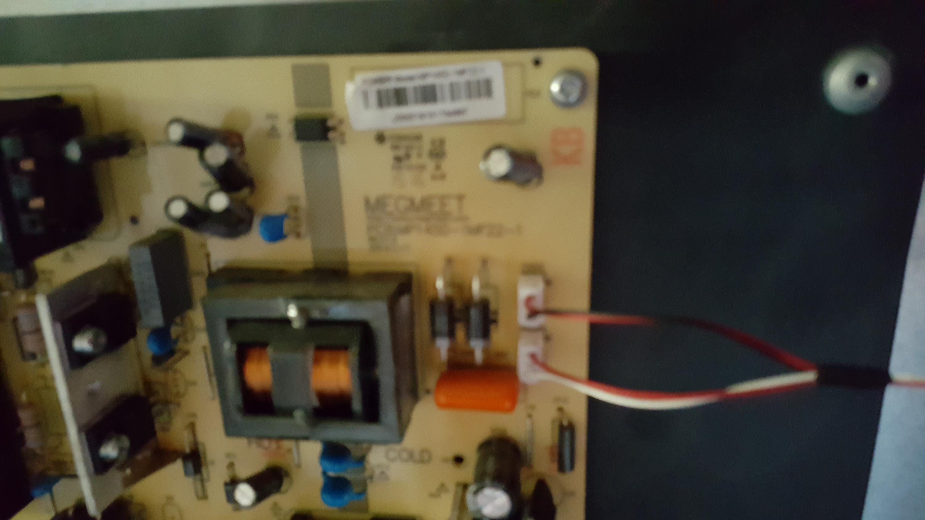

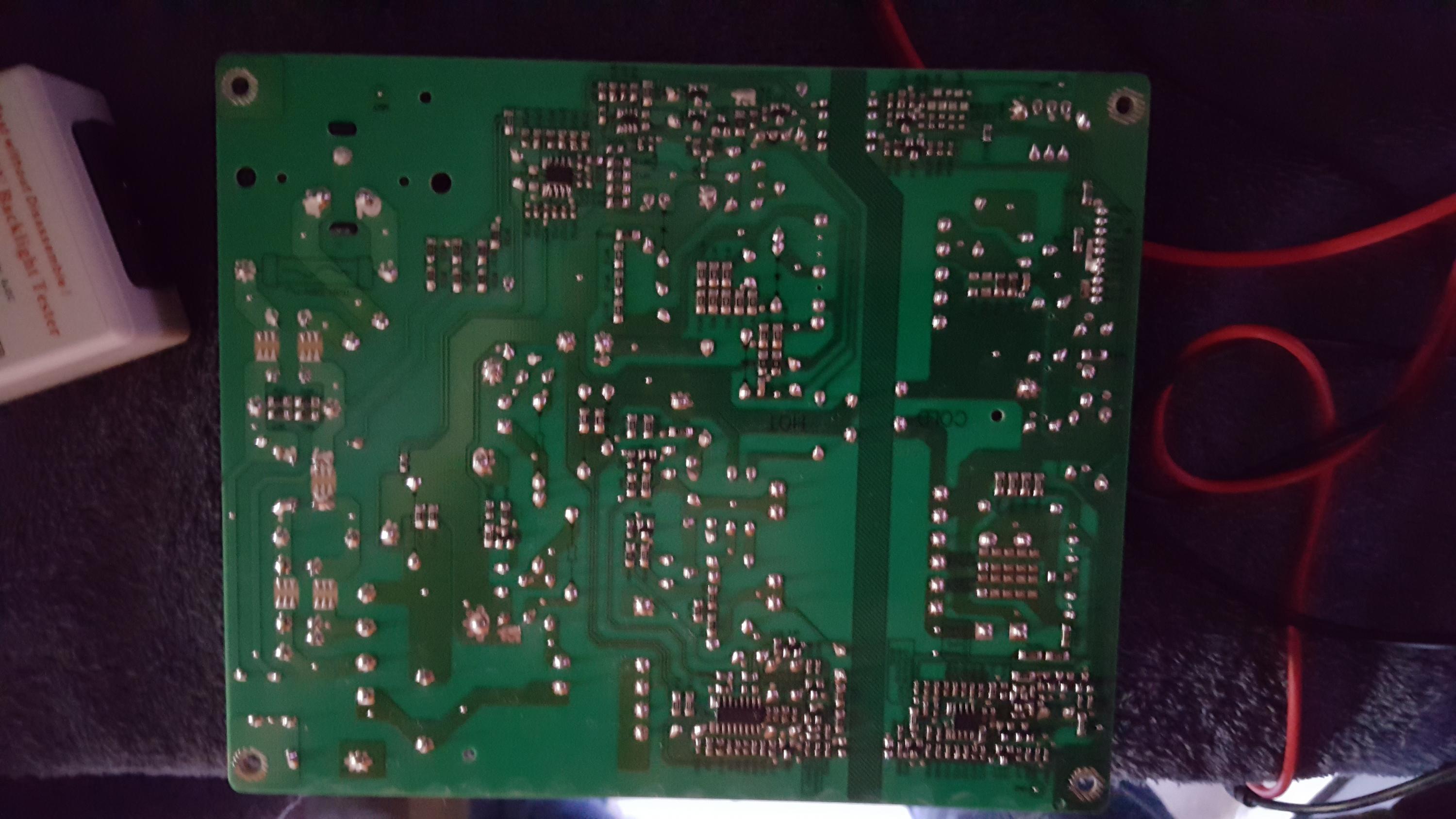

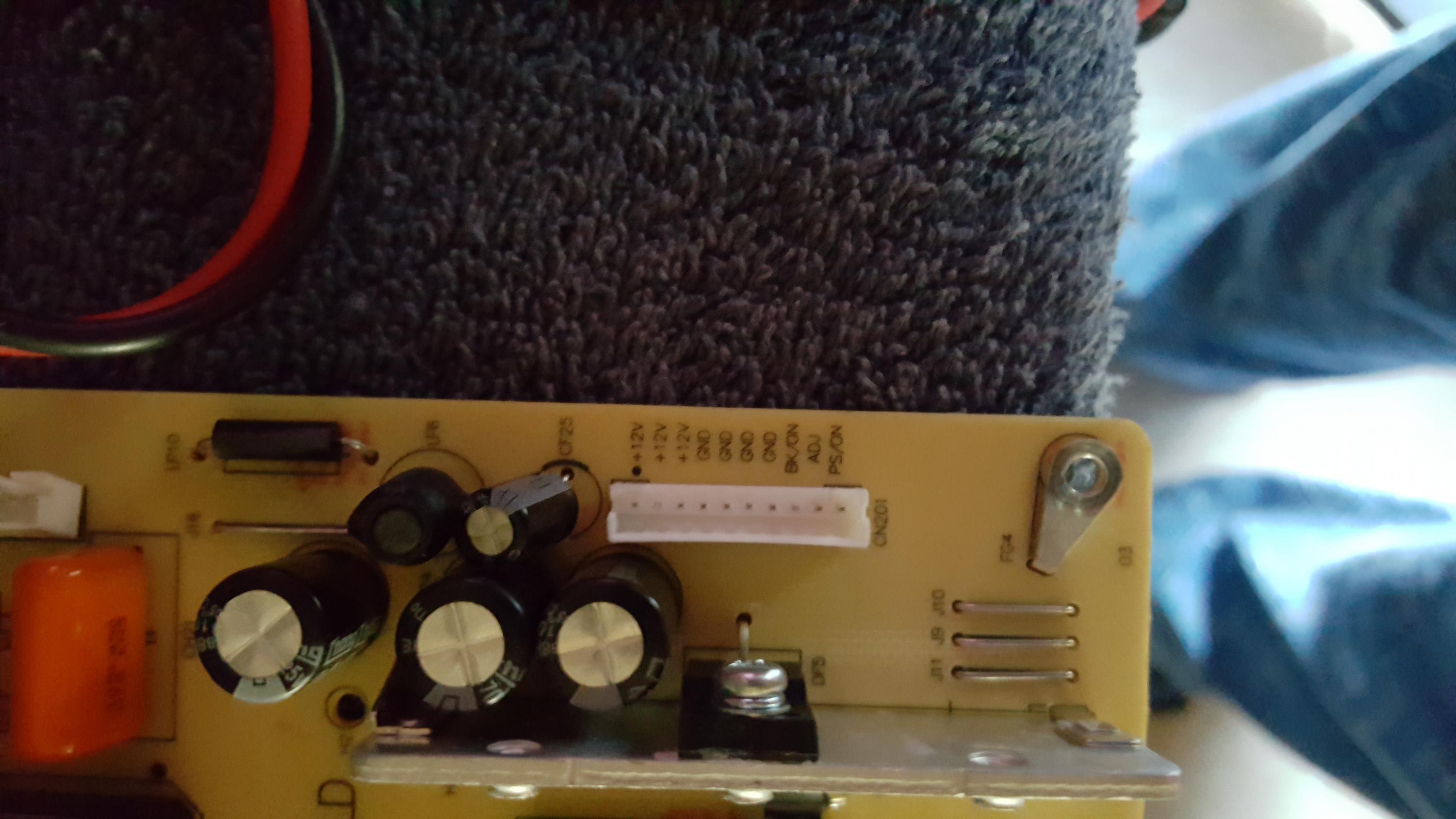

                        #31
                        well this thing is wearing me out, Led tester on red and black string wires all led's light up, no voltage coming from terminal with red/blk wires, so i think LED driver circuit not working, checked all voltages across terminal plug and get all 12V and 3V working fine, Not sure what to check next.,

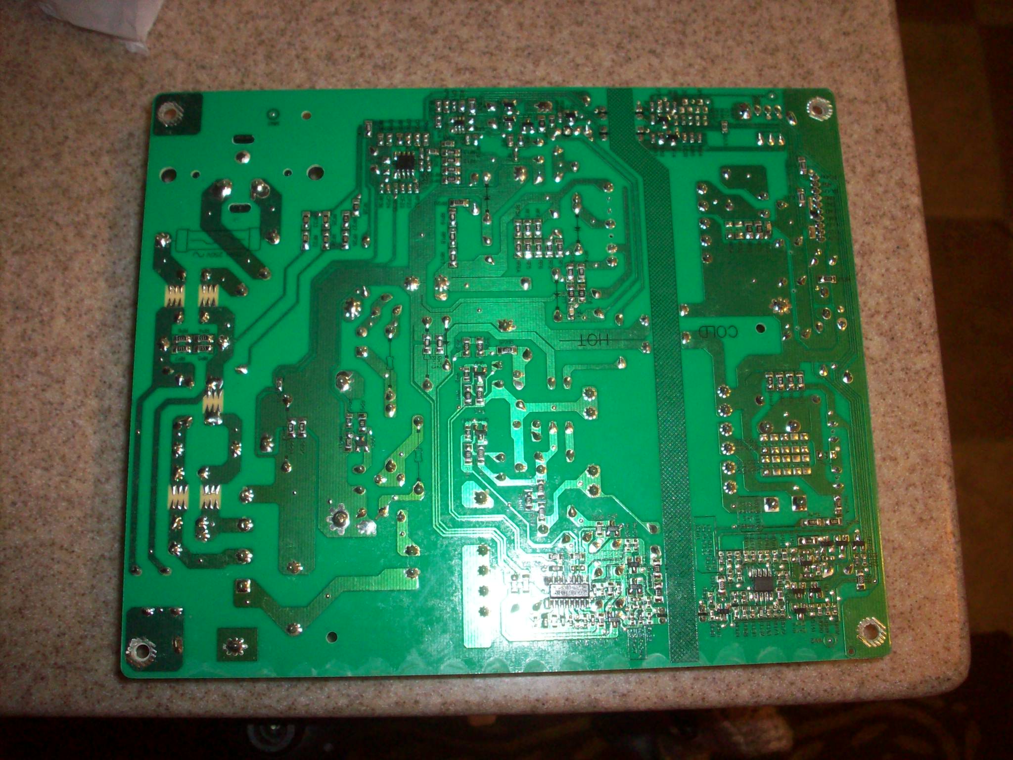

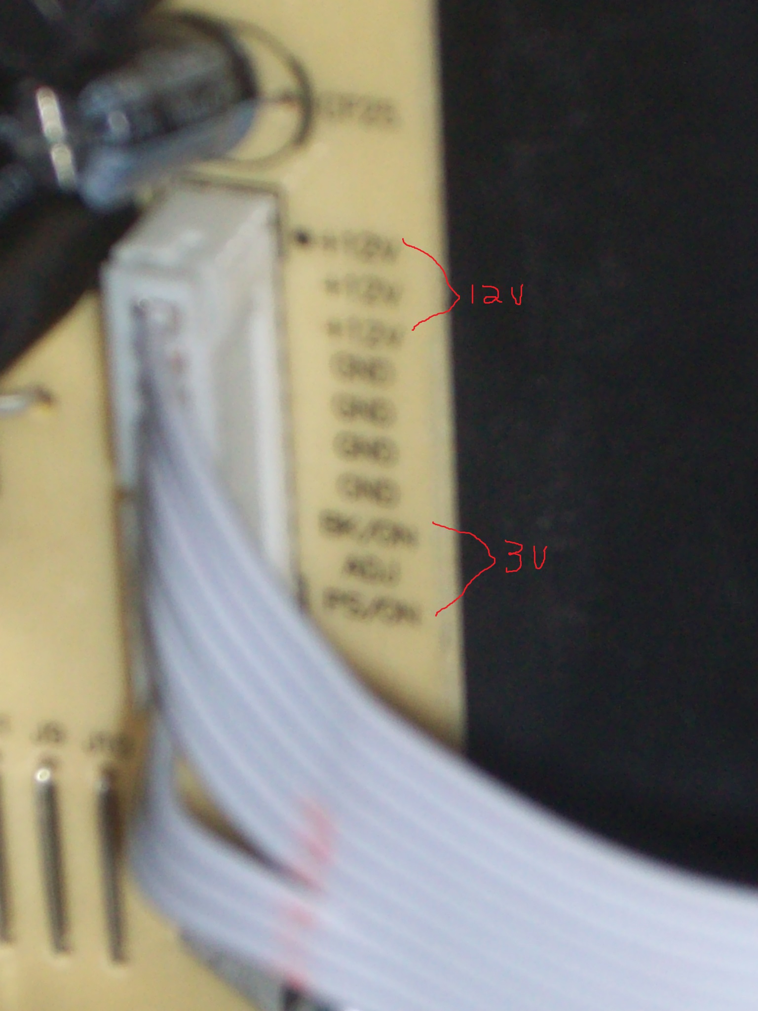

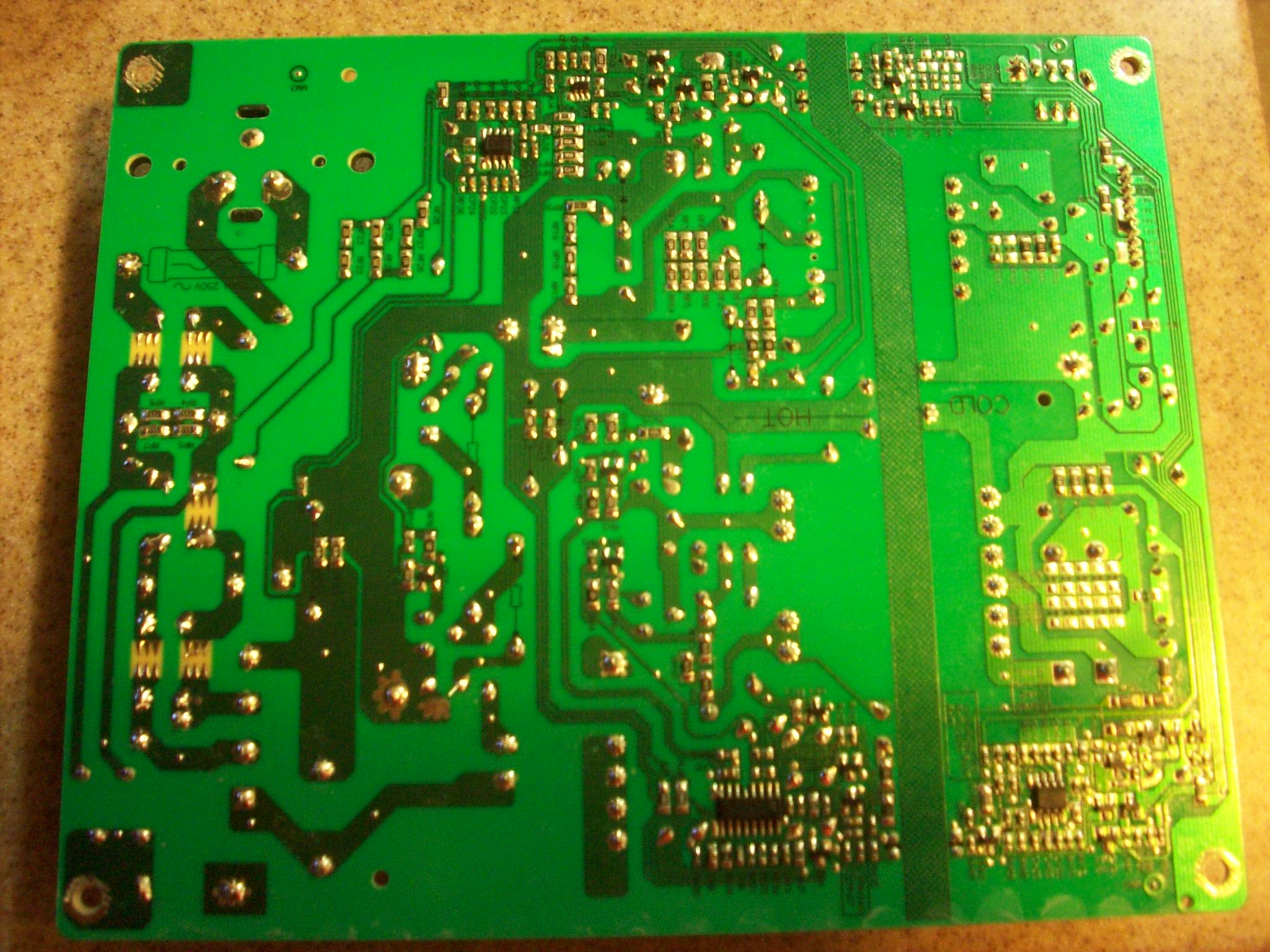

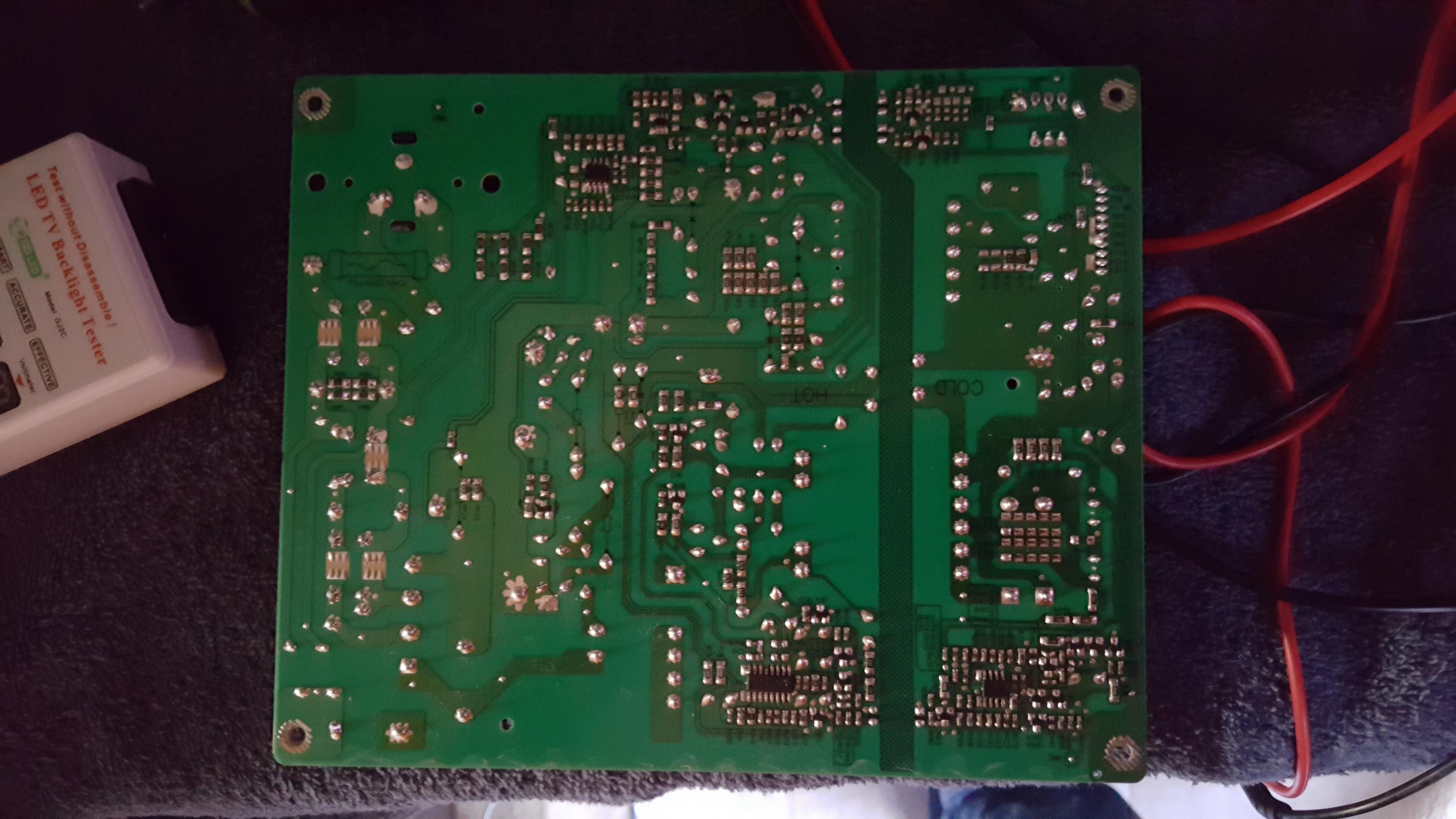

                          #32
                          https://www.badcaps.net/forum/attach...1&d=1498093933
                          Man! Can you take better pictures, they are blur and I cannot read any labels of the pins? I also need good CLEAR straight shot of the bottom side of that power supply board (pictures in post 5 are not clear enough to trace the circuits) and also pictures showing the whole backside of the TV so I can see all the boards.
                          • dick_barton
                            • Aug 2015
                            • 6642
                            • Wales
                            #33

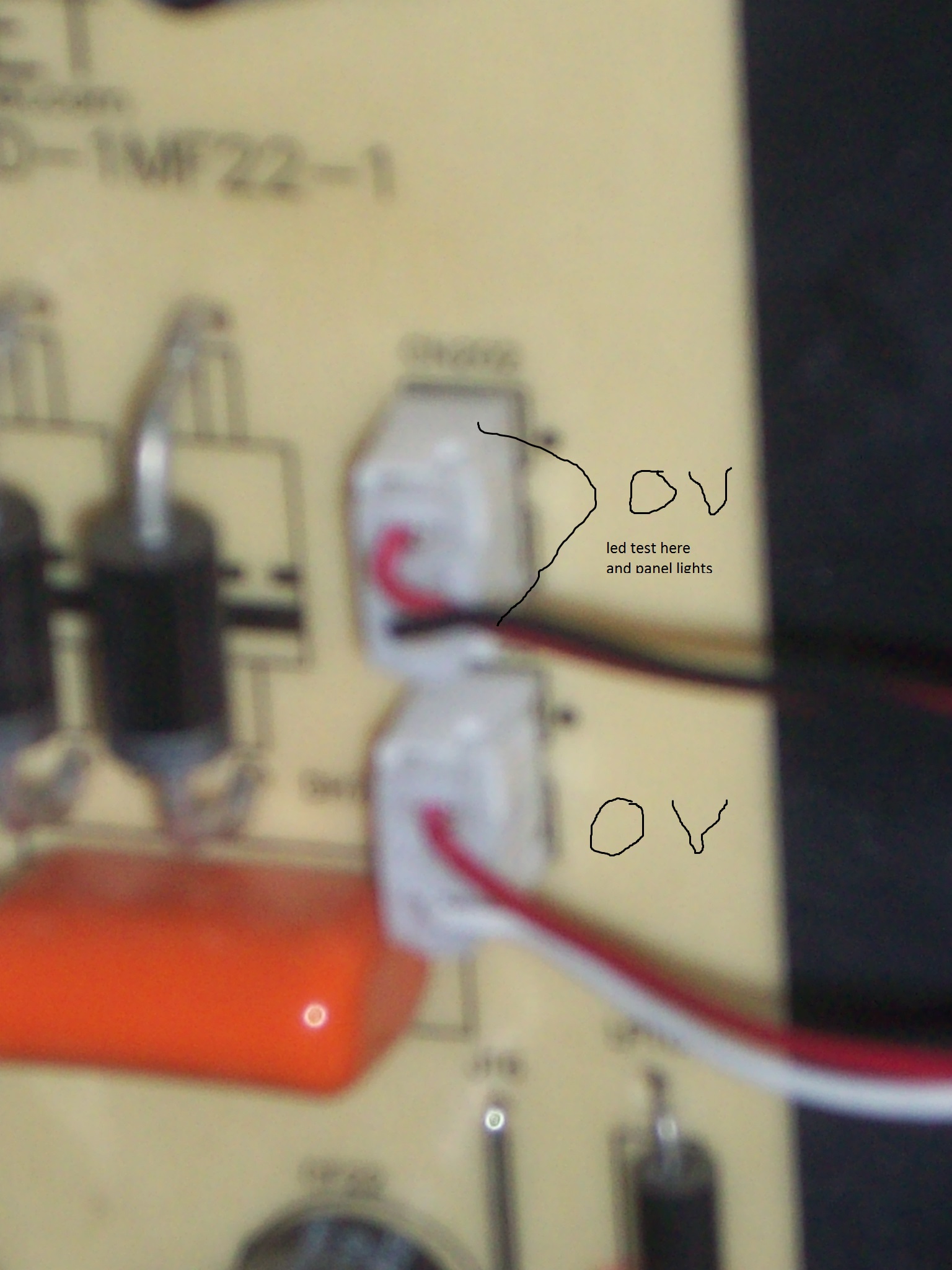

                            What voltages do you have at the diodes either side of which are next to the led connectors. Worth checking they are OK with meter in diode mode.
                            • LITEZONER
                              GO BOLTS!
                              • Mar 2010
                              • 223
                              #34
                              diodes seem good there, current one way or open, and 4-5 in diode mode the other. here are some hopefully better pictures.

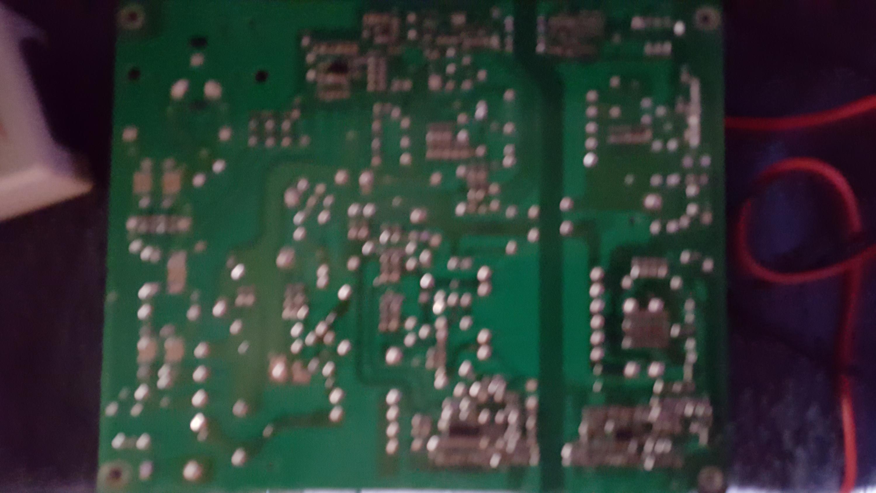

                                #35
                                No way I am going to be able to use those pictures to trace out the circuits.

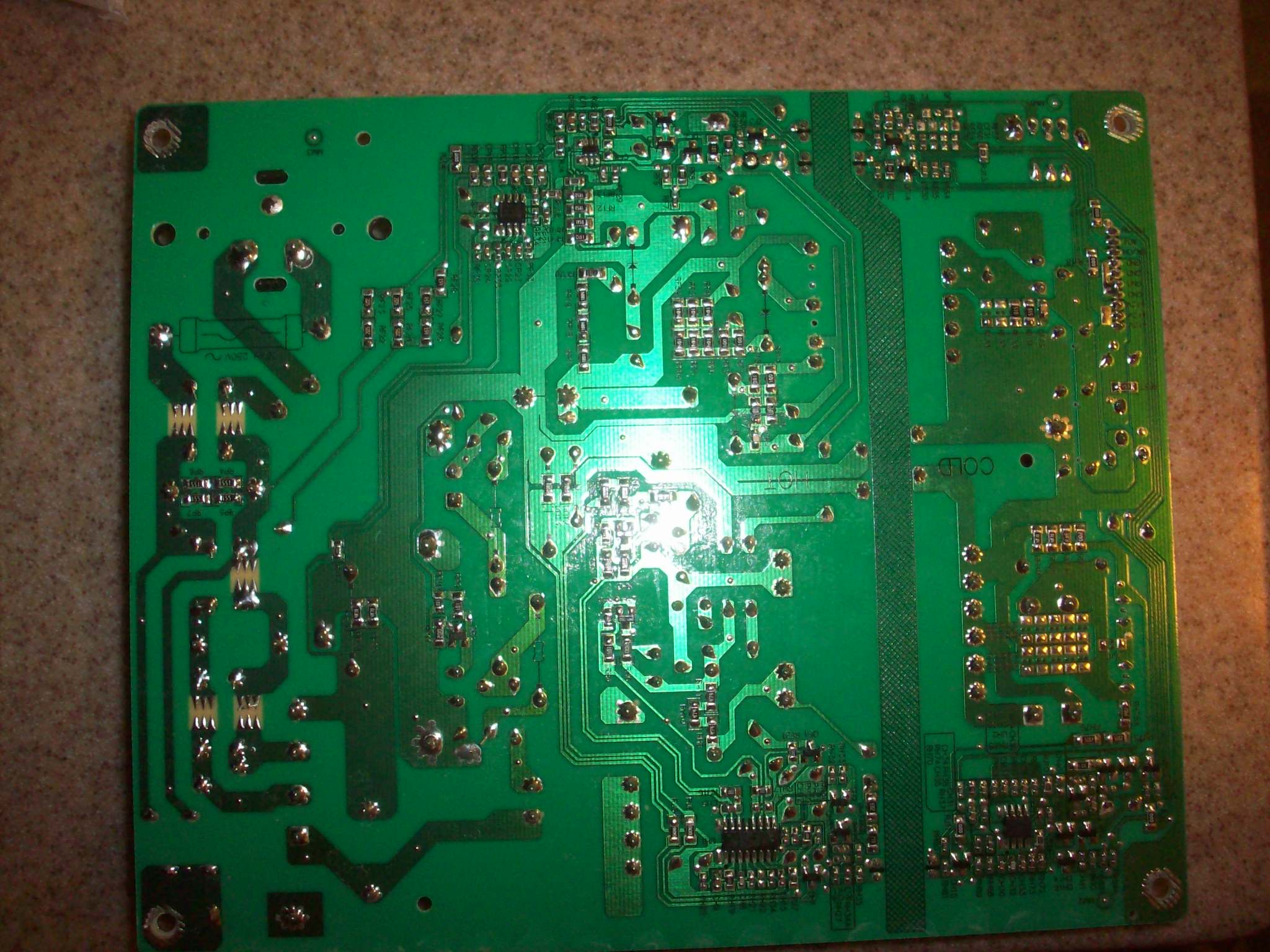

                                  #36
                                  Yes, but what voltages did you have?
                                  • LITEZONER
                                    GO BOLTS!
                                    • Mar 2010
                                    • 223
                                    #37
                                    I have to get a better picture for you, voltage from the diodes? just across anode and cathode?
                                    • LITEZONER
                                      GO BOLTS!
                                      • Mar 2010
                                      • 223

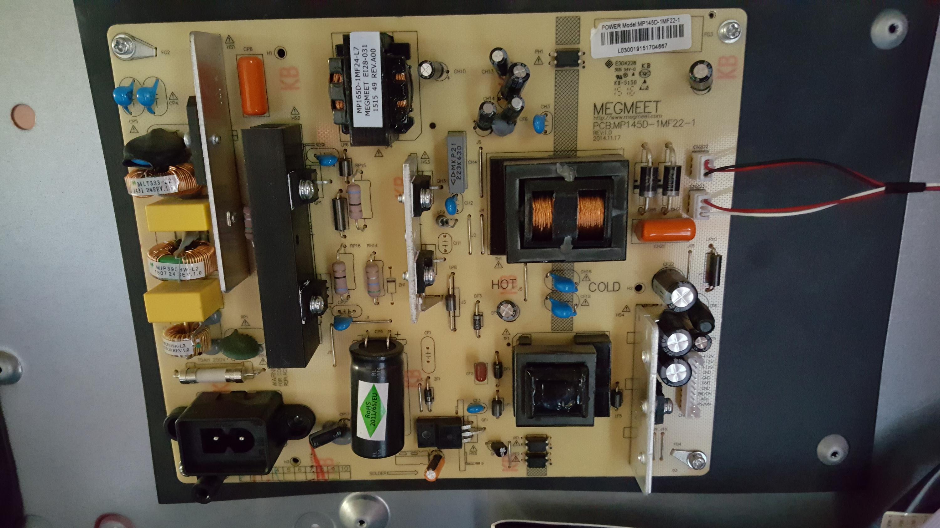

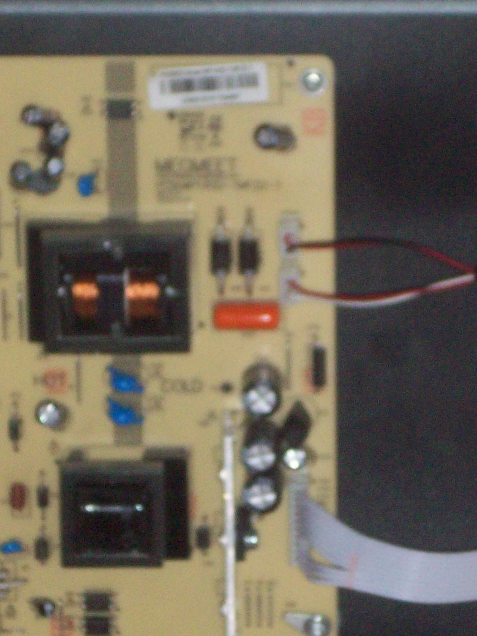

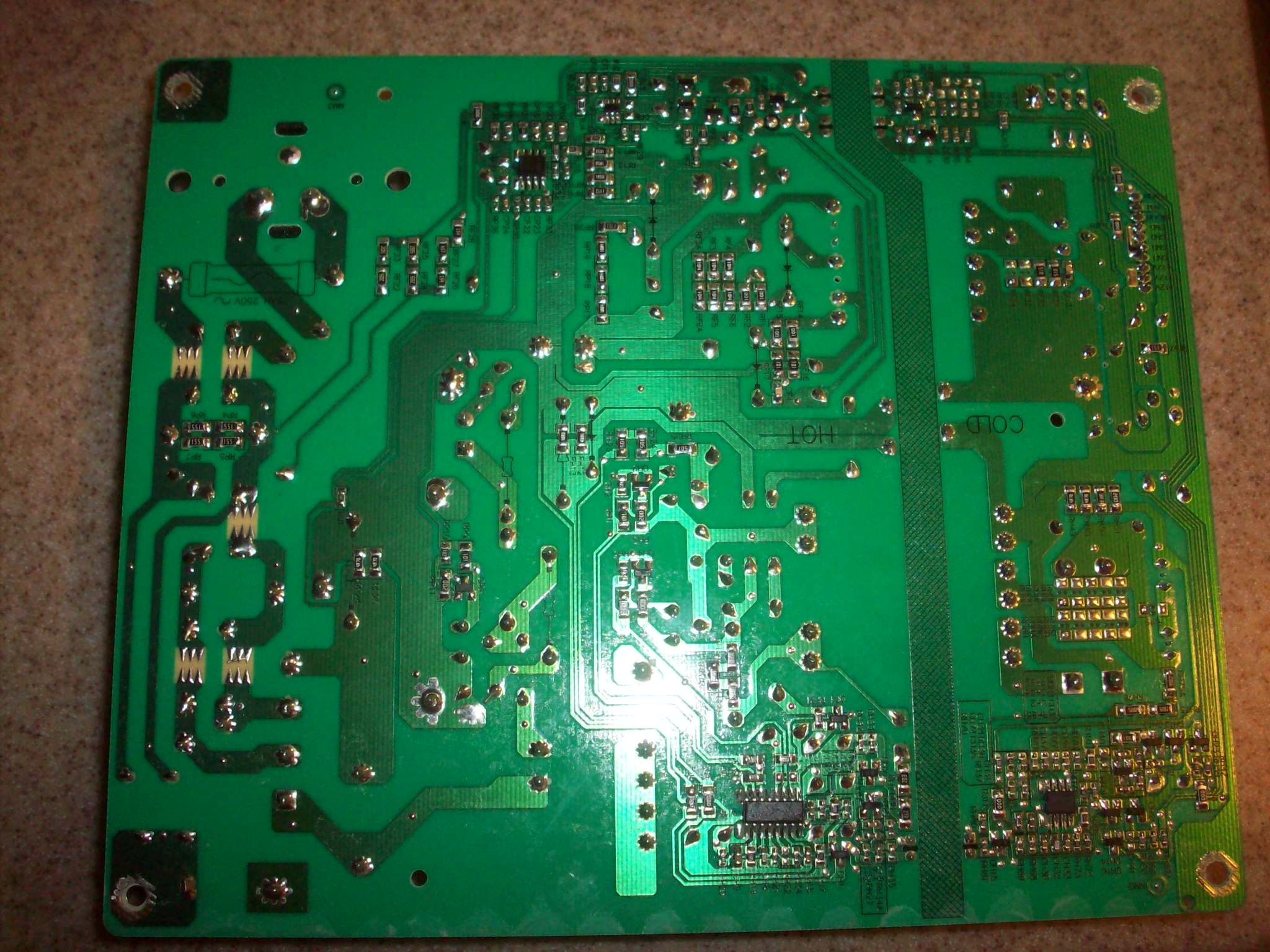

                                      #38
                                      pics
                                      • LITEZONER
                                        GO BOLTS!
                                        • Mar 2010
                                        • 223
                                        #39
                                        thinking this one is the best.
                                        • dick_barton
                                          • Aug 2015
                                          • 6642
                                          • Wales
                                          #40
                                          Chassis to diodes.
