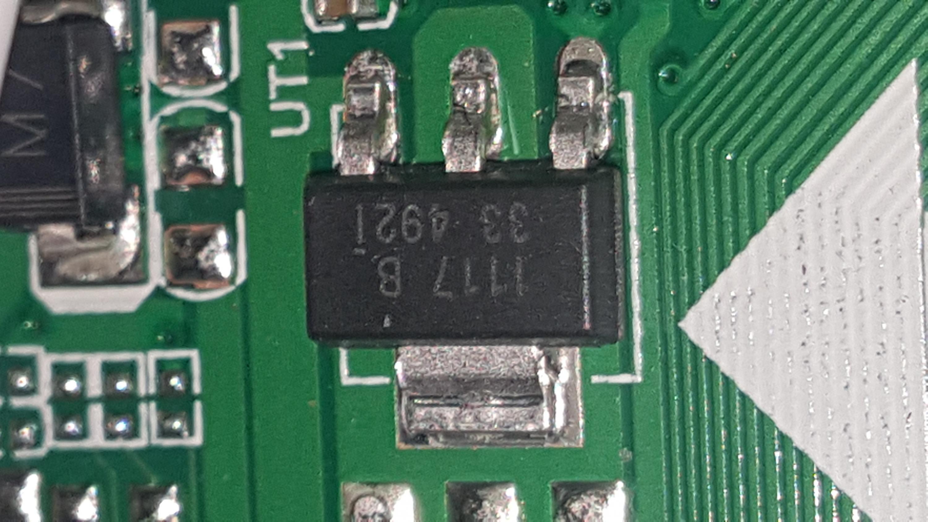

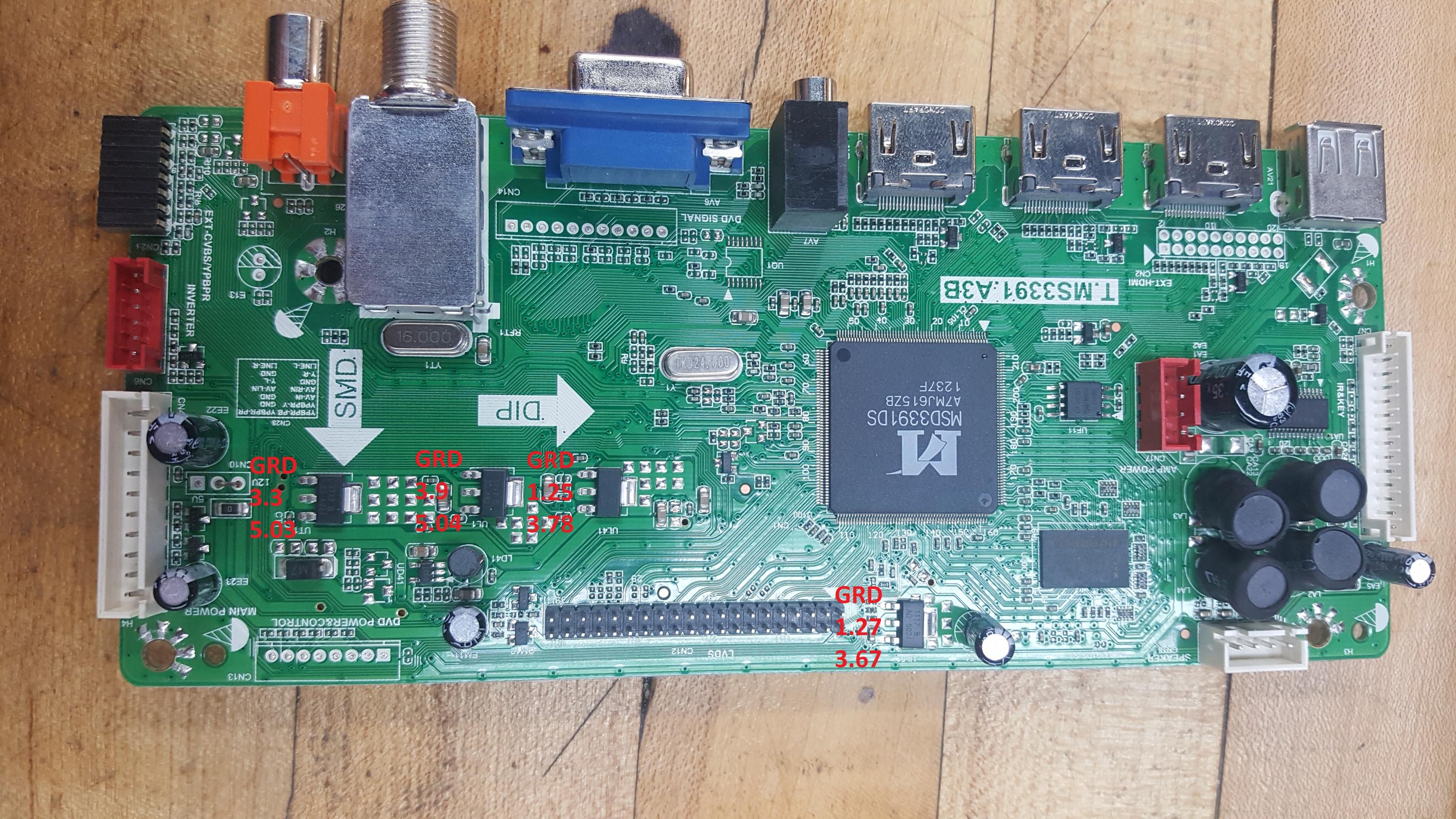

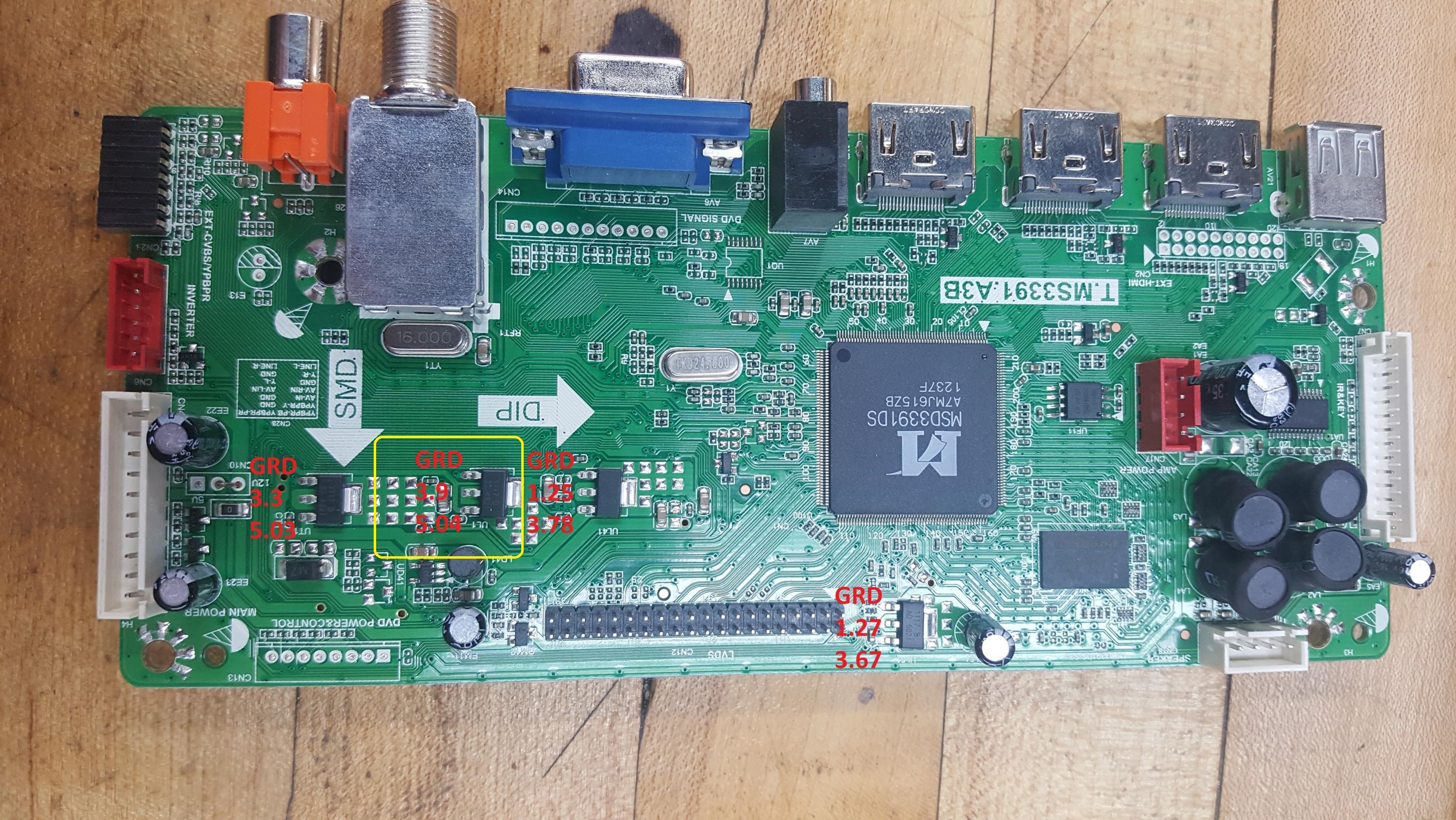

      I checked the fuse and it was good. Here is the readings from the regulators.

        this looks like an adjustable regulator, so output should be 1.25v above ground voltage.
        if it is a 3.3v regulator, (can't read bottom line on ic) then it is out of spec as well.

            Re: Proscan LED 32" TV not working.
            Looks like input to first reg. 5.03v and input to third reg. are from same trace but different voltages.

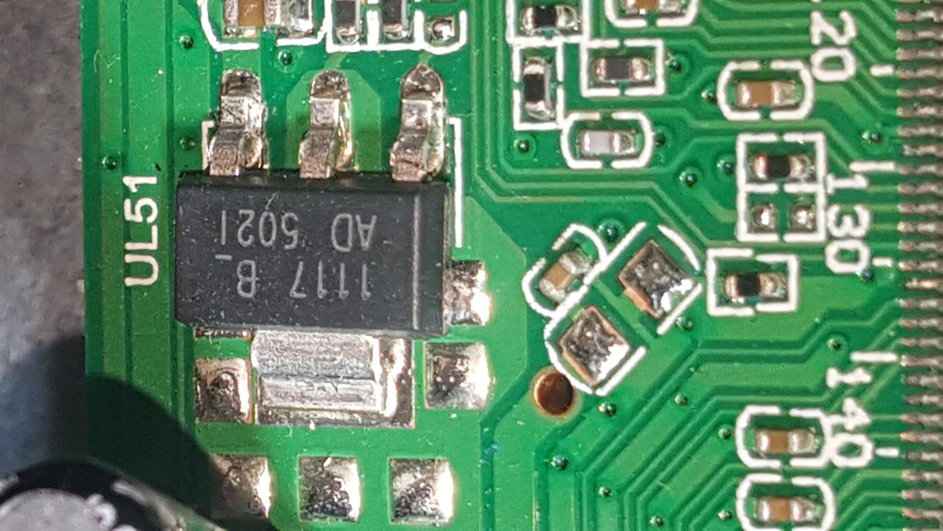

              Sorry its been a few days. Here is what i have so far. BTW the fuse was good. Zoom in to see the readings.
                  well, you will need to change out that regulator to start with.

                    which regulator are you talking about? Why? I'm not arguing, I'm just trying to understand/learn.

                      #30
                      the one i marked earlier as being out of spec.

                        gotcha thanks. I overlooked the thumbnail.

                          with that 3rd regulator it does seem odd that the trace at the left regulator is 5v but when it reaches the third regulator on the same trace its down too 3v volts so yes maybe double check voltage readings if still odd maybe change the regulator
