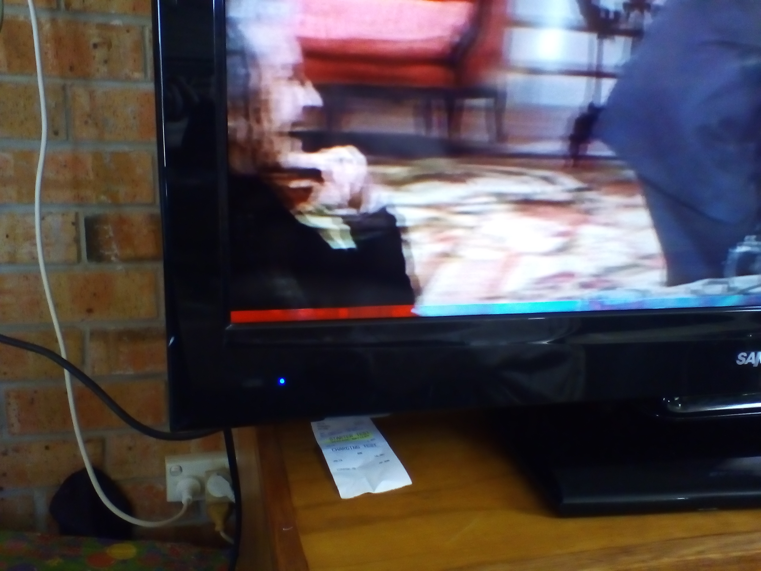

    Given this 2011 set with logo coming up but inverter switching off. Cheap new inverter sourced and fitted. All good and I play DVD to test - while this was going after about 15 minutes the picture jumped a little with audio out of synch but then stabilised within 30 seconds leaving a thin horizontal area of discolouration right across bottom of screen as per pic. I don't have the experience to make a quick diagnosis so asking the question to those that do. Thanks in advance.

    give the bezel a slight twist and see if it effects the picture at all.

      I assume you have tried different inputs besides dvd.

        Sorry yes have twisted bottom bezel and used HDMI and AV inputs both with DVD and remote signal receiver from TV retransmitter.

          I think you have a T-CON issue. Does this TV have a separate T-CON Bd that you can disconnect one side and do a test or is the T-CON part of the Panel? Pictures please so we could see what we are dealing with?

            Thanks for that yes it is a dedicated tcon and my first choice. Won't be able to get back to this set now for a few weeks as travelling away.
            Prime thought is why did picture play up with loss of audio synch when all going well on face of it??
