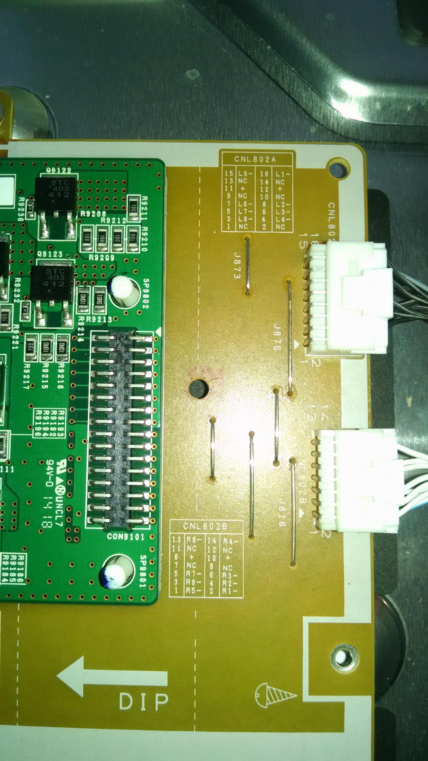

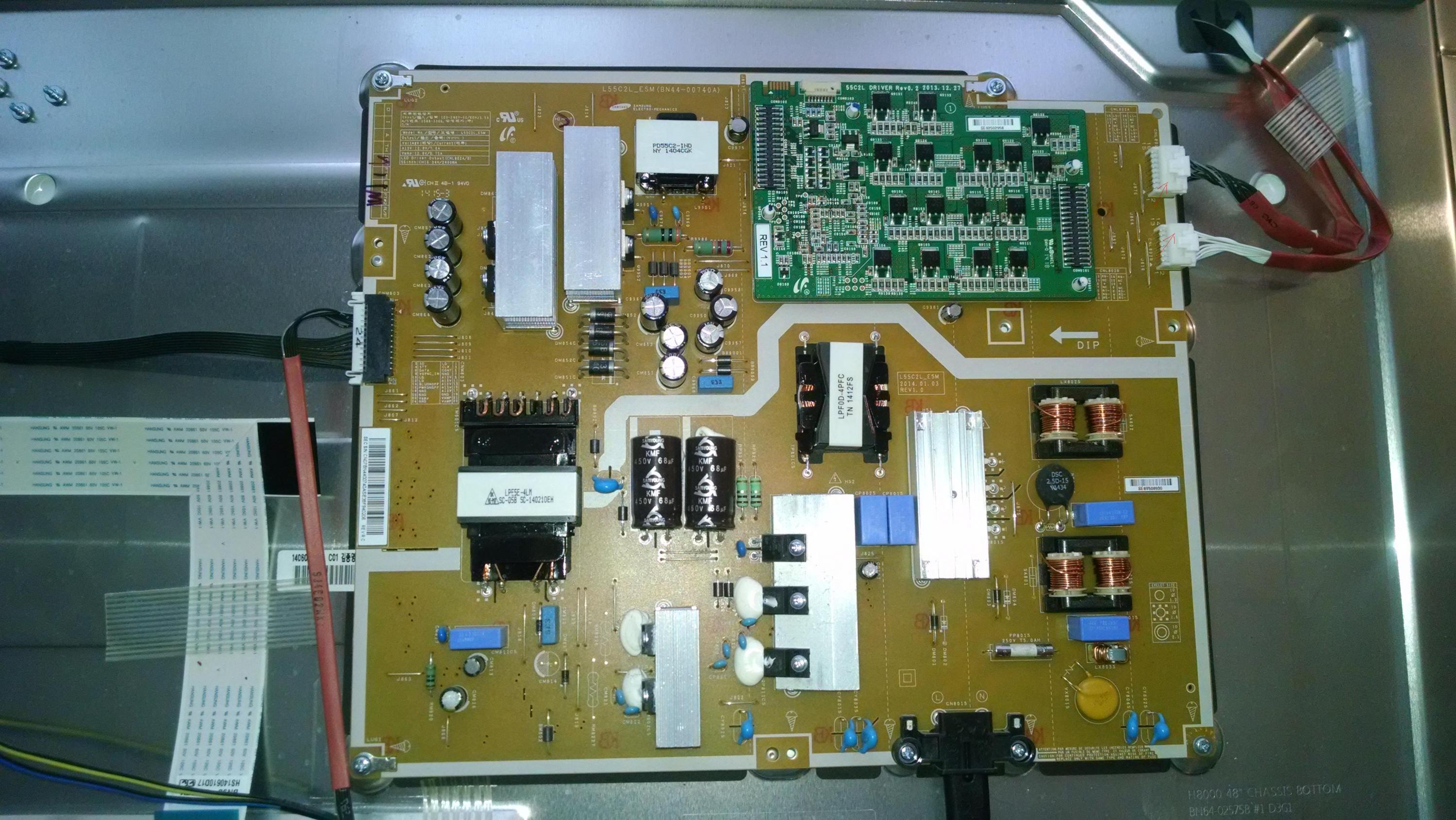

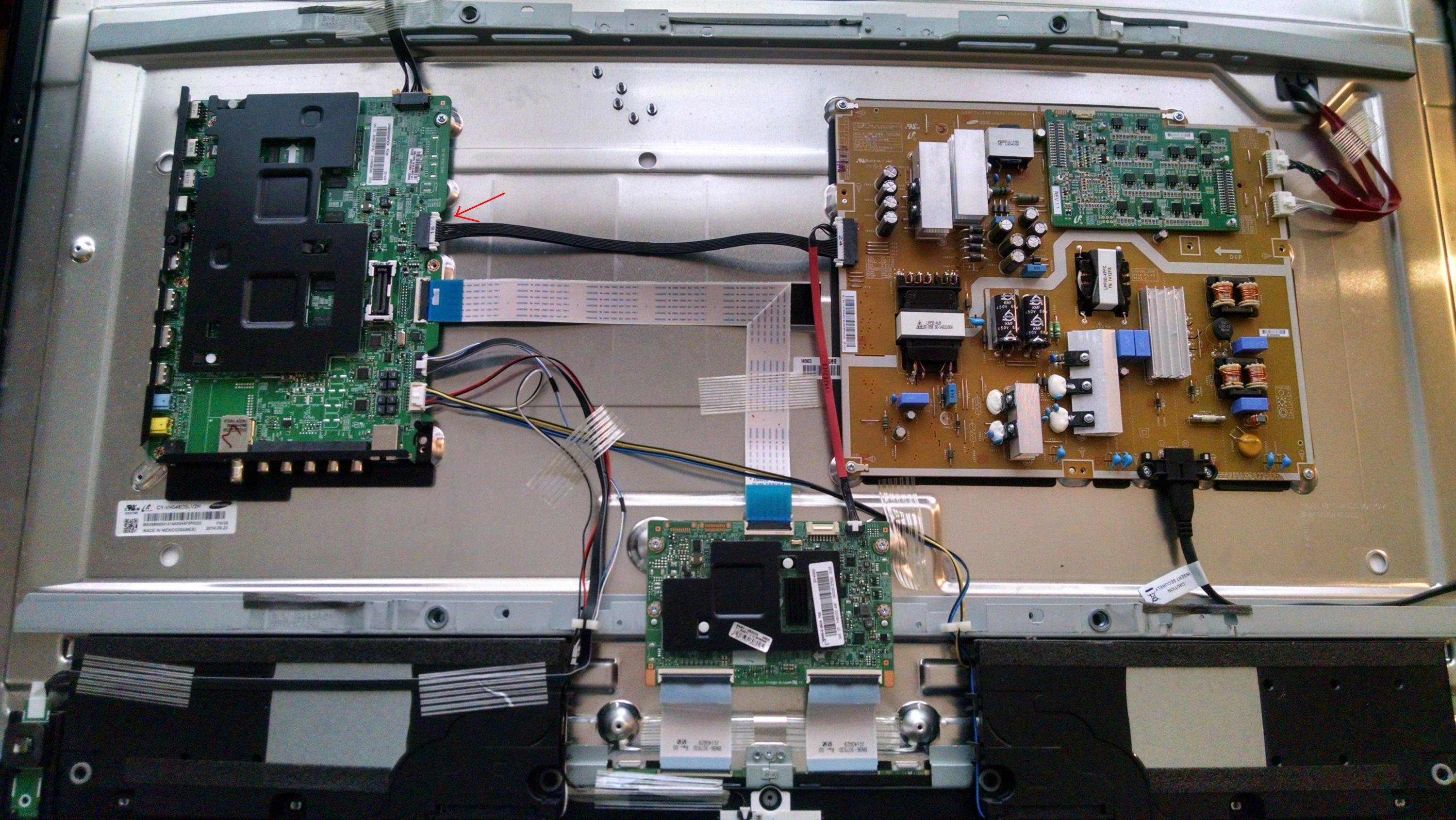

    Hi gents,
    I was hoping for some guidance with a curved Samsung. It has sound but no picture. Tried too see if back lights are on, did not see anything. Tried the ShopJimmy menu/flashlight screen test could see nothing.
    We did get an ebay main board, but when it was installed we didn't even get sound anymore, so suspect it was a bad ebay board. I've attached pics of the inside of the tv. There s hardly any voltage info to go by.
    Did some voltage tests on the main board video driver. I put an arrow nest to the two plugs I tested for voltage. I got about 18 volts whether in standby or on. On one of the pins per plug I got about 18 volts. I then disconnected the two plugs and tested on the board again thinking I would still see the 18v and 38v and got 0v.
    So not sure what board to look at.

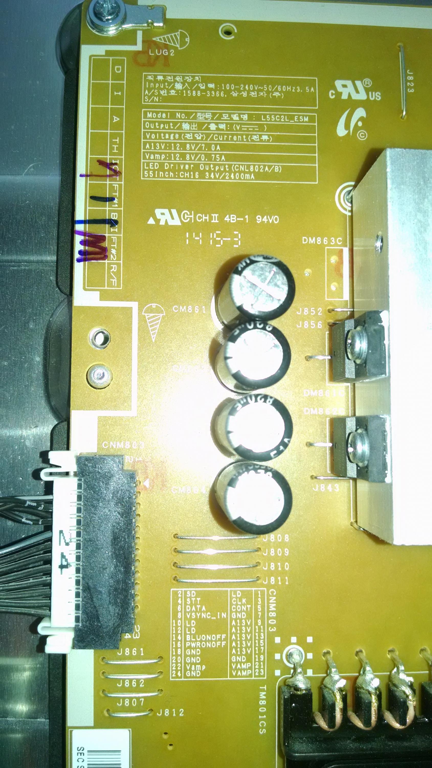

      Re: Samsung UN48H8000AFXZA No picture Has Sound
      What voltages do you get on your cnm803 connector?
      • attainteddragon
        • Apr 2013
        • 764
        • australia
        pin 16 of cnm803 is your power on command from the main board. does it change states when you try to power the set on?

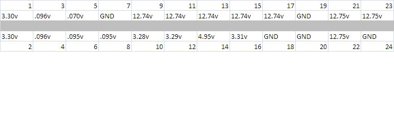

          Attached are the voltages.
          Also pin 16 on standby is about .12V then goes to 3.31v on power on
              your main and ps are good. now see if you can get some readings off of cn802.
              as dskall mentioned, we are now looking towards the backlights.
                No flash of backlights, no menu with flashlight

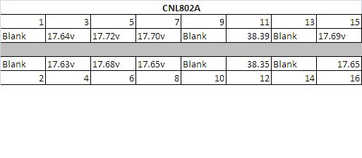

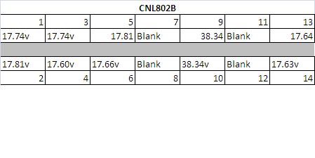

                Attached are the CNL802 voltage readings

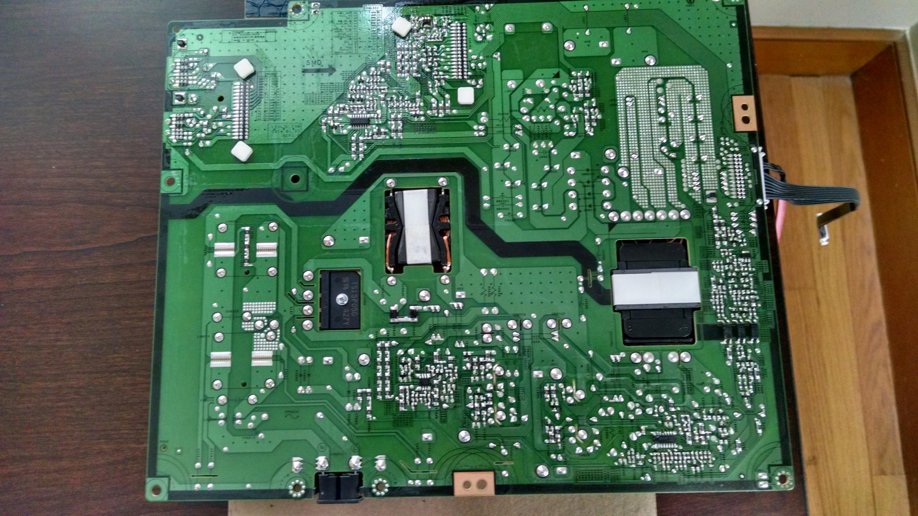

                  might be time for some good pics of the under side of the ps board.
                    This is atypical backlight issue. LEDs are open on strips. On plug with backlights did connected the LED driver did what it was supposed to do - Shutdown.

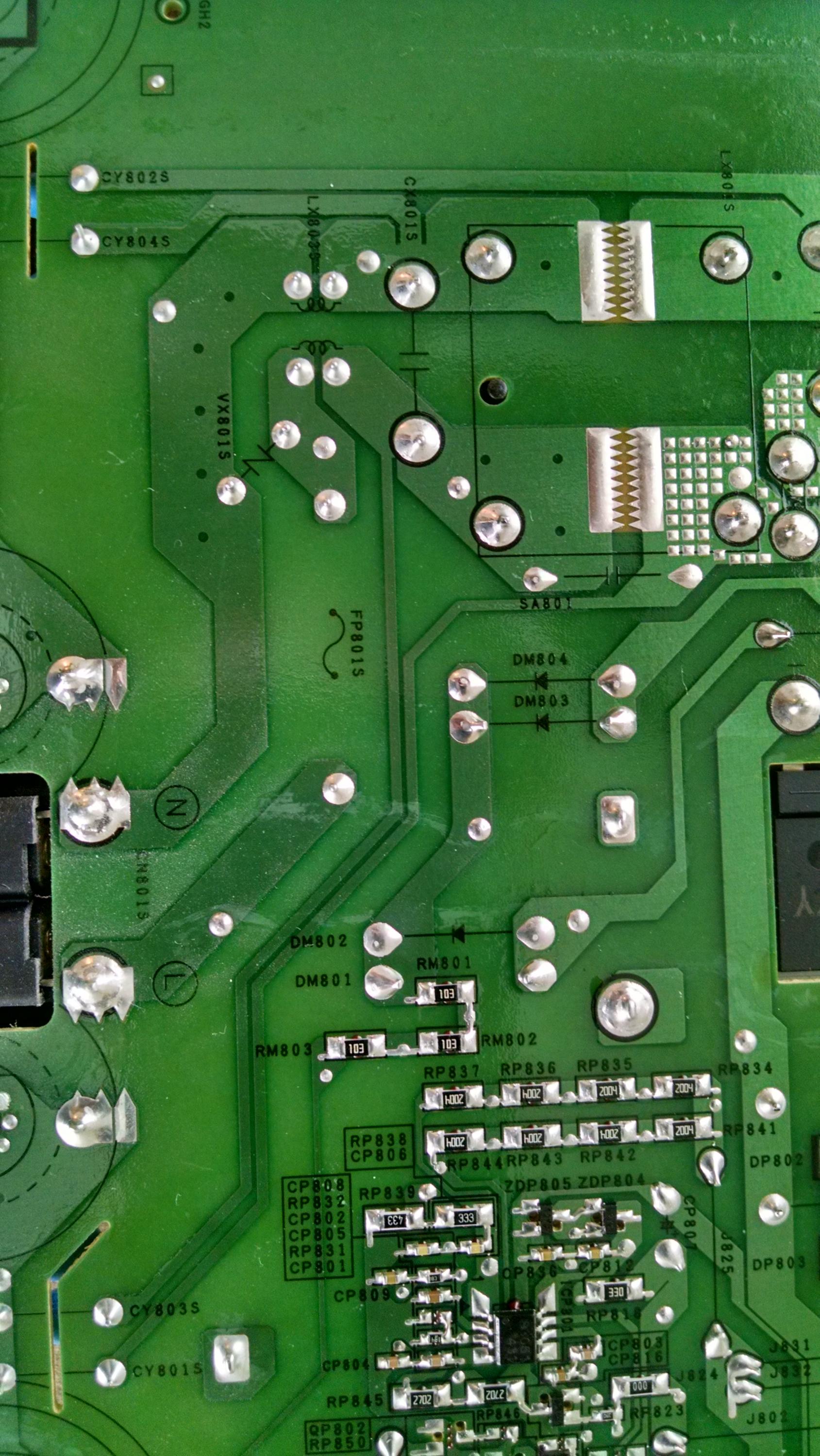

                        • Gladiatorx
                          • Aug 2016
                          • 95

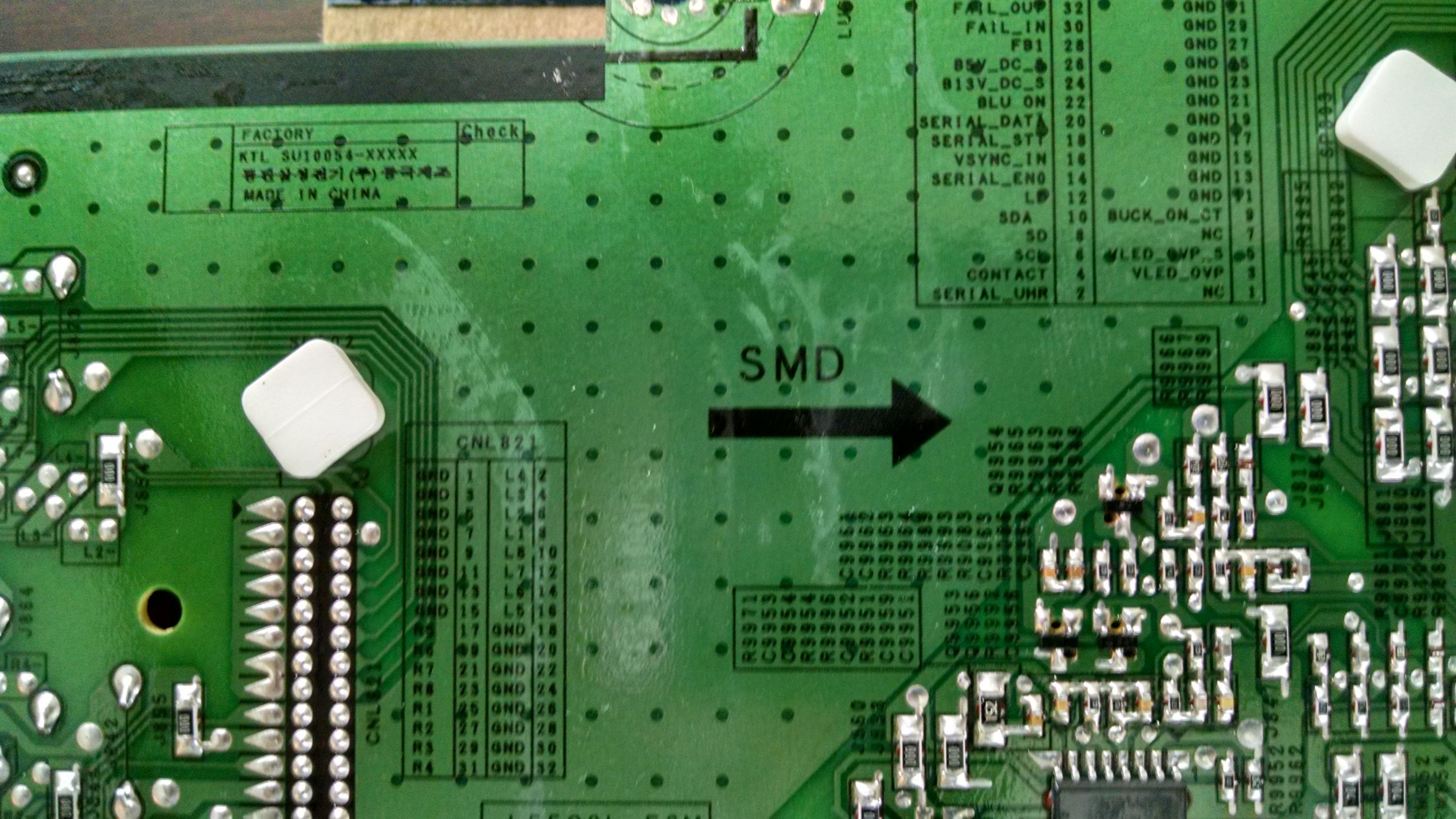

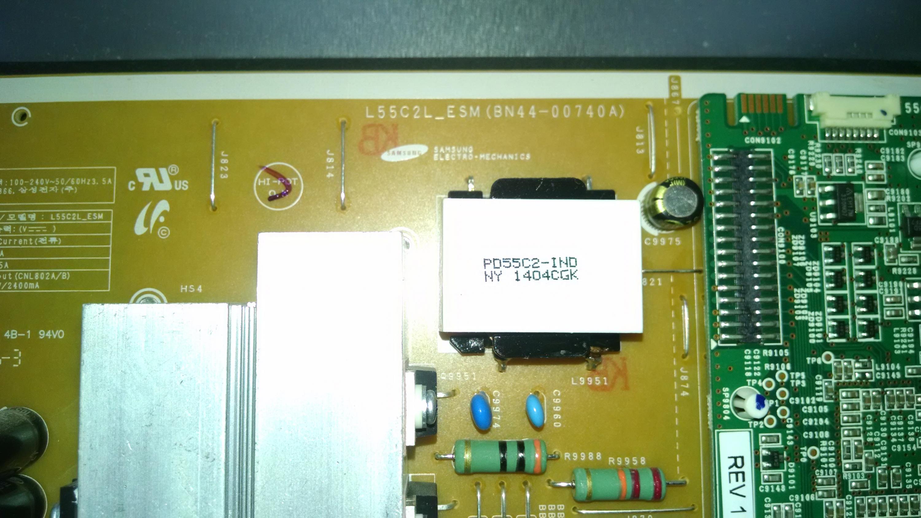

                          Attached are pics of the back of the power supply. The main borad only has traces on the back side with nothing visibly burned out.
                          I still need to pull the tCon board out to get those pics.

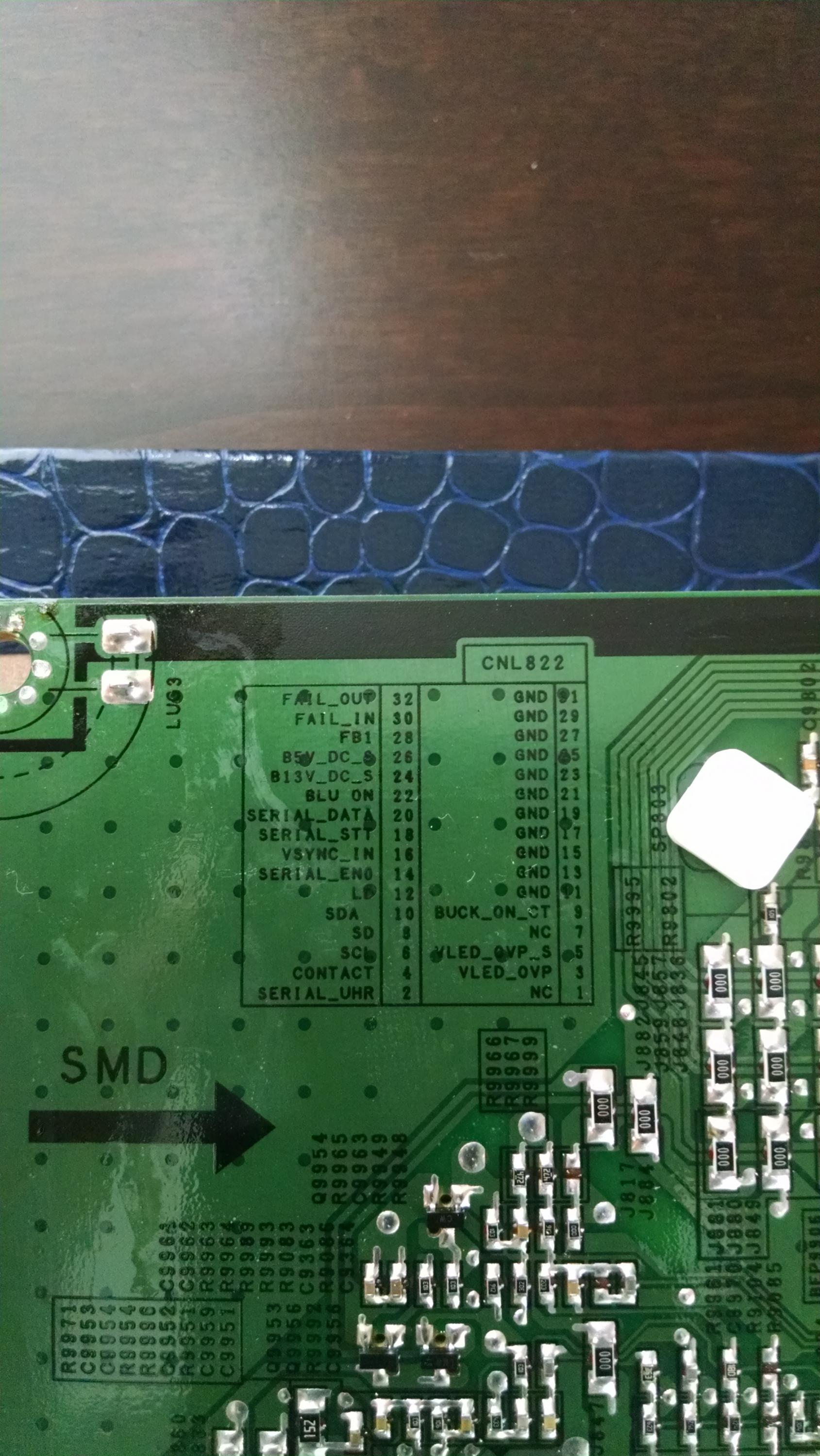

                            What voltages do you have on CNL822 pins 22, 24, 26 & 9?

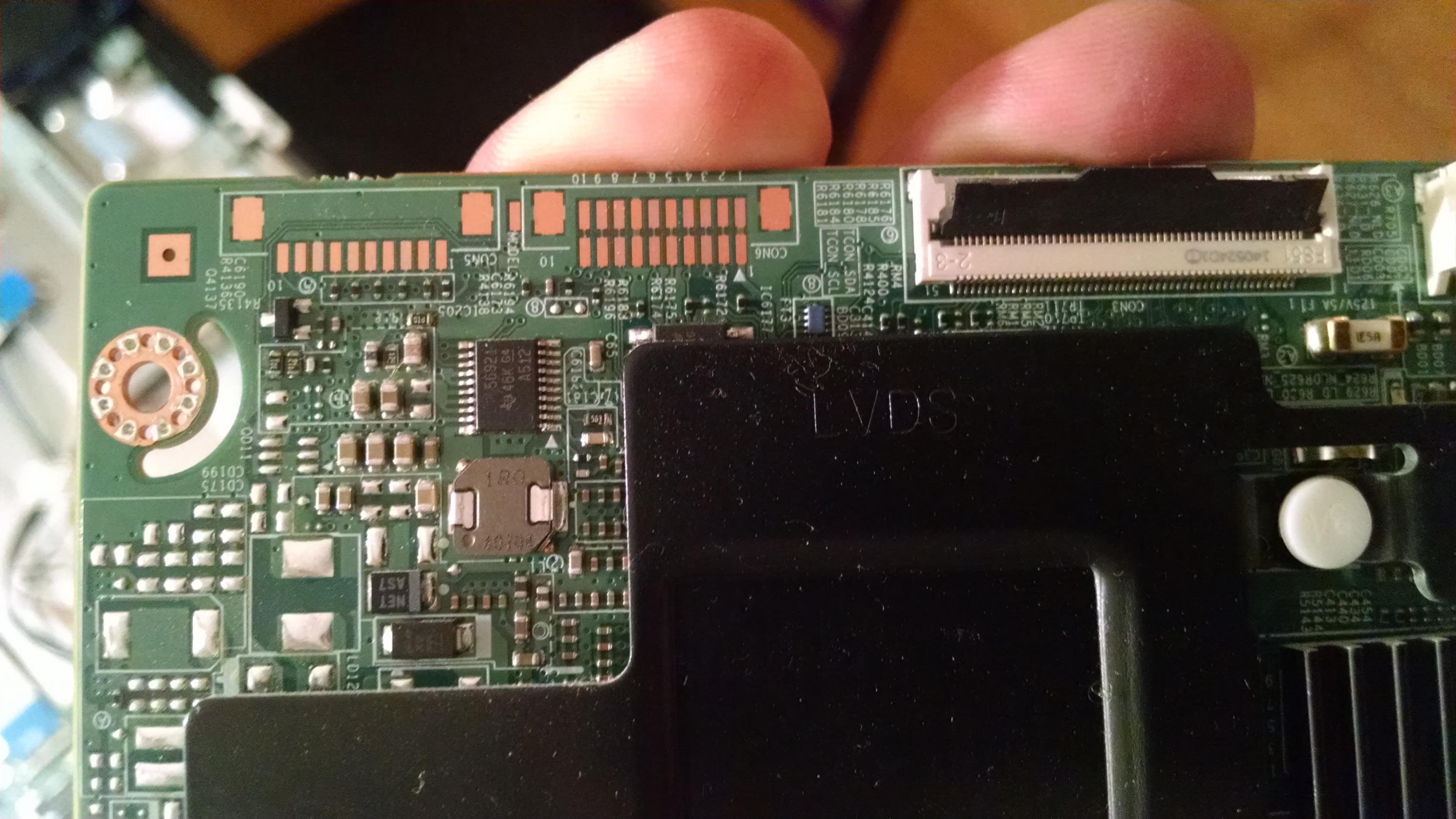

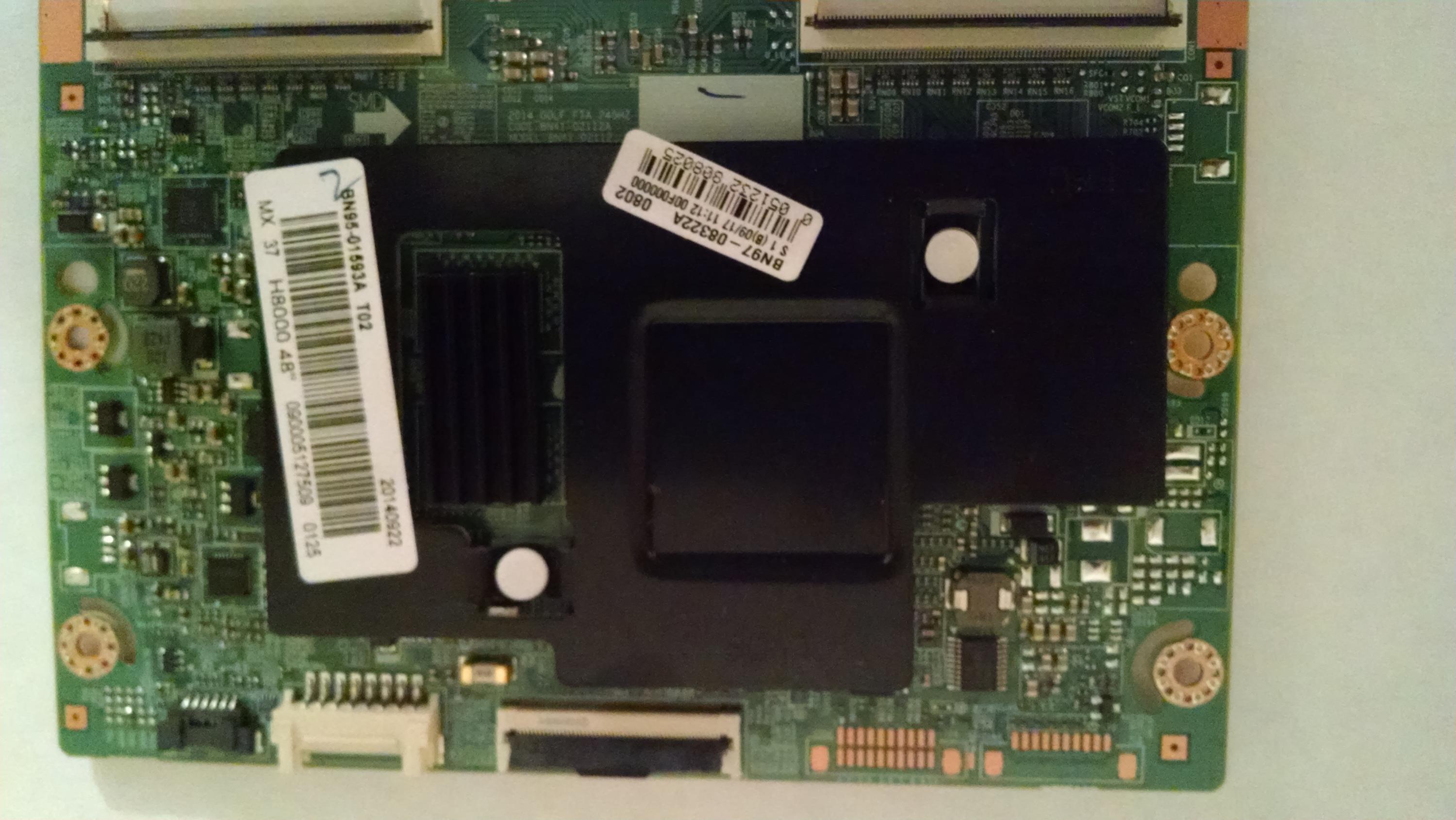

                                • Gladiatorx
                                  • Aug 2016
                                  • 95

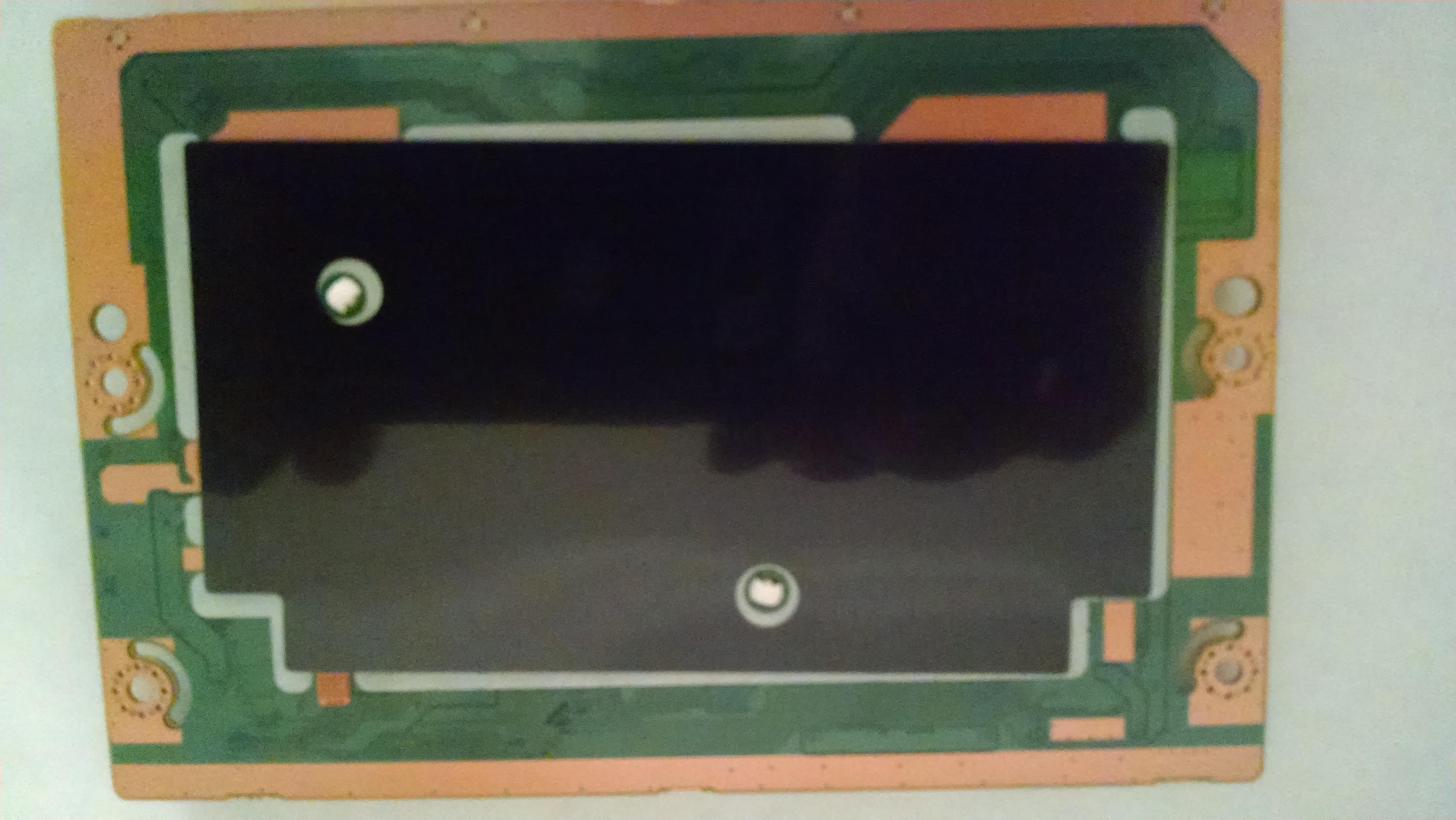

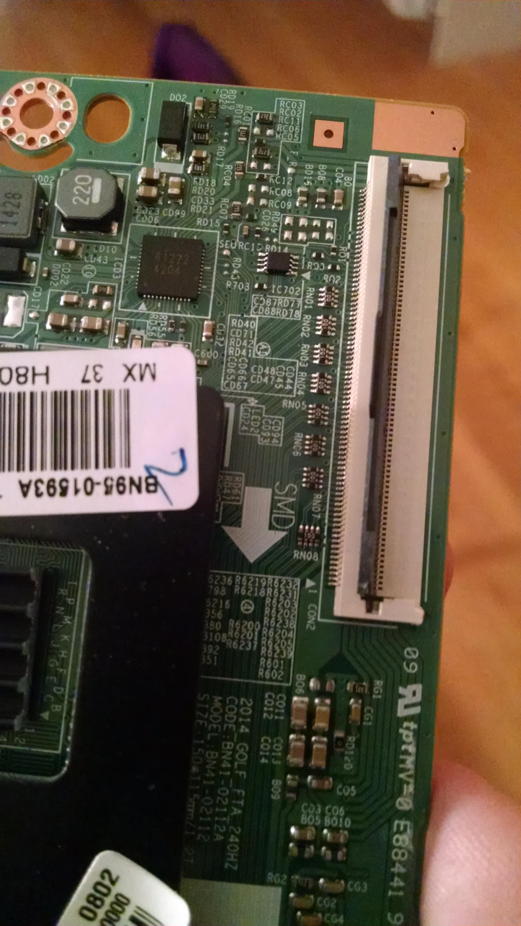

                                  T-conn Pictures attached. The black pad on back of T-conn is not removable.
                                    You have 16 strings of LEDs with 16 PWM controlled Power MOSFETs for the Cathode return. I would expect that you will at least see some of the LED strings light up before going into shut down because it has 16 circuits so some should come on before the protection kicks in.
                                    The LED Voltage as printed on the board is shown as 34V 2400mA so it does look like the Anode feeding Voltage is OK, and all the Cathode return pins are all showing around 17.5V or so. I seems to me that those MOSFETS are not being turned on.
                                    Something like this the LED string should be check with the tester first.
                                    Has any one fine any fast track for this model? I hate to see panel get damaged during taking or putting it back together.
                                    I think something else is stopping the backlights to come on.
                                    BTW, did you try disconnecting the cable between the main board and the power supply board and then power up the TV to see if you get backlights (it may need dim control signal too).
