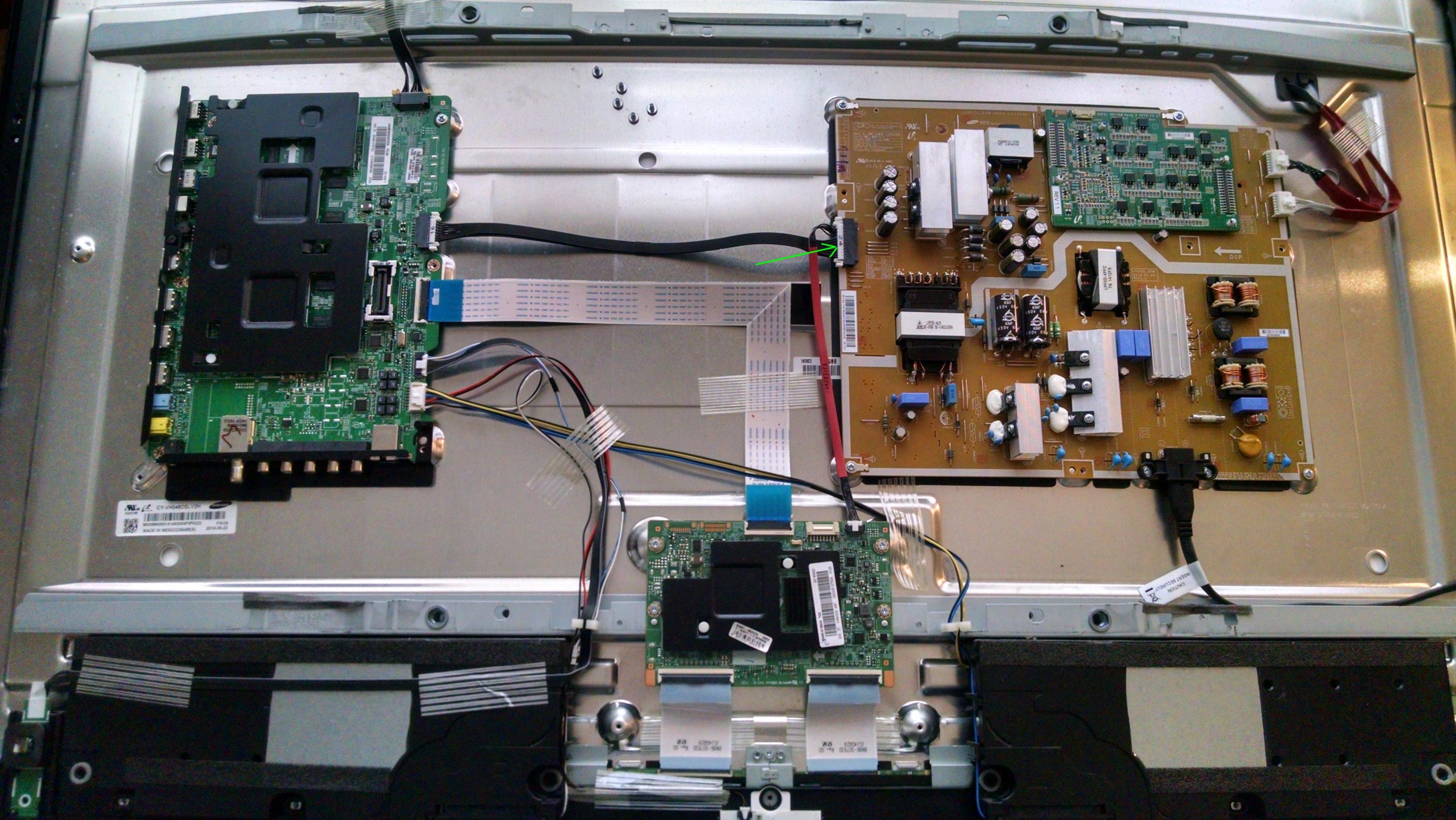

      Re: Samsung UN48H8000AFXZA No picture Has Sound
      Ok so removed the cable at the arrow per the pic I sent you. Got nothing.
      • Gladiatorx
        • Aug 2016
        • 95
        Hi BubM ok, removed the other side got back lights!!
        Well, not sure where to go from here
          which side allowed the back lights to come on? ps side, or main side?
          WHY CAN'T PHILIPS USE PHILLIPS HEAD SCREWS?
          • Gladiatorx
            • Aug 2016
            • 95
            See pic the side that goes to the power supply is the one I disconnected.
            Seems that line also goes to T conn, via that small red wire.
            So I guess we are down to between the Tconn and main board?
            • attainteddragon
              • Apr 2013
              • 764
              • australia
              i'm sure others will find that helpful.
              so there is no flickering of the back lights when it self powers them?
              if you disconnect the 2 t-con cables (power and lvds) then try to power it up, it might answer that question, but i doubt the t-con would be to blame.
                Good, your PS and backlights are OK.
                Those wires on the T-CON that go to the power supply board are for LED backlights zone control, they are the PWM dimming for each zone of the LEDS.
                You can put all the cables back in place and then remove that small connector on that T-CON board which goes to the power supply board and see what happen.

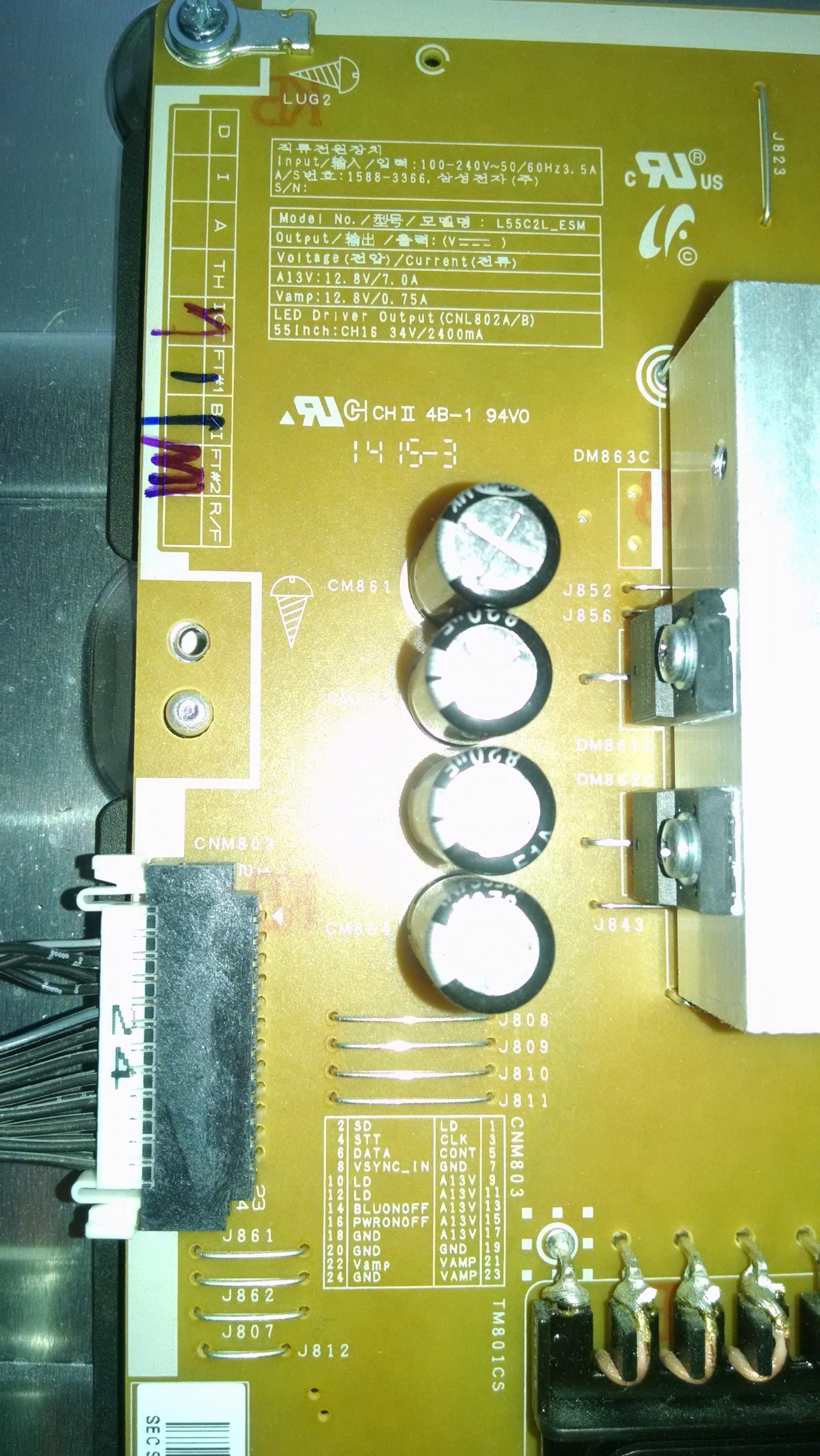

                  BTW, I need the pictures of the power supply board around the connector that goes to the main board hoping to get the pin names of that connector.

                    #29
                    attainteddragon:
                    No led flickering
                    BudM: removed the small red wire from tConn plugged tv in and got backlight.
                    I'll see whats on the main board for the pics

                      #30
                      Attached is the pic
                        #31
                        So with everything all hook back up except the small connector on the T-C0N board gong to the power supply board and you get backlights, but do you get pictures on the screen now. You also need to find out if you do have 12VDC at both ends (with ref. to chassis GND) of the SMD fuse on the T-CON board or not.

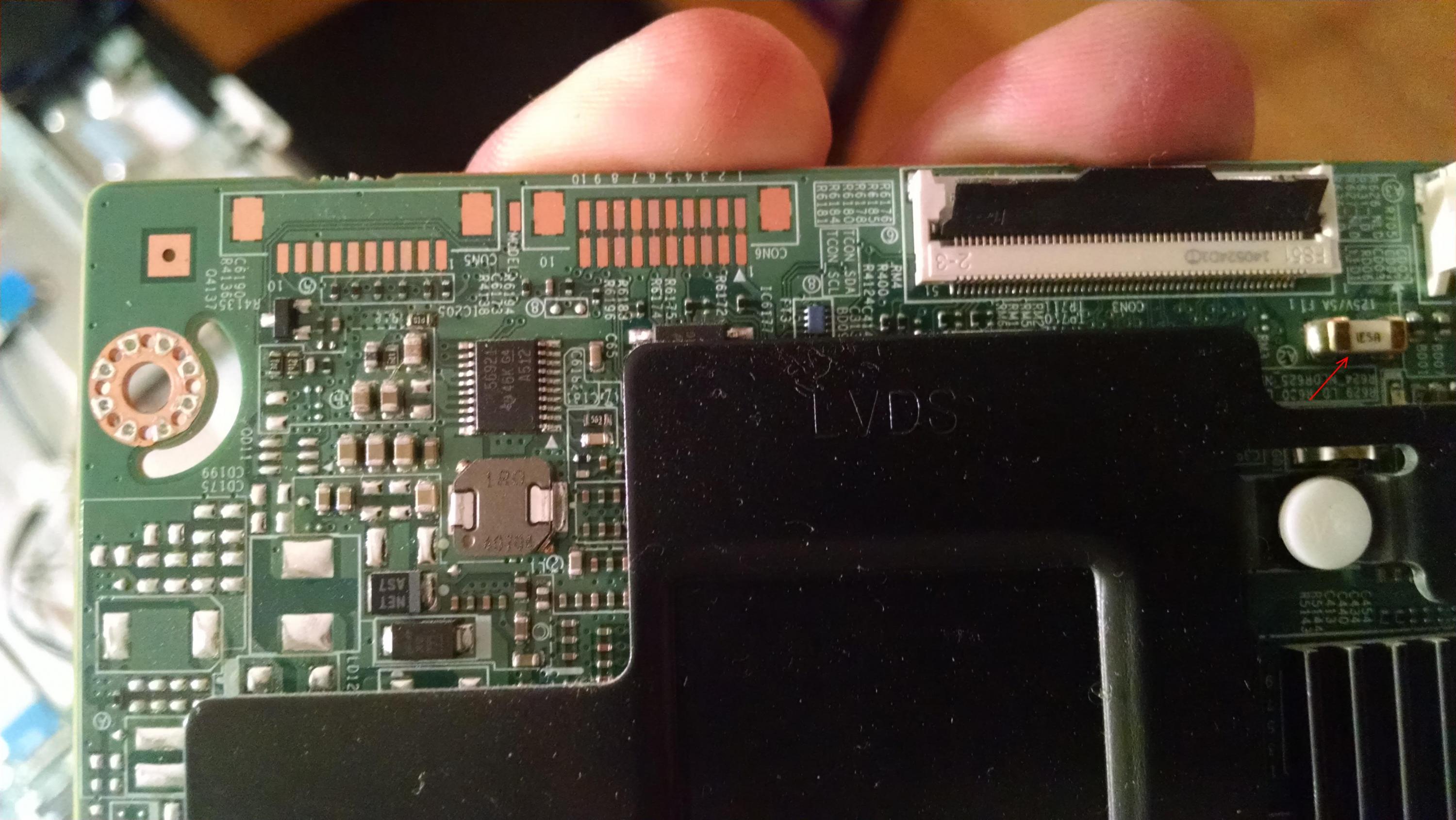

                            Is the fuse the white one I have the arrow pointed to? It says 125V
                              yeah, that is the fuse in question.
                                12.6 volts Dc on both sides
