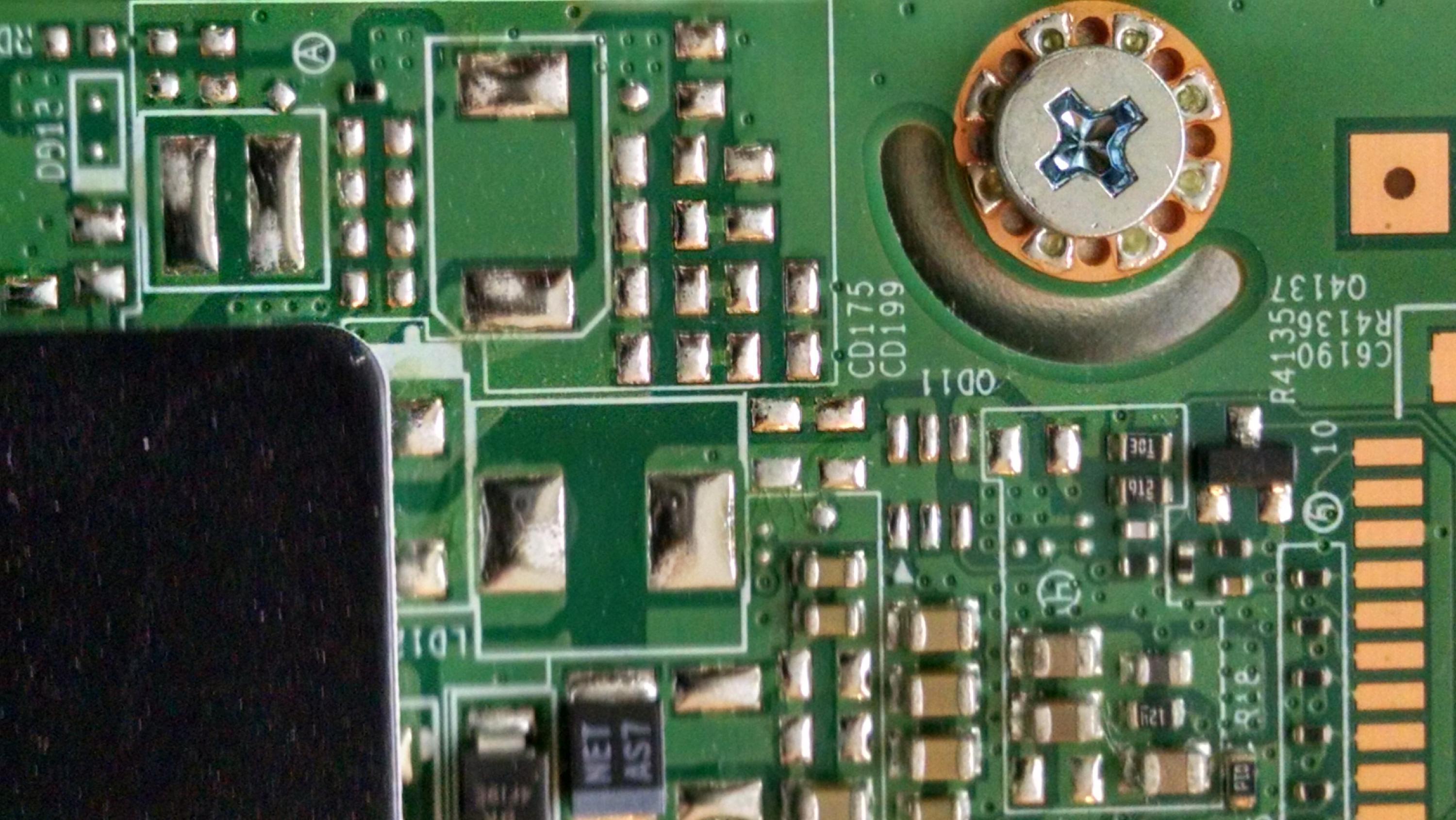

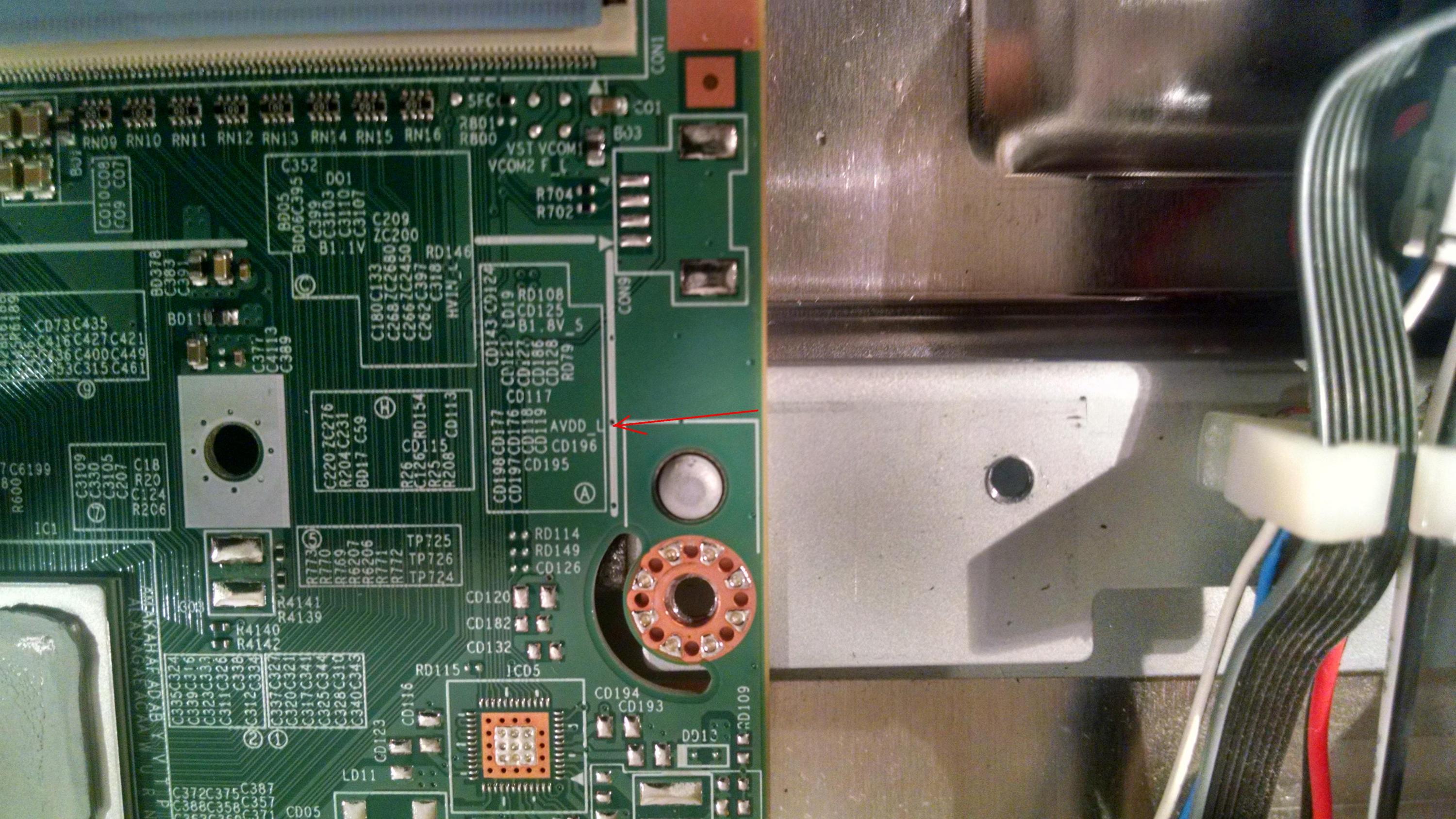

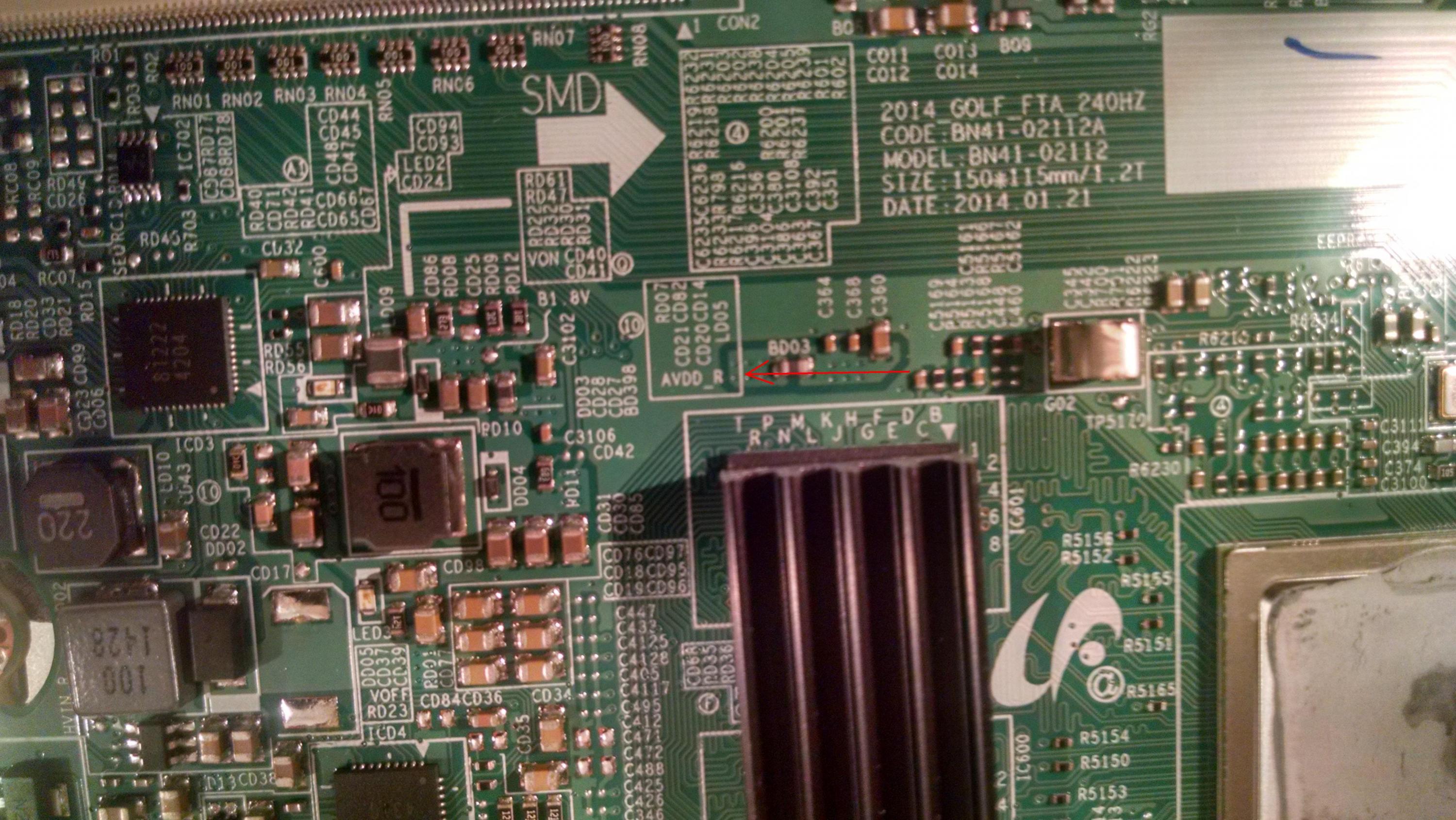

    took the heat sink off, and found an AVDD_L & AVDD_H
    see attached pics please

        Re: Samsung UN48H8000AFXZA No picture Has Sound
        What are those voltages on AVDD_L & AVDD_H? Didn't look at pictures. It is quite confusing.
          I can see the wording on the board, but not sure where the pins are located to test. Seems where ever there was space on the board they would try and give you info that pointed to other parts of the board where the test points were.
            It calls out an A for the AVDD_L .
            See the area I found with the A designation. Not sure if thats the right area, nor which one of the pins it would be.
