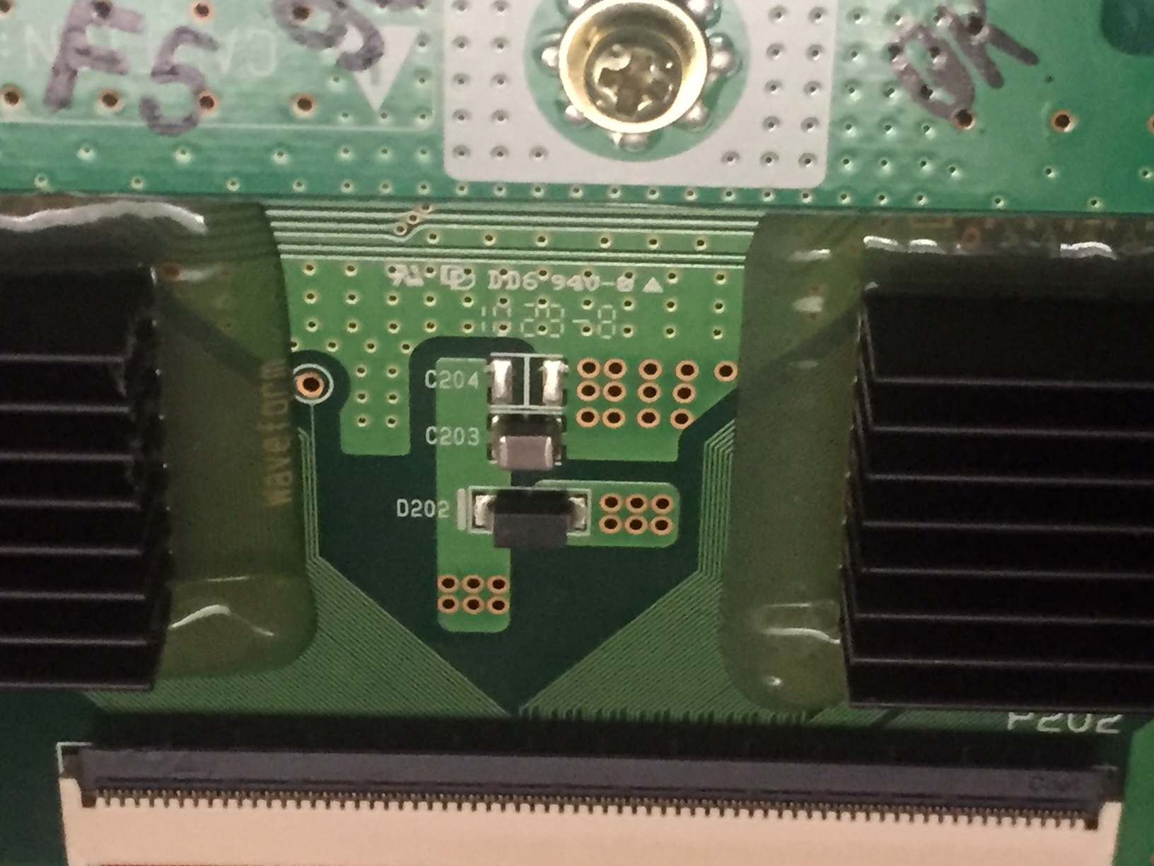

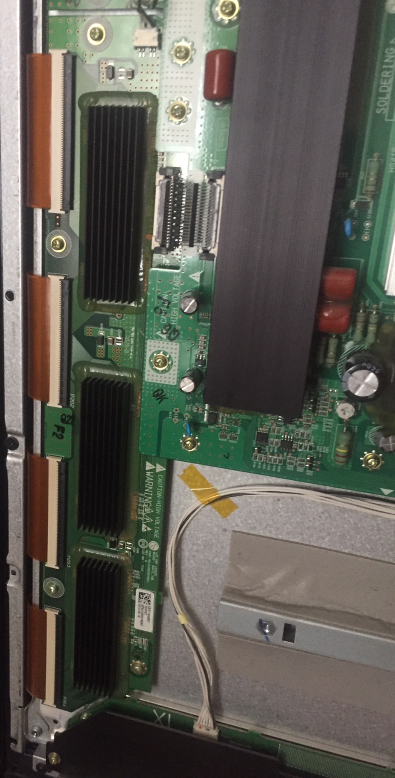

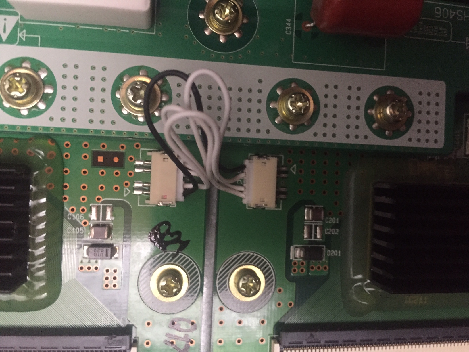

    The connector between the two Y Scan Boards, as seen in the 4th picture above, seems to be locked in tight. So tight, in fact, that I had a lot of trouble removing it at all and never ended up doing so. I wanted to see what would happen if I re-seated it. Could that connected be a suspect in this scenario?
    You can see the two wire-pronged connectors that lead from the YSUS Main Board to the two respective Y Scan Boards, also in the pictures above. That lower connector is the one I had off when I was getting the top half of the picture to come through.
    The picture you see below is just one of the small black components (all labeled D202) that rest on the Y Scan Boards. There are 3 of them per board (so, 6 total). Thing is, they all read the exact same on the 200 Ohm setting on my DMM (all six read 10.3), and they also all show continuity (beeping) and read 010 when I set the DMM to the Diode/Continuity setting.
    It seems odd to me that the lower scan board would not be operational under these circumstances and with these readings. When I was working on my year 2006 to 2008 Hitachi P50H401's, whenever these diodes obtained the same readings as related to all 8 IC's on each Y scan board, that's how I (generally) knew that that particular board was good and ready to display a correct 1/2 screen image when I plugged in the set. And, that rang true every time I did it.
    Question now, I guess, is:
    On this LG 60PX950 plasma, can the IC's be defective even if all of these D202 diodes are giving the exact same consistent results / readings?

      Okay then that lower board is shorted those green scan lines you're getting are showing which Ics are shorted to ground.
      You're getting a short in those diodes reading both directions due to the fact that one or more skin drives are shorted. It is acting as if you put a wire in Bridge series shorting the scan output drive to ground
      Do you get the same readings on those diodes on the upper board
      I should note that the green lines you are getting on the screen without the voltage being applied to the board is almost indicative of where the short lies within the scan ics

        In answer to your question up above, yes I am getting those exact same D202 diode readings on the Upper Y-Scan Board. The three on the lower board and the three on the upper board all read the exact same thing. That's why I am thinking that this lower board still might be functional in some way where I can bring it back to life.
        So, I don't think there is a short in any of these D202 diodes. They are all operating in the exact same manner, apparently. For the exact readings, please see Post #61 above.
        Can you confirm for me, definitively, that the IC's on this lower scan board can be shorted, even if all of those D202 diodes are reading properly? Or, is it possible that the problem lies in the small, white connector that bridges the Upper Y-Scan and the Lower Y-Scan and brings them in connection with one another? (See image below)
        Note: I found a lower Y-Scan board online for only $35, and will order it now if you confirm that the IC's are definitely defective on this lower Y Scan Board. Very good price, but I'd still hate to spend any money on it if the one I have can be resurrected in some manner.
        One other note: When I hooked the lower Y-scan back up to the YSUS Main board just now, and keeping the upper Y-scan board connected to the YSUS Main board as well, the entire screen goes black once again. Is that the expected result? Seems like the potentially defective lower Y-scan is disallowing the upper picture to appear.

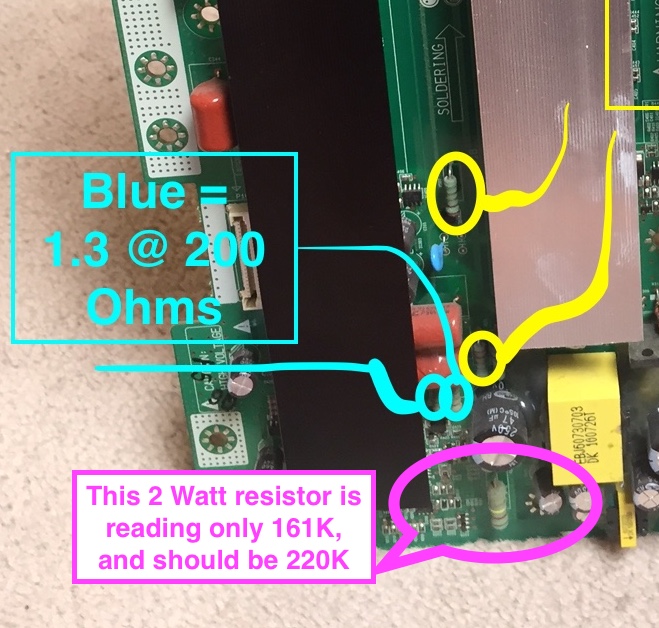

                Waiting for the new lower Y-Buffer to arrive.
                Still wondering if the Y Main Board is functioning properly, though. I am still getting odd readings on some of the resistors on the bottom half of it.
                Only 1.3 Ohms vs. the expected 2.2 on two of the resistors (see picture) ~~~ Markings on these two are both Red, Red, Gold, Gold
                and
                Only 161K vs. the expected 220K on the 2 Watt resistor also shown in the picture ~~~ Markings on this one are Red, Red, Yellow, Gold
                Important note is, I am getting only 1.2 on two Red, Red, Gold, Gold resistors that rest on the ZSUS board as well, indicating that this might indeed be okay.
                I don't want to put the new lower Y-Board in when it arrives if the Y Main is still compromised, as it might blow out the IC's in the new buffer board. Maybe these suspect resistors caused the original lower board to fail?
                QUESTIONS:
                1) Would the top half of my picture be appearing so flawlessly if the ZSUS was compromised in any way? For, if it isn't, then the two 1.2's on the YSUS might be just as okay. I'm guessing that these are indeed okay.
                2) Can the 161K reading be responsible for the lower half of the picture not appearing, while the top half indeed does?
                3) Should I wait for the new lower Y-Board and then just risk putting it in? Or, should I replace the three resistors you see pictured below before coupling this Y Main with the new Y Buffer?

                  if youre getting a perfect image with the shorted buffer removed and vsc and vy now correct i wouldnt concern yourself with the y-sustain any further.

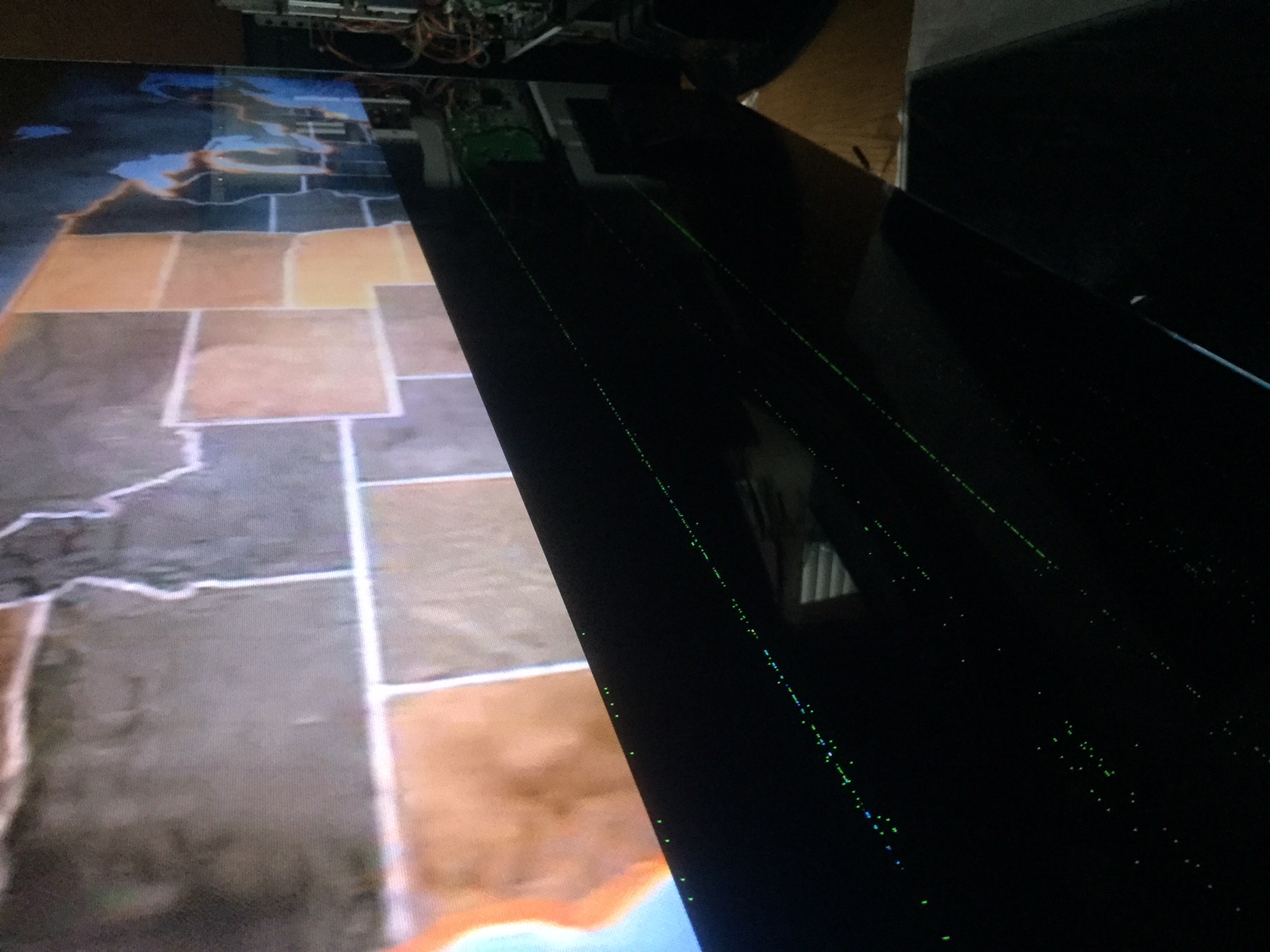

                          The other thing that's quite a bit different that the Hitachi's I worked on before is that when one of those IC buffers blew out, there would be a definitive "patch" of green, horizontal lines that went across the screen. This patch would be at least 4 to 6 inches high from top to bottom. In other words, it was rather large and distinctive.
                          The green lines I am not getting on the bottom half of this LG 60PX950 are very thin and very scattered. There does not appear to be a distinctive pattern to them.
                          Please check out this video to see what I mean:
                          https://www.youtube.com/watch?v=ycYK...ature=youtu.be

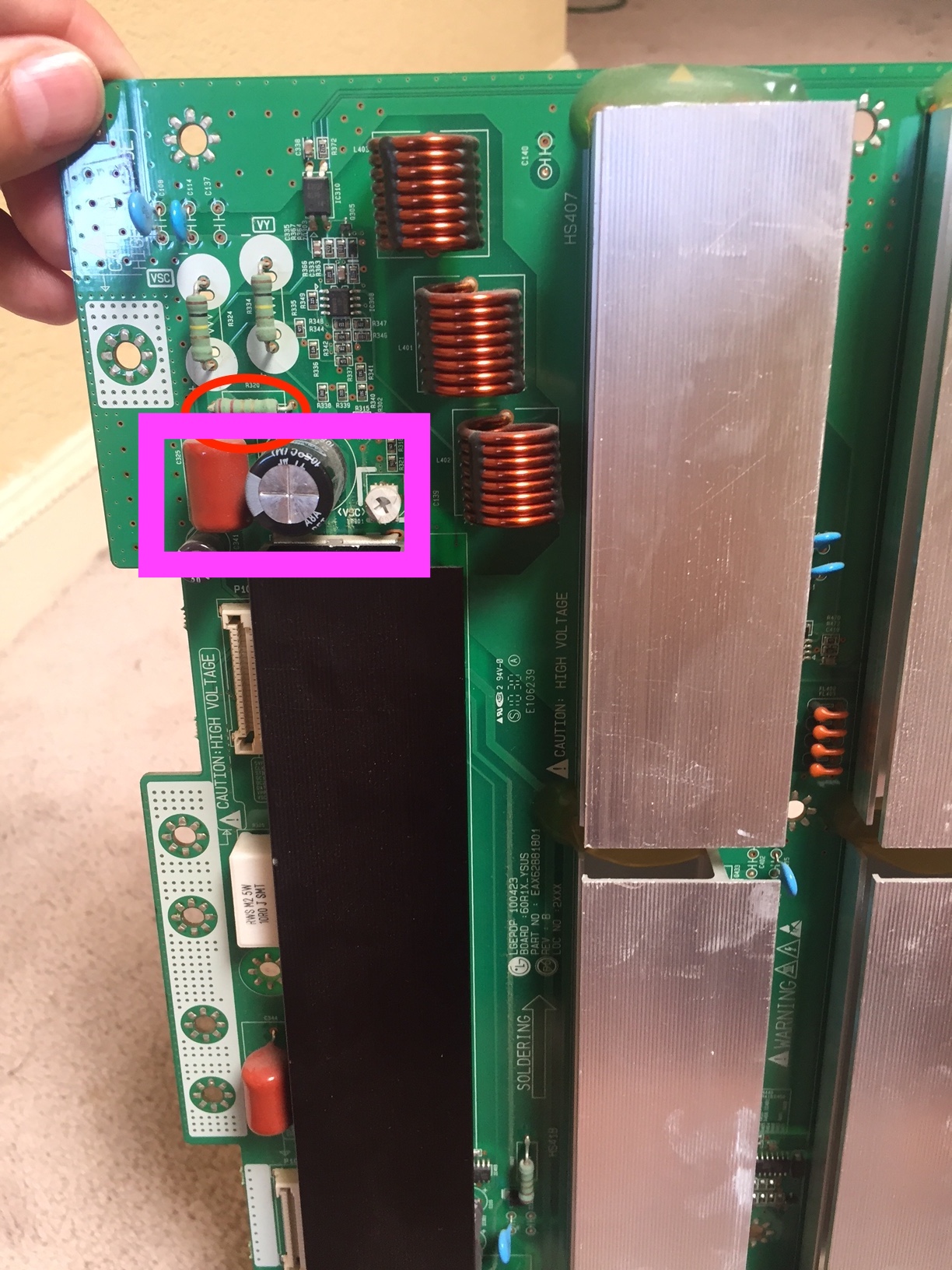

                                    Is it possible that the capacitor that sits just directly below the three resistors in question is malfunctioning, and causing all of this havoc with the resistors themselves (see image below)?
                                    Seems like either both Y-Buffers are shot now, or something on the Y Main is dragging down the voltages. Not a great setback, but I'm not willing to give up at this juncture.

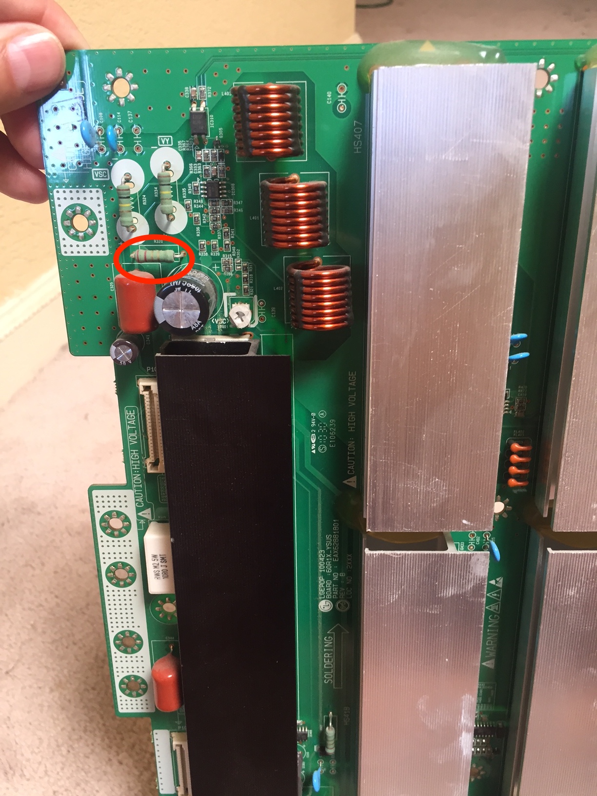

                                      Note: Interestingly, when both Y buffers were connected, I measured the 2.2 Ohm resistor that sits directly underneath the VSC and -VY resistors, and that one was no longer stable as well. It was too high (4.8) when I had the probes one way, and way too low (0.1) when I reversed the probes. When it was functioning properly (i.e., when the top half of the picture was showing up correctly), then I was getting a consistent reading of 2.3 or 2.4 at the most.
                                      Now, I tested the same expected 2.2 Ohm resistor (please see the image below) with both of the Y buffers DISCONNECTED, and got the same results noted above (too high with the probes one way, and too low the other way 4.8 and 0.1, respectively).
                                      Importantly, it has correct reading of 2.4 when no voltage is present.
                                      It seems to me that this resistor is either problematic in and of itself, or it is malfunctioning when voltage is applied as a result of some other component(s) which are NOT the Y-Buffers .... as those are disconnected from the Y-Main now and taken out of the equation.
                                      Adding to this theory is that I tested both the old (original) lower Y-Buffer for continuity as well as the new lower Y-Buffer that came in the mail the other day and neither seem as though any of the IC's are fried. Both tests were done when the boards were completely out of the set and attached to nothing. The red probe was on ground, and there was NO evidence of continuity on either the old or the new Y Buffer when I pulled that black probe across all of the pins (both the outside and inside pins). Also, all of the diodes on both old and new are giving the same reading of 492. In other words, there is no evidence that either of these lower Y-Buffer boards is defective.
                                      I am going to replace and resolder that 2.2 Ohm resistor with (another) new one to see what happens. If that doesn't fix anything, my latest question is:
                                      Which other component on the Y Main Board is most likely to be causing this 2.2 Ohm resistor to fail, but fail ONLY under voltage?
