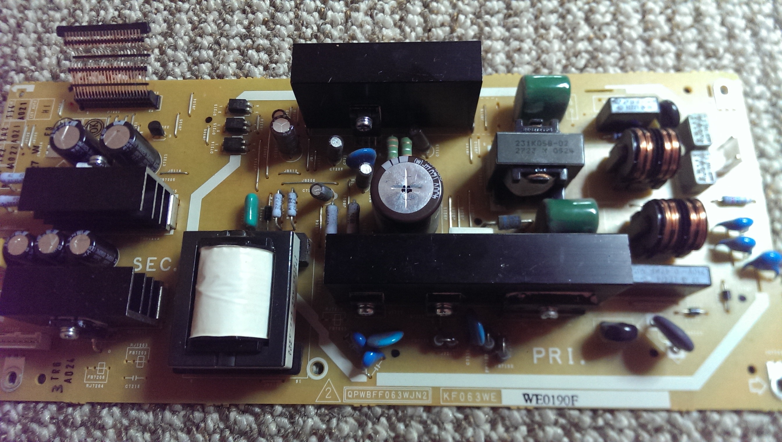

    I have this sharp 32 inch LCD TV that appears to be stuck in standby.
    When I plug the set into the mains there is no led lit , when I press the on off button on the TV the LED turns red but the tv remains lifeless. There is no remote control function.
    at all. The 12 .5 volt rail is only measuring 7.8 volts , PS ON seems to be stuck at 0.2 v. I notice the voltage on the Mains Filter Cap is 343v - 345v slightly fluctuating not a rock steady reading , I am wondering if the PFC is working right.
    Connector P7202 Measurements.
    PIN 1 - 0V
    PIN 2 - 0V
    PIN 3 - 0V
    PIN 4 - 0V
    PIN 5 - 0.2 V
    PIN 6 - 0.2V
    PIN 7 - 0V
    PIN 8 - 0V
    PIN 9 - 0V
    PIN 10- 0V
    PIN 11- 7.8V
    PIN 12- 7.8V
    PIN 13- 7.8V
    PIN 14 7.8 V

            pin 4 0v
            this is your stby pin. you need to recover this voltage before you go chasing your secondary voltages.
            someone with more knowledge will need to jump in, as i couldn't see where stby is transported to this pin.

              Re: Sharp LCD 32DH57E No power up.
              This power supply ony has one power supply so when it is in standby mode, the output Voltage is set (by controlling the Vref diode IC7202 KIA431, and the ADJ pin of the SMPS IC) to put out lower Voltage, 7.8V, enough to run the main board, when the PS-ON is present then 12V pin will put out 12V, and the PFC Booster circuit will also come on. So you need to get the main board to send out the PS-ON to turn the power supply fully on.
              Connector P7202 Pin 6 is the PS-ON pin, you can try forcing on the power supply board by itself to see if the 12VDC and the 60VDC will be present or not.

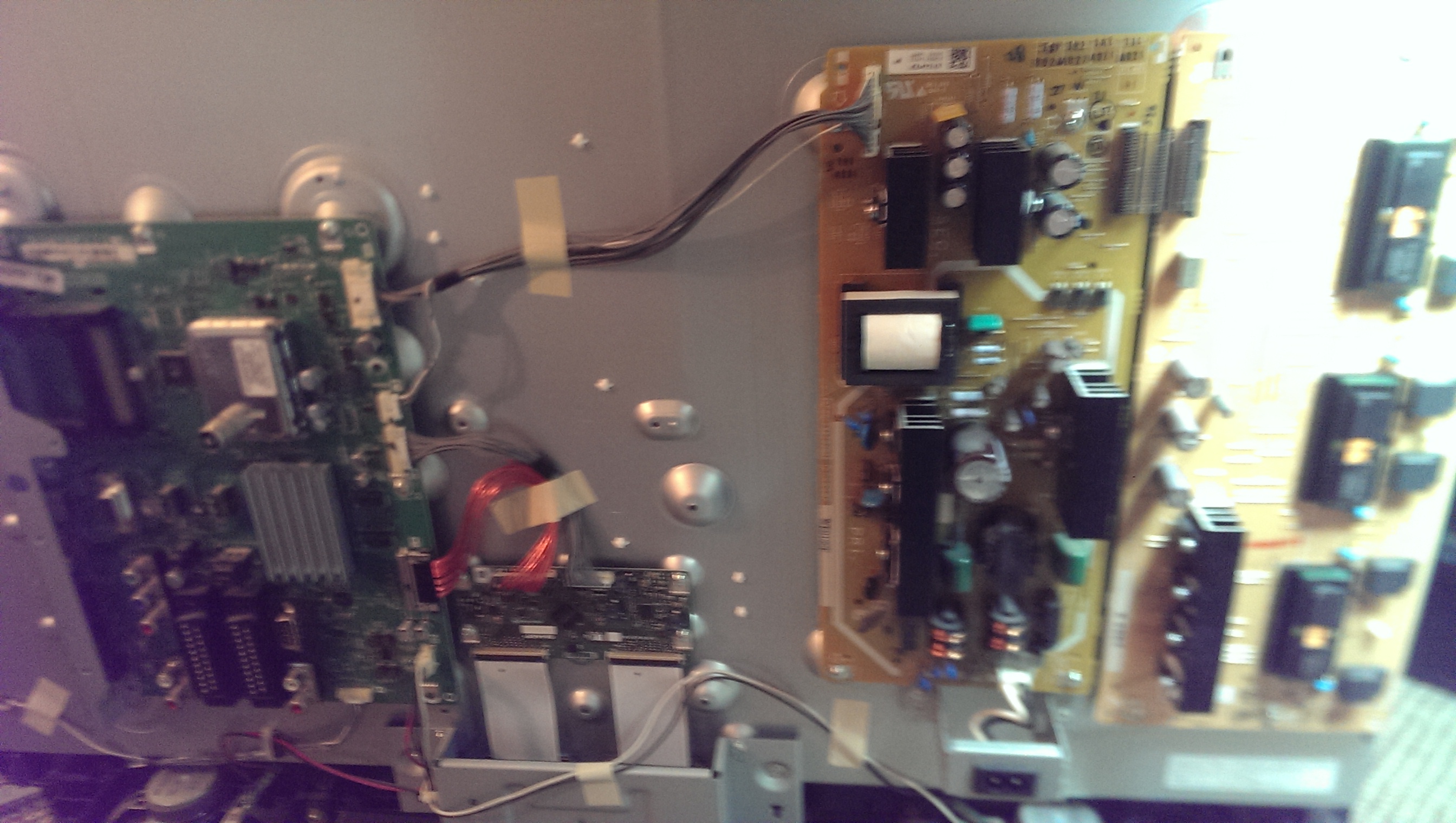

                I have forced the Power Supply board on here are the voltage readings
                on connector P7202
                Pin 1= 0v.
                Pin 2= 0v.
                Pin 3= 0v.
                Pin 4= 0v.
                Pin 5 0.2.
                Pin 6= PS on = forced on with 2.3 volts.
                Pin 7= 0v.
                PIN 8= 0V.
                Pin 9 = 0v.
                Pin 10 = 0v.
                Pin 11 =12.5v.
                Pin 12= 12.5v.
                Pin 13 = 12.5 v.
                Pin 14 = 12.5v.
                • dick_barton
                  • Aug 2015
                  • 6643
                  • Wales
                  Do you now have 60v dc at fuse F7700?
                  • Techstar
                    Tv Restoration
                    • Dec 2012
                    • 122
                    • United Kingdom.
                    There is 56 . 2 Volts at both sides of the fuse , i have measured the voltage as far as JA102 this is a wire link on the same rail as the fuse. The fuse appeared to have a solder crack where it is soldered to the board , i have resoldered it but the set remains no go.

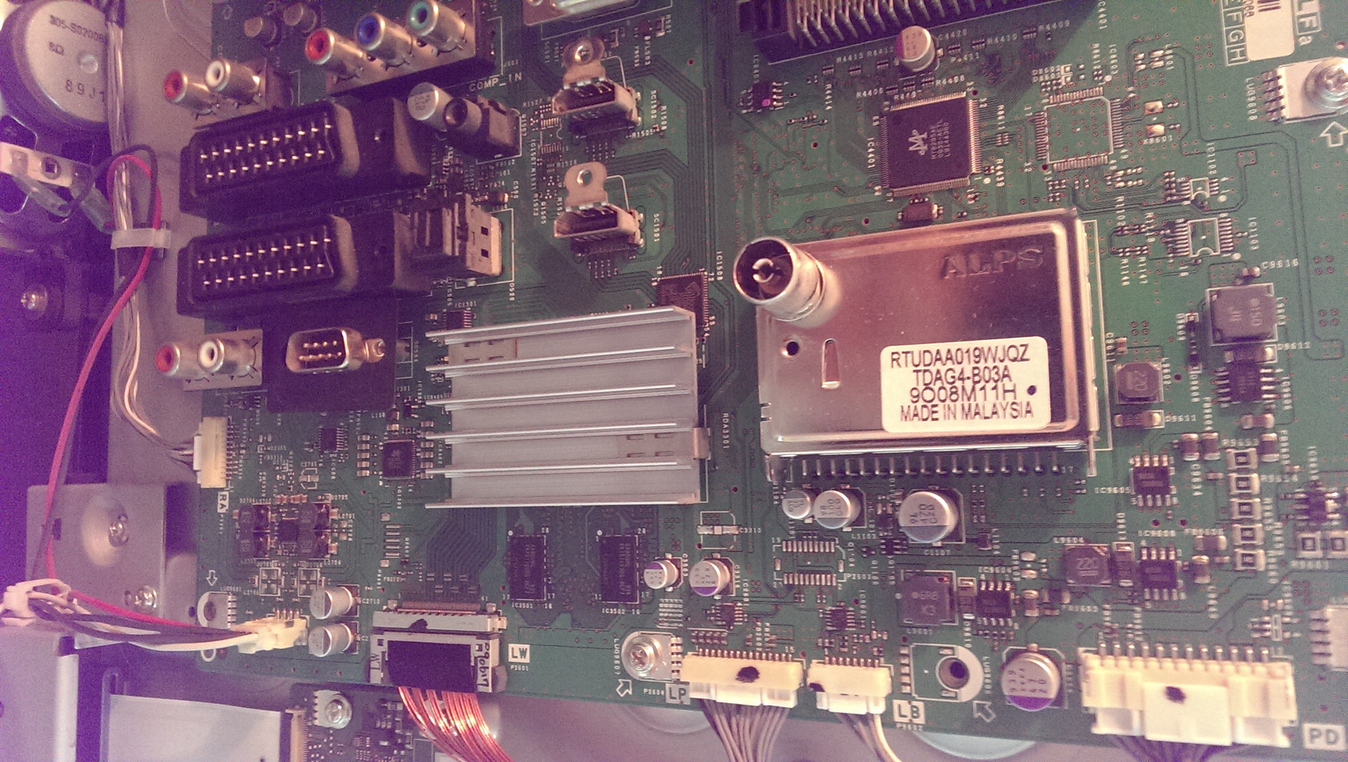

                      At this point the main board is not sending the PS-ON to turn on the power supply.
                          I have decided to salvage all good parts off this tv and scrap it.
                          A good screen too , if anyone needs the screen message me.
