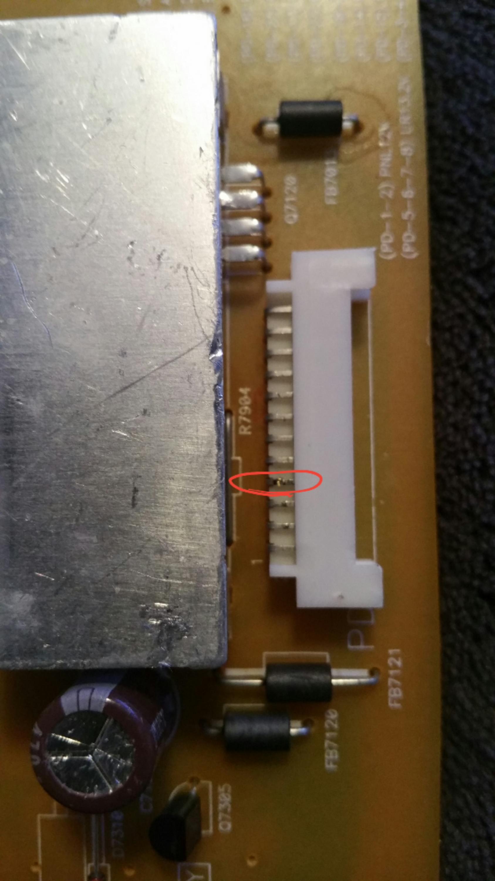

arc on a pin while testing ps
  • tjmethod
    • Jun 2013
    • 137
    Finally after receiving the second power supply while checking voltages and being distracted I accidentally arched pin 7 and knew it was a problem. Having checked back on pin 5 which was 13.14 and is now 0, I dont know what is blown. The board is for a Sharp and is a Delta RUNTKB057WJQZ (DPS-168JP A) Bud had helped me figure the problems on the original board which were:
    No command to turn on PNL12V for running the T-CON
    No BL-ON to turn on backlights circuit
    No dimming control:
    The second board I bought arrived damaged and this is the 3rd. If anyone has any info on chasing down what I've blown, I would be more than grateful.

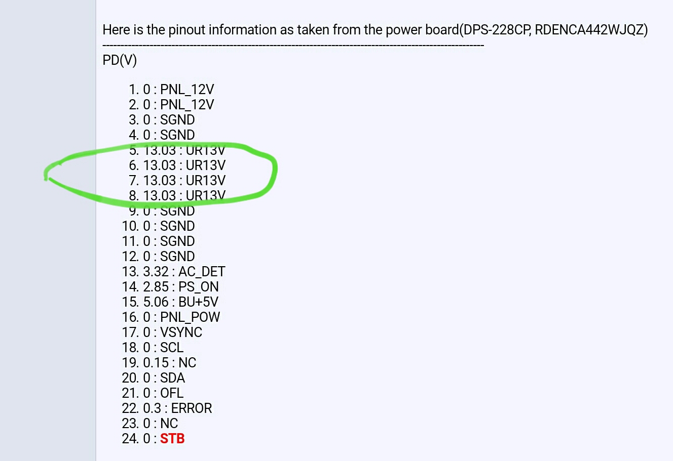

      Thats a good idea, I actually am able to turn the board around and andle the board and put one screw in. I wished I did that before. Here is a picture of the pinout from another ps very similar. It seems 5,6,7 and 8 are "UR13.2V" and "UR13.14V on 5,6,7 and 8 were i believe on mine. I am not exactly sure how to pinpoint the regulator that this or 5,6 or 8. I would imagine they all use the same regulator- and I do have a backup board for parts. How many components are in the regulator? How did you pinpoint and find yours?

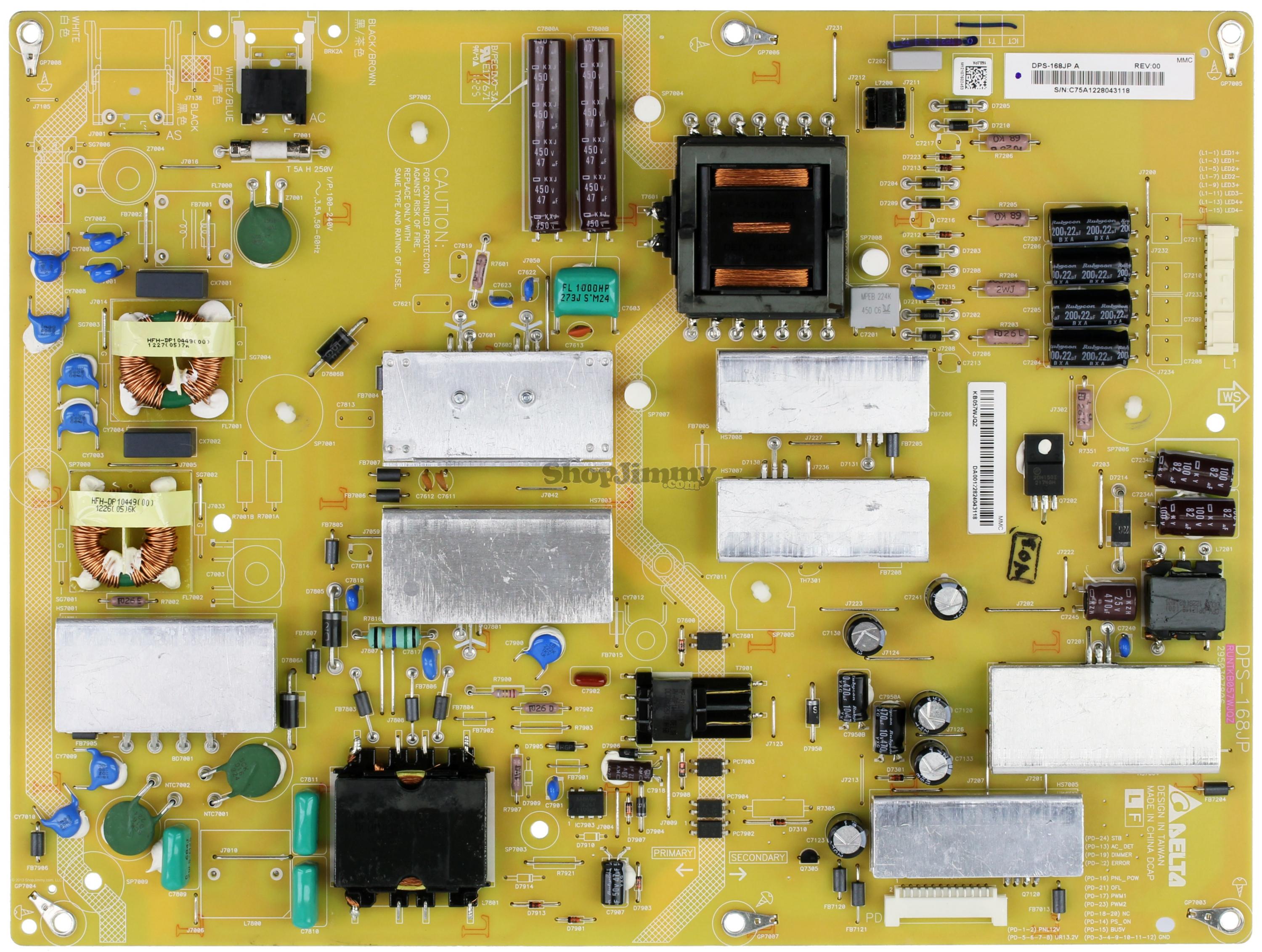

            This is the exact board, right?
            http://www.shopjimmy.com/sharp-runtk...-led-board.htm
            Sharp RUNTKB057WJQZ (DPS-168JP A) Power Supply / LED Board LC-60LE600U
            Pictures provided by shopjimmy.
              Re: arc on a pin while testing ps
              That UR13V is high current power supply section generated by transformer T7601 and full wave rectified by D7130, 7131, so check and see if they are damaged or not.
              You could also have blown the fusible resistor R7601 in the primary side that supplies the Boosted Voltage to the Power MOSFETs Q7601, 7602 which form the half-bridge drive for the primary winding of Transformer T7601.
              if the fusible resistor is blown then those tow MOSFETs may be damaged.
              The UR13V will only come on when PS-ON is present.

                  PD connector pin 5, 6, 7, and 8 are all tied together to the UR13V output, and you had shorted shorted to GND; pin 3, 4, 9, 10, 11, 12 are GND pins.

                      Hi bud I have continuety on the fusaible resistor R7601, so the Mosfet transistors Q7601 & 7602 should be fine? I dont know how to test them or the D7130 or 7130 (3) leg transistors?
                      thanks
                        thanks
                        They are Common Cathode Diode, just look up the spec sheet using the P/N as printed on the diode.
                        What is the resistance reading on that resistor, <1 Ohms? Continuity does not mean much since 1000 Ohms is also consider having continuity because it is not open circuit. We need reading in Ohm, make sure to report if the meter shows it in OHM, K OHM ,or M OHM.
                            OK, that is good and it means no shorted MOSFETs in the primary drive circuit.
                            You do have PS-ON signal on PD connector pin 14, right?
