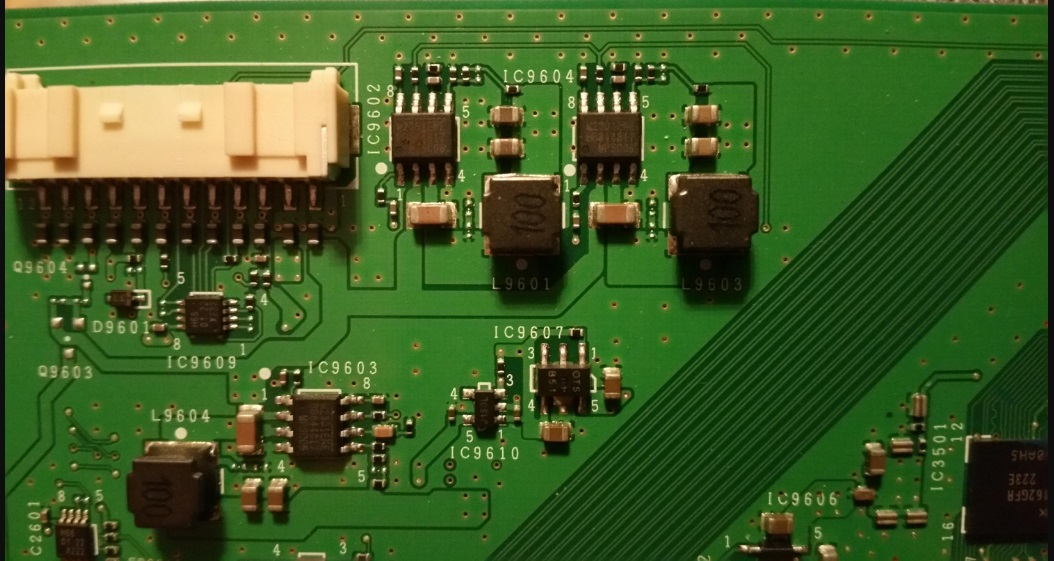

            This is the LC60LE600U thats dead in another thread. You had determined from the voltages:
            "Pin 16 PNL_POW = 0.05V = No command to turn on PNL12V for running the T-CON
            Pin 24 STB (Von) = 0.58V = No BL-ON to turn on backlights circuit
            No dimming control:
            Pin 17 PWM1 = 0.16V
            Pin 19 DIMMER = -0.00V
            The key is this one which I do not what it should be for normal operation:
            Pin 22 ERROR = 0.95V"
            You had figured since the standby power supply was present, that the main board is dead.
            I bought a ps from a company online which showed up cracked so I need another ps and bought a programmed eeprom off ebay. I had also ran this buy Shawn 'freakaftr8' and his take on the main was
            "Essentially What's Happening Here is the standby voltage is being sent to the main board but the main board is not doing anything with the voltage as most likely dead ee prom or voltage regulators. In this case you will never get 12 volt or panel on or backlight on. I think with this particular setup you're getting voltage at PS on and I think that needs to be grounded"
            This main is really hard to find- one or 2 popped up on ebay high priced but no info on what it came out of.
            Do you know where I can find this IC or compatable ones? I believe there are 3 I need. The main board-Sharp DUNTKKF905FM04 (KF905, QPWBXF905WJZZ
            Thanks-

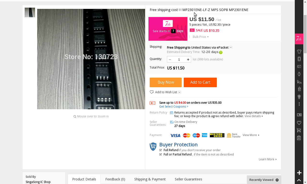

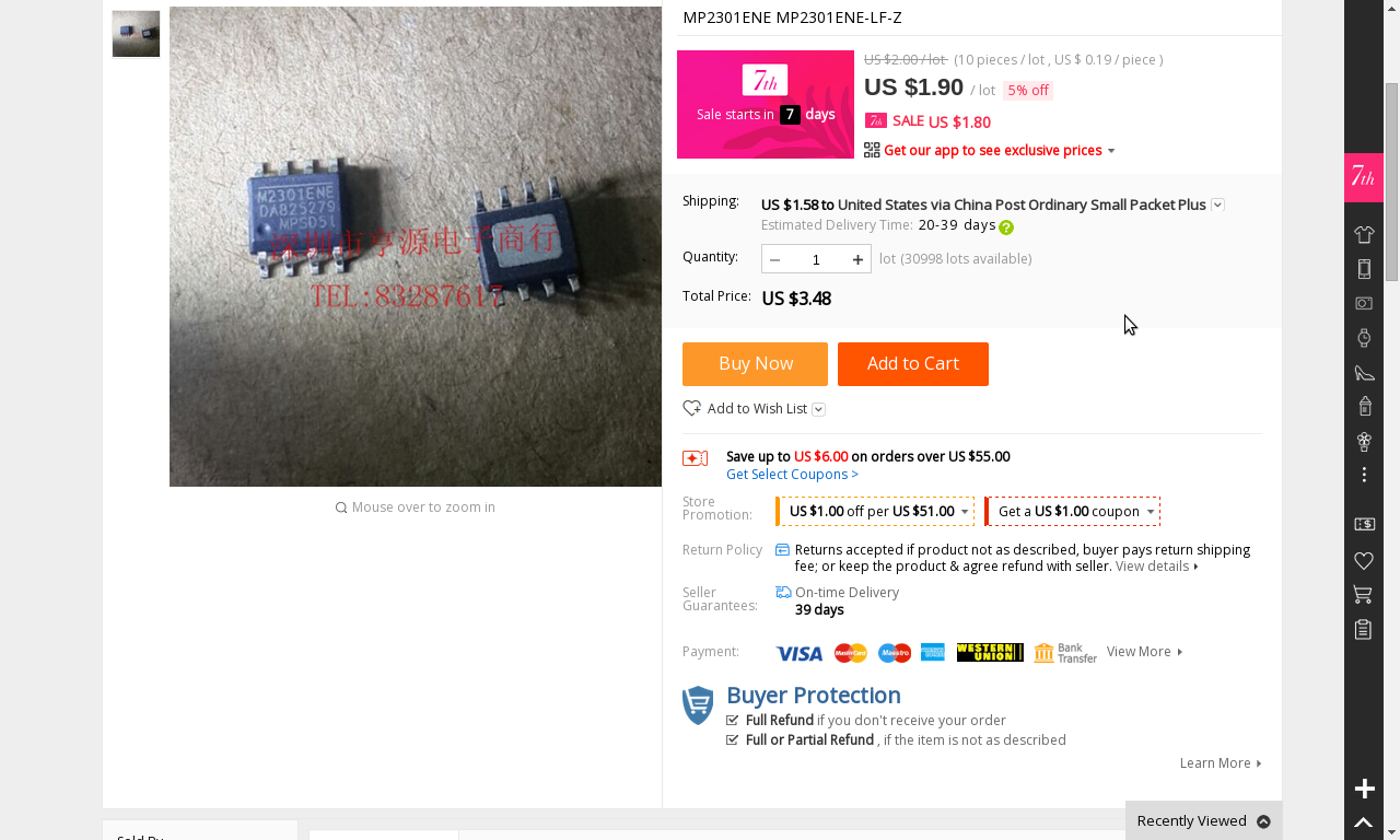

              WoW, You fix it..... amazing............"finally i found used PCB with that chip and it worked."
              MP2301ENE-LF-Z Aliexpress has it, Would you please give me the part location number?

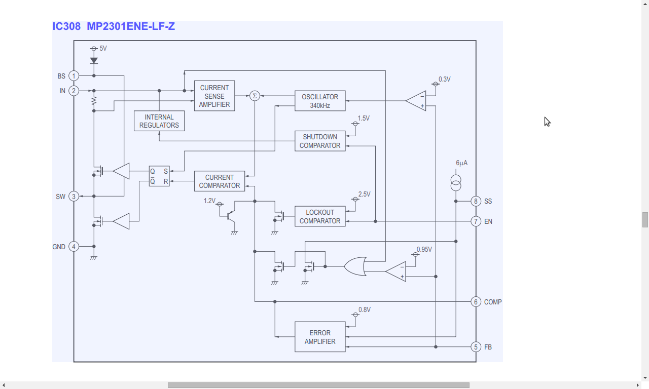

                  I would check to see if those 3 ICs are functioning or not first.
                  It has the same pinout as MP2303 series.

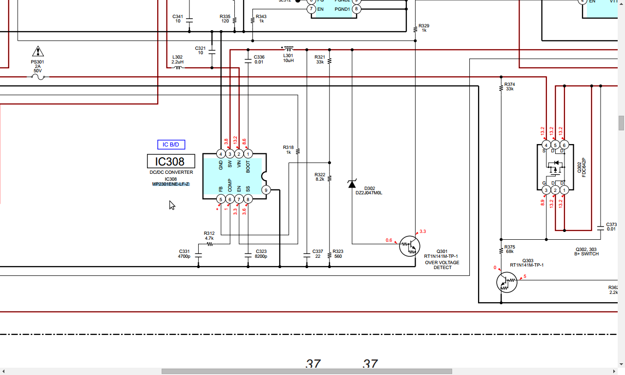

                      That is why they better be checked first before causing more problem due to removal and installation of the new parts. We have the pinout of the IC to do the testing.
                      OP needs to find out:
                      1) Visual check, resistance check (Input, Output), etc.
                      2) Does it have Input Voltage?
                      3) Does it have EN (ENABLE) command signal to turn on the IC or not?
                      4) Does it have Output Voltage with the present of the above Voltage and Command signal?

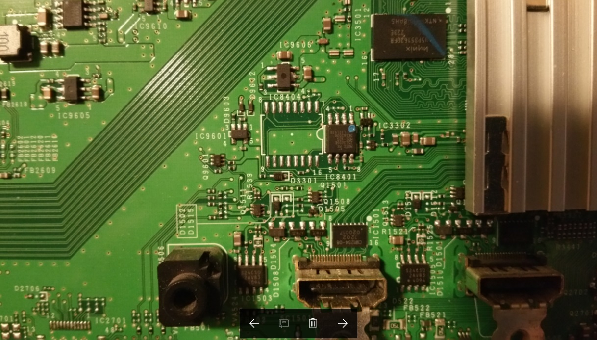

                        Hey there capwizard, the locations are 9602, 9603 and 9604
                        Sharp DKEYMF905FM04 Main Board For LC-60LE600U
                        Great you found them- I actually got a return email from the rep from the northeast with Monolithic Power Systems and he's going to just send me three of them.

                          Thank you for the details pictures, I bet yu it is not the IC 9602, IC 9603 and IC 9604 are causing the problems, If it is the case, it would be the (Badcaps), it will be nearby the ICs and just one SMD cap has problem.
                          Your TV problem is just need to reset it.( After you change egde LED if one of led not work, or you fix the power or main PCB).
                          From my experience working on two Sharp LED TV's (model lc60c6400u) that had the one long flash and two short flashes, both cases involved a poor or disconnected solder joint on the connector attached to the LED light strip. I redid the solder on both connectors just to be safe and both TV's are working great.
                          I did the Vol down, channel up and power trick to start it, and noticed only the right side of the screen had back lighting. I then confirmed the whole strip was out once I removed all the layers of the screen. I then looked for bad led lights on the strip and all were fine, and also test the voltage at the power supply which tested fine as well. lead me to the connector or wires as the culprit. Of course the wires tested fine, but when I looked at the connector, I noticed the solder at 3 points on the connector had cracked.
                          PS: This Sharp TV (If LED has bad connection) by reset it, Will works.
                          Conclusion: Not knowing the TV at shutdown mode, as a module Tech am I , I ordered the all boards still not fix the TV. I am hoping someone does not make the same mistake like I did. After this lesson, I've fixed more than 10 of them.

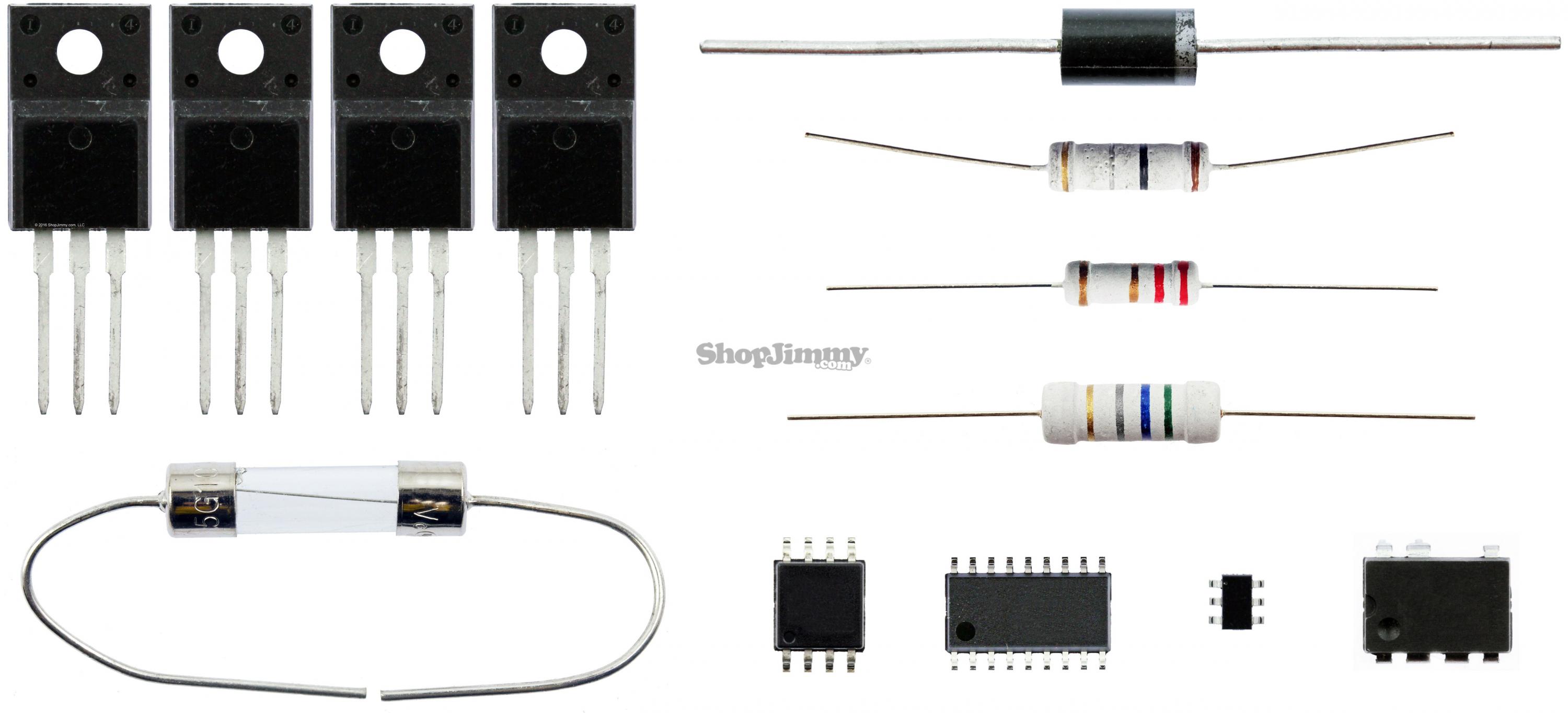

                            I'm waiting for another ps, I had bought the repair kit from shopjimmy and replaced eveything without issue although the numbers on little IC didnt match the one that it replaced. When plugging in and testing voltages, I thought I saw two flashes, then I see a flame coming out of the ferrite bead in the middle of the board as if it were a bic lighter. I then hear a pop like a popcorn kernel before getting it unplugged. I then ordered a ps from a company that showed up with the corner broken and crack in it so I cant test anything until I get a ps

                              cap we found voltages that were too low causing not enough to turn on the backlight circuit, t-con or dimming control, even though theres standby power, the ps is the first problem and the fact that theres no button combination, power, vol up or down that will show any sign of life on this set means there is an issue on the main and from what I'm told its theeeprom or voltager regulators or combination of them both

                                You're gonna put in is this one?
                                Sharp RUNTKB057WJQZ (DPS-168JP A) Power Supply Repair Kit LC-60LE600U
