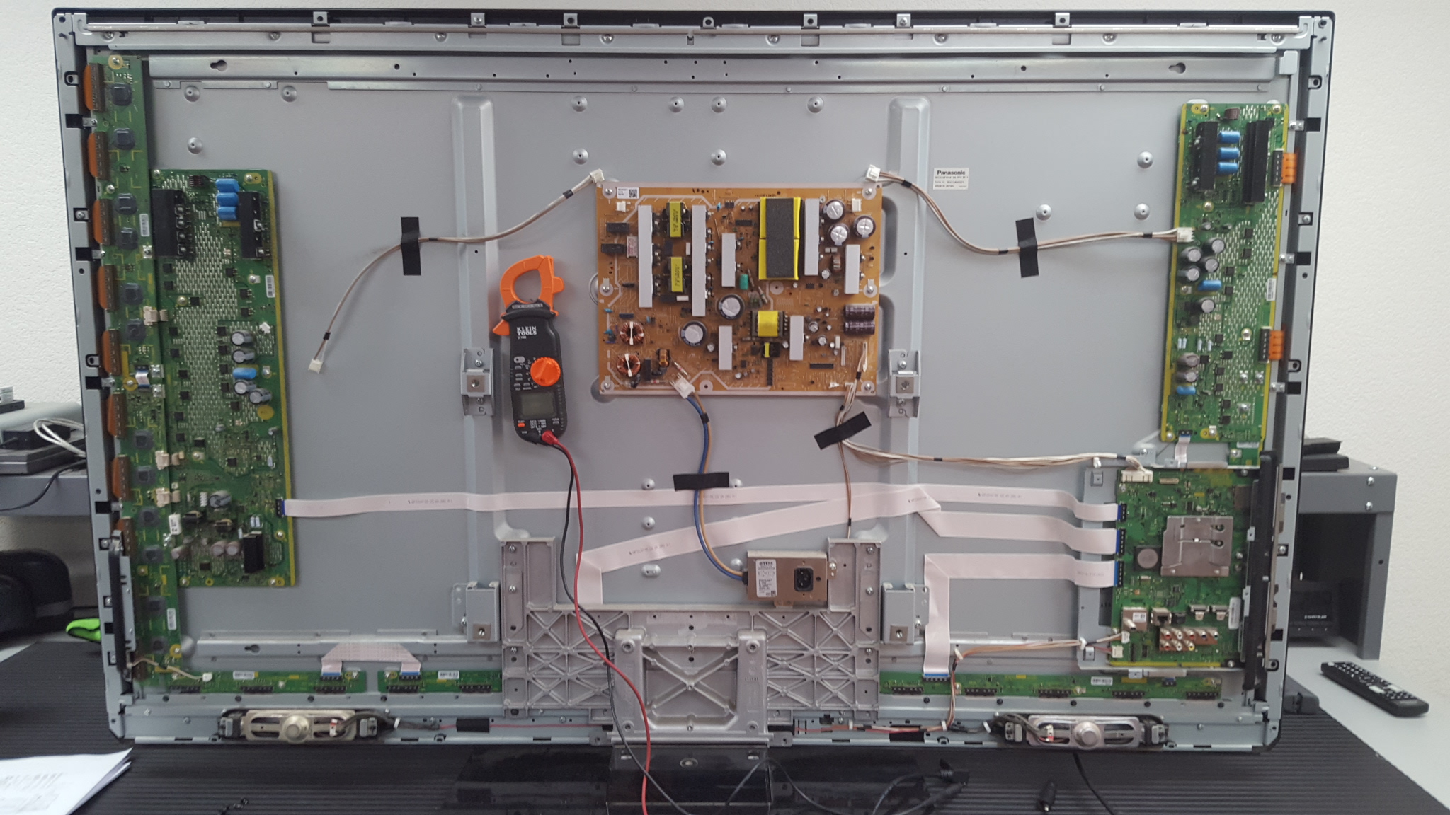

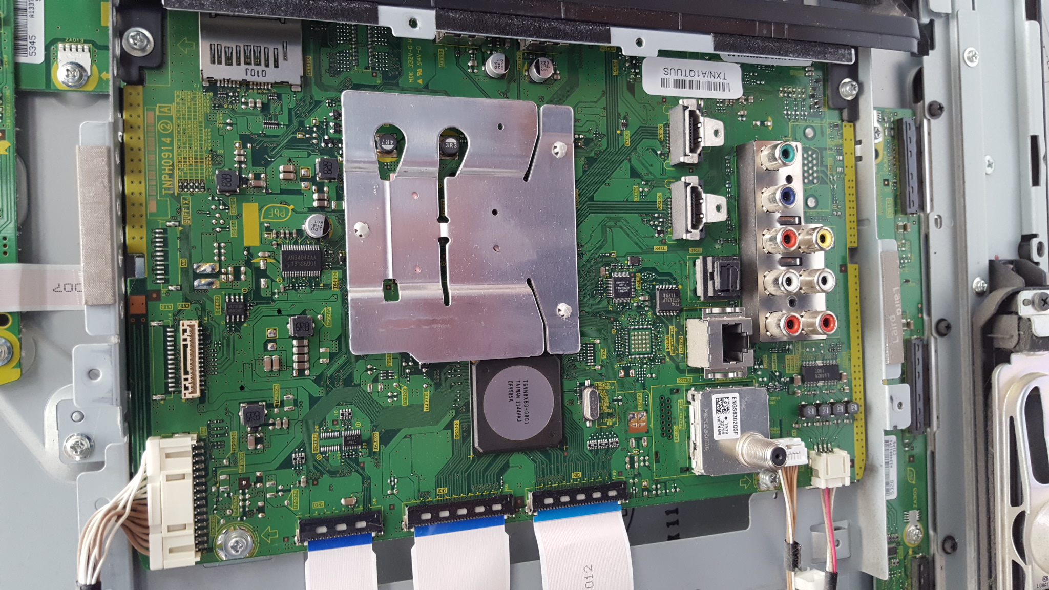

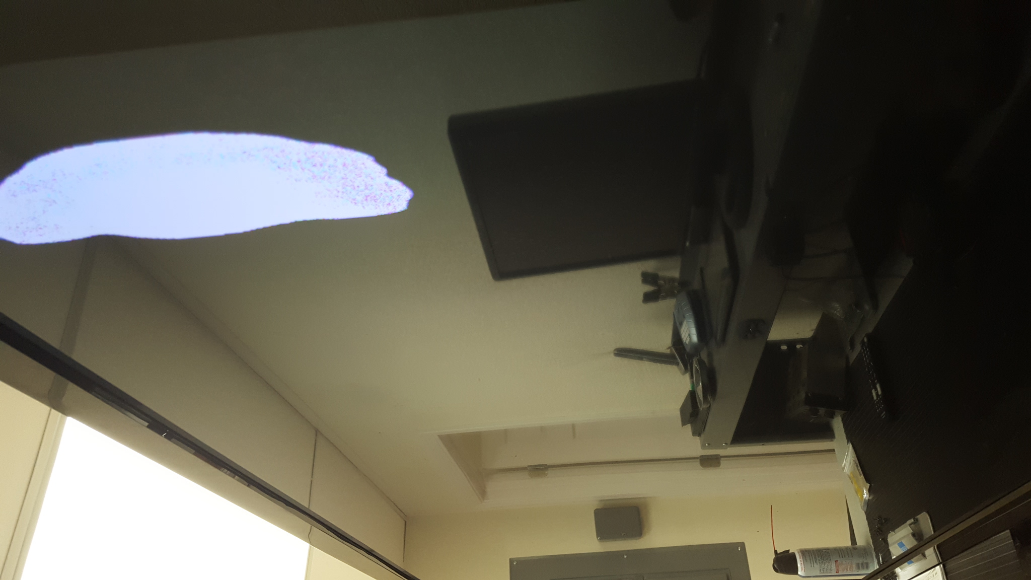

    Hello all,
    Someone may know just by looking at the picture, so I'll start with that. The TV turns on, the red LED remains lit (no blinking), but there's only a blob of lit pixels in one corner. The IC (T6VN8XBG-0001) on A board gets really hot after about 5 minutes then it shuts off. Measured 116F with infrared thermometer. I'm thinking panel or A board?
    Started by checking for shorts:
    P11: Pin 1 to chassis: 8MΩ (Vsus)
    P11: Pin 4 to chassis: 15kΩ (P15V)
    P35: Pin 1 to chassis: 6MΩ (Vda)
    Green LEDs on SC and SS are lit.

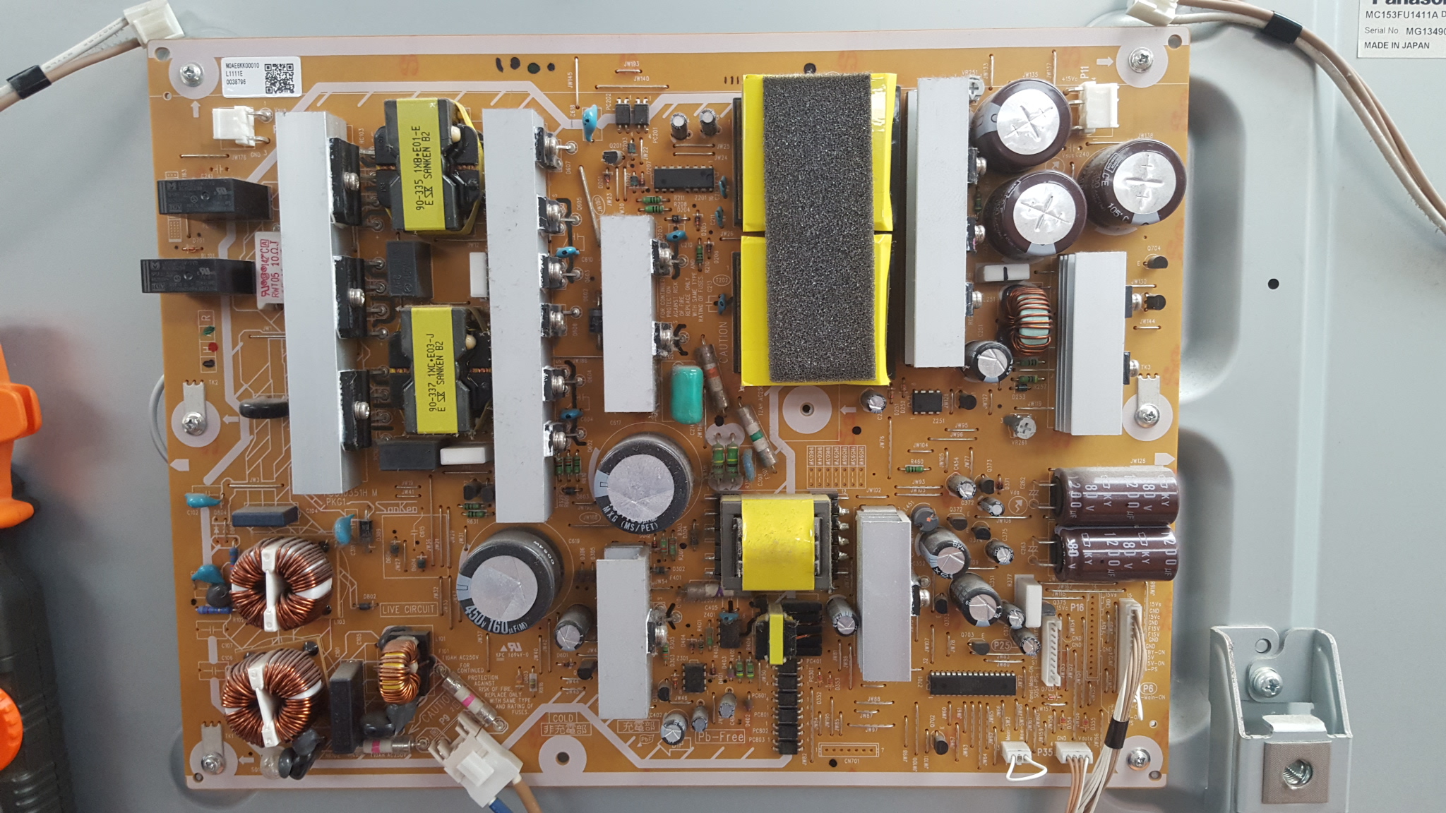

    P board:
    P2: Vsus: 210V
    P11: 15V: 15V
    P6: 15Vs: 15V
    P6: GND: 0
    P6: 15Vc: 15V
    P6: GND: 0
    P6: F15V: 15V
    P6: F15V: 15V
    P6: GND: 0
    P6: GND: 0
    P6: F-STBY-ON: 3V
    P6: STBY5V: 5V
    P6: STBY5V-ON: 20mV
    P6: SOS4-PS: 4mV
    P6: S0: 0
    P6: S1: 3.2V
    P6: 1: 3.2V
    A board (p/n TNPH0914):
    TP3520: 15V
    TP3534: 15V
    TP3522: 15V
    TP3526: 5V
    TP5506: 5V
    TP9276: 5V
    TP9273: 1.2V
    TP9201: 3.3V
    TP9268: 3.3V
    TP5293: 3.3V
    TP1110: 4mV
    TP4954: 1.6V
    TP4953: 1.6V
    TP4952: 1.6V
    TP4951: 1.6V
    SC board (p/n TNPA5399):
    TPS0S7: 140mV
    TPS0S6: 0V
    TP101: 5V
    TP98: 5V
    TP126: 0V
    TP82: 15V
    TPSC1: 160mV
    UHZ: 5V
    TPVAD: 63V
    TP57: -117V
    TPVSUS: 210V
    SU board (p/n TNPA5343):
    TPSU15: sometimes 2V and sometimes ~150mV (??)
    TPSU16: same as TPSU15
    TPSU17: -126V
    TPSU18: -131V
    SD board (p/n TNPA5344):
    TPSD15: 0V
    TPSD16: 2V
    TPSD17: 1.2V
    TPSD18: 0V
    TPSD19: 40mV
    TPSD20: 55mV
    TPSD21: 0V
    TPSD22: -131V
    TPSD23: -126V
    TPSD24: -126V
    TPSD27: -5mV
    TPSD28: 140mV
    TPSD29: 1.9V
    SS board (p/n TNPA5400):
    TPVe: 135V
    VeRef 1: 2.5V
    VeRef 2: 2.5V
    P5V: 5V
    TP057: 0V
    TPSOS8: 5mV
    TPSS1: 108V
    TPVSUS: 210V
    P15V: 15V
    Panel p/n MC153FU1411A
    Thanks for any input!!
    Edit: Not sure why pictures are rotated, sorry.

    Re: Panasonic Viera Plasma TC-P60S30 (weird blob on screen)
    I would think that is a bad panel.

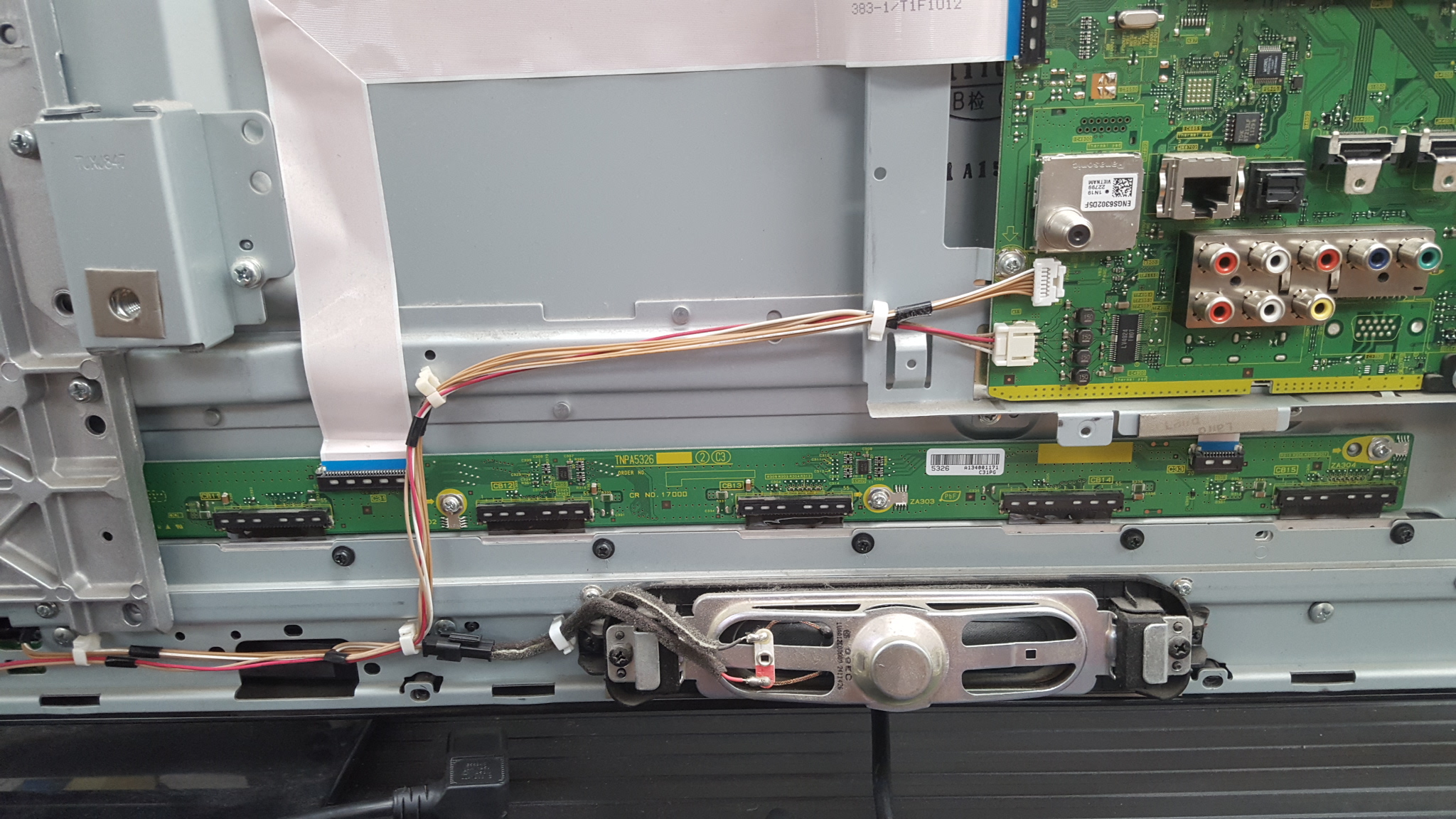

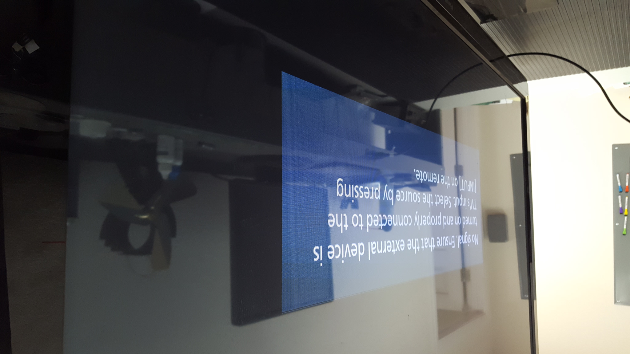

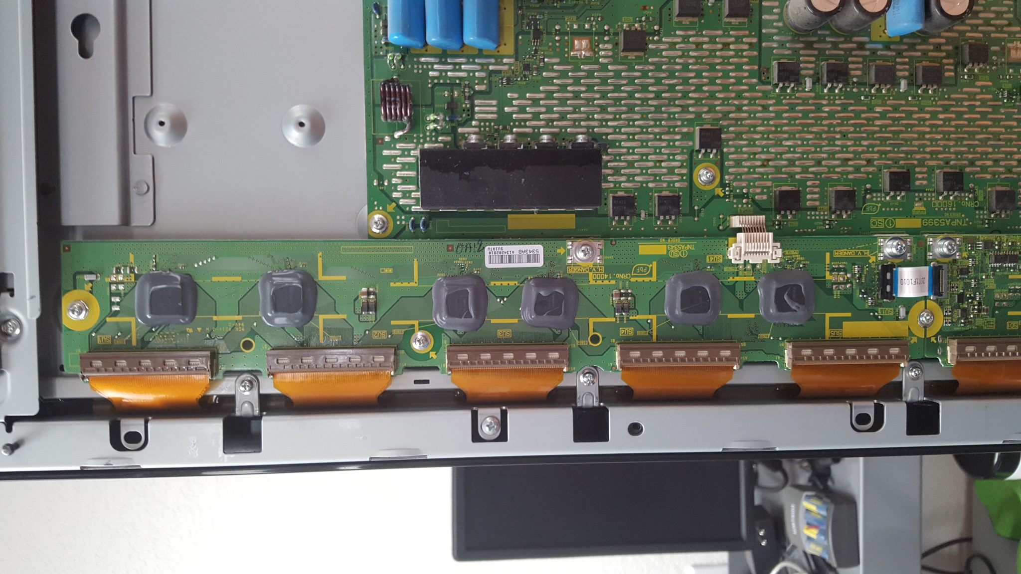

      Reseat the panel address driver cable for that area of the screen.
      • joeblah
        • Apr 2016
        • 65
        Thank you dskall.

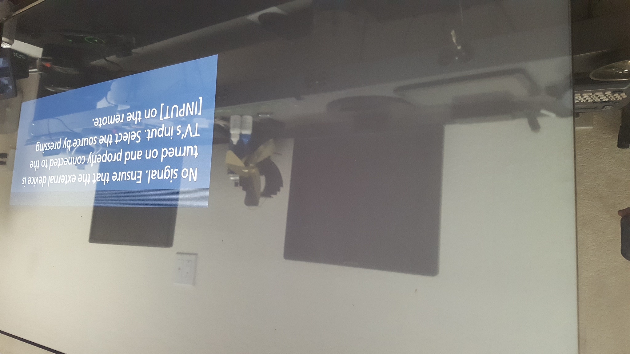

        Hot damn, ReeceyBurger! Re-seated every damn connection possible and now I can actually see the menu. Blob is gone. Still some lines on the upper half, maybe re-seat the SU cables again? Pictures attached. Thank you!
        • joeblah
          • Apr 2016
          • 65

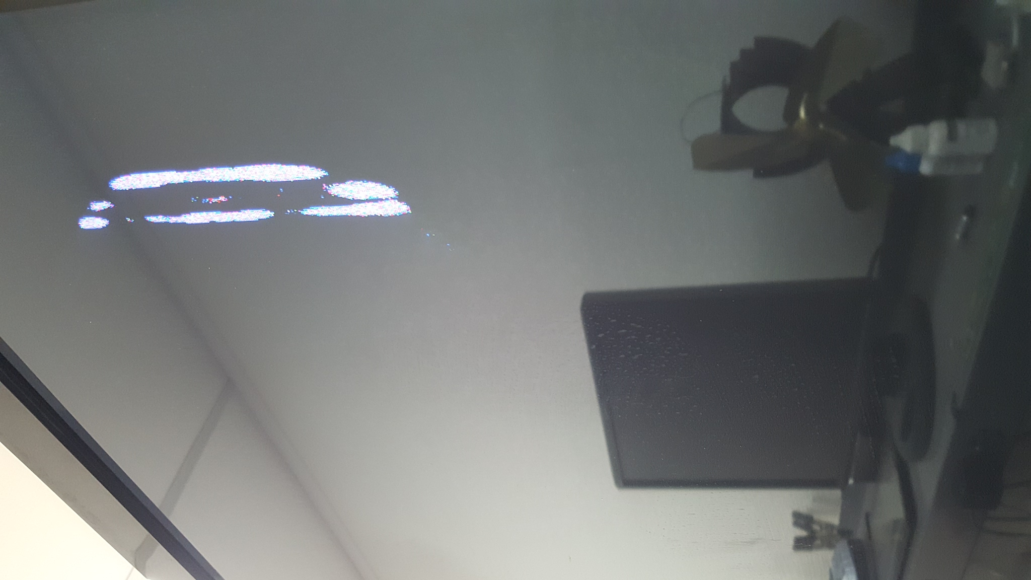

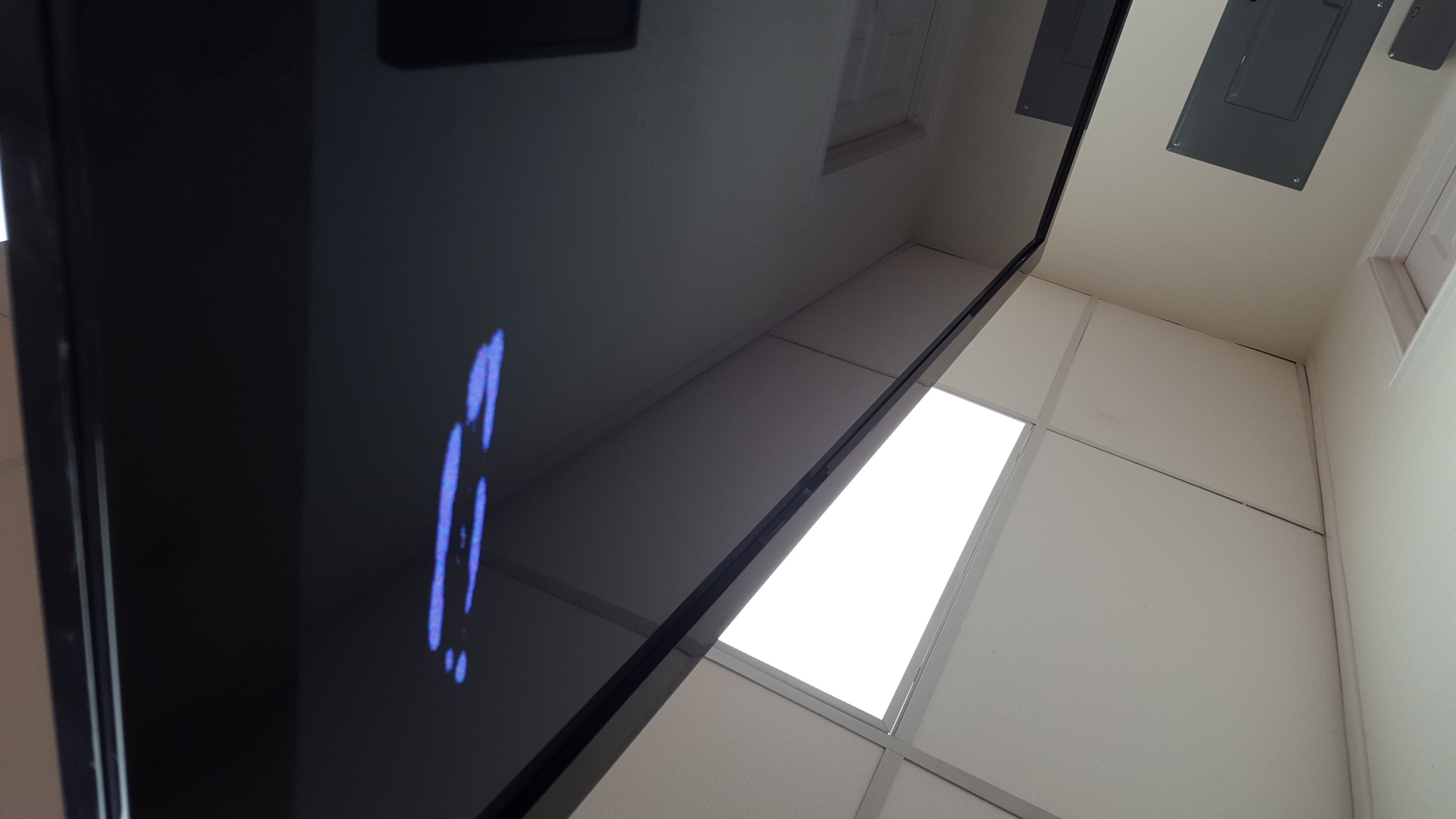

          Edit: 2nd picture gives a better indication

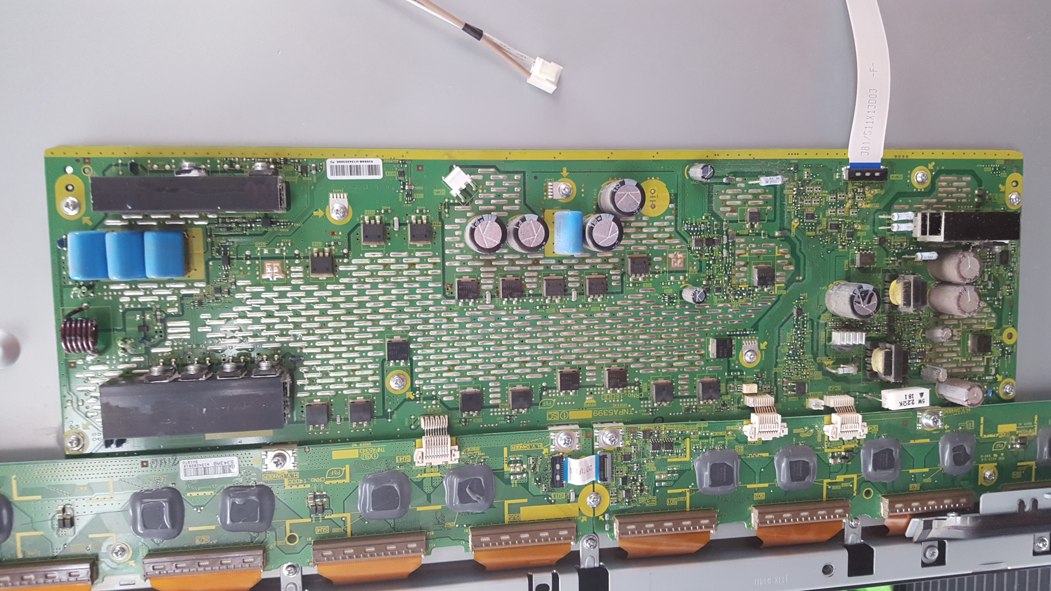

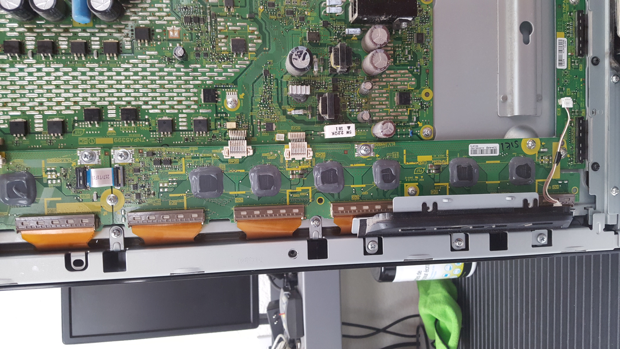

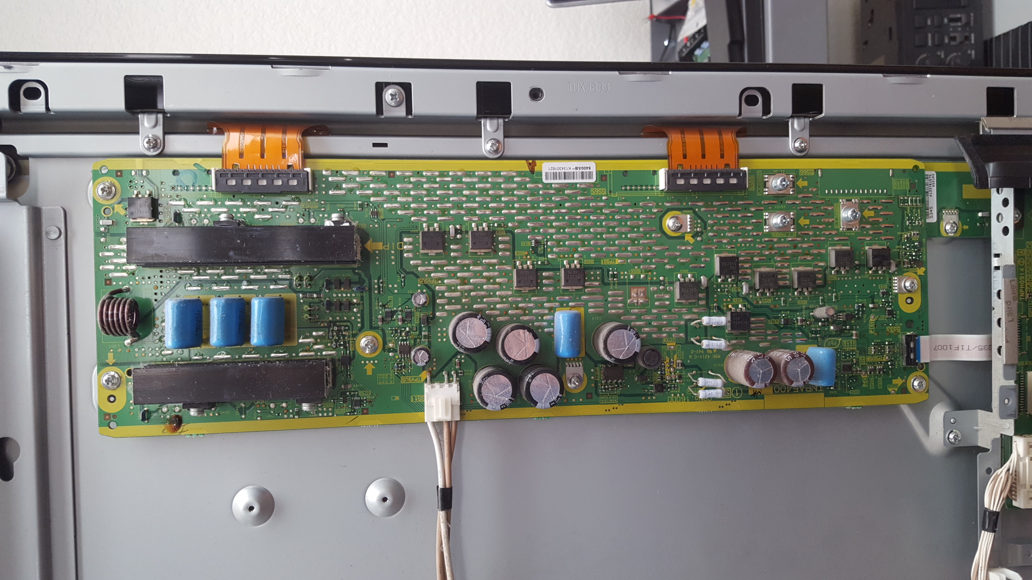

              Well, not out of the woods yet. Re-seated the SU connections again to try and fix the horizontal lines. Now the screen shows nothing and I get 7 blinks on the front panel LED. Sprayed the connections with Deoxit. Tried going by the attached troubleshooting guide below. Power board no longer gives any Vsus. No voltage at Vda or 15V either. Vsus to chassis is open. Anyone suspect power board?
                Try disconnecting y main and x and see if it will power on?
                  You didn't happen to reseat them with the power on did You?
                      heavy, still get 7 blinks with x/y disconnected.
                      freak, excellent question, I did in fact reseat them with power on. I was tapping the connections and could tell which ones were acting up, so I reseated them with power on. did I nuke something? dumb move!
                              Reconnect X Sustin, disconnect Y Sustin both power cable and flat ribbon see if it changes to 6 blinking lights when powered on. remember safety precautions. Panny calls it the SC but is same as = Y Sustin which is also connected to SU and SD which is also called Upper and Lower buffer boards respectively. in case you didn't know.
                                  heavy, thanks, tried that, it changes to 8 blinks.
                                  should i just replace both SS/SC? they're only ~$20/each on eBay.
