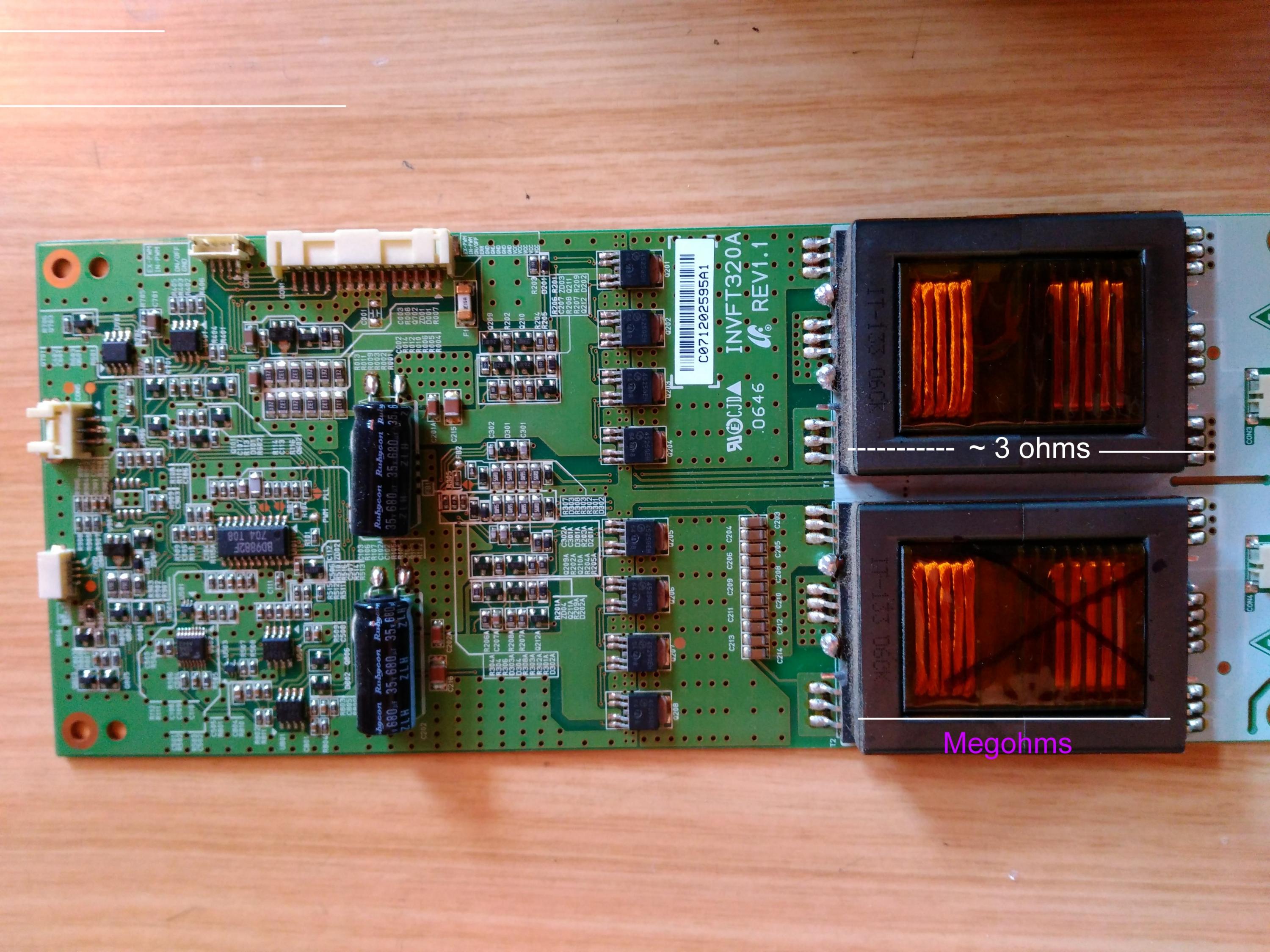

    This is an inverter used in a range of 32 inch CFL TVs. Mine has an open transformer winding. Thought maybe someone had one in the bottom of their parts drawer? Or maybe even the transformer, which has a part number of IT-133 06CK typed on it.

    Ironically, I stripped down the same model for scrap a couple of years ago and I sold the inverter! When fault finding today's TV I had no PS-On signal from the mainboard. I'd saved the previous mainboard because I was unable to confirm it was functional. Dropped it into this current repair and everything came up except the backlights. Flashlight test showed all other systems functional, voltages to inverter were correct. Troubleshooting inverter led to the conclusion the transformer had failed.

      I'm assuming it's the high voltage winding, although the companion transformer winding reads ~3 ohms which suggests perhaps it's a primary winding? Very hard to trace circuit as the transformer tracks are whited out. I do have a schematic so I'll pull that out and see if I can find how the windings are configured. BTW, the fuse on the board is OK.

        You have two transformer drive circuits (4 MOSFETs per transformer). So even if you have one bad transformer you should see the backlights from the good transformer come on for seconds before the protection circuit kicks in.
        We need good clear high res straight shot pictures of the board to see how the circuits are laid out on the board.

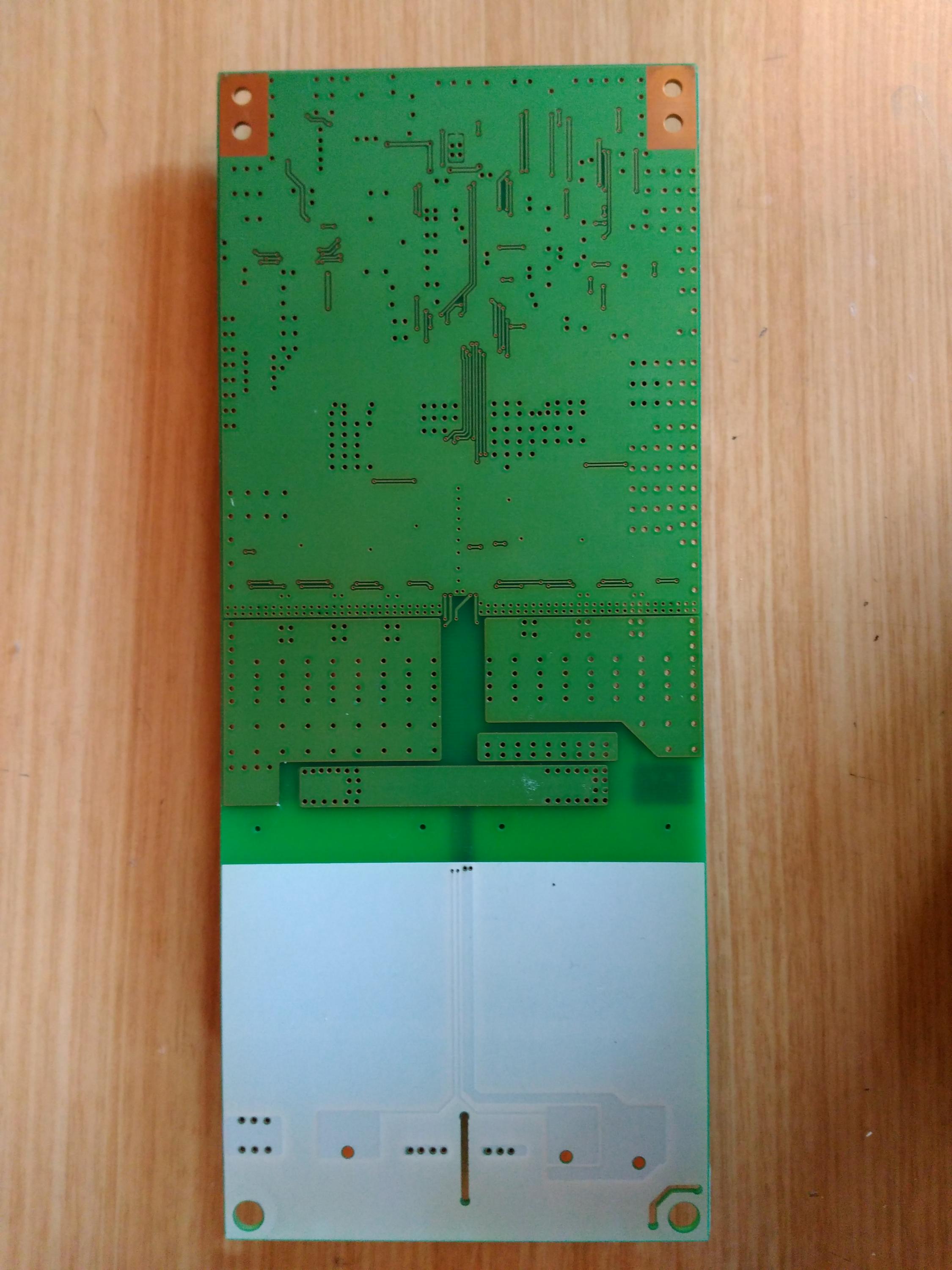

          The manual does not include a circuit diagram for the inverter. The reverse side of board has no tracks. I suspect it is a multi layer board. I've tried to indicate in the pics the discrepancy I was measuring.

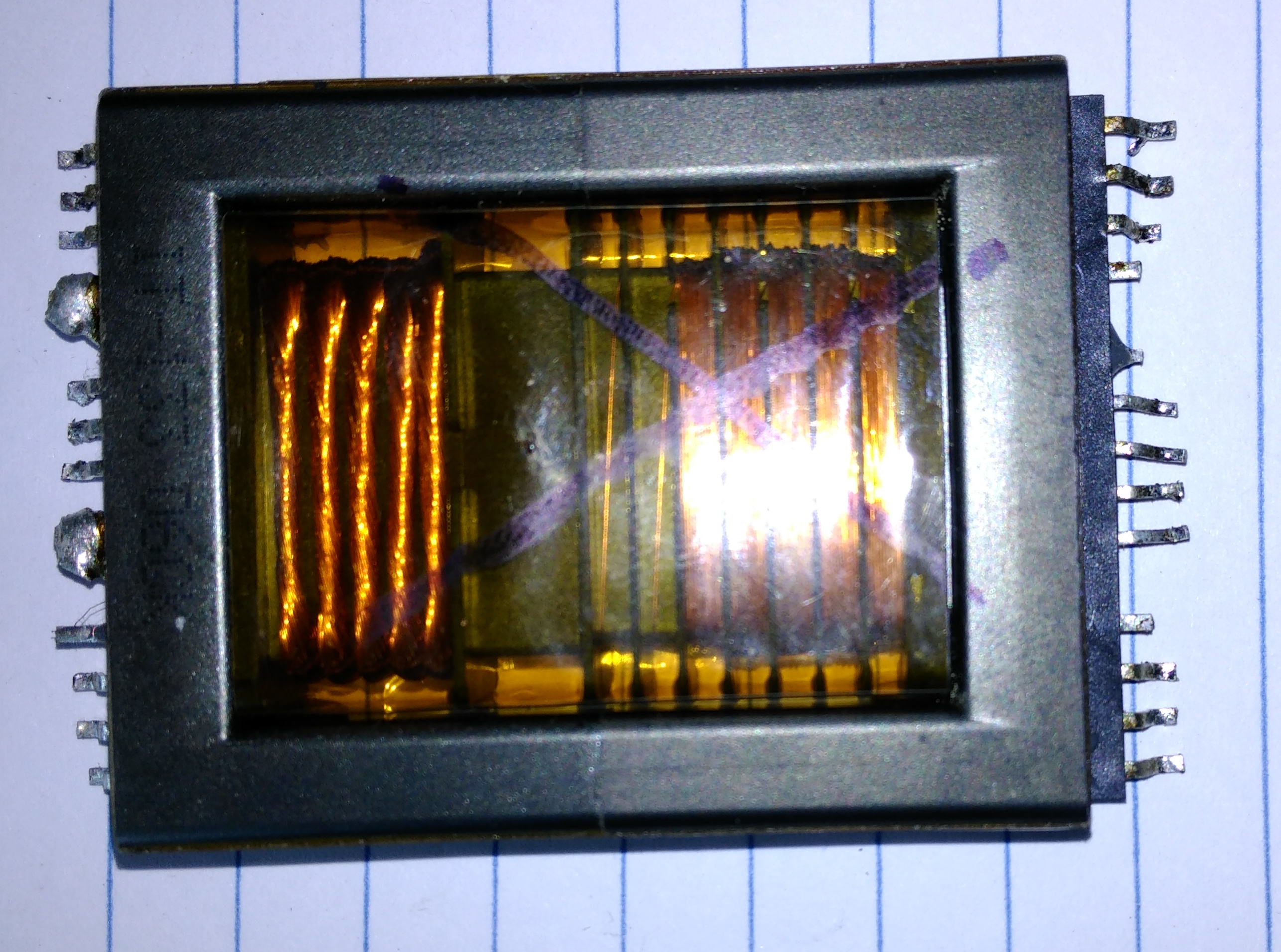

            At this point I would remove that suspected transformer and look at the bottom side to side what condition it has and that will also show us how the HV winding is connected to the legs of the transformer.

              It's the strangest thing Bud. I can't get any continuity on the secondary side of those transformers. I mean, I know how a transformer is configured. There's 6 tabs coming out of the transformer; 3 aside I'm assuming. On the primary side I get a very low DC ohms reading across two of those tabs (the upper two in the image shown in post above). No apparent connection on the third tab. But apart from that, nothing on any other tab. Nothing on the secondary side. And it's the same for both transformers. Got me thinking I didn't know how to use a meter! I de-soldered one of those transformers but no secrets were revealed. The power FETs check out OK.

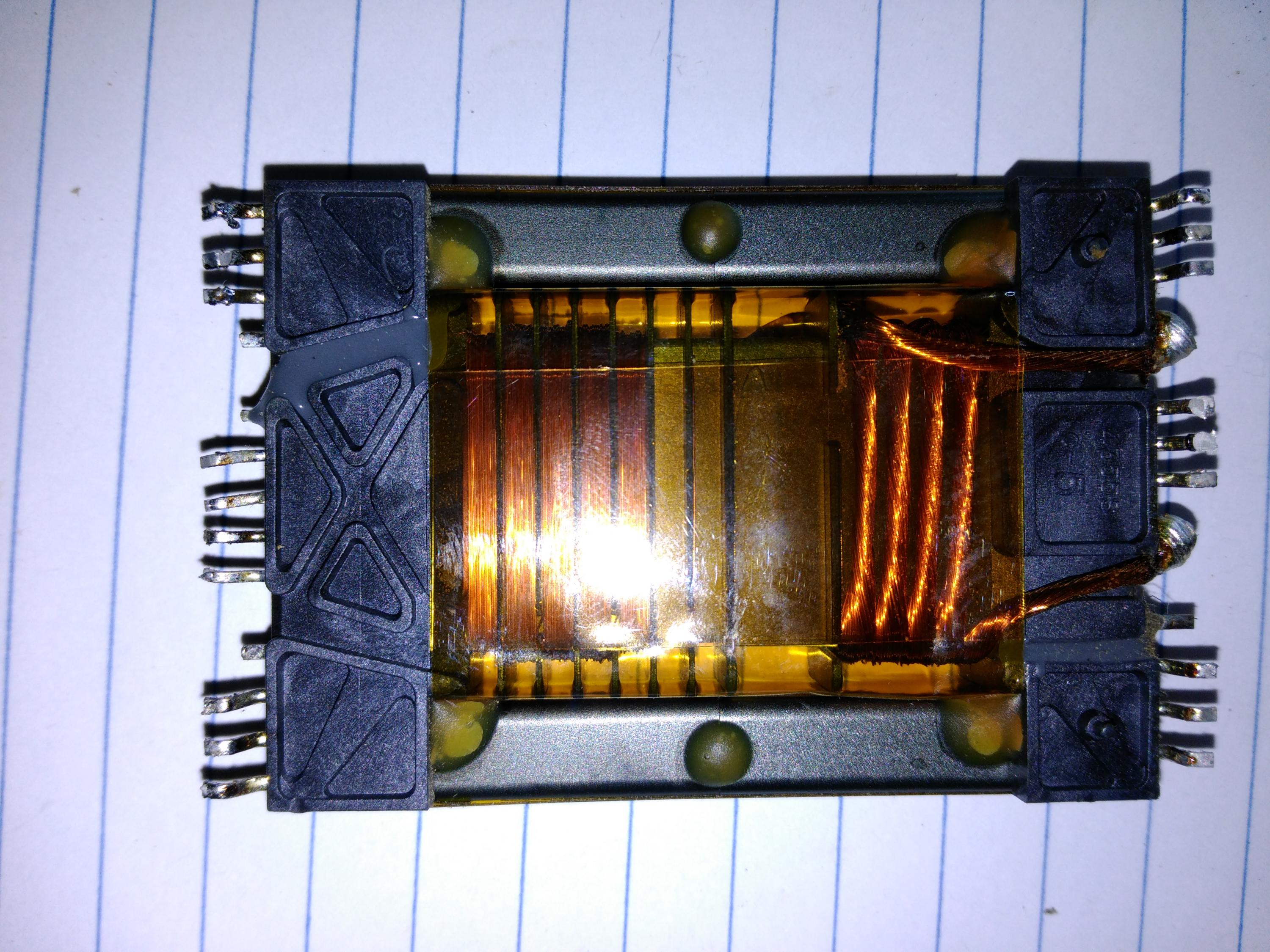

                Can I see good clear pictures of the bottom side of the transformer?

                  I'll get those pics to you tonight (our time) when I go home from work.

                      Counting the transformer tags from top left in a counter-clockwise direction, 1 & 2 are the primary windings with virtually 0 DC ohms. The secondary appears to be 3 and 5 with a ~15 DC ohms. 4 and 6 appear not connected and are probably mounting supports?
                      Both transformers measure the same. Not sure why my initial measurements suggested a bad TX?

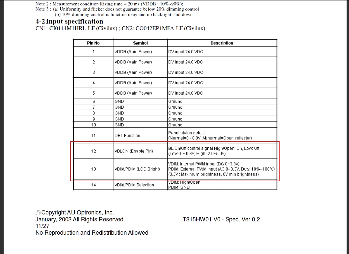

                          One thing we do not know is that if you are getting the BL-ON signal or not.

                              The ON/OFF pin is the BL-ON pin so check and see if it has >2.5VDC when TV is ON.
                              Might as well check the IN and EX dim pis also.
                              I was assuming that you had already check those signal since you seem to know about the PS-ON so I would think you will know about other signals as well.

                                The reason I was prepared to purchase a complete new board was because I did measure BL-On and it was about 3.5volts. I had good 24 volt supply, no sign of CFL's firing and then going off after 2 seconds. In the past when repairing TVs I've seen these symptoms, realised it was a SMT board that was essentially too difficult for me to fault find and/or repair, so just bit the bullet and ordered another board.

                                Now I'm on my learning curve. Explain what the IN and EX DIM lines do, where they are driven from, etc?
                                  Re: Need INVFT320A Inverter
                                  Should IN be EN and EX DIM be P-DIM? Look again at the jack and see if you have another pin with the label PWM, P-DIM or ADJ. You have 24Vdc and BL-ON. So all you need to get is 4 LED strips and the Universal LED Driver Bd and you are well on your way to convert to LED, as an alternative.

                                        As labeled on the board:
                                        IN-PW?(M) = Internal PWM dimming
                                        EX-PW?(M) = External PWM Dimming
                                        ON/OFF = BL-ON BACKLIGHTS ON/OFF
                                        These signal are from the main board.
                                        the Dimming control signal will one of the two but not both.
