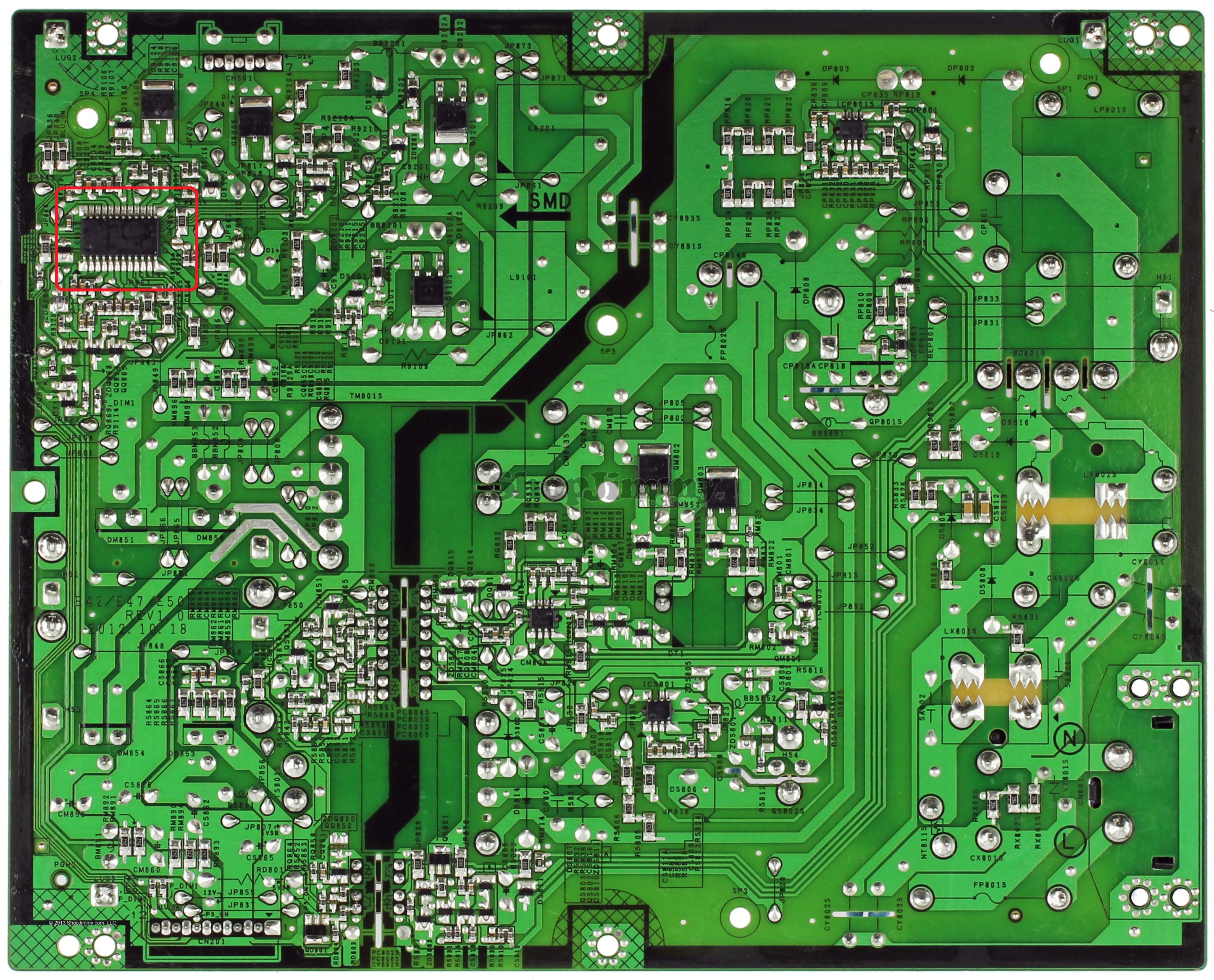

        What is the part number on the chip shown in the red box?
        Photo courtesy of Shopjimmy
                    very difficult to see... appears to be SEM5 28 with 179 below it????

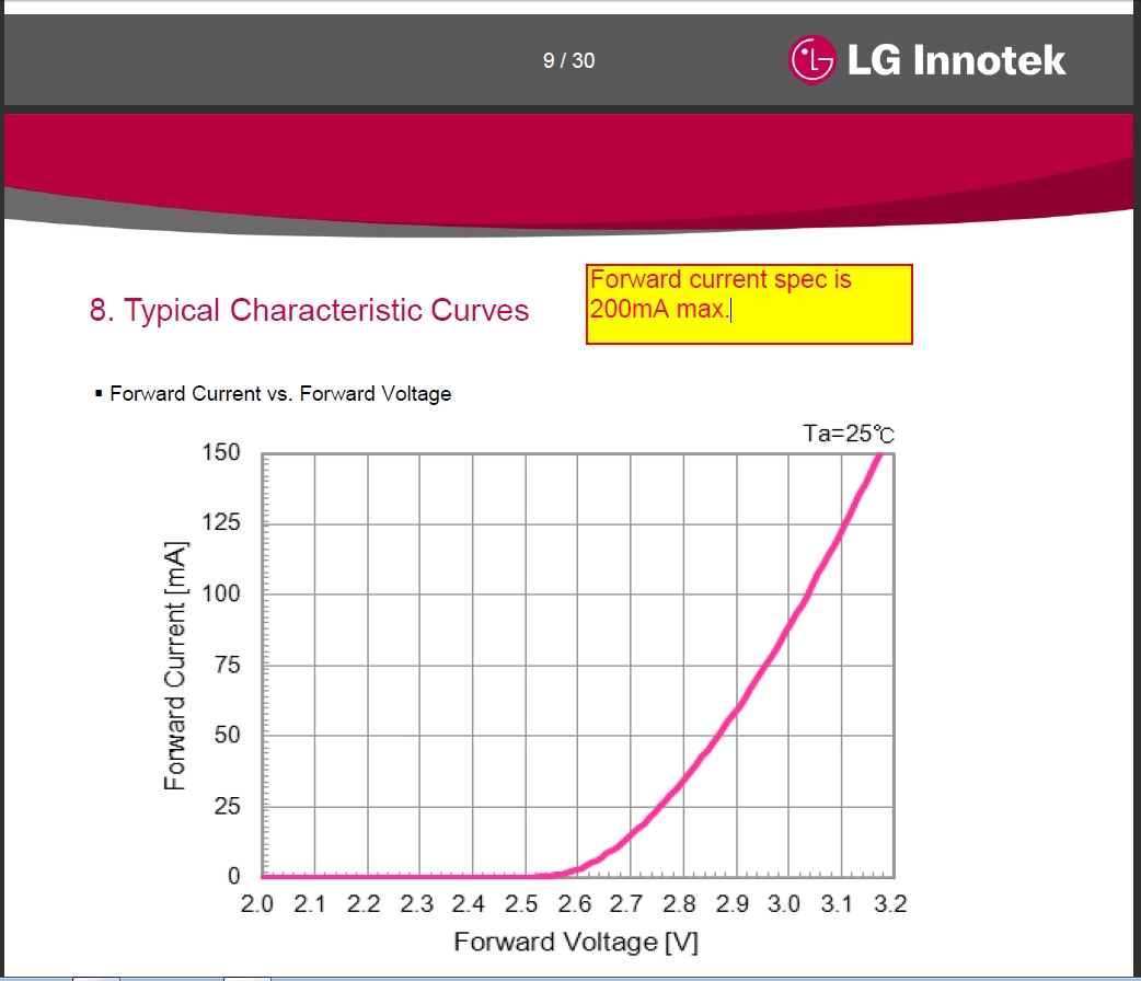

                        The problem with using the LED tester is that we do not know what the forcing current is set to, the Vf of the LED will vary with the Forward current being applied to the LED.
                        As you can see from the graph for the 200mA LED, you will see the affect of the current has on the Vf of the LED.
                        The LED used in this TV per spec sheet is 400mA, as you know, it is really pushing it, that will be more than 1W.
                        So the tester is probably not putting out 400mA so the readout does not come out as around 111V per spec. OP should put DCA meter in series with the output of the tester to see how much current is be forced through the LEDs.

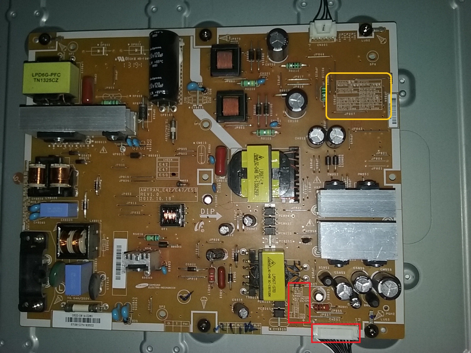

                            Re: Vizio E500i-A0 backlight on 1/2 second off 2 seconds
                            One red box shows the legend for the connector in the 2nd red box but unfortunately your picture is out of focus to be able to read them. There's also a another yellow box giving voltages and again cannot read it.
                            Perhaps you could post clear pictures of those two areas.
