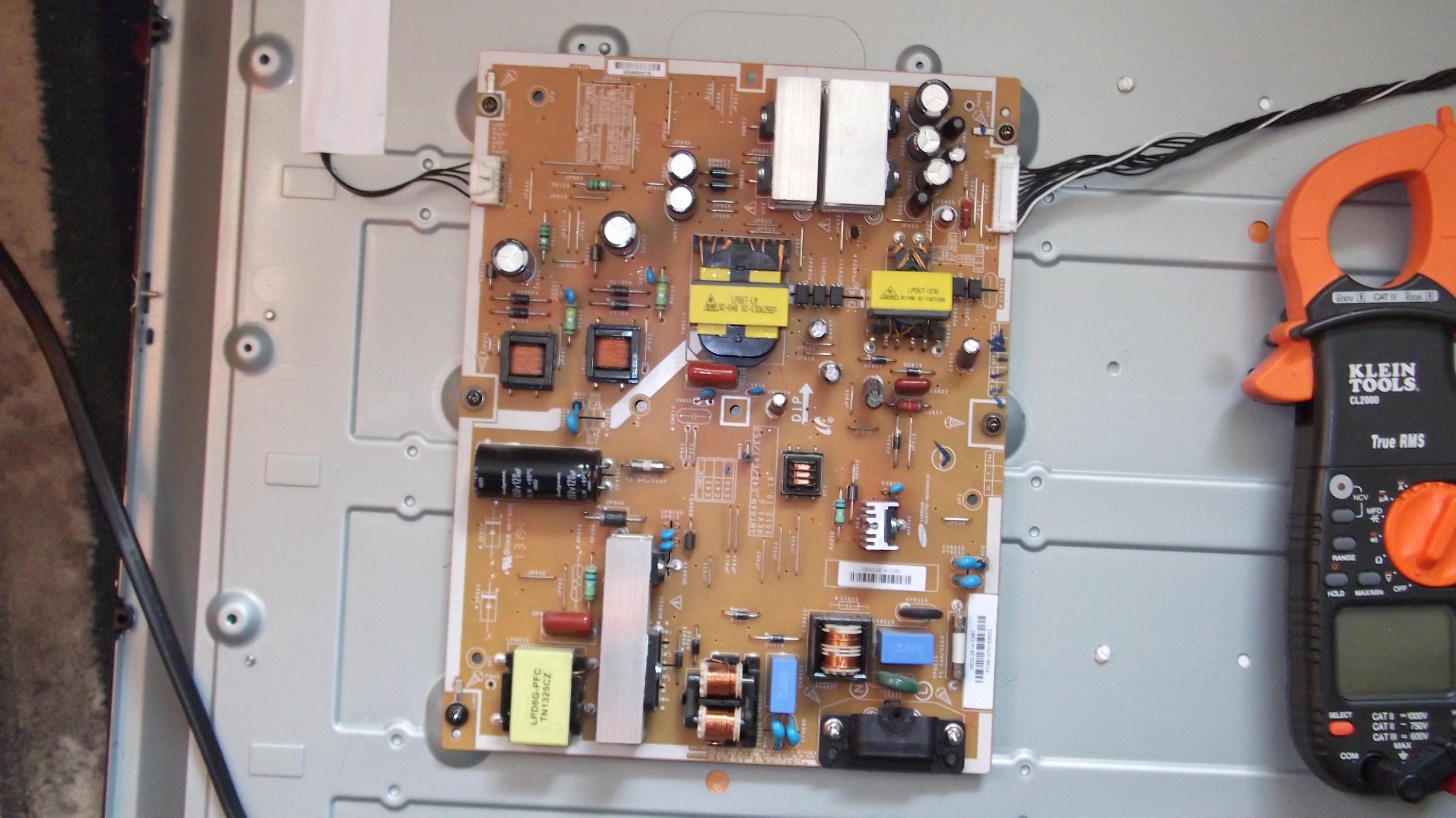

    My Vizio E500i-A0 TV has a power supply fluctuating an output of 124VDC-129VDC to the back lights (LEDs 1 and LEDs 2) with or without the back lights connected to the power supply/driver unit (0500-061400280) output.
    I do not see a working standby light on the TV(do not know where to test for it's power)
    The blue indicator light comes on when the TV is powered on and fades to off after a second or two. The TV has audio, the picuture/etc will flash on for about 1/2 second then go black for 2 seconds.
    The panel display is by LG [LC500DUG-(JF)(R1)]
    The main board is LAQKNTBP3500360
    No apparent burnout/etc on either board.
    I cannot identify the voltage regulators on the boards
    I have a current limiting power supply (max output 50VDC/2A) and wonder if I can test LED strings 1 and 2 separately.
    Need a schematic/diagram for the boards and your advice.
    I am thinking I should change both boards but need to test the backlights to verify they all work without complete disassembly if possible.

    Need some pictures of boards. I don't think you have enough voltage to check led's

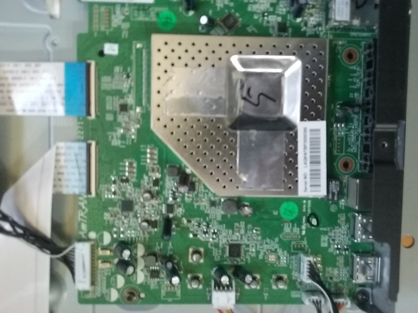

        Trying to figure out how to upload a pic. Hope this works...
        • j0etee1
          • Mar 2017
          • 15
          • united states
          Re: Vizio E500i-A0 backlight on 1/2 second off 2 seconds
          Okay I'll attempt this again. Pics were took with my phone...may need to get my camera out and figure how to get the pic to my laptop.. Real new at this upload stuff.

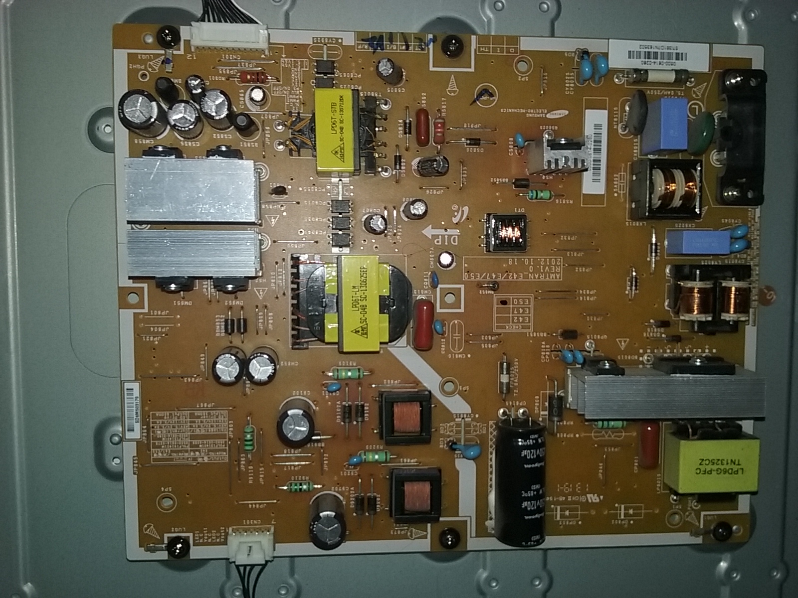

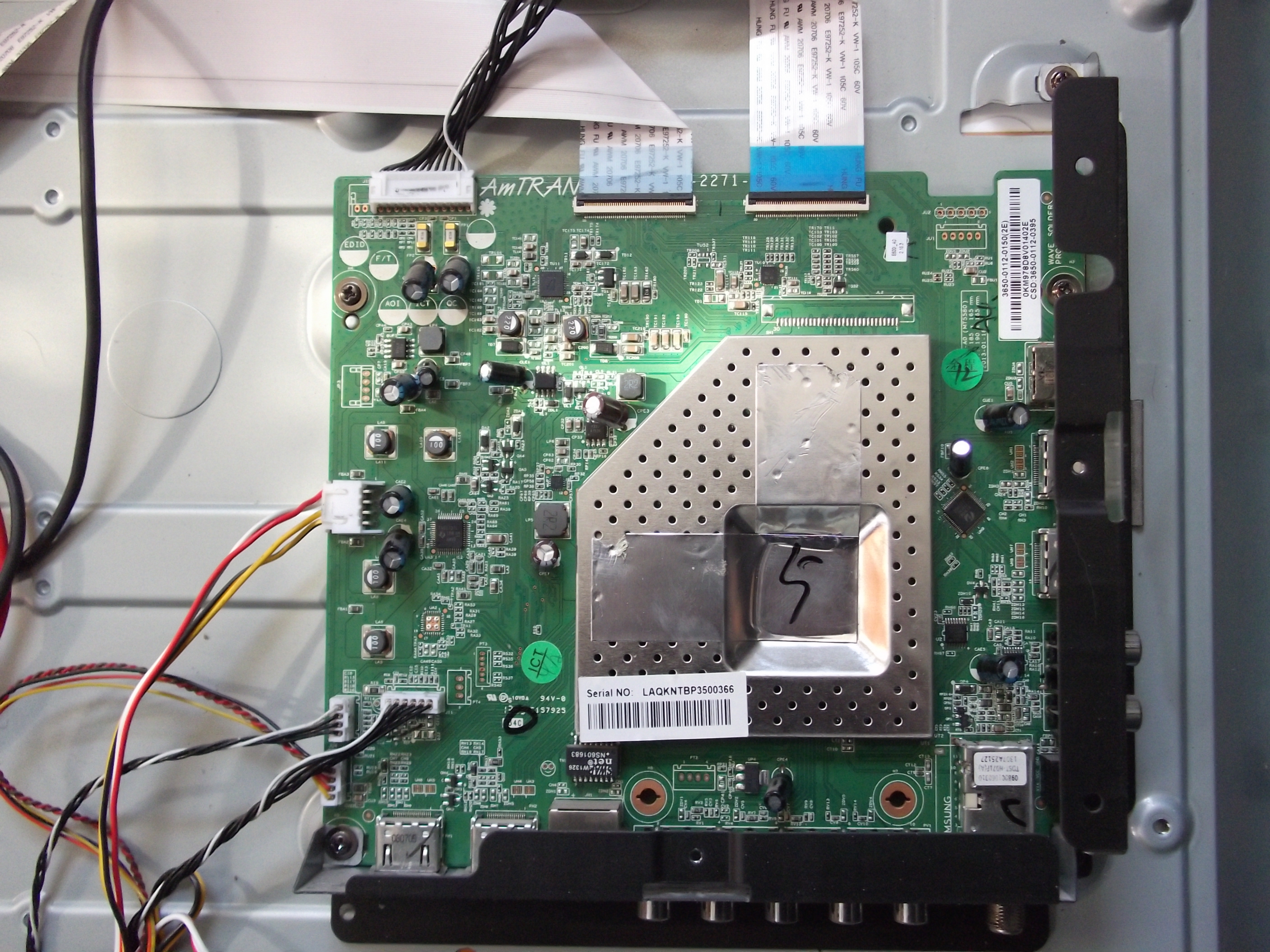

              here are possibly better pic of the boards. Can anyone assit me?
              powerboard is 0500-0614-0280
              main board is 3650-0112-0150
              serial number is LAQKNTBP3500360
              panel display is by LG LC500DUG-(JF) (R1)
              TV Model is E500i-A0
              got sound and got pic when back light LEDs flash on
              back light LEDs FLASH on 1/2 second off 2 seconds then repeats
              no standby led
              blue LED comes on when powered then fades out in a second
              124VDC-129VDC fluctuating voltage at output to LEDs connected or disconnected.
