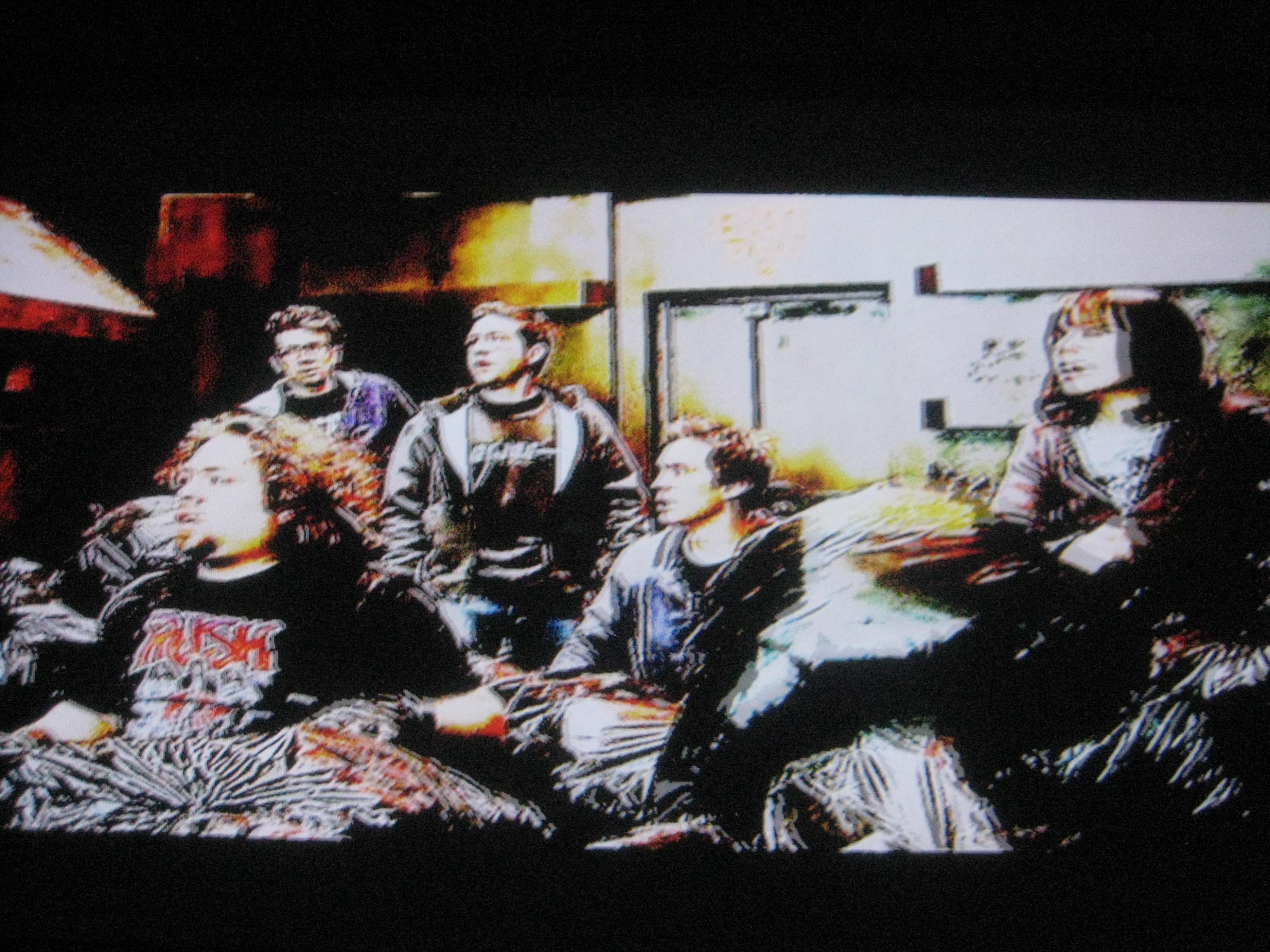

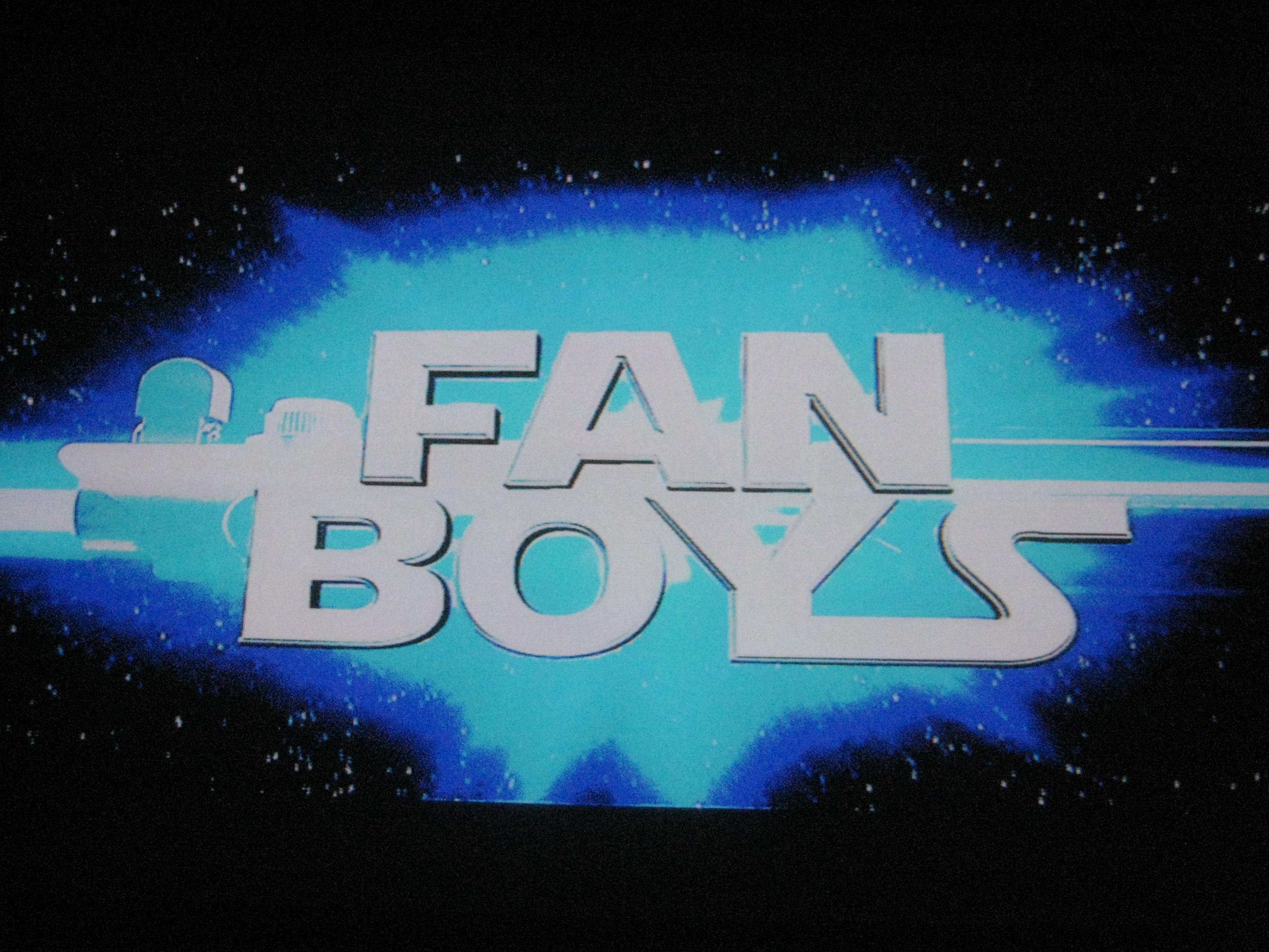

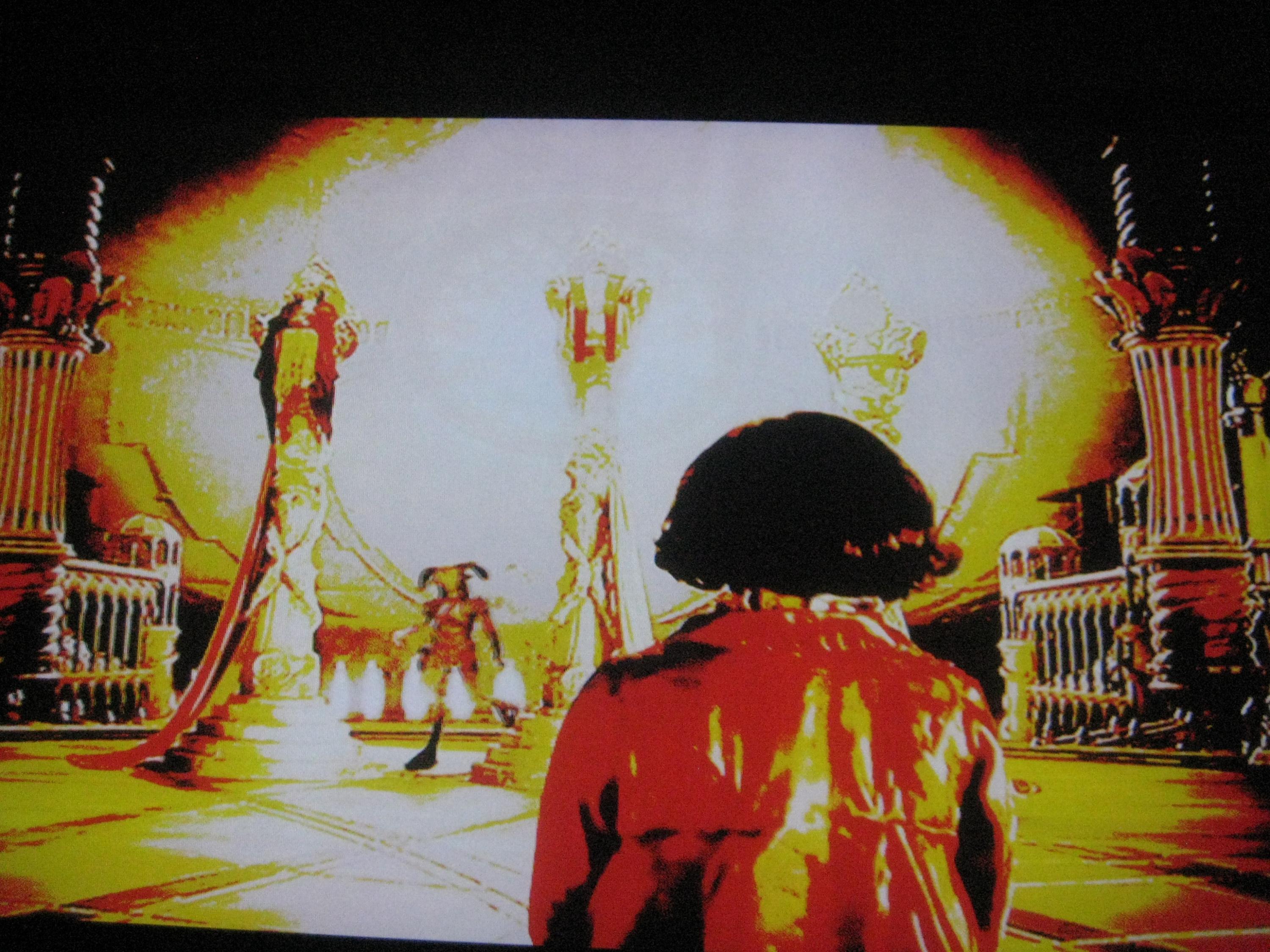

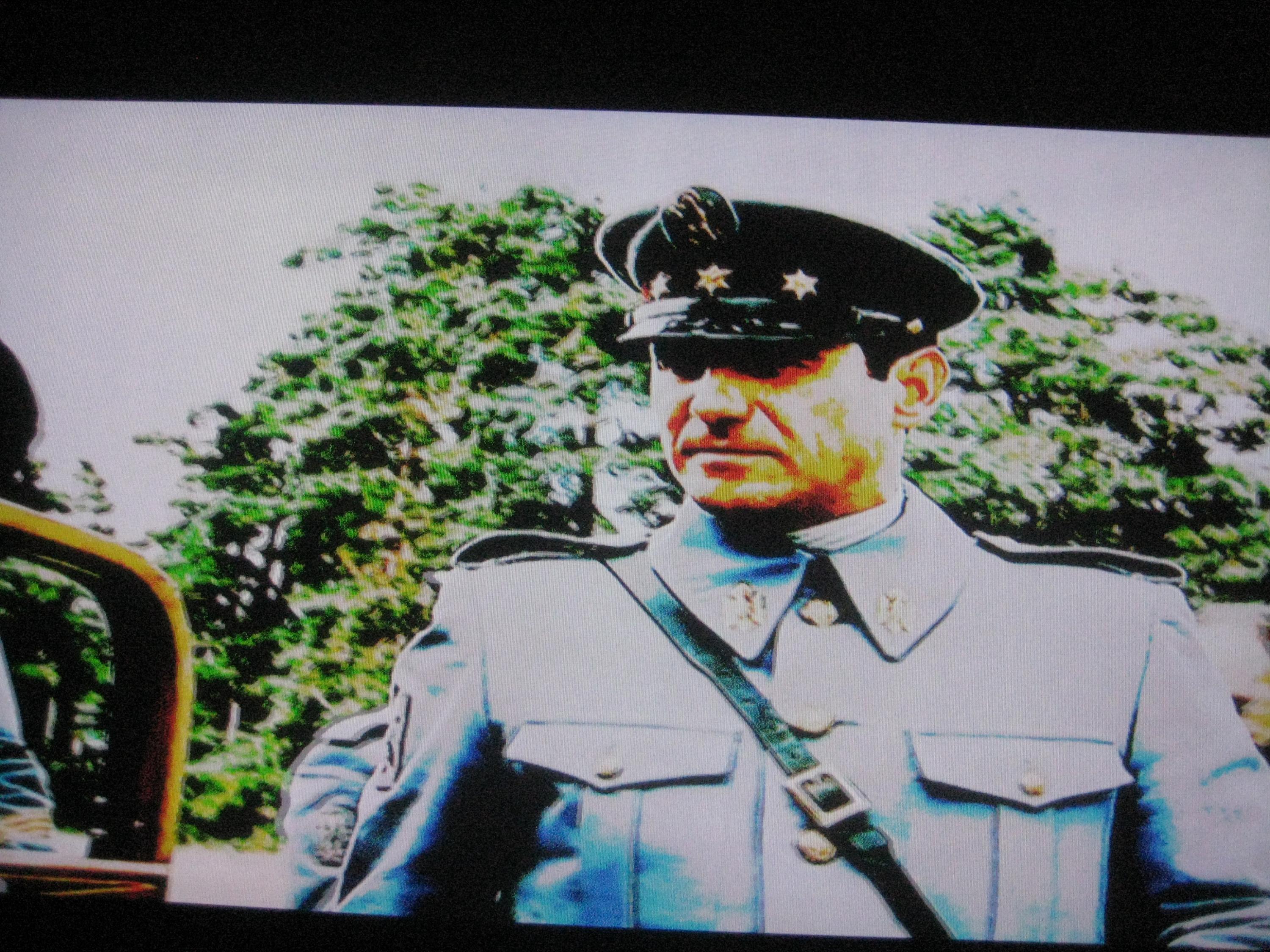

    hi guys,
    this is a tv that im working on the first time it arrive the zmain board was bad and the upper buffer board...so i replace them with new one....
    now i have the picture and everything working but the picture is so bad that there are missing colors,ect....picture included.
    did anyone ever had these problem after replacing the board.
    all reban seem ok an the both side.
    any help will be appreciated.thank you.

    Run the self test and see if your colours are OK

      his the self test the one that need a jumper around r452 and 451.i did forgot about this test...not sur is that is correct test.

        That is part of it. Do a search for "self test" because I think you have to remove the ribbon from the power supply to the control board.

            well i did the test and all colors are there but still ugly.could a main board do this even if there is picture and sound or most likely another problem...thanks for your help

              If you ran the self test and it passes then it normally suggests a mainboard problem. However in your case the mainboard does not appear to be the problem.
              I'm not a plasma expert but it may be your control board at fault.

                that the problem,i did change the control board also,i just forgot to say it....but me also am not a plasma expert..but thanks you for the time and help..very appreciated.

                  On the plasma panel at the back of the set there is a label with voltages given. Have you then checked that all the voltages on the circuit boards match the label?

                    yes all voltage are the same.have no more ideal what to check....

                      Have you done a factory reset via menu?

                        Zsus erc coils, resolder them. Or could be two resistors on Ydrive for Yfr that are failed.

                          Don't know a lot about plasma but you may have to go into service menu and change some settings. Put your old control board back in and see if that changes things.

                            I don't know about plasmas, but once i have followed a Samsung plasma thread, that has a tipical solarization defect, it was the main board, it seems to me that in plasmas gamma correction is made on main board.. possible? tell us the mainb. model code..

                              thanks for the time...i did change the upper buffer board,zmain board and the logic board.i did swape back the old one 1 by 1 to see if there was a defference but no always the same...i did a factory reset no change,now im trying to find if there is a firmware updates,ect...but the one i found did not work...so still checking.but at my experience i do think that Davi.p is right by saying the main board since that is where i supect the problem....but customer will not pay $200 for this board...so i guest it will be take apart for recycling by the weekend....thank you.
