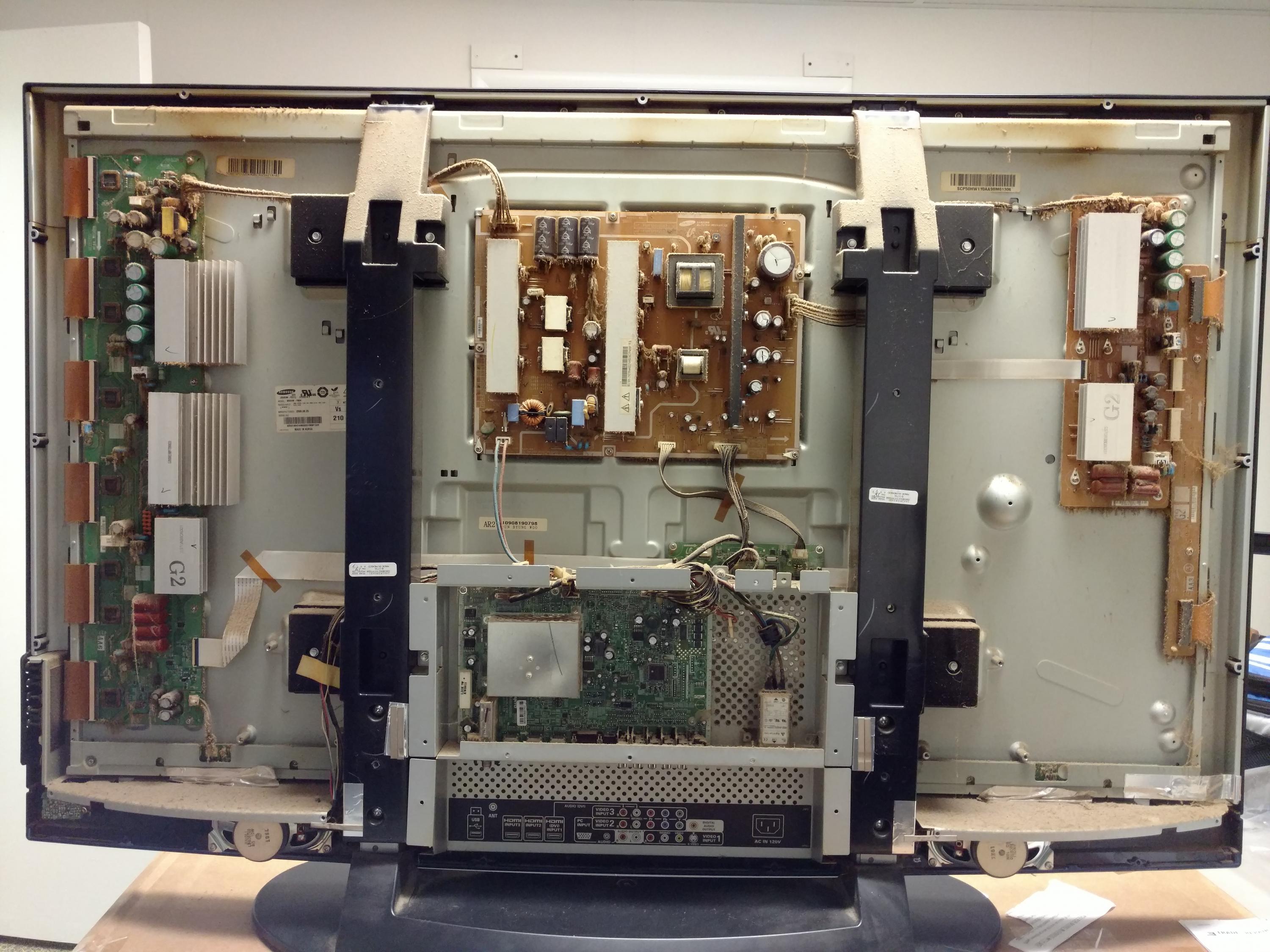

    I'm working on this incredibly smelly Sanyo Plasma and am trying to find out why it isn't working quite right. What happens right now is the power indicator will light up, the set will turn on, the screen will light up, and then the screen will power off after a couple seconds (nothing ever shows up on the screen) before it clicks off. Afterwards, it'll start the process again and try indefinitely to get fully powered up, even though it never gets there.
    In the time that the panel does spend powered on, Vs and Va look good.
    Any ideas as to where to start on this one?

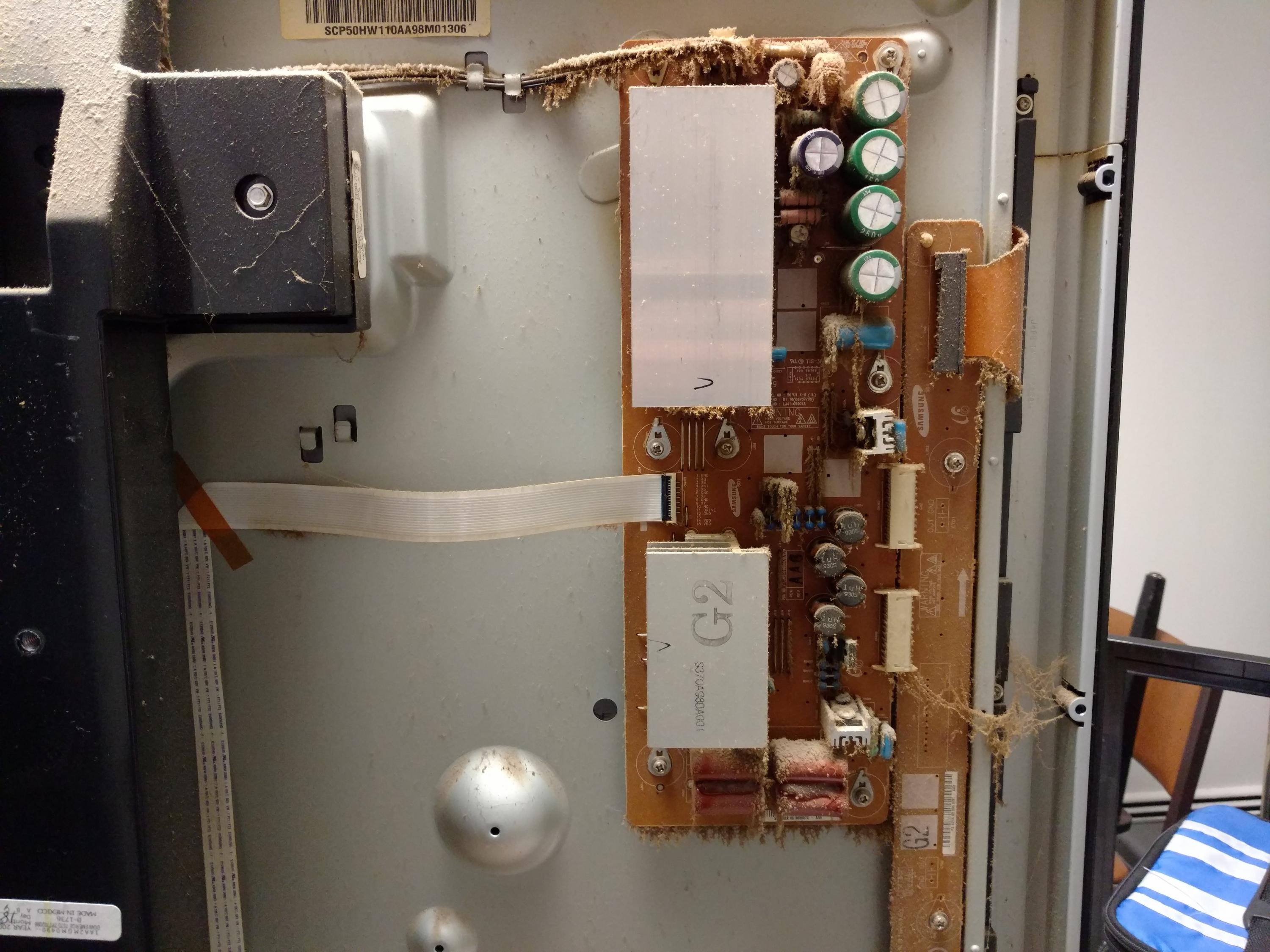

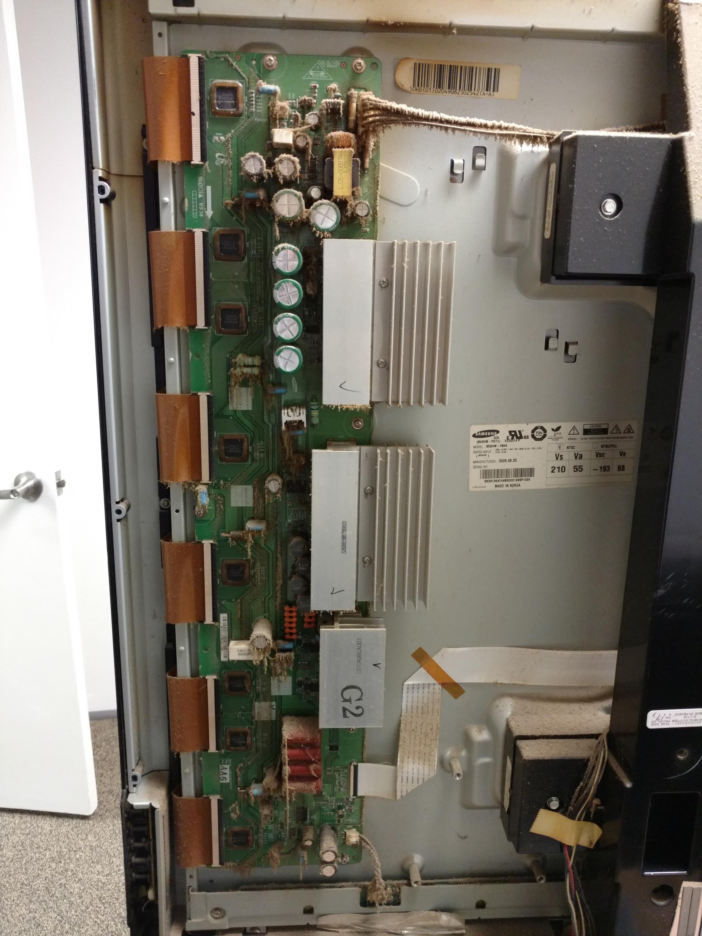

    From your pics looks as if y and x (left and right from rear) have individual connections from power board so disconnect first one and if no joy with vs staying on then disconnect the other. Not sure how protection circuit works on this set. Main board seems ok in basic operation. Why the smell ? what and where followed by why.

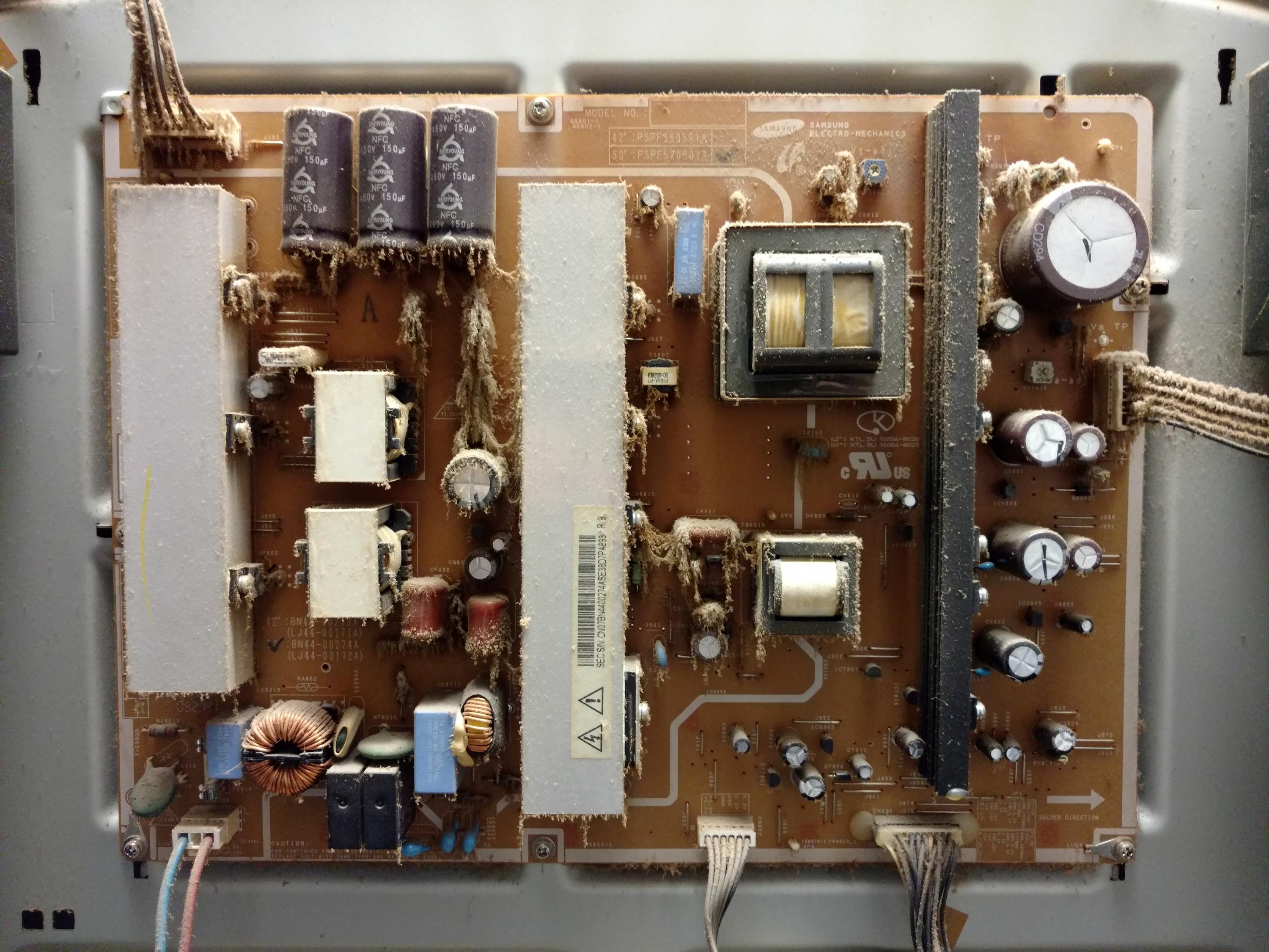

      heavy smoker. It is posible the caps are bad in the power supply even though they are not bulged, If they are bad the power supply just can't maintain the voltage.
      I just repaired a vizio power supply and the caps on the +5 looked just fine, even the voltage measured 5 volts but as soon as the tv was turend on it would shut down again
      it had 2 1000uf/10v completely open
        Same results with either one disconnected.
        That sounds reasonable. Are they wired in parallel or can I test them using my capacitor tester without having to desolder?
