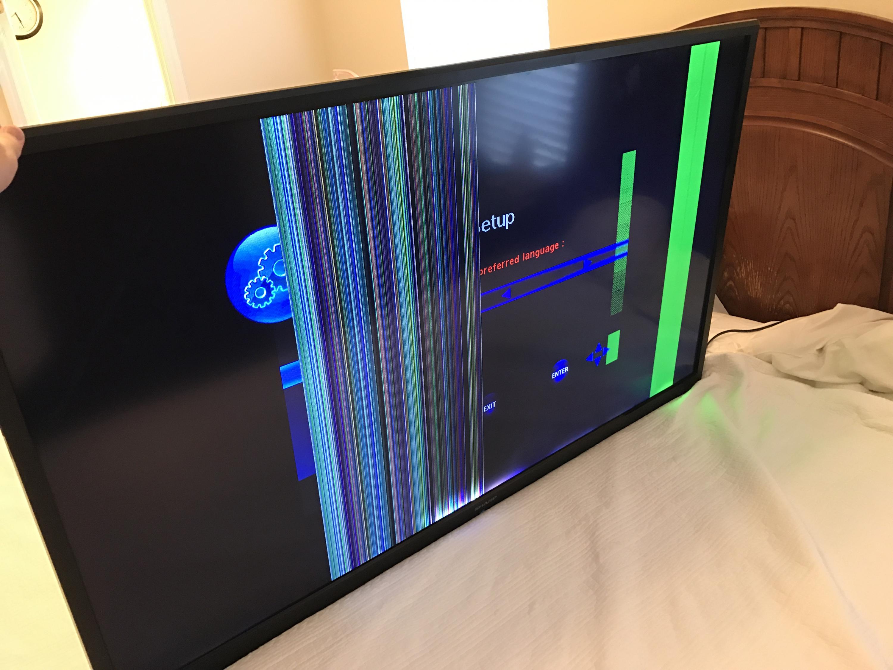

    So I bought this TV off of craigslist. The guy told me it had a border LED problem. So after a couple hours of checking voltages and trying the input/vol- reset, I can get it to power up but only if the LED's are unplugged. I can see snow when I shine a flashlight on the screen. When I plug the LED's back in to the power supply, the led's flash for a second then the whole thing shuts down. Have any of you ran in to this before? Is this a shorted LED strip?

            Ok, I found multiple problems. The connector on the power board had a couple solder joints that were bad. One had almost no solder. I repaired both of those. Now the LED's come on blindingly bright. But, there is one bad LED. Can I simply jump around it? Should I remove it? Do you know of any videos of how to do it?

                  Well, I jumped the LED just to see if it would work. It did. So now this is what I have. If I can fix this without spending a ton of money, I'll install a diode.

                    Re: Sharp LC-60le600u
                    Is this caused by a bad T-Con board?
                      If you took panel apart reset ribbon connectors. Or you possibly damaged a tab bond to panel.
                        Yeah there is damage on the panel bottom.
