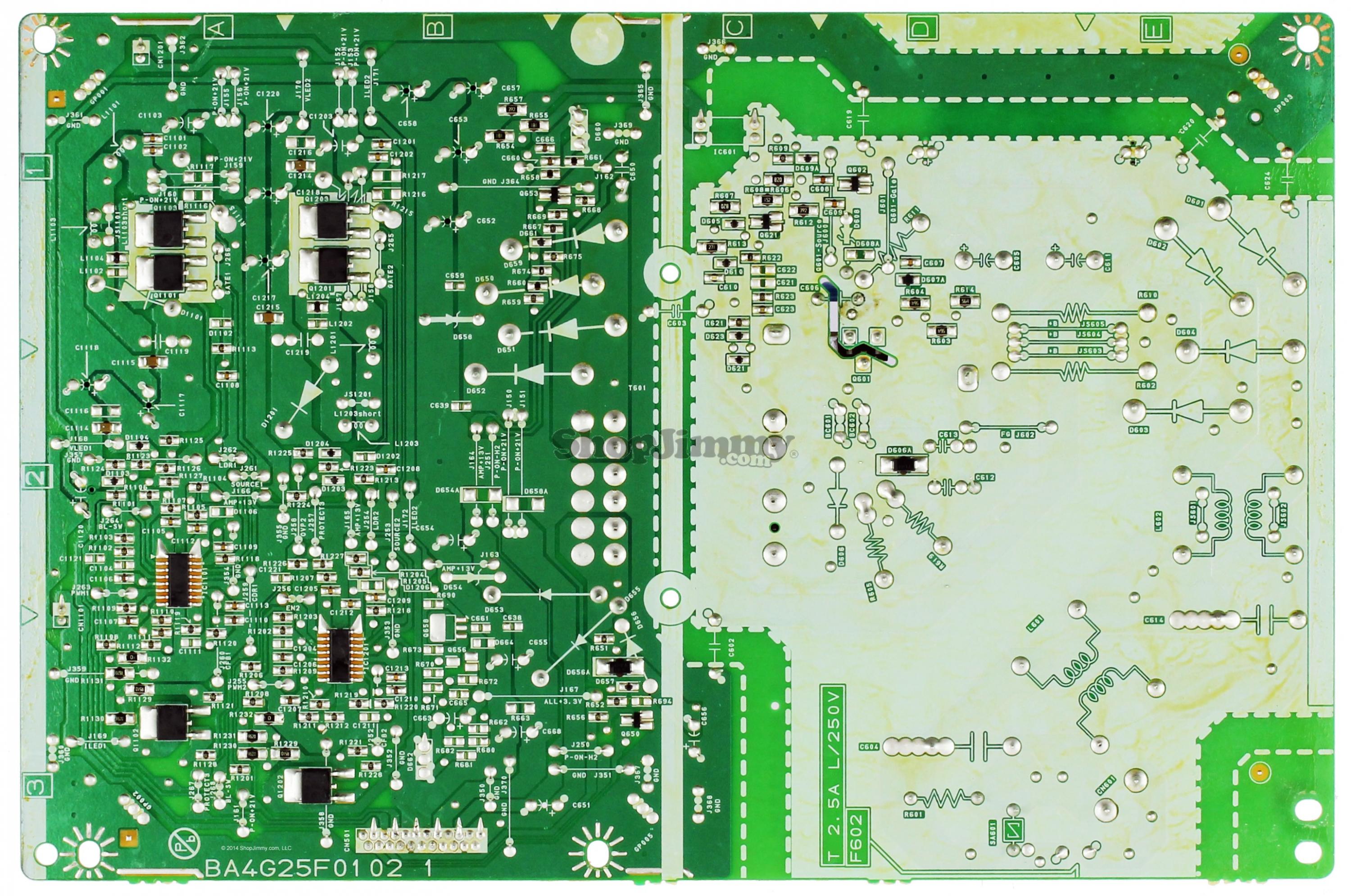

        I found a site called ShopJimmy that has the whole power supply board for the Emerson for like $54, and then they also sell a repair kit with some specific parts that are known to go bad for like $15.
        Board:
        https://www.shopjimmy.com/magnavox-a...upply-unit.htm
        PS Repair Kit:
        https://www.shopjimmy.com/magnavox-a...repair-kit.htm
        Looking at this ShopJimmy repair kit, the included items are listed as,
        Fuses - 1
        Transistors - 2
        Diodes - 4
        Resistors - 1
        I know the white component with the stripes is a resistor because I used to be an electricians apprentice and I was also taking electrical classes at the college in order to get my journeymans card. The stripes indicate the specific Ohms of reisistance. If the component in the red rectangle is not the fuse then I'm guessing the little brown component in the blue rectangle is the fuse? Cause there's only one fuse listed and it's the only component of it's kind and it has two leads.
        I tested the power connector with one lead of my voltage tester on the hot power lead and the negative just touching the metal case the boards is attached to inside the TV. It read 88.7 volts.
        The only reason I'm reluctant to just go ahead and buy a whole new board is because I'm not sure it's even the PS board that's bad. I really would like to figure out if it is indeed a bad part on the PS board and then figure out which part and replace them. If you wanna help me with it I would be very grateful. I have a pretty decent Weller brand soldering iron with adjustable temp control. If not, would it be possible to just figure out if the PS board is actually bad before I waste money on a new one?
        I just wanted to add one more thing. I know not to touch anything on any boards or any electrical components inside the TV with my hand with it plugged in haha. Just to ease your mind.

          The blue circle is a transistor and if reading between all three leads maybe bad so remove it and retest the red circles are diodes best to unsolder one side and lift a leg and retest the blue rectangle looks like a fuse test the same part on your board and see what it reads
          reagarding the 88v reading on the mains connector it depends what you was using as a ground as your working on the hot side of the psu use the negative side of one of the large capacitors as a ground on the cold side of the psu you can use a grouding screw etc.

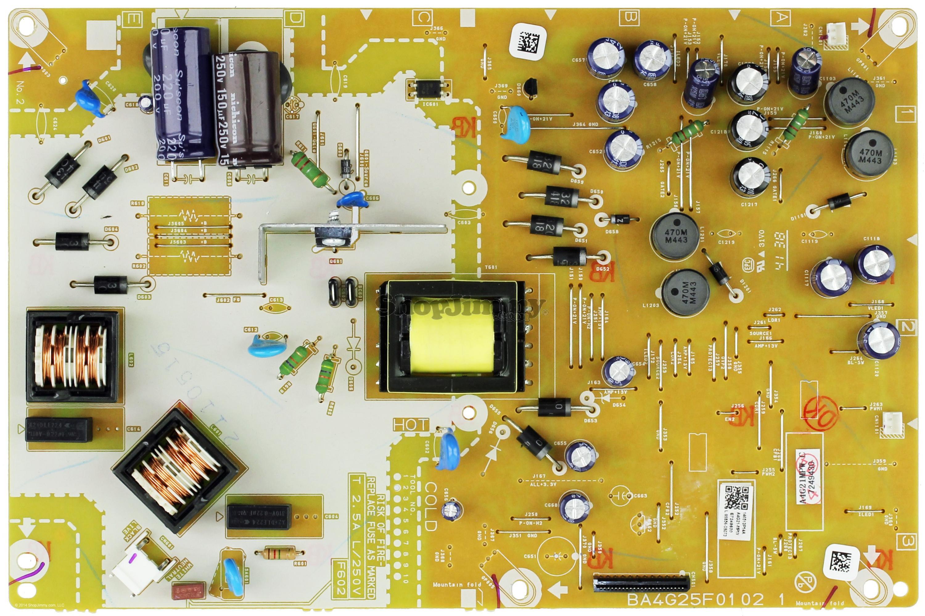

                Black Retangle: This part has no continuity. If it's a fuse it's blown.
                All 3 legs of this transistor still has continuity:
                The 1 diode in this pic looses continuity with leg lifted. The other still has continuity:
                And this diode still has continuity with a leg lifted:
                Some diodes I test for continuity ring out for a brief second then loose it. Don't know what that's about. But the three I have pointed out had continuous continuity.
                I got 91V on the hot lead of the power connector and going to a ground screw on the cold side.

                Power connector directly from power cord: Red Circle
                Ribbon cable to main board: Blue Circle
                To display?: Purple Circles
                Bottom:
                Whole thing:

                    I will probably give the shopjimmy kit a try first before I buy the whole PSU. I can see plainly where that big 3 lead transistor goes, the brown component which is probably the fuse and that one resistor with the 2 red stripes 1 silver stripe & 1 gold stripe goes. I hope shopjimmy gives me the location of the other 5 components. I want to see what VinceRoger69 has to say first before I order the shopjimmy kit.
                    With that fuse being blown it should have protected the main board and the rest of the TV components. I feel pretty confident the damage is limited to the PSU at this point.

                                  Can someone help my identify this diode:
                                  It's got SB3A0 printed on one side which I found is a SCHOTTKY BARRIER RECTIFIER diode and then it's got the value of 65 printed on the other side. Does "65" mean 65 volts? I'm gonna replace both of these diodes since the ShopJimmy repair kit did not include them and the one still has continuity with a leg lifted and the other one is still suspect. I'm gonna have to order them from ebay and I wanna make sure I get the right one.
                                  Edit: Looking at stuff on the net just now I think the 65 mean 65 degrees celcius. So then does the 3A in the SB3A0 mean 3 amps? So am I looking for a Schottky 3amp 65 degree C diode? What about the voltage rating?

                                        Can you indentify this noise the PSU is making after repair
                                        So I got all the ShopJimmy parts on the PSU and an additional bad diode that didn't come with the ShopJimmy kit and miraculously the TV powered right up. Got a minor hitch though. The PSU is making this crazy sound haha. It sounds like it's coming from the yellow transformer on the pics above. Can anyone make out what could be causing this. The TV is powering up fine and the fuse isn't blowing. I know some of my soldering was rough but all the connections must be fine cause it's powering up.
                                        There is one diode that I had to replace that did not come with the shop Jimmy kit that I ascertained was bad. I could not find an exact replacement for that diode which was a SB3A0 (data sheet) 3amp 100volt with a IFSM of 80 amps. I found a similar diode on ebay which was an 1N5401 (data sheet). The SB3A0 is 3amps 100volts with an IFSM of 80 amps. The 1N5401 is 3amps 100volts with an IFSM of 200amps.
                                        I can show the location of each part I replaced. I made a video so you can hear the sound the PSU is making here: https://youtu.be/hDMcqKj_uOc
                                        Should I just let that sound go and not worry about it? The sound is not as alarming loud as it sounds in the video as the cell phone is so close to the PSU when I took the video but you can deffinitely hear it. The TV is working.
