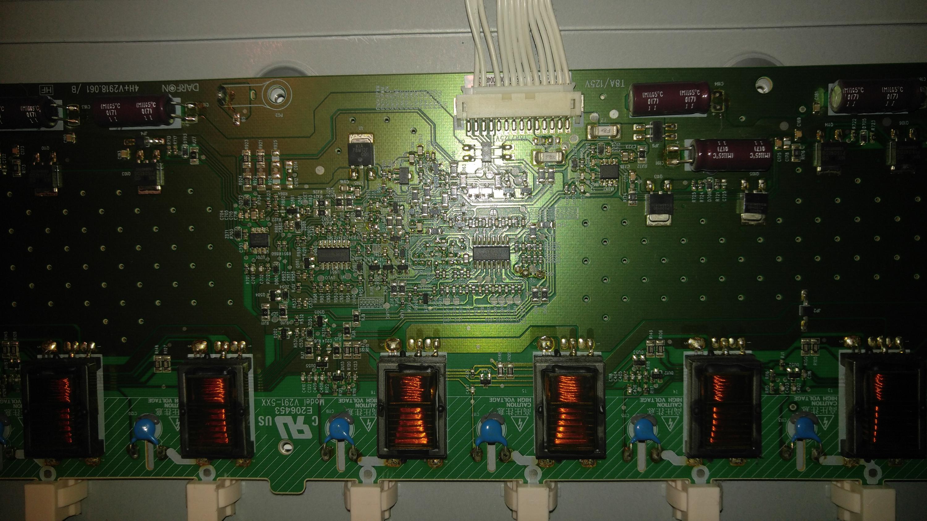

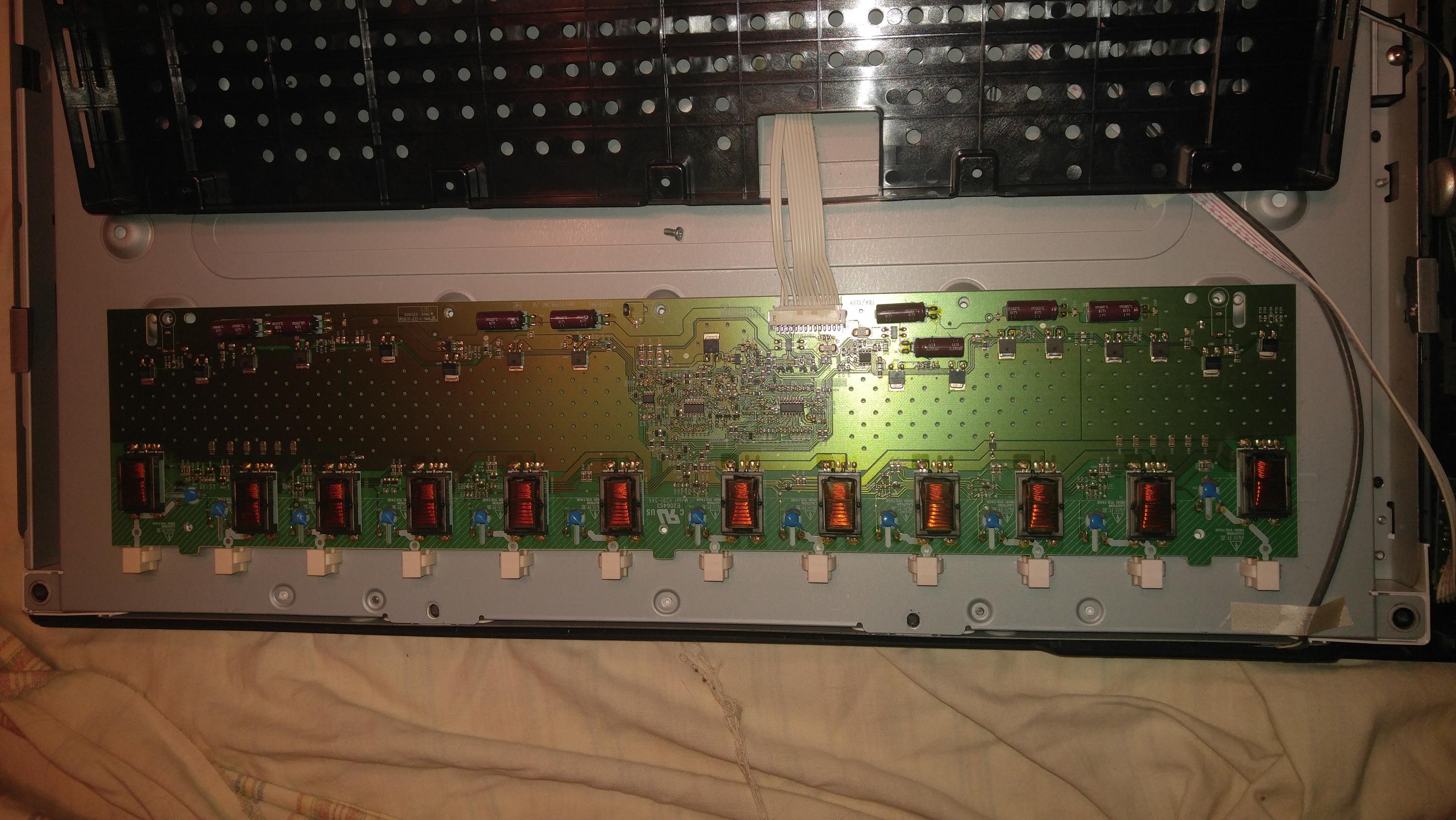

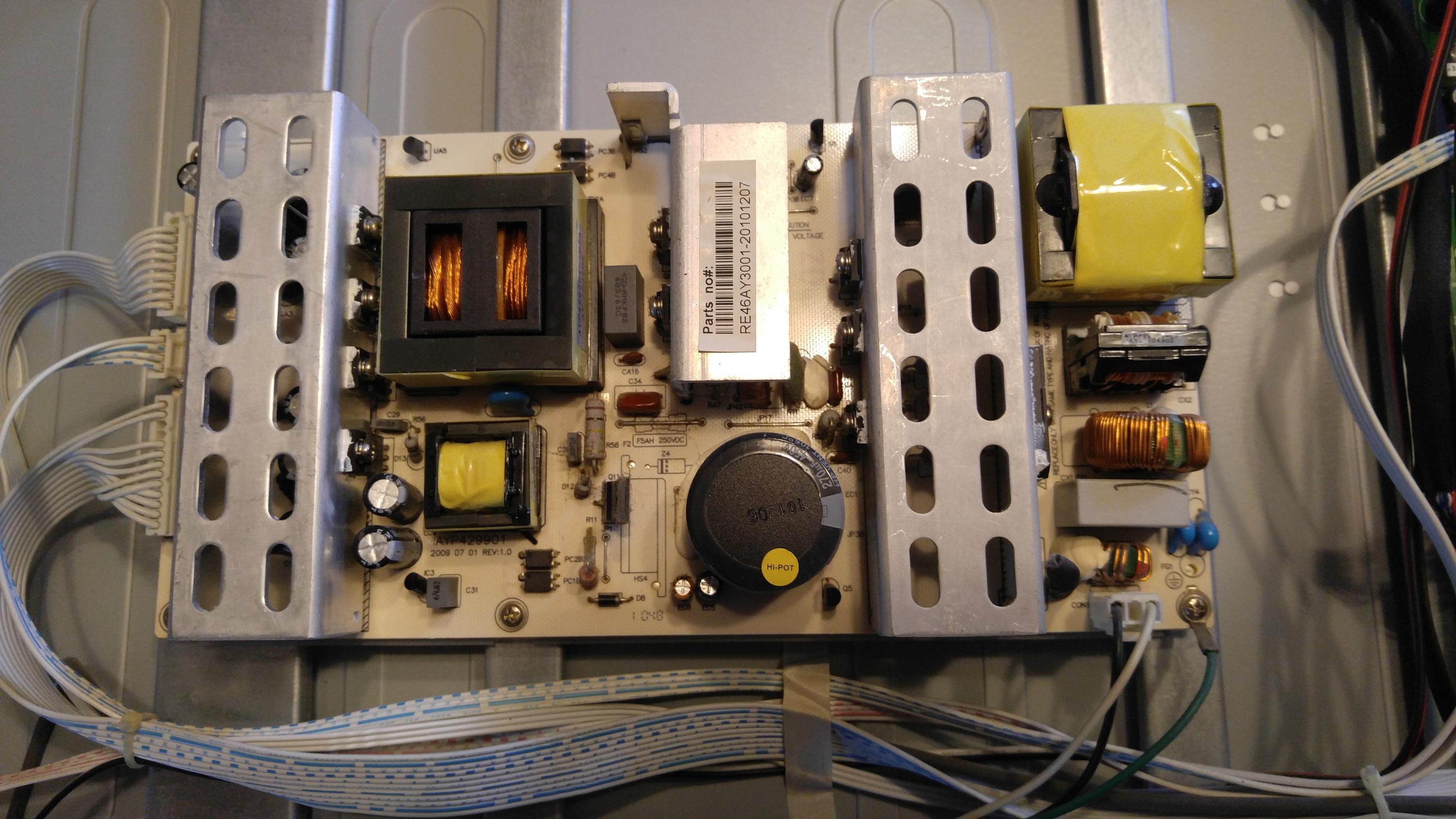

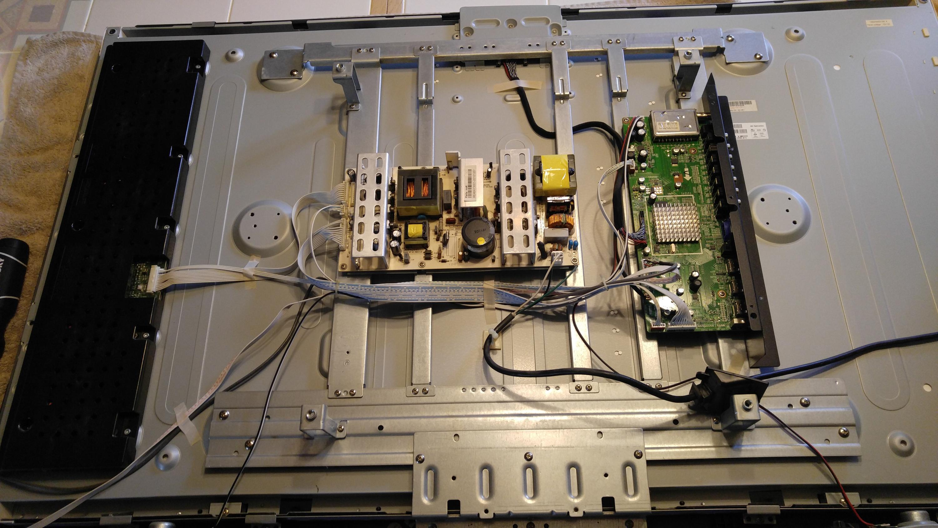

    Greetings all again. Craigslist freebie here. No back light after a minute or two when powered on. Flashlight test shows that the image is still on the screen.
    Opened it up and got 23-24 volts on all 5 pins going from power board to the backlight inverter board. When the backlight cut out, no change in the readings.
    Right now I am thinking a bad cap somewhere on the backlight board. There are 8 caps at 35v 390uf. Since the TV is 7 years old, I might as well replace all 8.
    Now I have a bag of 35v 470uf caps from a prev repair. Was just as cheap to buy the 50 count bag as the 4 I needed. Brand is Chenxing off of Amazon.
    Can I use the caps on hand? Or should I just buy the 390uf ones?
    Next post with have pics of the boards.

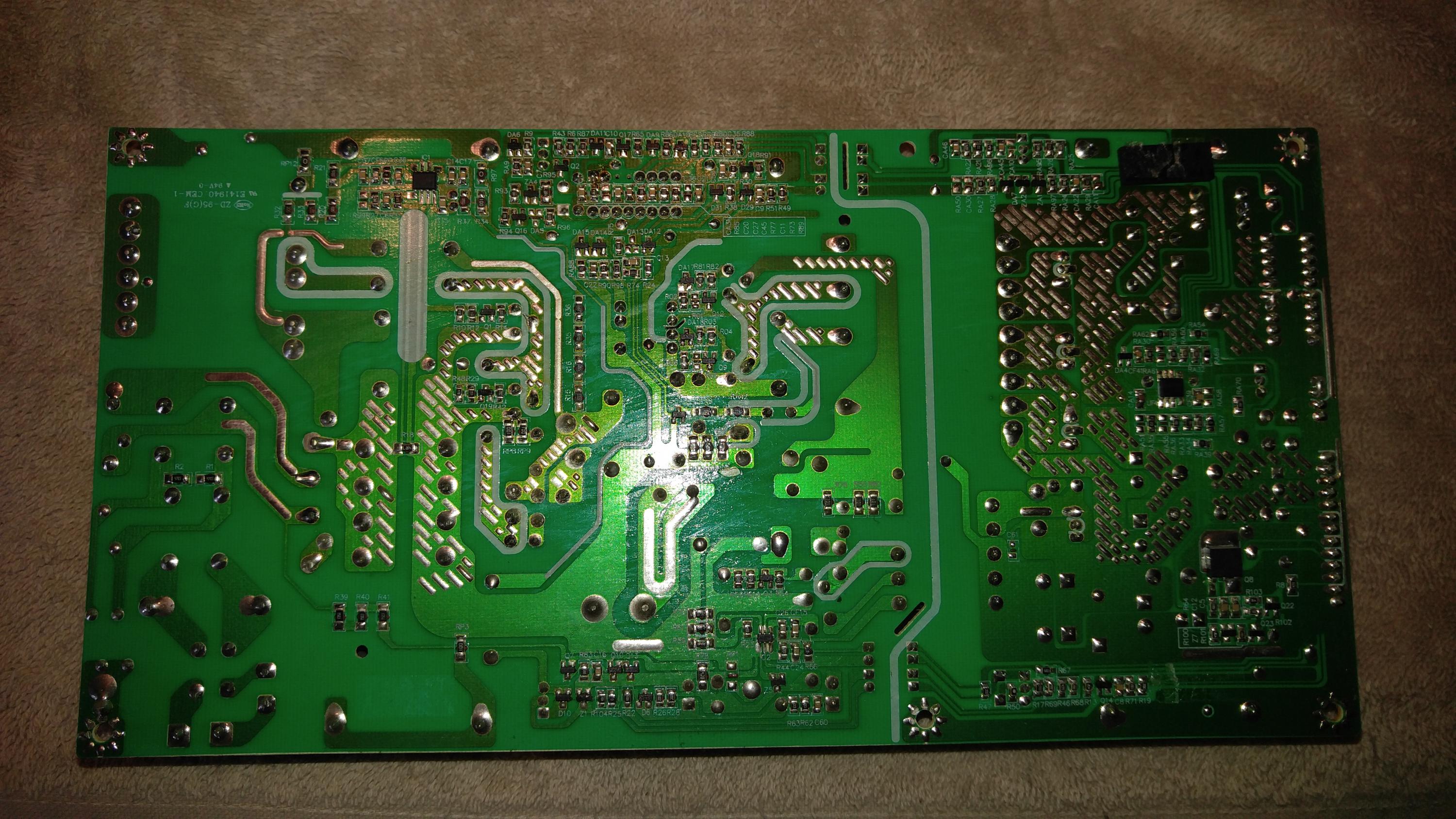

    Re: RCA 46LA45RQ no backlight
    First set
      Second set
          take the inverter out and check the back for burn marks/discolouring, that will give an idea as to where there may be a problem,
          • Jim1590
            • Jul 2013
            • 98
            Nothing on the back. Looks like there is no tracings or components at all. On the front, most of the solder points have at least some Browning.
              Check those 2 fuses on the Inv Bd. Ckeck if there is voltage on both sides of each fuse.
                    Since the back lights come on for the first minute or two and then go out, I rule out capacitors. My bet is on a bad transformer or a bad bulb, some component that draws more current when getting hot.
                    Compare the resistance of the secondary output winding of each transformer on the inverter board. The tolerance can not exceed 3% of each other.
