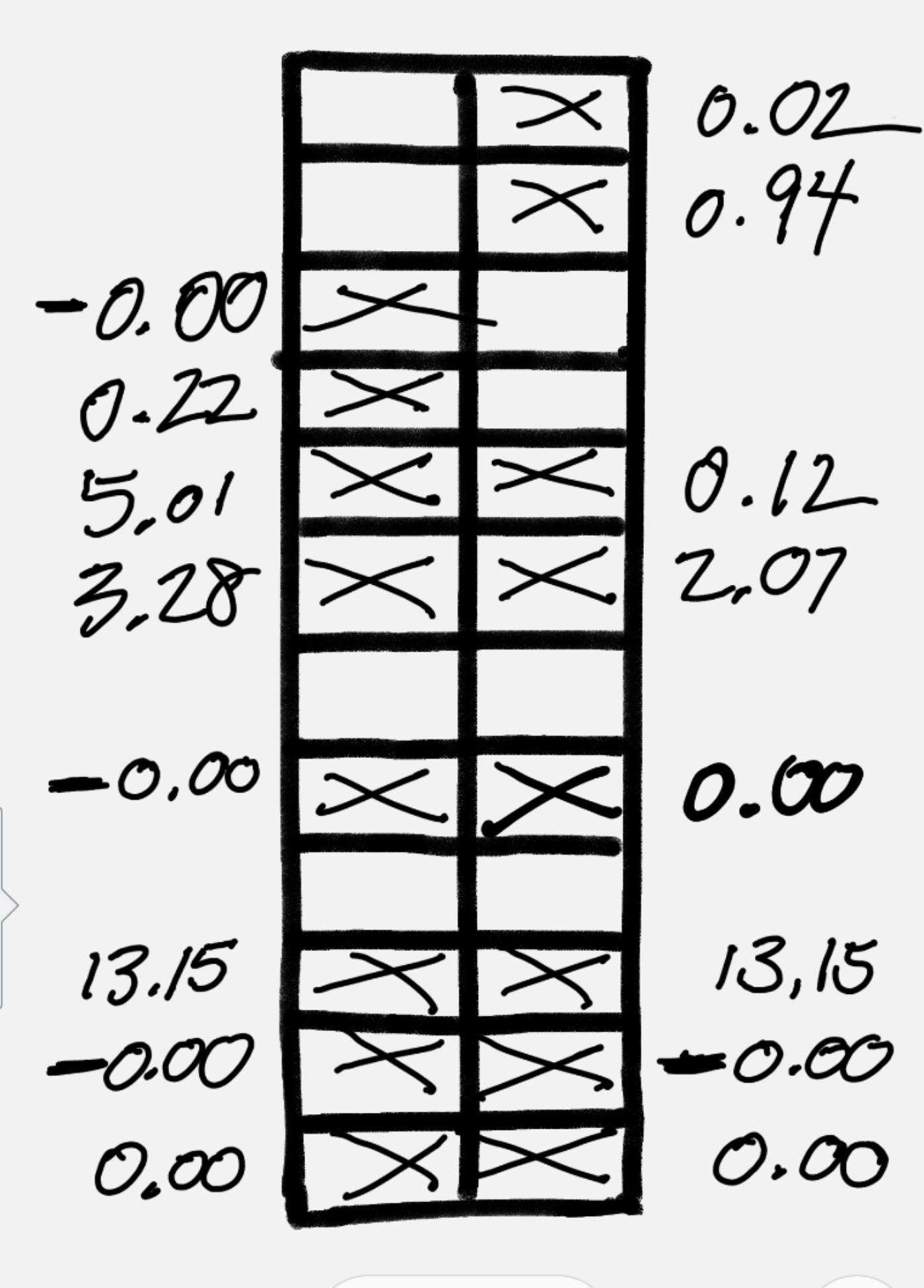

        With the advice of 'dskall', I did back probe the main board plug- plugged in to the power supply and power to the board. I have a picture and illustration of the voltages I found. I have no schematic or diagram or know where to find one. Any input with what I found would be a big help-
        • dskall
          • Oct 2016
          • 2905
          • usa

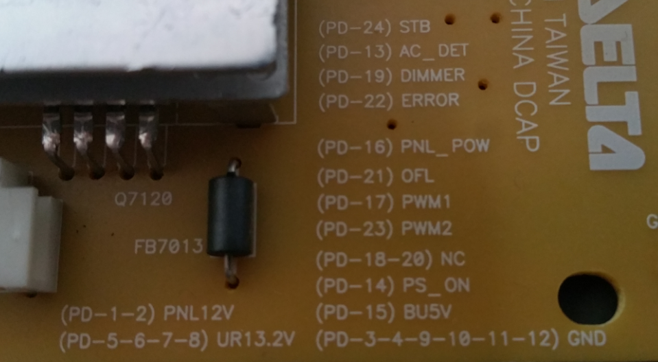

          Re: Sharp Aquos LC-60LE600U no power period
          The connector PD and the numbers around it tell you what voltages you should have on the pins eg PD-5-6-7-8 should have 13.2vdc when things are working. Next to connector should tell you were pin 1 and 24 are on connector. Take readings and post as p5 13.2v = voltage you get for all pins. Then push power button while probing Pin 14 ps-on and you should get a voltage.

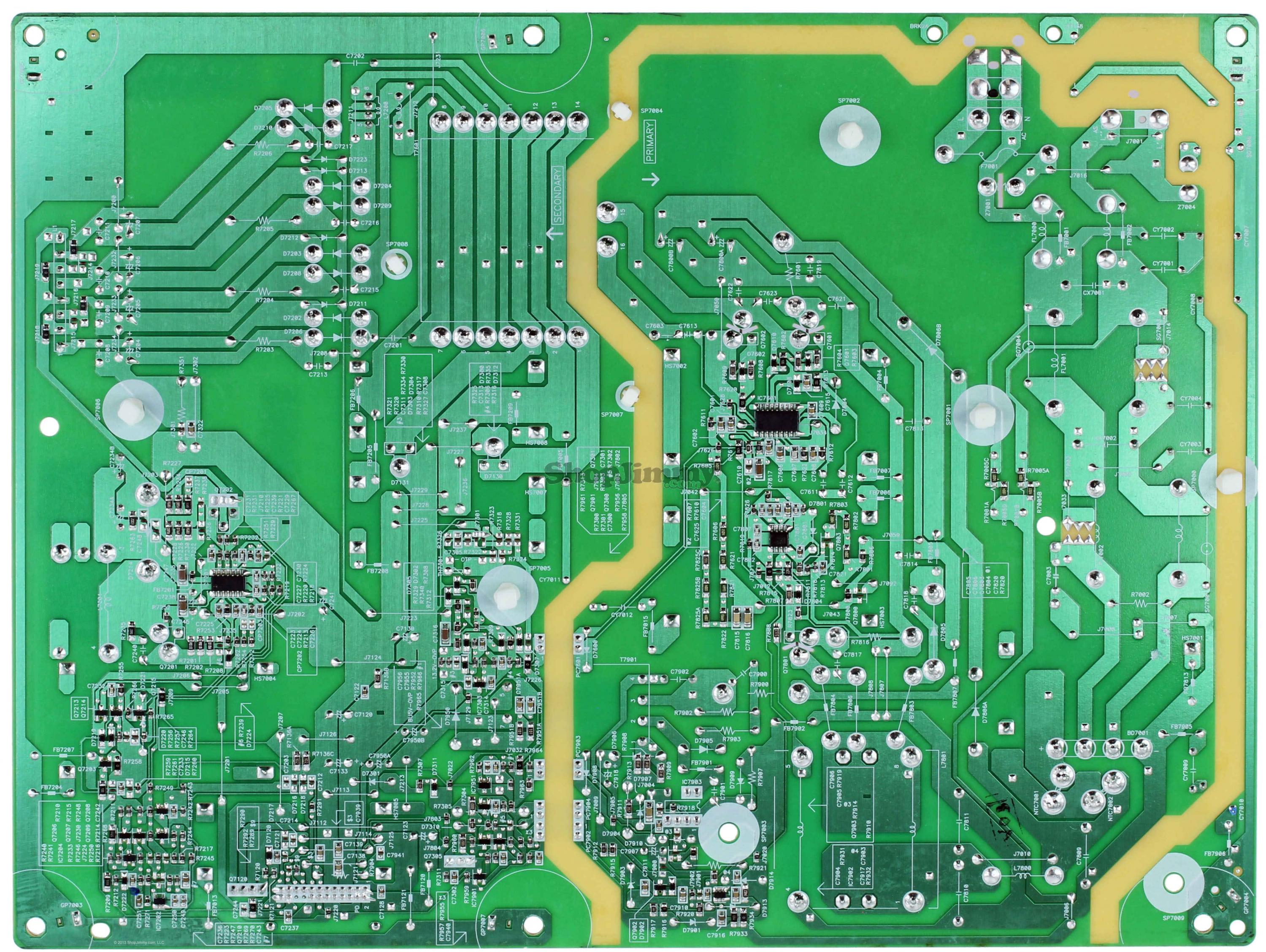

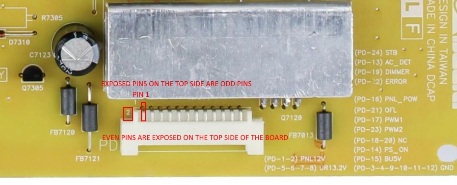

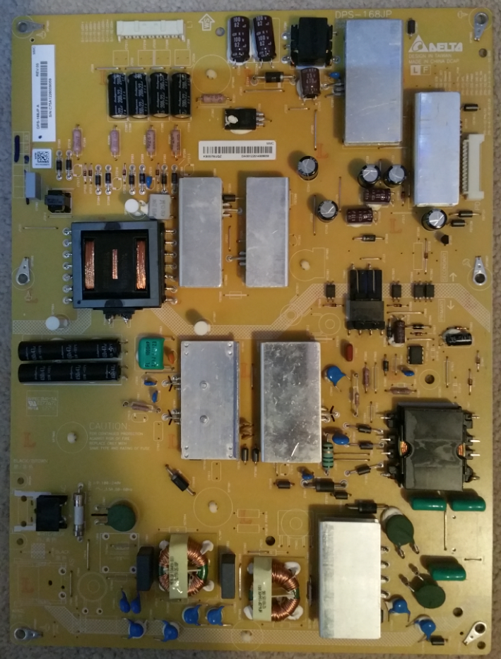

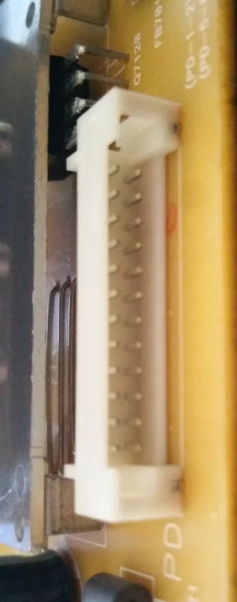

              If you look at the PD connector on the top side of the board you will see '1', and '2' printed right next to the connector.
              The exposed pin you can see on the top side of the board are the ODD number pins, the other pins you cannot see are the even number pins, which you can probe them on the female back side of the connector.
              We need the pin name and follow by the DCV reading of each pin so we can see which Voltages and signals are missing.
              http://www.shopjimmy.com/sharp-runtk...-led-board.htm
              Sharp RUNTKB057WJQZ (DPS-168JP A) Power Supply / LED Board
              Pictures provided by shopjimmy.
                          https://www.badcaps.net/forum/attach...2&d=1485933978
                          You count the pin wrong, I guess you did not read my post 7 about the pin '1', '2' and the reporting format.
                          I do not have the board in front of me so I did the research to find the pictures of the board and study them and give the instruction on how the pins are assign.
                          What more do I have to do?

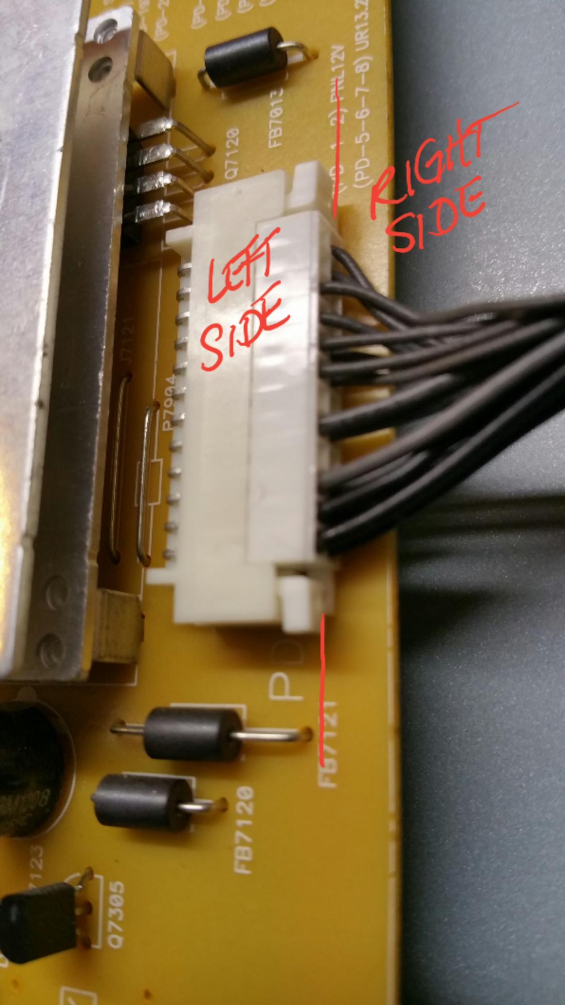

                            With Magnavisors on I didn't even see that 1 & 2 tucked in there- in post 7 I thought you were making reference to (PD-1-2) PNL12V since it was at the top of the PD. Anyway, I hope this makes better sense. Also while I back probed all the pins, I tried hitting the power button which did nothing-
                            Pin 1 PNL12V = 0.00V
                            Pin 2 PNL12V = 0.00V
                            Pin 3 GND = -0.00V
                            Pin 4 GND = -0.00V
                            Pin 5 UR13.2V = 13.15V
                            Pin 6 UR13.2V = 13.15V
                            Pin 7
                            Pin 8
                            Pin 9 GND = -0.00V
                            Pin 10 GND = -0.00V
                            Pin 11
                            Pin 12
                            Pin 13 AC_DET = 3.28V
                            Pin 14 PS_ON = 2.07V
                            Pin 15 BU5V = 5.01V
                            Pin 16 PNL_POW = 0.05V
                            Pin 17 PWM1 = 0.16V
                            Pin 18
                            Pin 19 DIMMER = -0.00V
                            Pin 20
                            Pin 21
                            Pin 22 ERROR = 0.95V
                            Pin 23
                            Pin 24 STB = 0.58V
                              BTW, did you see any blinking error codes at all?
                              For example:
                              https://www.badcaps.net/forum/showth...&highlight=STB
                              Pin 16 PNL_POW = 0.05V = No command to turn on PNL12V for running the T-CON
                              Pin 24 STB (Von) = 0.58V = No BL-ON to turn on backlights circuit
                              No dimming control:
                              Pin 17 PWM1 = 0.16V
                              The key is this one which I do not what it should be for normal operation:

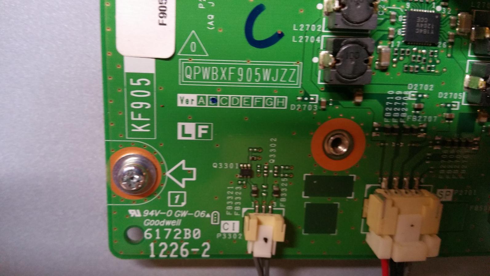

                                      Hi yes unplugging and holding power, plug in hit power again or vol and chan down while replugging does nothing. when I saw the key controller is plugged into the main board I figured that might be smoked worse then the power supply- is there some method of testing the main?
                                      • tjmethod
                                        • Jun 2013
                                        • 137
                                        Here the main
