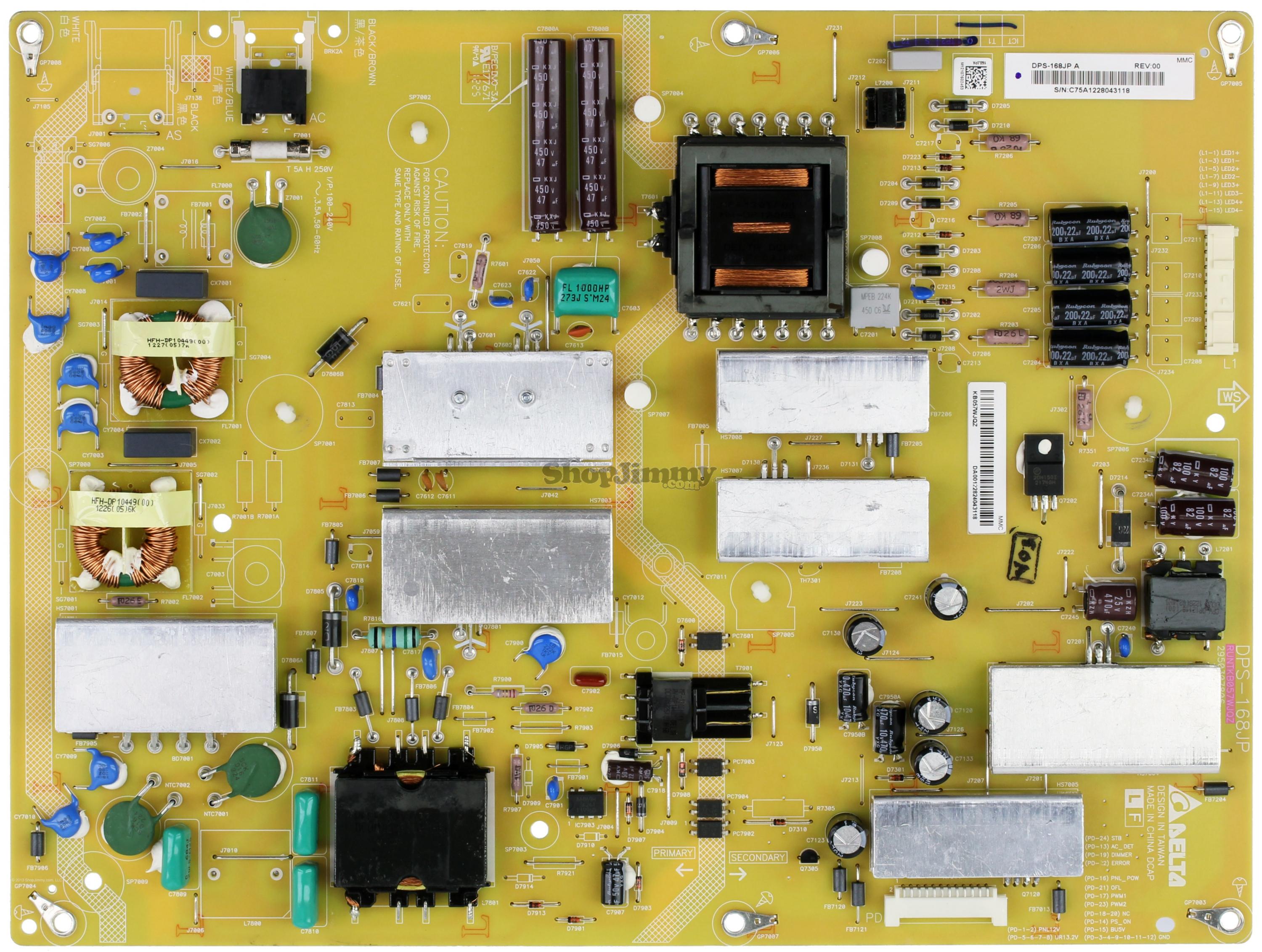

                    Hi All, I have a LC-60LE600U with blown fuse. I did quick check and looks like its rectifier is fried. Hence I am looking for actual part numbers for the Bridge rectifier, the Q7801 and R7816. Does anyone have schematics?

                      Just checked even the variastor is blown but its number is visible so I can get a replacement for it.
                        #31
                        Re: Sharp Aquos LC-60LE600U no power period
                        There should be part number printed on the Bridge and the Q7801 (PFC MOSFET).
                        If that PFC MOSFET is blown, more likely the components connected to the Gate and the PFC IC are likely to be damaged also.
                        You should attach the pictures of the board?
                        What is the P/N of the power supply board?
                        Sharp RUNTKB057WJQZ (DPS-168JP A)???
                        MOV Z7001 is blown? 150V rating MOV with about the same Dia, will be fine.
                        What is the history of the TV? Hit by power surge?

                          Thanks for the superfast response BUDM. Do you know the value of R7816? Looks like owner replaced (or got it replaced) the resistor. Currently it has a 6.8 ohm resistor. Not sure if thats the right value.
                          Sharp RUNTKB057WJQZ (DPS-168JP A)??? yes its DPS-168JP A
                          What is the history of the TV? Hit by power surge? I got it from Craigslist hence no information on history.
                          Pictures provided by shopjimmy.[/QUOTE]
                            #33
                            R7816 is the current sensing resistor connected to the Source pin of the PFC MOSFET, when MOSFET shorted out it will blow that Source resistor, it is 0.56 Ohm Flame proof type resistor, you can use MOX (Metal Oxide) power resistor.

                                I was dignosing the TV further and found on the board KF905FM04 and found the diode 9601 is bad. Does anyone know whats the value of this diode?

                                        I was diagnosing the TV further and found on the board KF905FM04 and found the diode 9601 is bad. Does anyone know whats the value of this diode?
                                        I have attached the picture of the part.
                                        Thanks in advance!
                                          #40
                                          Thanks in advance!
                                          What is this board you are referring to?
                                          Can you zoom out so we can see what connector it is connected too? It looks to be protection diode.
