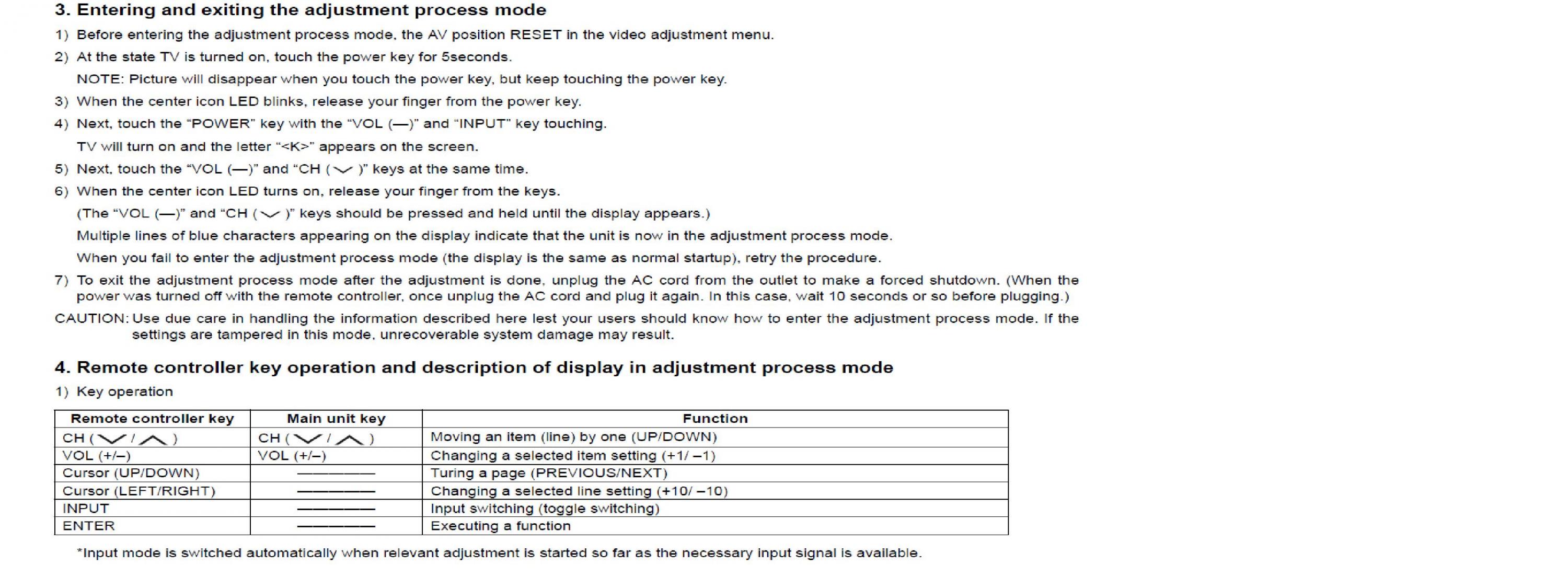

      I have this excerpt from my LC60LE632U manual if it helps

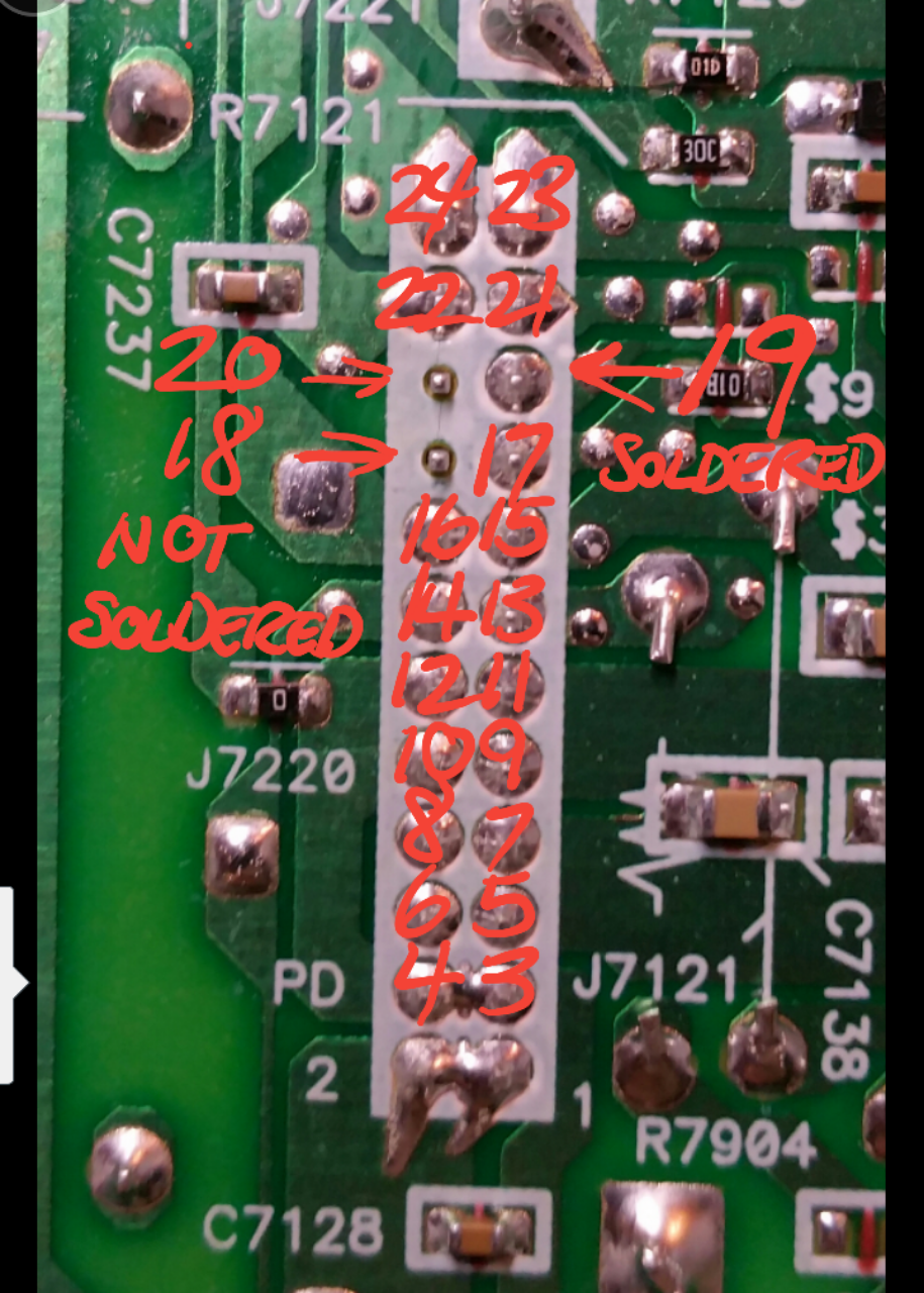

        PD
        Pin, Vol, Name
        1. 12.2 : Pnl_12v
        2. 12.2 : Pnl_12v
        3. 0 : Sgnd
        4. 0 : Sgnd
        5. 13.43 : Ur13v
        6. 13.43 : Ur13v
        7. 13.43 : Ur13v
        8. 13.43 : Ur13v
        9. 0 : Sgnd
        10. 0 : Sgnd
        11. 0 : Sgnd
        12. 0 : Sgnd
        13. 3.32 : Ac_det
        14. 2.85 : Ps_on
        15. 5.06 : Bu+5v
        16. 3.27 : Pnl_pow
        17. 0 : Vsync
        18. 3.28 : Scl
        19. 1.98 : Nc
        20. 3.28 : Sda
        21. 0.4 : Ofl
        22. 3.29 : Error
        23. 0 : Nc
        24. 3.25 : Stb
        This is the board that throws the 1-1 error, but that I can get the tv to turn on with by holding vol+ and channel-. If you scroll up to the very first post, you can compare to the board where I cannot get the screen to turn on and it throws the 2-3 error.
        I am confused by pin 19 that shows not connected(there isn't even solder on it on the backside, but it still has a voltage)?
          Re: Sharp 70" LC-70LE734U : No Picture : 2 Slow - 3 Fast
          Thanks! So the ERROR pin according to service manual, it is for the Backlights error.
          When ERROR is present, it will be low (<1VDC, and when there is no error it will be around 3VDC, I went through many service manuals to find out but no info, so thanks to you now I know what it should be.
              Originally posted by Inverted View Post
              So I just tried menu 2489. What am I supposed to see happen? I hit menu on the remote and it obviously brings up the tv menu, then when I hit 2, it starts acting like I am entering a channel to go to, once I enter 2489 and then wait about 2 seconds it just goes back to displaying the current channel number that it is on.
              It's supposed to bring up another menu with four options - obviously doesn't work on your set.

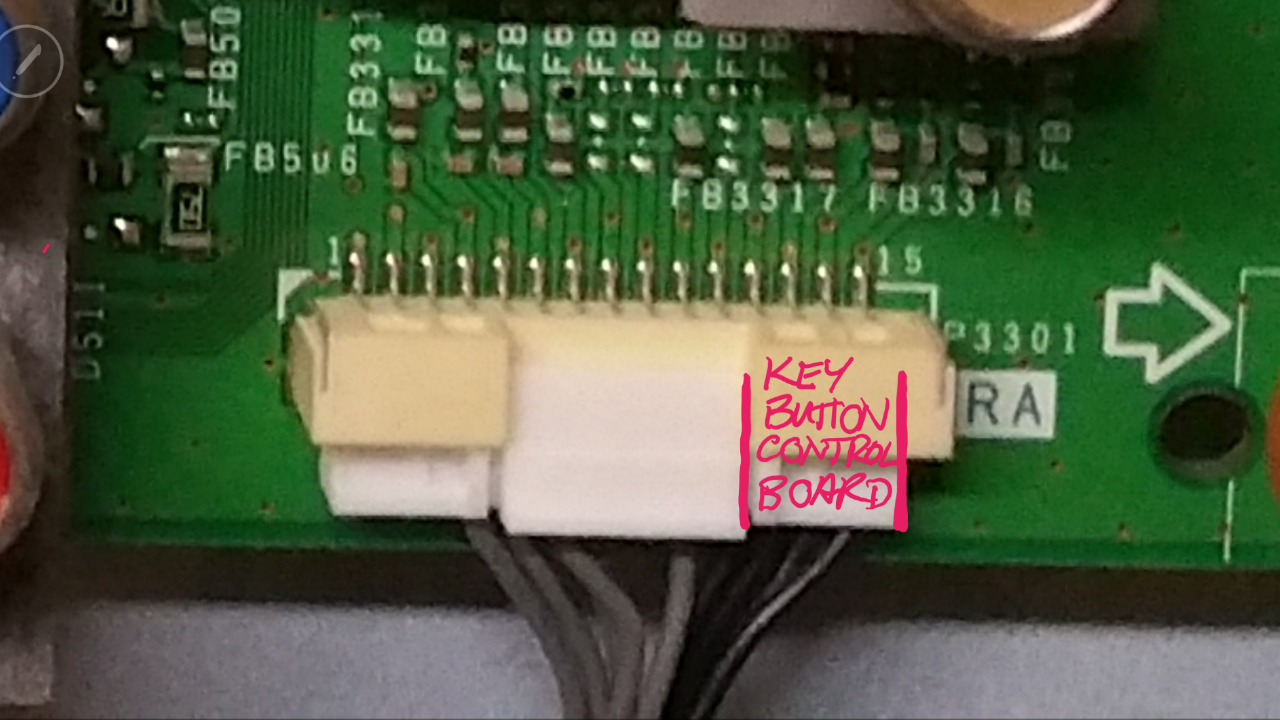

                      Bud my 19th pin on the PD is soldered, anyway but since there's no response from the key control board showing any error codes, I checked the RA where the key control board plugs in to the main and these were the voltage readings I got, there were no voltage around it printed on the board that I could see. Of course the last four oins are the key board controller.
                      Pin 1. - 0.00V
                      Pin 2. - 0.00V
                      Pin 3. - 0.00V
                      Pin 4. - 3.25V
                      Pin 5. - 3.20V
                      Pin 6. - 0.74V
                      Pin 7. - 0.00V
                      Pin 8. - 0.00V
                      Pin 9. - 0.00V
                      Pin 10. - 0.00V
                      Pin 11. - 0.00V
                      Pin 12. - 0.00V
                      Pin 13. - 3.25V
                      Pin 14. - 3.15V
                      Pin 15. - 3.15V
                      If these voltages are correct then this would point towards the key control board may have failed since we cant get blinking error codes?
