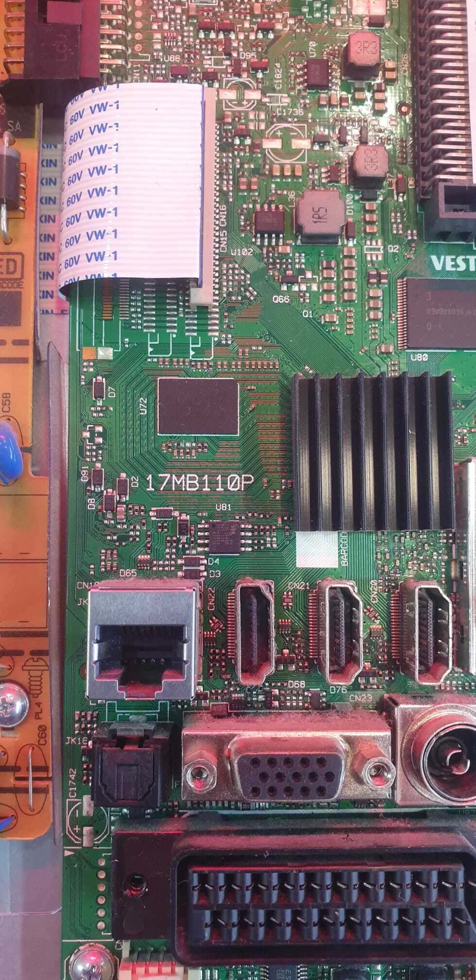

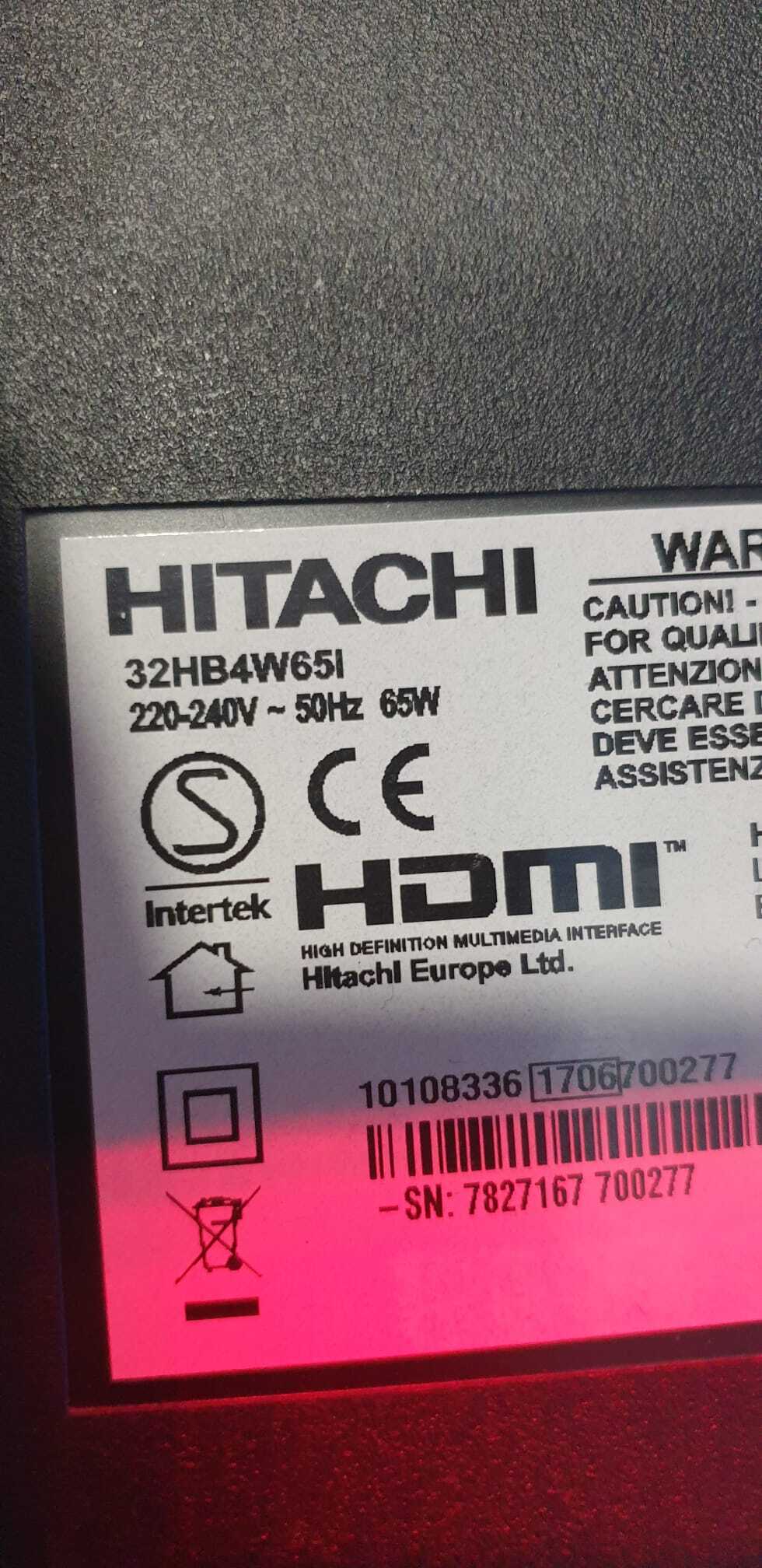

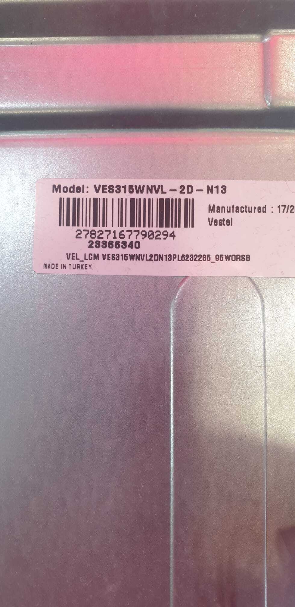

Eeprom dump thread!
This is a sticky topic.
  • yokoono
    • Apr 2010
    • 505
    #1781
    Is ves500qndp-2d-n42 not vesq500ndp-2d-n42
    • porfyriadhs
      • Oct 2023
      • 80
      • Greece
      #1782
      Good morning . I am really sorry is Ves500qndp-2d-n42 exactly .Any help please , i have problem with the bios . As it says memory running out and need to reset Tv goes on and off
      • xe_d_sono
        • Aug 2013
        • 25
        • Portugal
        #1783
        I need EMMC Dump for Sony Android TV KD-55XG8596 with Main 1-983-791-12.
        Can somebody help me?
        • lotas
          • Jan 2016
          • 4752
          • Russia
          #1784
          Originally posted by xe_d_sono
          I need EMMC Dump for Sony Android TV KD-55XG8596 with Main 1-983-791-12.
          Can somebody help me?
          Here is a working dump of eMMC (Samsung) on ​​Sony KD-55XG8596 1-983-791-12.
          https://drive.google.com/file/d/18X5...nclLW870i/view
          • xe_d_sono
            • Aug 2013
            • 25
            • Portugal
            #1785
            Originally posted by lotas
            Here is a working dump of eMMC (Samsung) on ​​Sony KD-55XG8596 1-983-791-12.
            https://drive.google.com/file/d/18X5...nclLW870i/view
            Thank you! i will try.
            • mnjoao
              • Feb 2022
              • 14
              • portugal
              #1786
              Good morning, I come once again to ask for help to resolve the situation with this TV that needs to update the firmware, if anyone could send help I would appreciate it​
              THOMSON 55UA6406W MOTHER BOARD 40-NT67ES-MAC4HG SOFTWARE:V8-NT67F01-LF1V378
              THANK YOU
              • kirill_maker
                • Nov 2024
                • 6
                • Sweden
                #1787
                I'm looking for a dump for the LG PF1000U projector (chassis FM51E), (NAND Hynix H27U1G8F2CTR SPI_FLASH: MX25L8035EM2I, EPROM 24C256C).
                There is no epk file available anywhere
                This device attempts to turn on and responds to both buttons and the remote control:
                It exits standby, runs the fans for 5 seconds, then spins them at 100% for another 5 seconds judging by the sound, and then goes back into standby.
                The problem seems to be a corrupted NAND as it appears to me:
                [ 0.110000] NAND device: Manufacturer ID: 0xad, Chip ID: 0xf1 (Hynix NAND 128MiB 3.3V 8-bit)
                [ 0.110000] redirect_size = 400000, redirect_start = 7c00000
                [ 0.110000] Loading nand bad block info(00000000+00020000)...
                [ 0.119000] Mstar nand-flash partition definition
                [ 0.119000] mtd info: # of partitions = 23
                [ 0.119000] Creating 23 MTD partitions on "NAND 128MiB 3.3V 8-bit":
                [ 0.119000] 0x00000000-0x00020000: "bbminfo"
                [ 0.120000] 0x00040000-0x00060000: "mtdinfo"
                [ 0.121000] 0x00160000-0x00760000: "rootfs"
                [ 0.121000] 0x00760000-0x007c0000: "lginit"
                [ 0.122000] 0x007c0000-0x007e0000: "crc32info"
                [ 0.123000] 0x007e0000-0x00800000: "model"
                [ 0.124000] 0x00800000-0x00900000: "logo"
                [ 0.124000] 0x00900000-0x00a00000: "cmndata"
                [ 0.125000] 0x00a00000-0x01200000: "nvram"
                [ 0.126000] 0x01200000-0x01300000: "user"
                [ 0.127000] 0x01300000-0x01400000: "ezcal"
                [ 0.128000] 0x01400000-0x014a0000: "estream"
                [ 0.128000] 0x014a0000-0x01620000: "opsrclib"
                [ 0.129000] 0x01620000-0x018a0000: "kernel"
                [ 0.130000] 0x018a0000-0x03560000: "lgapp"
                [ 0.131000] 0x03560000-0x04fa0000: "lgres"
                [ 0.132000] 0x04fa0000-0x05be0000: "lgfont"
                [ 0.132000] 0x05be0000-0x05c00000: "tplist"
                [ 0.133000] 0x05c00000-0x07640000: "lgres"
                [ 0.134000] 0x00080000-0x000a0000: "cert"
                [ 0.135000] 0x000a0000-0x00140000: "authcxt"
                [ 0.136000] 0x00060000-0x00080000: "hdcp2"
                [ 0.137000] 0x00140000-0x00160000: "keyrsrv"
                [ 0.138000] mod_nand_init is invoked
                [ 0.138000] GE driver inits
                [ 0.138000] mod_iic_init is invoked
                [ 0.138000] model option = 0xfc
                [ 0.138000] Mstar_emac: [PHY Addr] ==> :0
                [ 0.138000] Mstar_emac: alloRAM_VA_BASE = 0xA0C40000 alloRAM_PA_BASE= 0xC40000 alloRAM_SIZE= 0x100000
                [ 0.139000] RBQP_BASE = c44000
                [ 0.140000] [SCALER][000173] _mod_scaler_init
                [ 0.140000] [TTX_DRV][00508]init 170
                [ 0.140000] MDrv_CC_Init
                [ 0.140000] init 172
                [ 0.140000] [DEMOD_DRV][00369]init 245
                [ 0.140000] [BDMA_DRV][00629]init 251
                [ 0.141000] TCP cubic registered
                [ 0.141000] NET: Registered protocol family 17
                [ 0.142000] RPC: Registered udp transport module.
                [ 0.142000] RPC: Registered tcp transport module.
                [ 0.142000] Adding user_initcall[0] = 0x803a1314
                [ 0.142000] Adding user_initcall[1] = 0x803a1320
                [ 0.142000] Adding user_initcall[2] = 0x803a66f8
                [ 0.144000] VFS: Mounted root (squashfs filesystem) readonly.
                [ 0.150000] VFS: Mounted lginit (squashfs filesystem) readonly.
                [ 0.150000] Freeing unused kernel memory: 132k freed
                [ 0.204000] SQUASHFS error: Can't find a SQUASHFS superblock on mtdblock19
                [ 0.225000] Empty flash at 0x000213bc ends at 0x00021800
                [ 0.234000] Empty flash at 0x00023200 ends at 0x00023800
                [ 0.242000] Empty flash at 0x00024bbc ends at 0x00025000
                [ 0.250000] Empty flash at 0x000271ec ends at 0x00027800
                [ 0.250000] jffs2_scan_inode_node(): CRC failed on node at 0x00028fe0: Read 0xffffffff, calculated 0x916f9a2e
                [ 0.258000] Empty flash at 0x00029120 ends at 0x00029800
                [ 0.264000] Empty flash at 0x0002ab84 ends at 0x0002b000
                [ 0.289000] Empty flash at 0x00040878 ends at 0x00041000
                [ 0.289000] jffs2_scan_dirent_node(): Node CRC failed on node at 0x000427f4: Read 0xffffffff, calculated 0x2322e93d
                Thank you in advance!
                • MF ELETTRONICA
                  • Jun 2024
                  • 41
                  • italia
                  #1788
                  sorry does anyone have the dump for this hitachi tv?
                  25L1606E thanks e nel caso va cambiato anche lo status reg?​
                  • MF ELETTRONICA
                    • Jun 2024
                    • 41
                    • italia
                    #1789
                    sorry does anyone have the dump for this hitachi tv?
                    25L1606E thanks and if so should the status reg also be changed?​
                    • MF ELETTRONICA
                      • Jun 2024
                      • 41
                      • italia
                      #1790
                      sorry I didn't put the model, does anyone have the dump for this TV? HITACHI 32HB4W65I
                      • lotas
                        • Jan 2016
                        • 4752
                        • Russia
                        #1791
                        Originally posted by MF ELETTRONICA
                        sorry I didn't put the model, does anyone have the dump for this TV? HITACHI 32HB4W65I
                        What is the motherboard number, what is the panel number?
                        • MF ELETTRONICA
                          • Jun 2024
                          • 41
                          • italia
                          #1792
                          here they are
                          • lotas
                            • Jan 2016
                            • 4752
                            • Russia
                            #1793
                            Is the model exactly the same as hitachi 32hb4w65i? Because this model had a motherboard not 17MB110P, but 17MB140.
                            • Davi.p
                              Hobbist Tech
                              • Sep 2009
                              • 4460
                              • Italy - Milan
                              #1794
                              HI, this are some little dumps from TV Sharp LC-40LE730E...
                              • MF ELETTRONICA
                                • Jun 2024
                                • 41
                                • italia
                                #1795
                                ok lotas yes I sent you as you asked me tv model screen model and main number I'll send you everything again here
                                tv model
                                screen model
                                and motherboard model​
                                • lotas
                                  • Jan 2016
                                  • 4752
                                  • Russia
                                  #1796
                                  Originally posted by MF ELETTRONICA
                                  ok lotas yes I sent you as you asked me tv model screen model and main number I'll send you everything again here
                                  tv model
                                  screen model
                                  and motherboard model​
                                  I only have this dump.
                                  • MF ELETTRONICA
                                    • Jun 2024
                                    • 41
                                    • italia
                                    #1797
                                    sorry lotas this is already ready do i have to change the status reg? in case can you tell me what the status reg is thanks
                                    • MF ELETTRONICA
                                      • Jun 2024
                                      • 41
                                      • italia
                                      #1798
                                      I tried it but it doesn't work, the TV keeps flashing but it doesn't turn on, the red light flashes
                                      • MF ELETTRONICA
                                        • Jun 2024
                                        • 41
                                        • italia
                                        #1799
                                        sorry lotas how do you read a status reg of the eprom?
                                        • lotas
                                          • Jan 2016
                                          • 4752
                                          • Russia
                                          #1800
                                          Originally posted by MF ELETTRONICA
                                          sorry lotas how do you read a status reg of the eprom?
                                          The eeprom does not have a status register, but the spi flash does. When reading a dump from the spi flash, the programmer should show which status register is installed. What kind of programmer do you have, if CH341A, then what program do you use for it?
                                          • AlexGsmMaster
                                            Eizo CS2740 eeprom dump, search.
                                            by AlexGsmMaster
                                            Good day to all, I have a big problem. I can't find the eeprom dump for the Eizo CS2740 monitor. The device doesn't turn on, the indicator just lights up. It responded to connecting to the PC once. The update process started with the standard program and then disconnected from the computer. The computer doesn't detect it anymore. If anyone has an eeprom dump, please share.
                                            07-26-2025, 03:24 PM
                                          • (0)_(0)
                                            Looking for a HP Photosmart C4280 EEPROM dump
                                            by (0)_(0)
                                            Hello, This might be a long shot, but I'm looking for an EEPROM dump for a HP Photosmart C4280 All-in-one printer.
                                            The printer seems to be in cartridge alignment mode. Sometimes it print the alignment page and then hangs during the scanning step, sometimes it hangs during the printing process and sometimes it hangs during the boot process. If I let it idle for a while then it flashes the back-light of the top screen and there's a letter E. Bottom screen is asking me to restart it to no avail. I have to remove the power cable from the printer for a couple of minutes to make it work...
                                            02-17-2022, 09:09 PM
                                          • my2k2
                                            Harman Kardon AVR 171, Request for IC1504 (24C32) eeprom dump file
                                            by my2k2
                                            Good day to every one,
                                            I have AVR 171 the IC1504 (24C32) eeprom is corrupted not able to read.
                                            Does anybody have an eeprom dump file? I really appreciate any help.
                                            Thanks in advance.
                                            07-01-2024, 09:04 PM
                                          • Whale linguini
                                            p14s Gen 2 thunderbolt eeprom dump
                                            by Whale linguini
                                            P14s Gen 2
                                            HT4B0/HP4B0/HT5B1/HT4B2
                                            NM-D352 Rev 1.0
                                            sn PF-35P15W
                                            Requesting thunderbolt dump
                                            also attached is the tbt dump. I extracted the bin from the cap file and modified it, not sure if it's correct. also didnt work....
                                            09-03-2024, 01:56 PM
                                          • Ancient1
                                            Before I dump this Panel...
                                            by Ancient1
                                            Hi
                                            I was working all day on a 42" with no backlight = Driver is bad . LED Tester. Image exists
                                            As I was reassembling, I discovered faults on the screen ( used the LED Tester to power the strips).
                                            Right distribution board, 2 Flexs, near them:
                                            The one near the center has 1" line on screen. Pressing on the board-side or Panel side of the Flex bonding place results in some change, I sensed heating one time, but main fault line remains
                                            The other, pressing on the Panel to the Chassey and the lines disappears 99.99%
                                            I...
                                            10-23-2022, 11:07 AM
