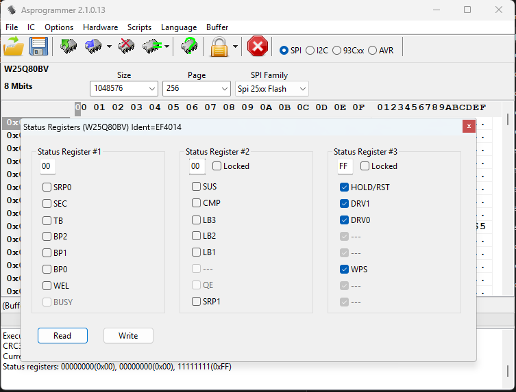

                    For 25Q80 (0x98.0x2) there is nothing to install, it didn’t need to be touched at all, it is for T-con, status registers are installed after recording dump...

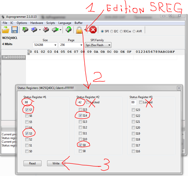

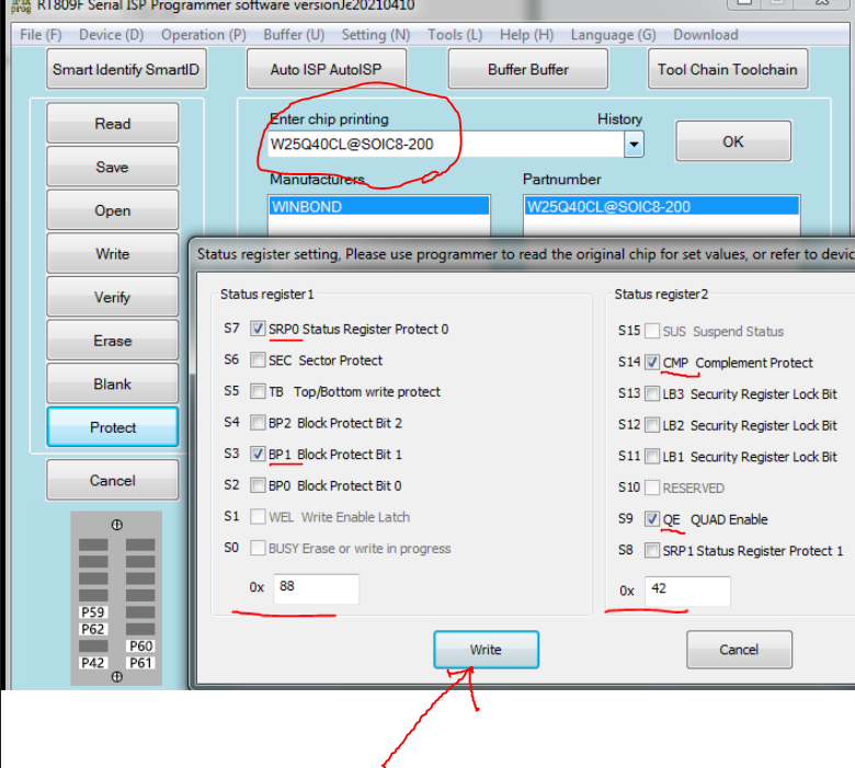

                        I don't know how you write everything down and why nothing works for you, if it was a native dump, then I fixed it and it should work...
                        Procedure for recording:
                        1. First you need to delete all status registers (uncheck all the boxes and click "Write")
                        2. Erase the chip.
                        3. Write down the corrected dump and check what was written down.
                        4. Set the status register (0x88, 0x42), check the boxes and click "Write"
                        5. Everything is ready, solder the chip in place....​
                        Read this thread: https://www.badcaps.net/forum/troubl...ung-ue49mu6120

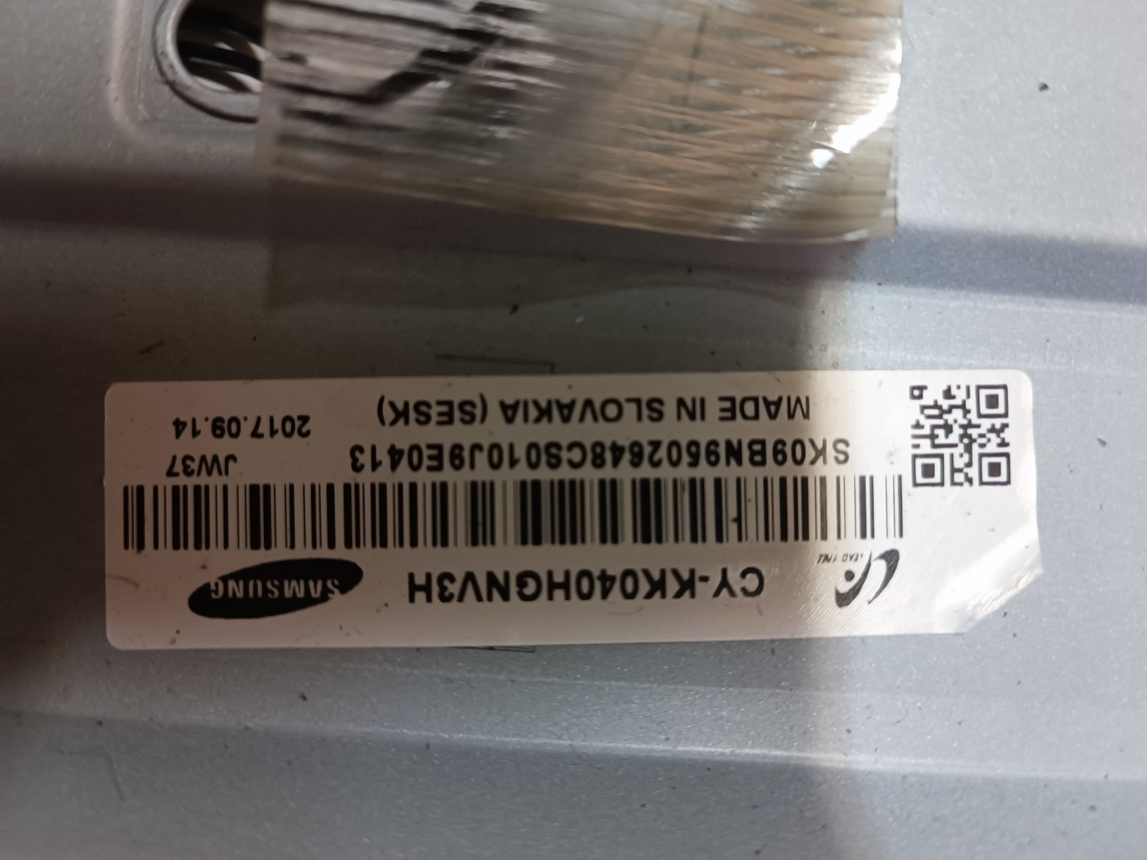

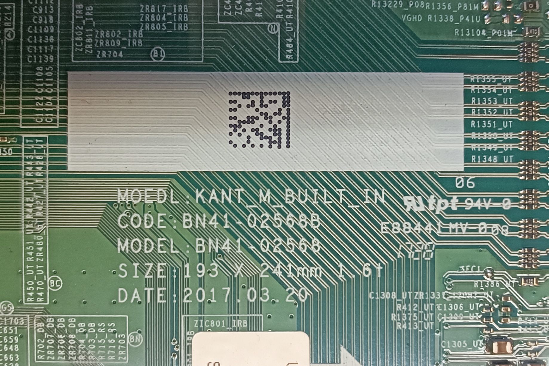

                                I used sop8 adapter, but i think my original dump of 25q80 is demaged because;
                                After dump of 25q40 and 25q80 i flashed a files finded on line with this referece
                                samsung UE40MU6450U
                                Øàññè: kant_m_built_in
                                BN41-02568b
                                BN94-11958k
                                panel cy-kk040hgnv3v
                                and after flashed on 25q40 and 25q80 tv is turn on but screen is blu..the problems is my panel is cy-kk040hgnv3h not cy-kk040hgnv3v such as the firmware finded on line.
                                when i reflashed 25q80 and 25q40 tv wont turn on..is dead and after flashed 25q40 fixed from lotas..tv already wont turn on..a this point i think my original dump is not very well or correct.
                                i haven't solution.
