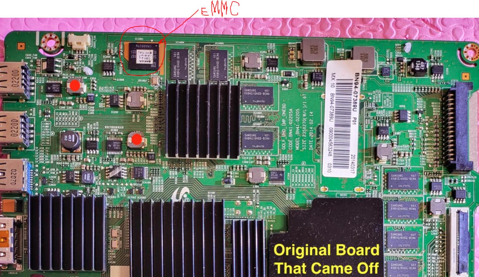

          Got another one for you good people.
          Samsung UN55HU8550
          Bootloop at Startup "SmartTV" logo.
          I found 2 chips but I am not sure which one is the firmware so Im including both.
          Both were relatively close to the processor and both were marked with a marker at the factory.
          Thank you in advance!
            Samsung UN55HU8550
            If you have a bootloop, then the problem is in the eMMC firmware.
            • KYBOSH
              • Oct 2011
              • 581
              • Unknown
              #1406
              Re: Eeprom dump thread!
              You are amazing Sir.
              Thank you for the knowledge.
              I will proceed accordingly.
