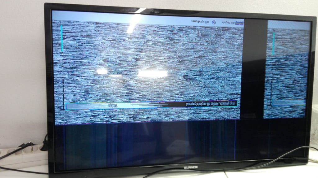

          Re: Eeprom dump thread!
          I have a TV TELEFUNKEN TE32269B38Y2D with VESTER 17MB211 and VES315WNDL-2D-N15 panel.
          The TV turns on, but the display shows some channels in contrast with double numbering (the one that appears after having done the channel search).
          It does not accept any command except the OK from the remote control and after giving so many OK the TV restarts with the same numbering problem!
          Practically there is the damaged software.
          I tried to load a new DUMP on MX25L1606E but the problem remains the same.
          Does anyone have a USB update?
          It may be that with that you get back to working properly.

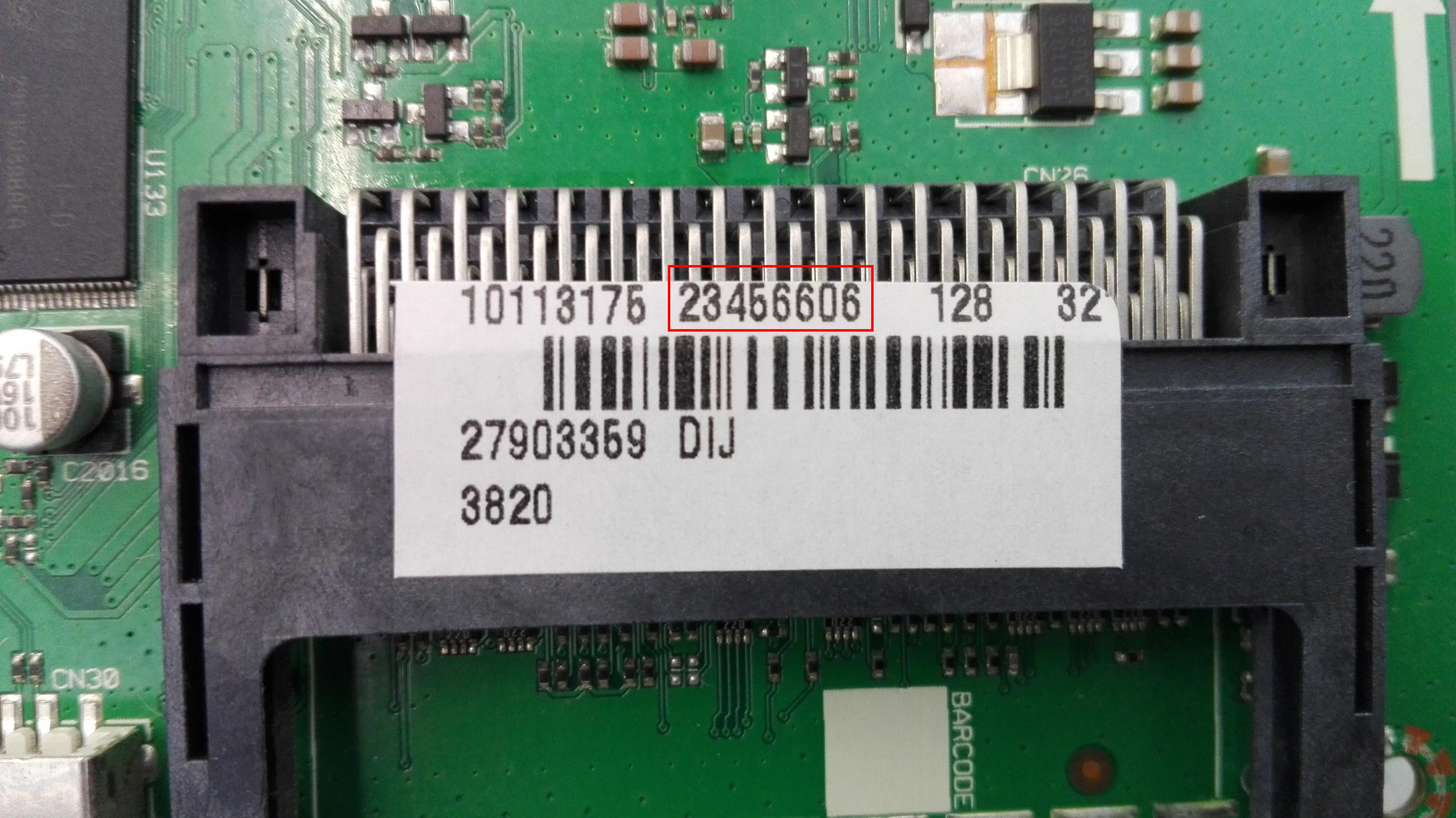

                • Daniman74
                  • Oct 2019
                  • 12
                  • Italy
                  #568
                  I uploaded this link file
                  https://www.electronicforum.ro/viewt...17MB211#p23390
                  But now I find this image !!!

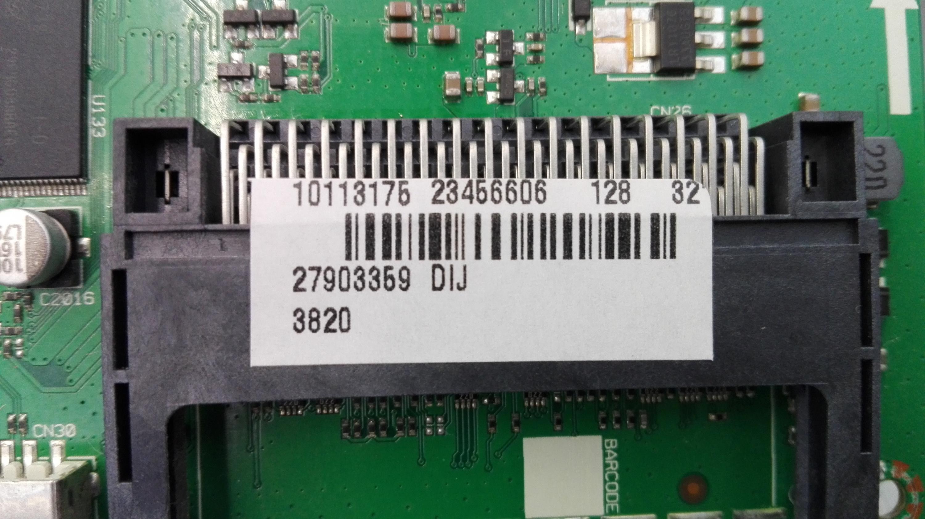

                            #573
                            3820 is nothing to do with the board, the configuration, the screen details, the software etc.
                            The only relevant numbers from the board are the long numbers. One is the serial number of the board if I recall this is the first number that's 10113175 the second number is the board number with the relevant screen information and configuration details ie 23456606. This number 23456606 is the number to look for on the main board when looking for a replacement board for the TV! As the same TV model can have more than one screen fitted to it and unless you get the correct one then more than likely your screen output will be incorrect.
                            A lot of big sellers who sell these boards in bulk on ebay uk are clueless to this information and normally use the serial number as the board model number! Which if you think about it every serial number is different! So unless you do your homework then you will be floundering in confusion as to what board to order!
