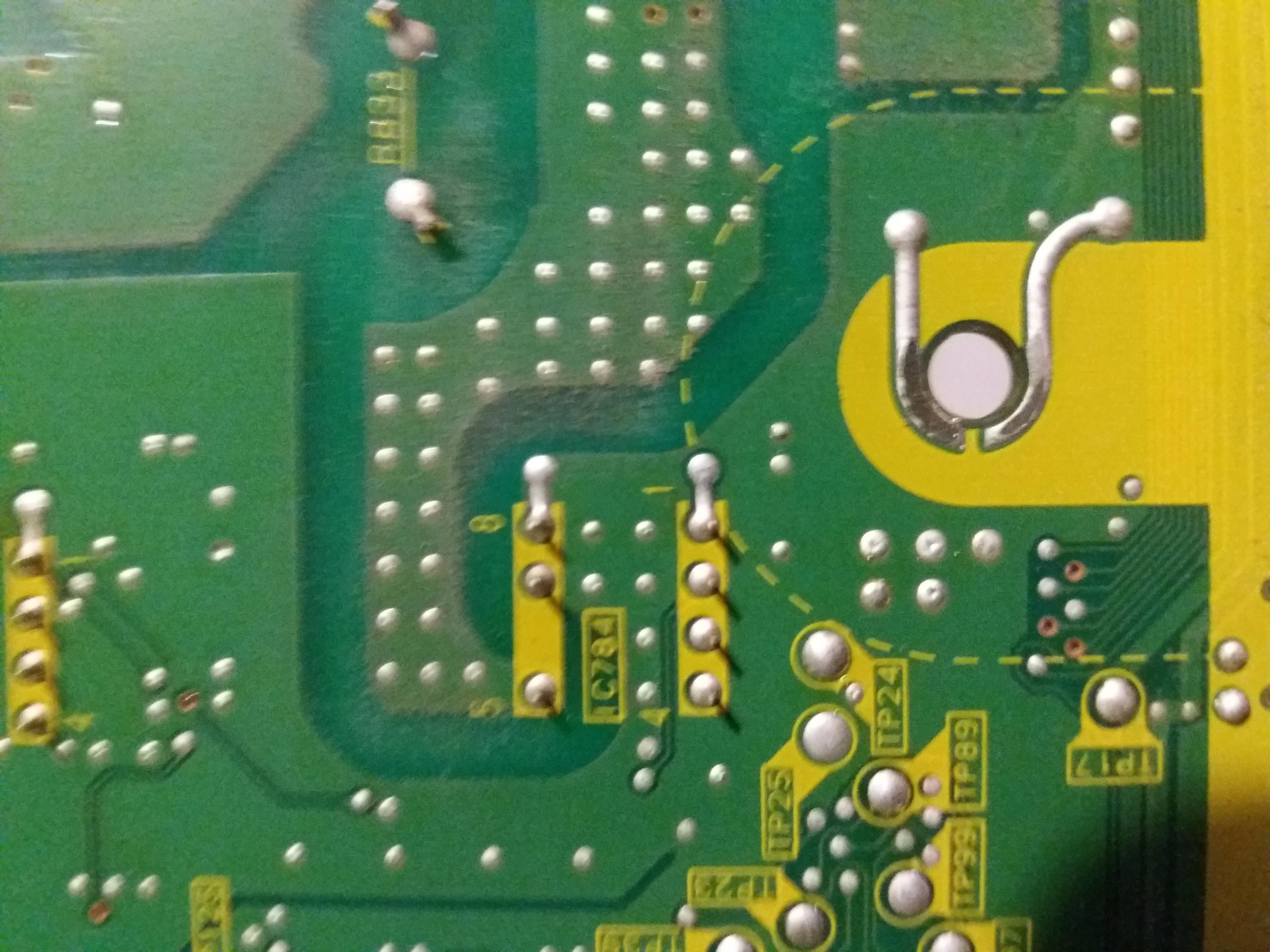

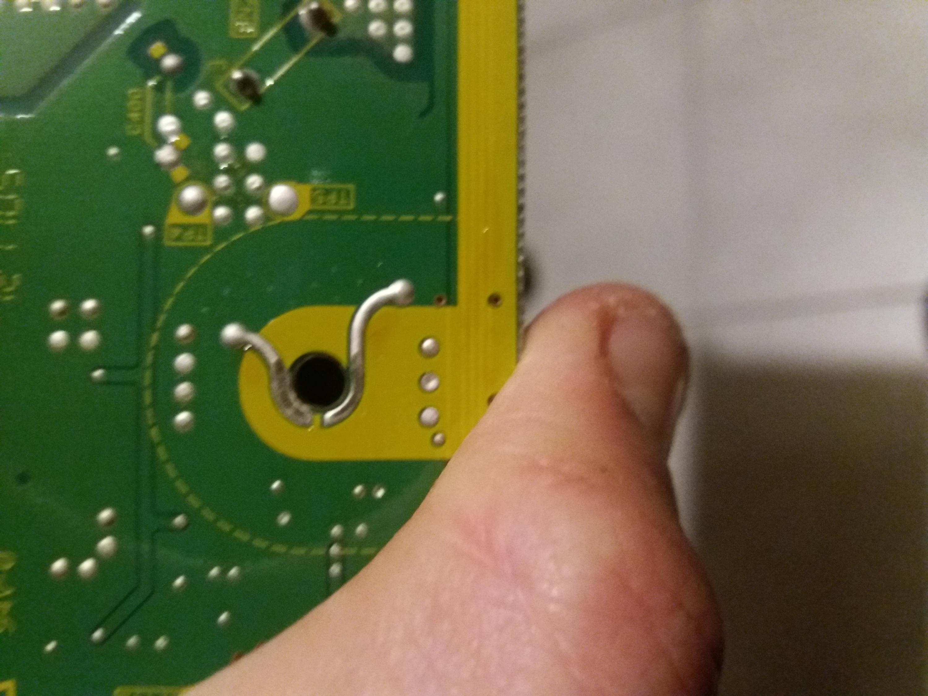

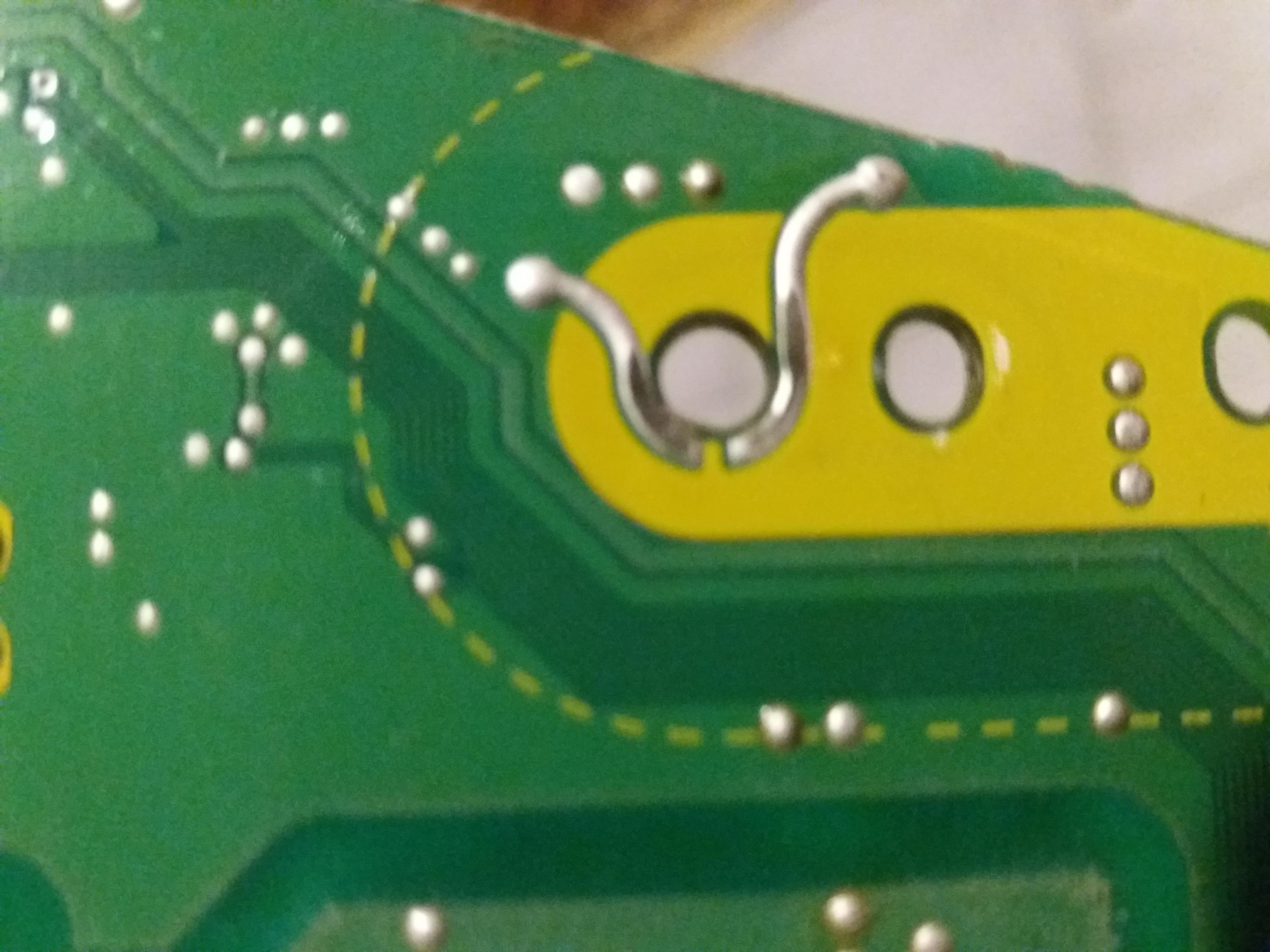

              some photos my sn s board back..
              the grounds seems to really need some resoldering
              • Moreno83
                • Jun 2014
                • 2008
                • The Netherlands
                Re: panasonic tx-p42ut30 6 blink led problem
                Hmm its normal , all models suffer the same problem. Its the beginning of the end and your lucky the sc board did not fail yet.
                If this won't fix the problem then my only advice is a new mainboard because on these boards the parts work or don't work. There is no way in between.
                Ps , when you resolder just do it gentle and make it look as new. You don't need much solder. Tiny bit of solder and reflow the whole pad. Its pretty easy if you have a 60W solder iron or good solder station. ( Middle to big tip ).
