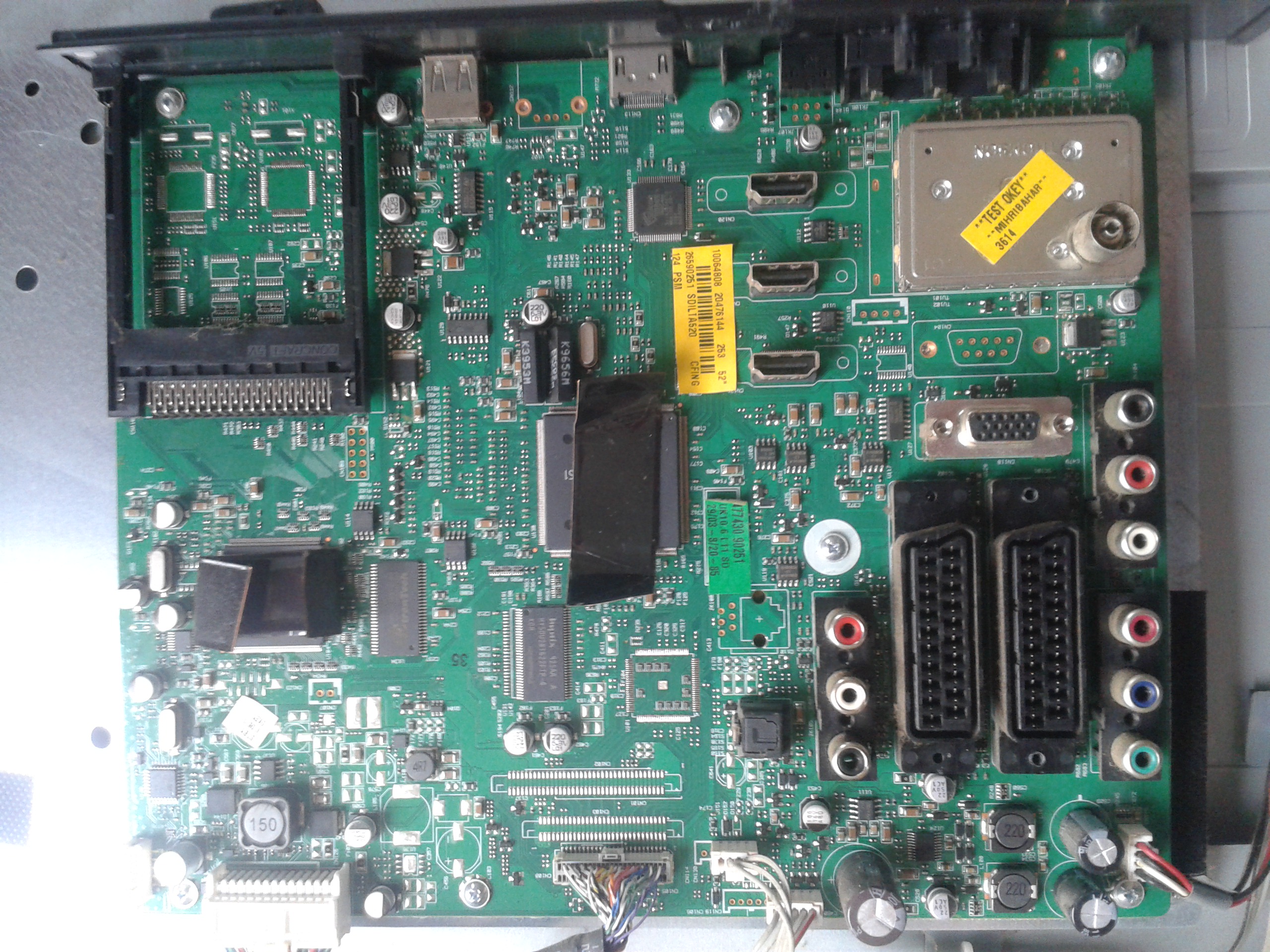

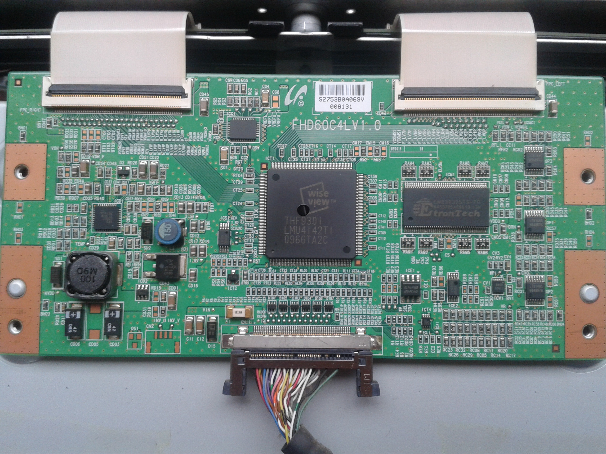

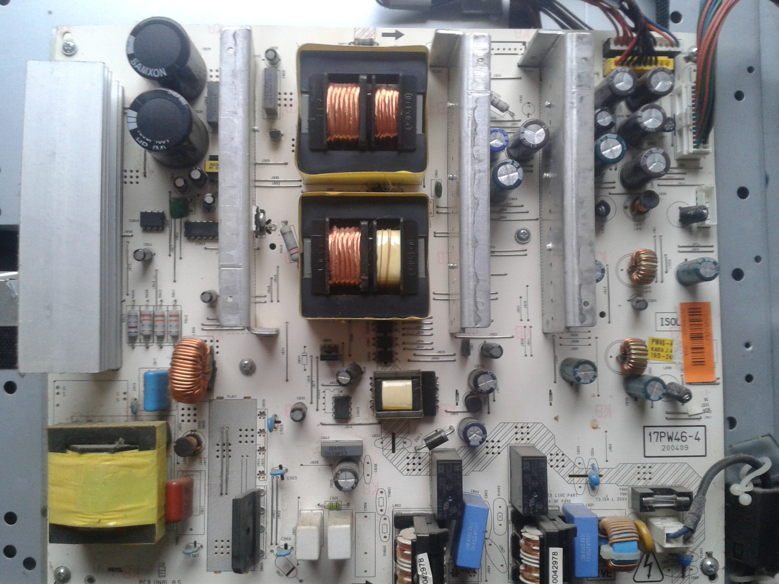

hi really sorry for taken so long to get back iv had a few family issues, so as i said the tv works fine then just shuts off and no its not the remote lol, here are some pics of the boards, one problem is there is no legend to go by for readings so where do i begin
im getting a steady
24v
3.5.v
12vLast edited by jmh474; 01-18-2017, 06:50 AM.Comment
Re: Bush LCD52786F1080P
here is the psu scematic although these can and do vary it should be ok for testing the voltages etc if you can test the tv in the working condition and when the tv goes off we should be able to tell what voltages are then missingLast edited by vinceroger69; 01-18-2017, 07:13 AM.Comment

When you say it shuts off, does it go into standby, switch off completely or do you just lose the picture.Willing to help but I'm no expert.Comment

Ok right Vestel Psu, could be cold solder joints or even failed Polly film caps causing the set to power down. Also sorry to hear, dont take what I say here personally.Please Do Not PM My Page Asking For Help Badcaps Is The Place For Advise, Page Linked For Business Reasons Only. Anyone Doing So Will Be Banned Instantly !

Hi again, so iv got another tv to play with, im at a bit of a loss to whats going on really yet again, i think its the T-con card but im not to shore is there any way of proving this, my problem is the TV stays on sometimes then other times it will just shut down. any help will be grate
On luck so i looked at tv tube strips and they had came loose
