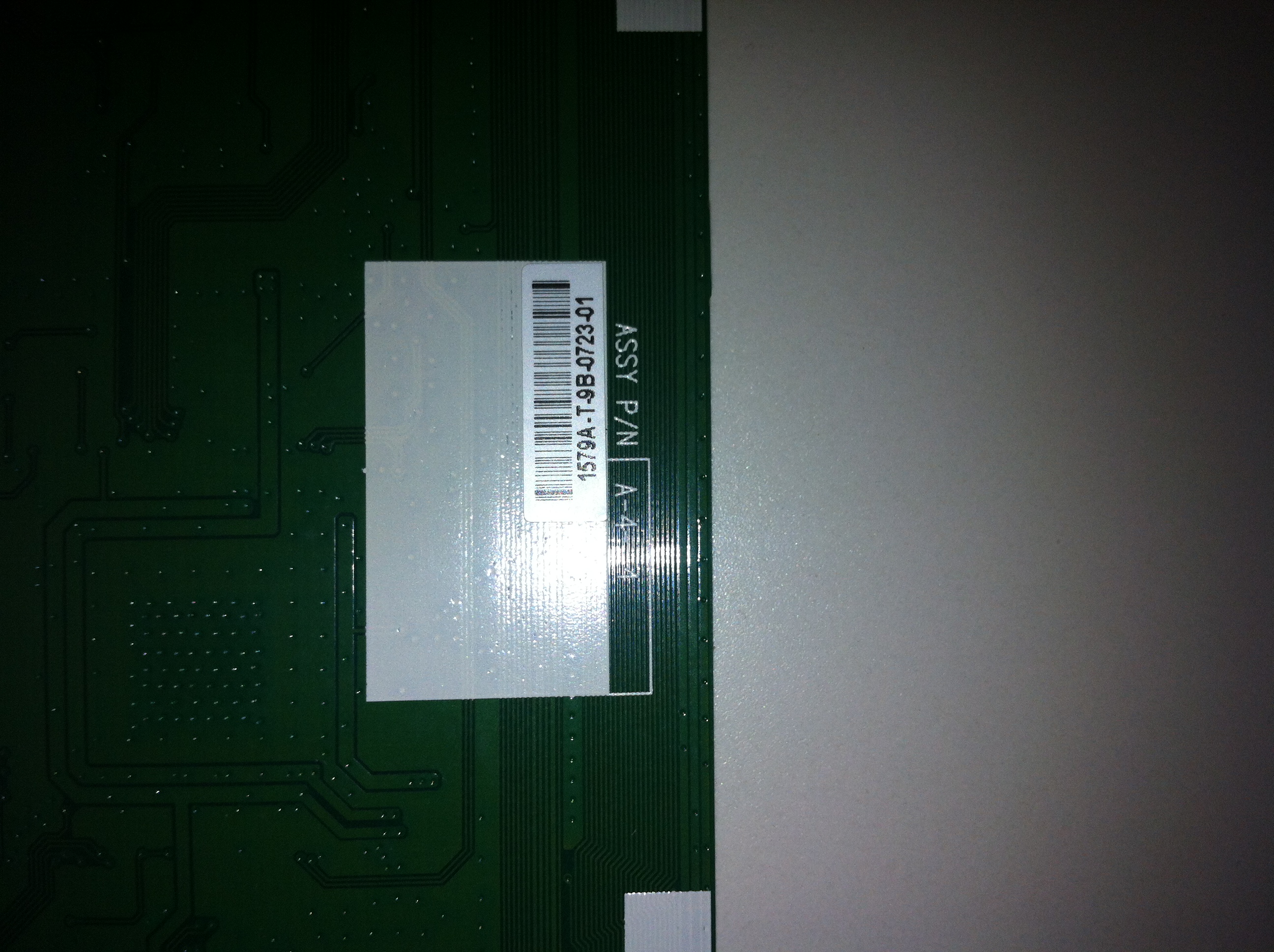

              If the T-Con board is bad, does the number on the sticker on back of T-Con board must match the replacement?

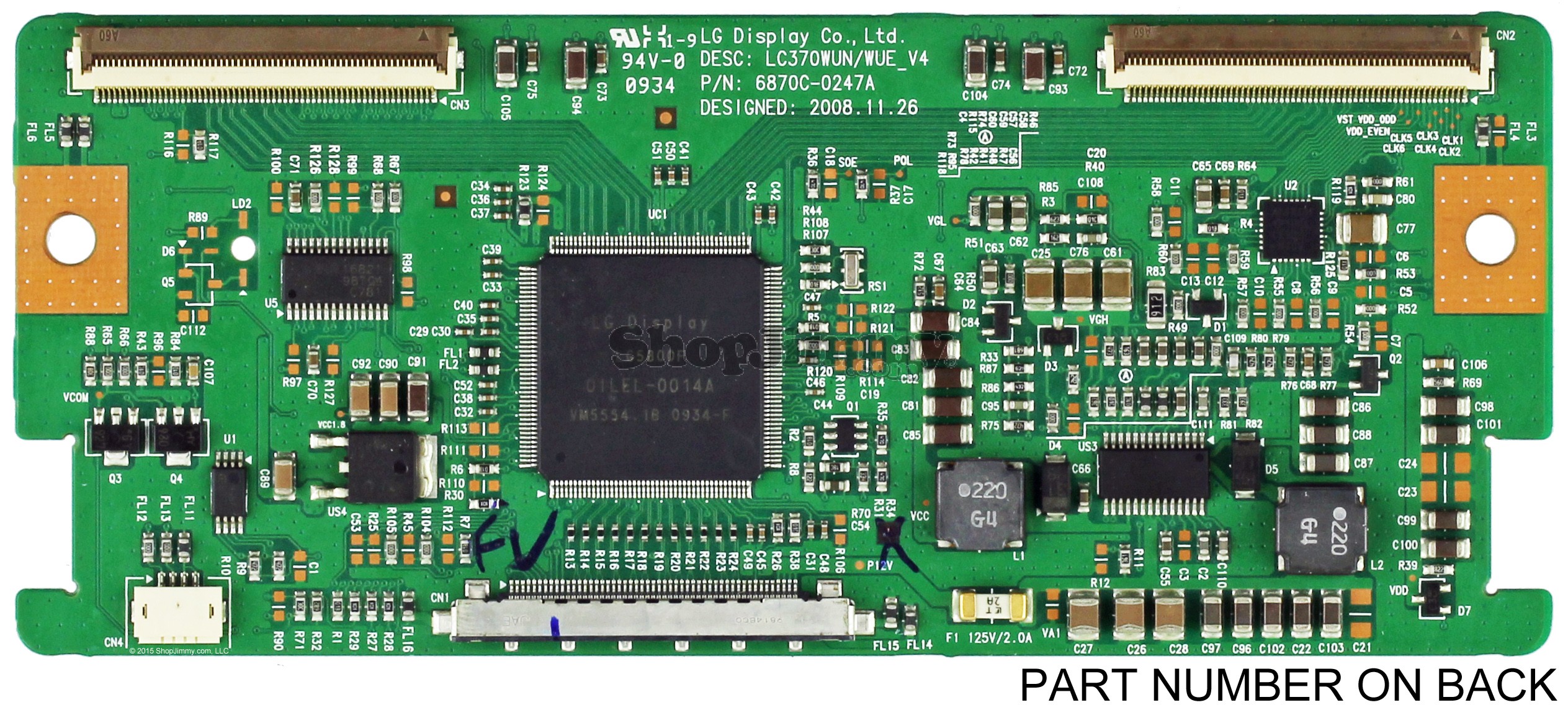

                    I know it very well may not be the T-Con board, but if I want to buy one.
                    On shopjimmy.com the one has the same part number as mine but has less components on the board, will that board still work in my TV?
                    My partial p/n on back is 1579A, so the part I am looking for is 6871L-1579A?

                      I would contact SHOPJIMMY.

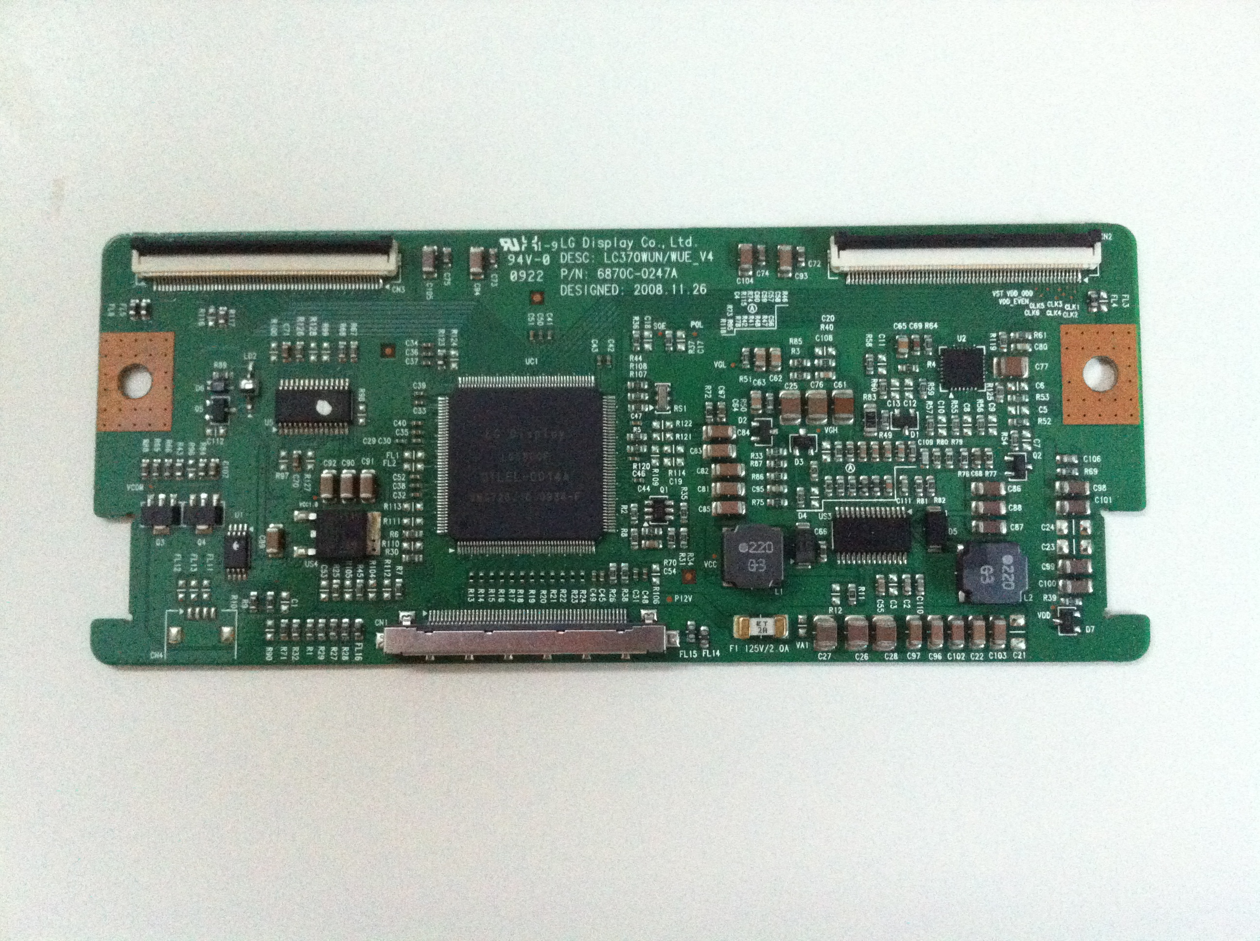

                        I received a different used t-con board, and the TV works
