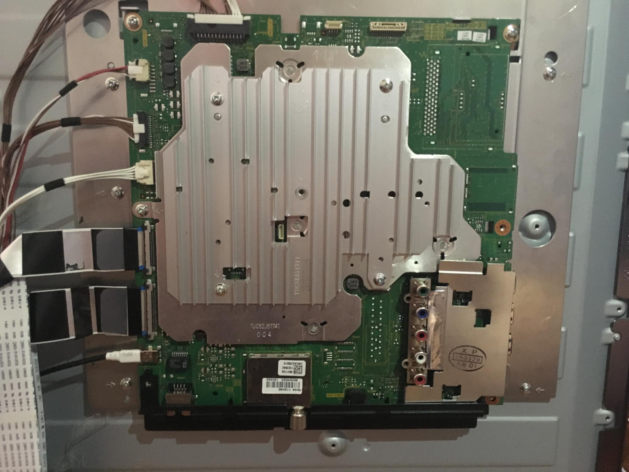

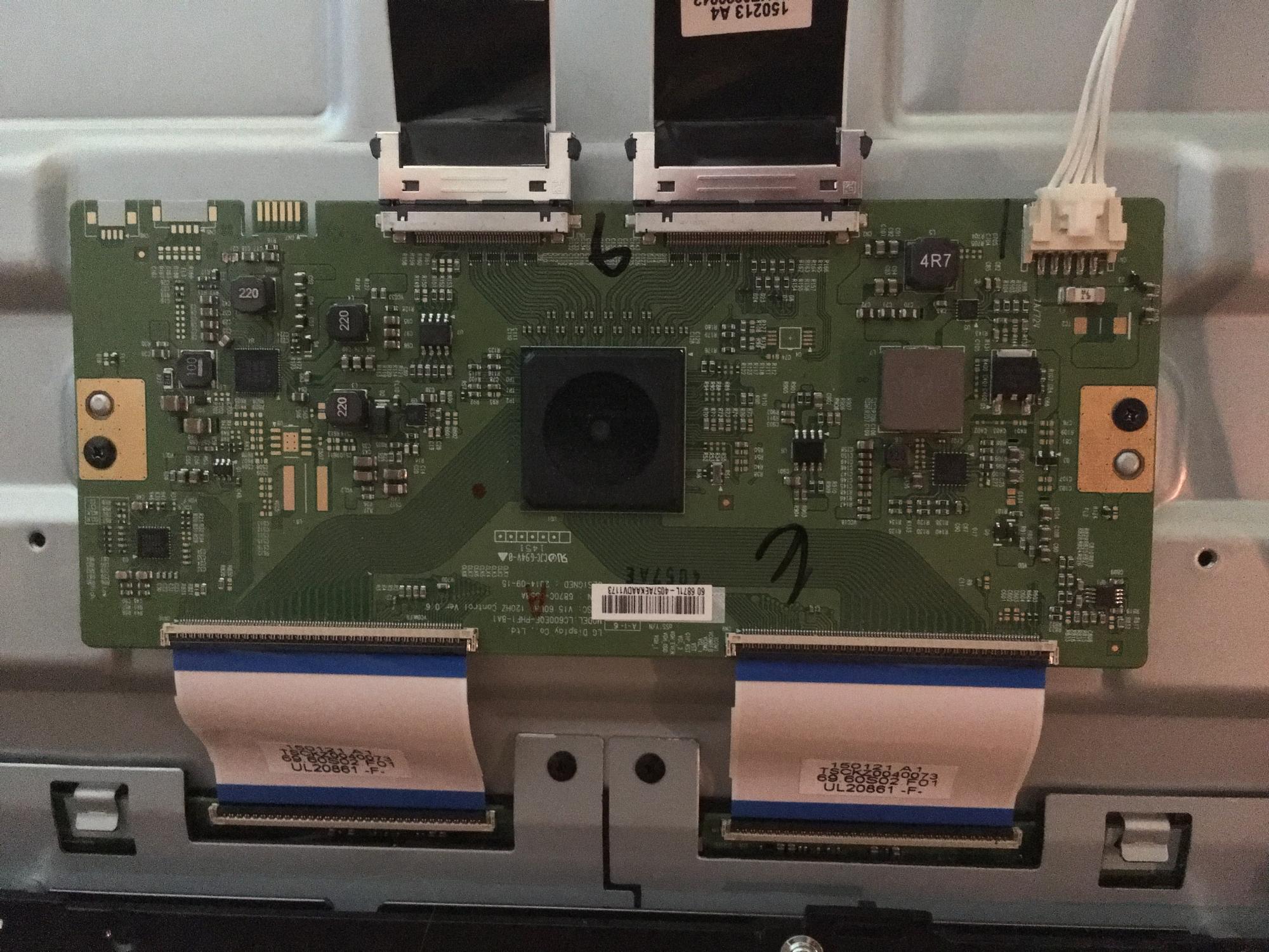

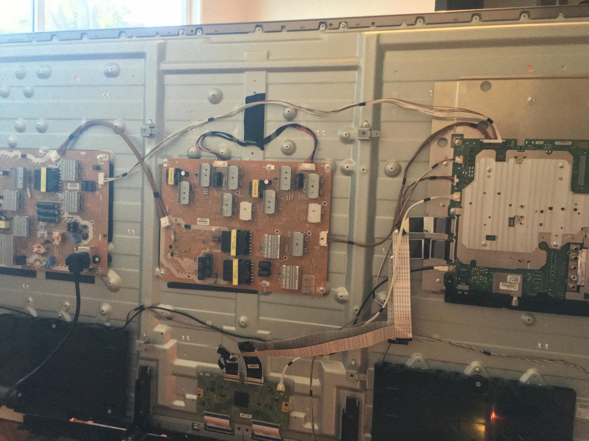

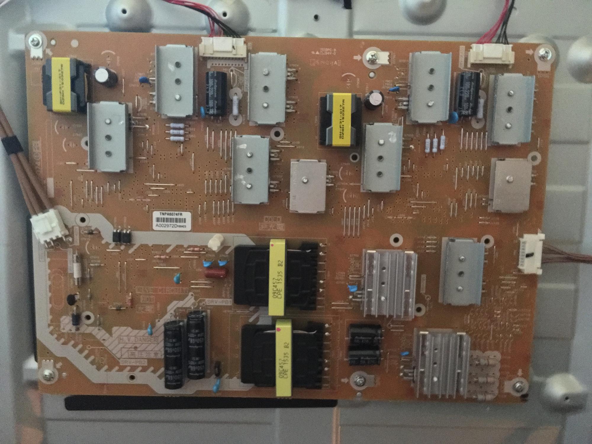

    Hi Everyone,
    Looking for a little advice.
    I acquired a 60" Panasonic LED (TH-60CX700A) a few months ago and have been idly trying to fix it. I got told it had no picture yet backlights and sound were still working, my testing confirmed this so it looked like a simple TCON replacement would solve the issue.
    Obtained a new TCON board (LC600EQF-PHF1-8A1) and installed with the same results. I figured at this point the TCON wasn't being supplied with a video signal (TV shows up on a laptop when I connect a HDMI and I'm able to get sound out) so I replaced the LVDS cables and the mainboard. Still no picture. I've tried disconnecting one half of the cables going to the tcon (both the 41pin and the 51 pin) while leaving the other side plugged in but no picture is displayed. If I disconnect both tcon cables the TV will cycle through primary colours until powered off.
    I've read over the documentation provided in BudM's LCD TV and Monitor basic troubleshooting guides and quoting from the documentation I'm assuming this is the issue:
    "Logic board supplies 5 or 12vdc to T-CON board B+ pin through switched transistor if T-CON board does not get the voltage from the logic board, you will get white/gray glowing screen without pictures."
    If I power on the TV and use the remote, the backlight changes as if it was adapting to what is supposed to be shown on screen so this part seems to be functioning as intended.
    So now I'm looking at the power to the mainboard / tcon as being the issue, I'm slightly amiss as to where to go from here though, I'm an IT tech by trade so I'm comfortable swapping out boards and cables without much issue, my electronics skills are very VERY lacking but at this stage I'd be ever so grateful if someone can provide some direction. I've got a multimeter and can test if pointed in the right direction. At this point I'm thinking the issue is with Power board A which has the white cable running to the mainboard)
    I've looked at the power boards feeding the mainboard and I can't see any bulging caps or discoloured parts, but a more trained eye might be able to spot something.
    Any help is greatly appreciated!
    TH-60CX700A
    Part numbers:
    Mainboard: TNPH11202A
    TCON: LC600EQF-PHF1-8A1
    Power board A: TNPA6060DC
    Power board B: TNPA6074FR
    Photos attached of all the boards.
    Edit: Apparently being from Australia means all your images upload upside down or something, fixed now, apologies.
    Thankyou!

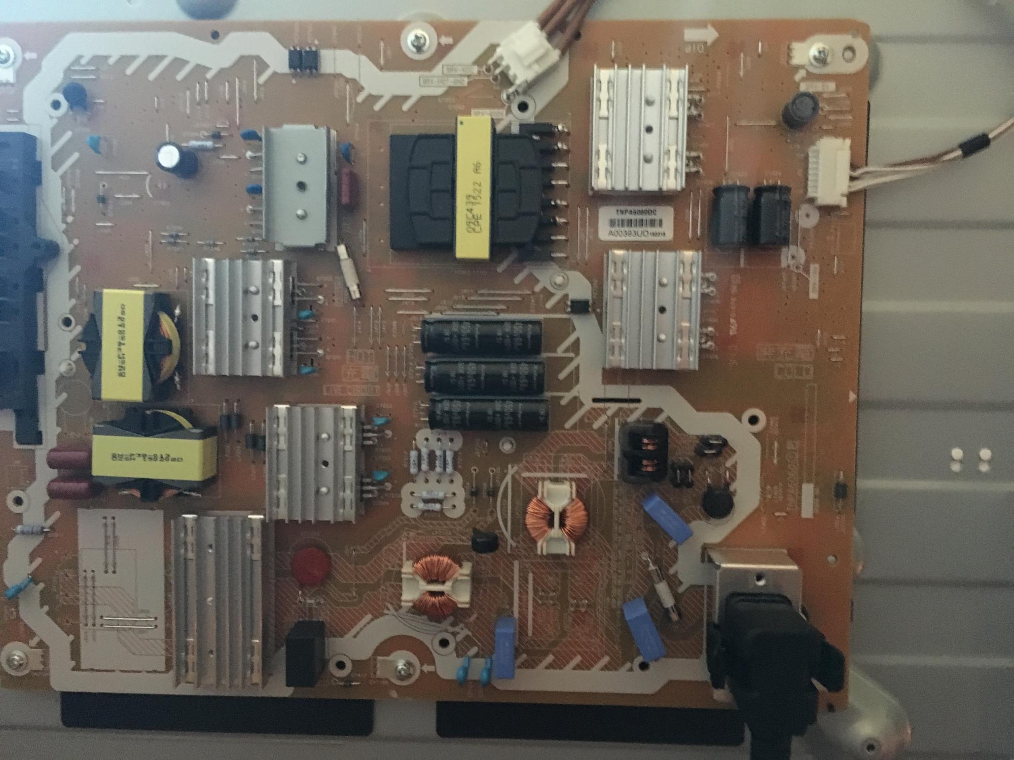

    I've now swapped out the power board (TNPA6060DC) with no luck.

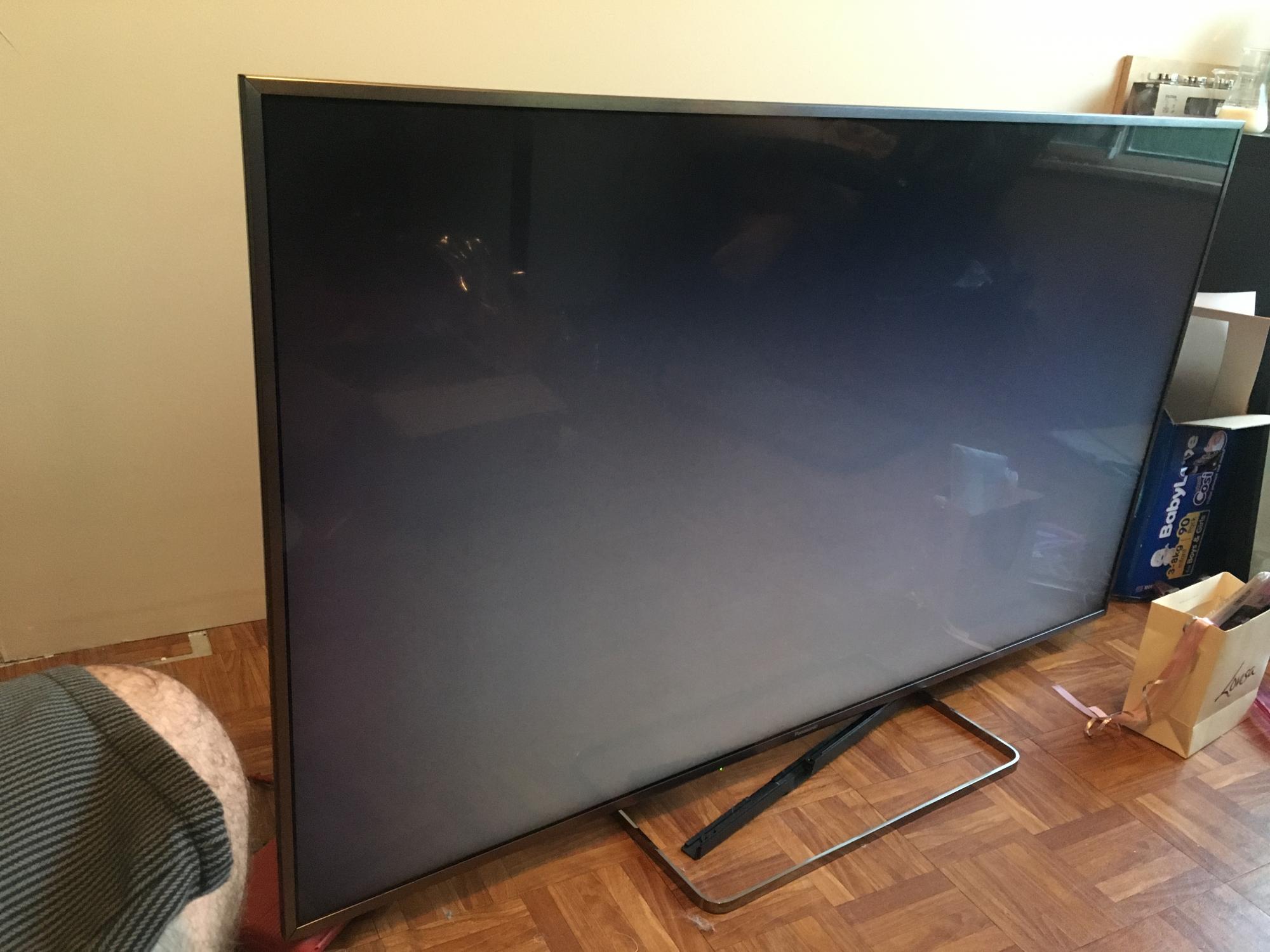

    Any suggestions on where to troubleshoot next or even telling me the panel is dead would be greatly appreciated.
    If I attempt to put the TV in test pattern mode (volume down + 3 yellow button on the remote) it begins its colour flash and cycle pattern.
    Thanks everyone.

      have you confirmed you have voltage to both sides of the fuse on the tcon board? (top right under connector white oblong fuse)

        Just checked it then, 12v on either side of the fuse.

          Top left in your t-con photo. There looks to be a ceramic cap not right ?
          • Frost3h
            • Mar 2016
            • 13
            Re: Panasonic Viera LED TH60CX700A - Sound / Backlights Working - No Picture
            Looks like that one is definitely damaged. It's refreshing to know I've missed things as this has been driving me a bit spare for a while now

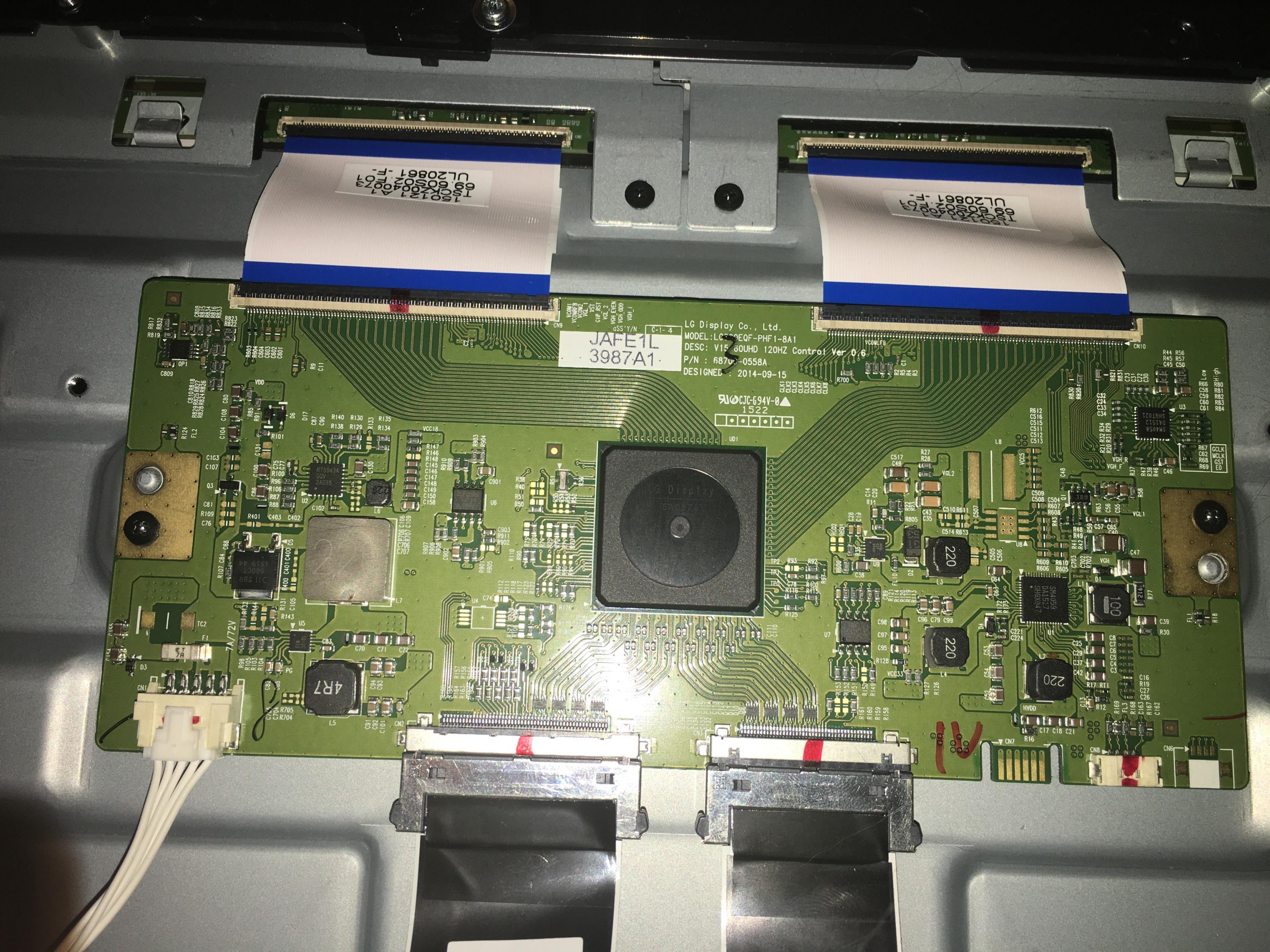

            I've attached an image of the replacement TCon I swapped over to (same issue with no picture coming through)

                the part number showing on the first T.con is 4075A the replacement shows 3987A , have you checked that this is a compatible T.Con replacement?
                  That part I regret to say I glossed over unfortunately
                  In terms of repairing the original tcon, how could I go about figuring out what the values of the ceramic cap that was damaged was?

                    The ceramic cap looks to have broken off and slipped diagonally ?
                    Can't tell from the photo how bad the damage is but you could try and solder it back or measure the cap on your other t-con.

                      The only hope you have is to find the correct T.Con . you could have caused damage to the main board or screen drivers by fitting the incorrect board, as this set uses the LG panel with a Panasonic main board the T,Con also acts to interface the two, so you would need a working 6871L-4057A to reference the components, and if you had that and your set worked there would be no need for repair

                        Hey Flocko / diif,
                        Thanks for the advice. I incorrectly assumed because I had the model correct that would have been all I needed. Combination of arrogance and naivety.
                        I've located a replacement tcon with the correct part number and model and its on its way.
                        I'll see if that cap that has dislodged can be reattached but my soldering skills aren't that precise.
                        With any luck I haven't damaged anything irreparably, if I have, this will be an expensive lesson but a lesson all the same.
