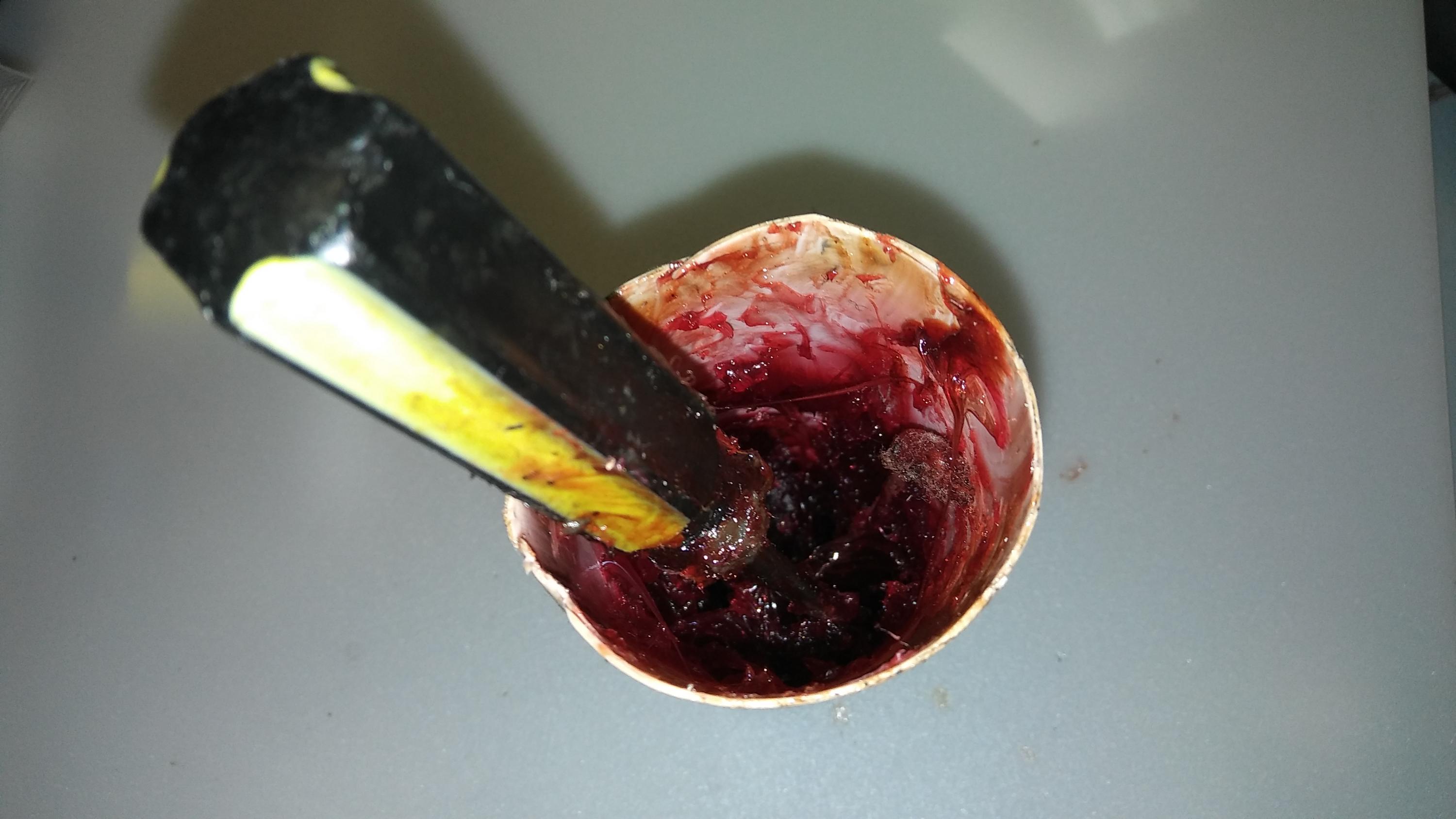

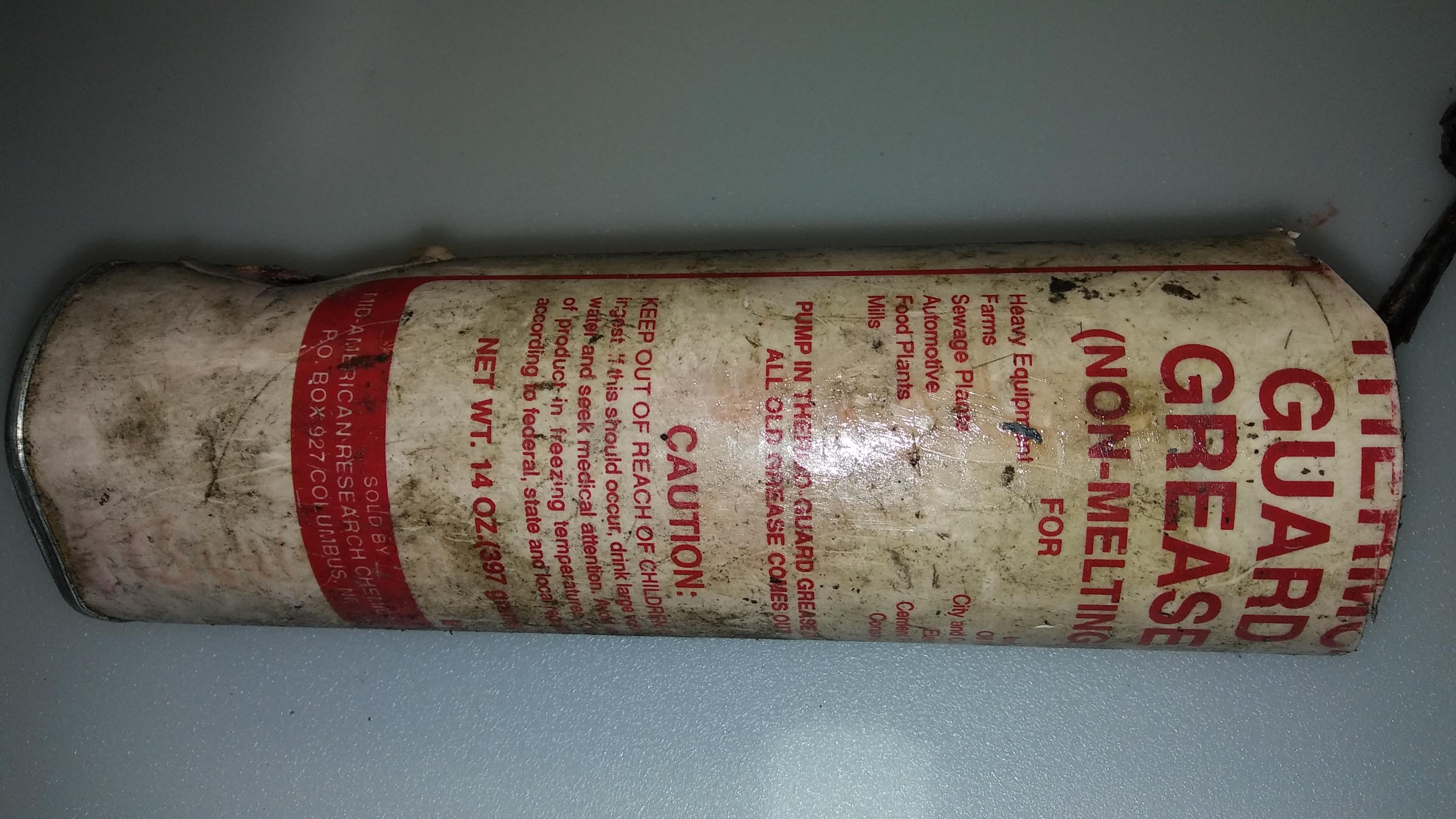

                  MY TIPS: After change 3BR1565, you do need put some heat sink compound, a white thermal paste, I hate it, white stain mess everywhere. I sub with this( PIC 1,2), original use for car transmission, which i used in CPU processor and Xbox GPU ......for about 20 years still has some left.
