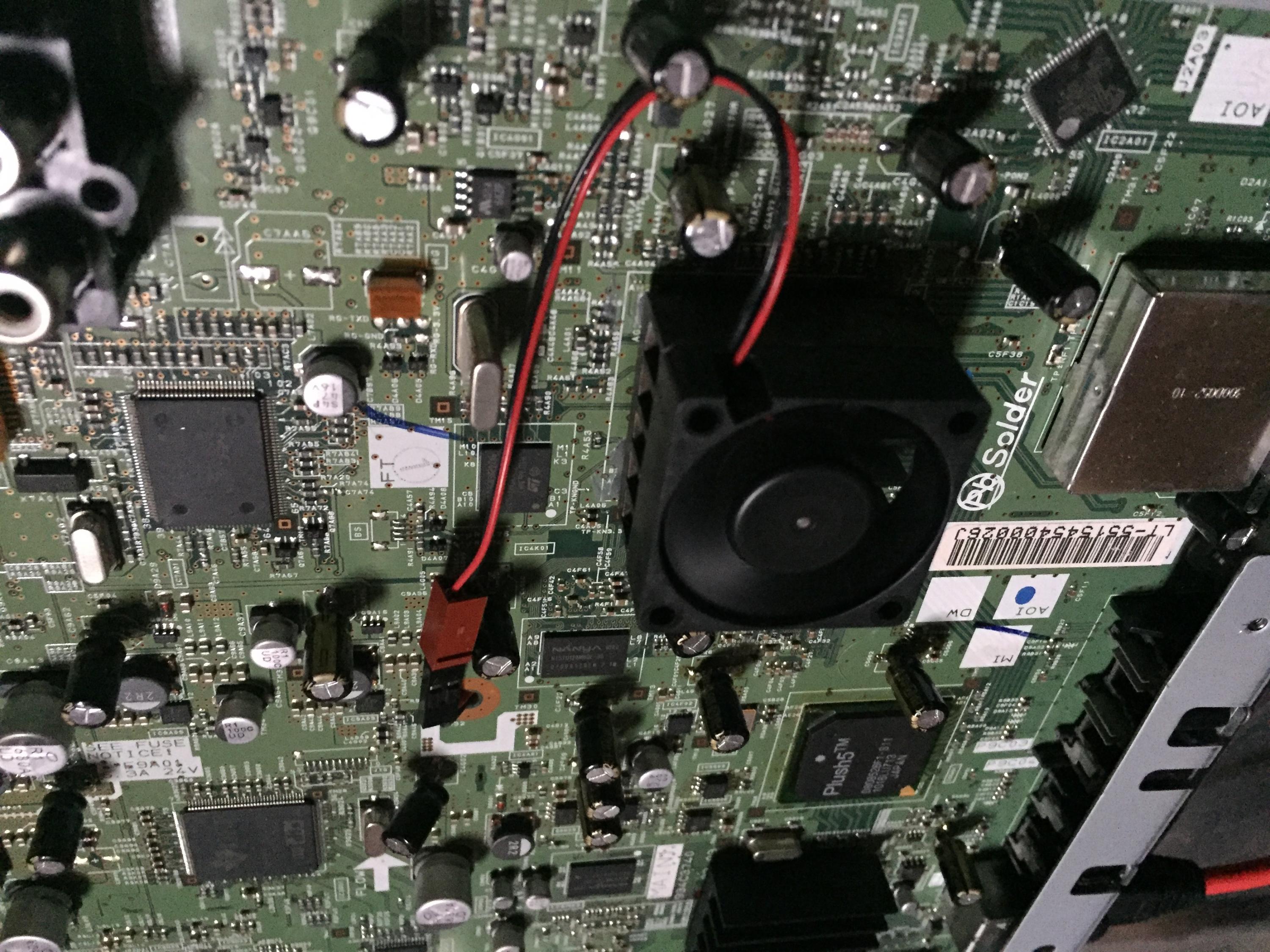

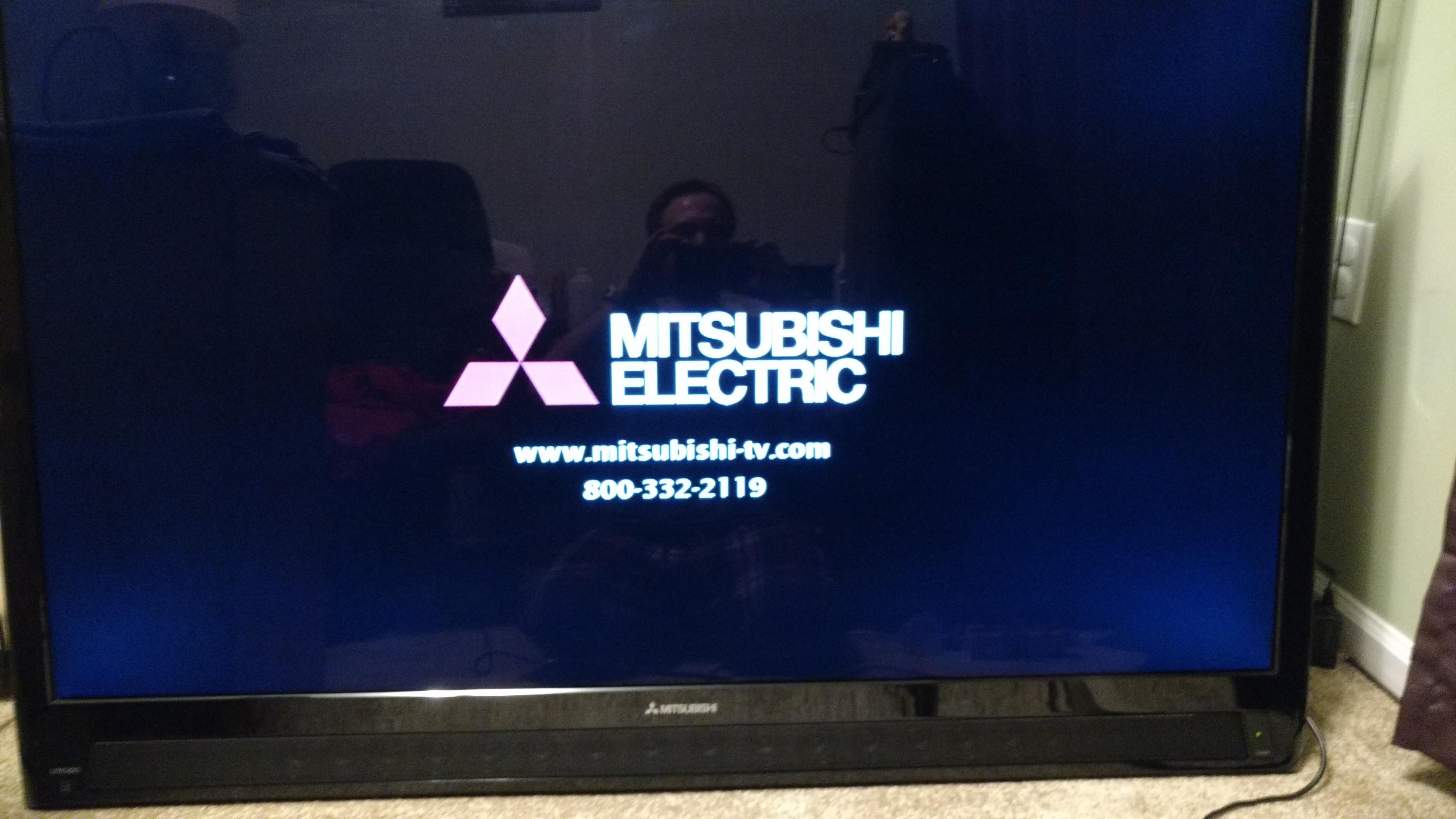

          Update: my LT-55164 lives! I studied some videos on how to reflow chips, and picked up some liquid flux and a X-tronic reflow solder station. Performed the operation on just the Broadcom video chip, using some Sekisui thermal tape to re-affix the heatsink. Turned it on (thinking in the back of my head, no way this will work), and voila! Been using it for a couple weeks now, and haven't noticed any issues.
          I also attached a small fan on account of how unbelievably hot the heatsink gets after only a few minutes of on-time. Tied it in to a 12 vdc feed from the power supply, and got lucky in that the 12 vdc turns on and off along with the TV. Decided to cut a ventilation hole in the back and covered with a gutter shield... it's not pretty but it runs cool now!
          Again, MAJOR THANKS to Michael Long for the info, my TV would still be collecting dust

              4.) This morning I re-installed the mainboard, plugged the power cord in, watched the green light start flashing, had a doubting few moments, and then the green light went completely off.
              5.) Pressed the power button, watched the screen come alive, entered into the service menu with the remote, checked that I still had the correct screen size configured, did a full initialization, scanned the channels and started enjoying one of the finest LED screens I've laid eyes on.

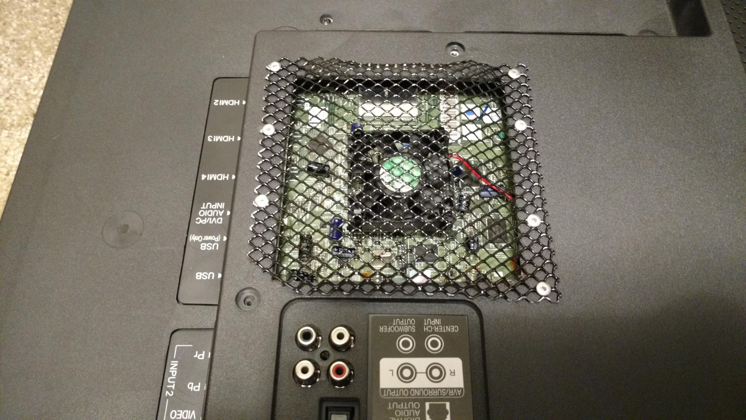

                          #52
                          Re: Mitsubishi LT-55154 Blinking Green Light?
                          I too just followed mazdaspeeds instructions and to my amazement the TV came back to life! Thank you all for sharing your brilliance! I hope it lasts for a while.
                          I did have some melting/distorting of the black plastics around the av ports, etc despite covering with AL foil. Minor problem.
                          Prior to putting the back cover on I decided to cut some air vent holes above and below the heat sinks on the main board for good luck.
                          Thanks again.

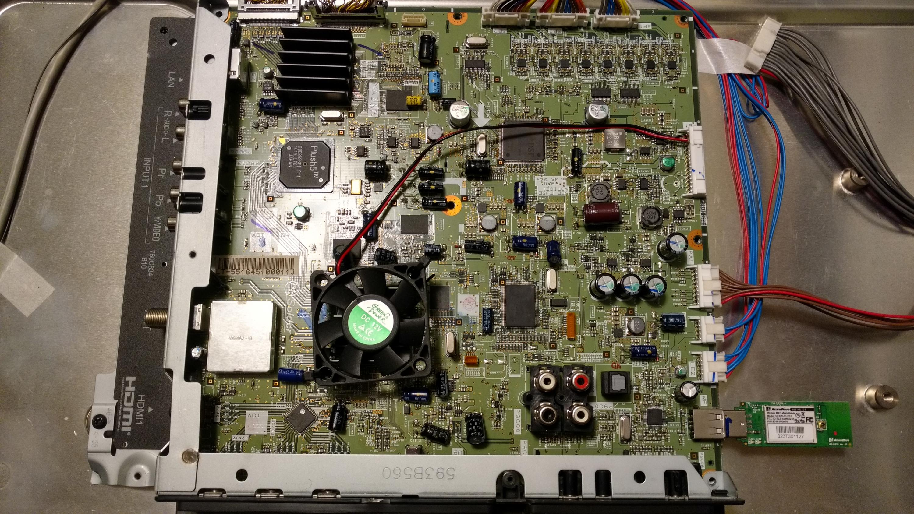

                                • Nyjetfan21
                                  • Oct 2017
                                  • 11
                                  #56
                                  Re: Mitsubishi LT-55164 Blinking Green Light Is Back?
                                  I have a Mitsubishi LT55164 that I repaired almost 2 years ago due to a constant blinking green light. Well guess what it happened again The same blinking green light . I did also install an internal fan that constantly runs even when the TV is powered off . So now I'm back to square one where I have to reflow the GPUs and reinstall the heat sinks . The one question I have is how can I install the fan where it only powers up when the TV is turned on and don't have to run constantly like it used to . Does anybody have a diagram or a video to show me how to wire the fan in and only power up when the TV is turned on thank you
                                  • R_J
                                    • Jun 2012
                                    • 9532
                                    #57
                                    What are the specs on the fan? is it a 120v ac fan or a 12v dc fan. or something else?
                                    • nomoresonys
                                      • Jan 2013
                                      • 12087
                                      • U.S.
                                      #58
                                      Ran across this fan mod, I don't know if this would put extra stress or have any adverse effects on the circuit or not. I should think the best way to use 2 case fans for cooling would be one towards the bottom drawing air in and one towards the top exhausting the hot rising air out: https://www.youtube.com/watch?v=wRrHL-em854

                                          I installed fan on the GPU... Multi Volt Fan 3 v - 12 v running at 5 v... on the USB Circuit... See Image above for FAN Mounting. Fan was also a 80,000 hour MTBF
                                          I also Re-flowed the GPU and Epoxied the four corners... My GPU now runs ICE Cold..
                                          The 5 volt USB circuit will time out and eventually shut down...
