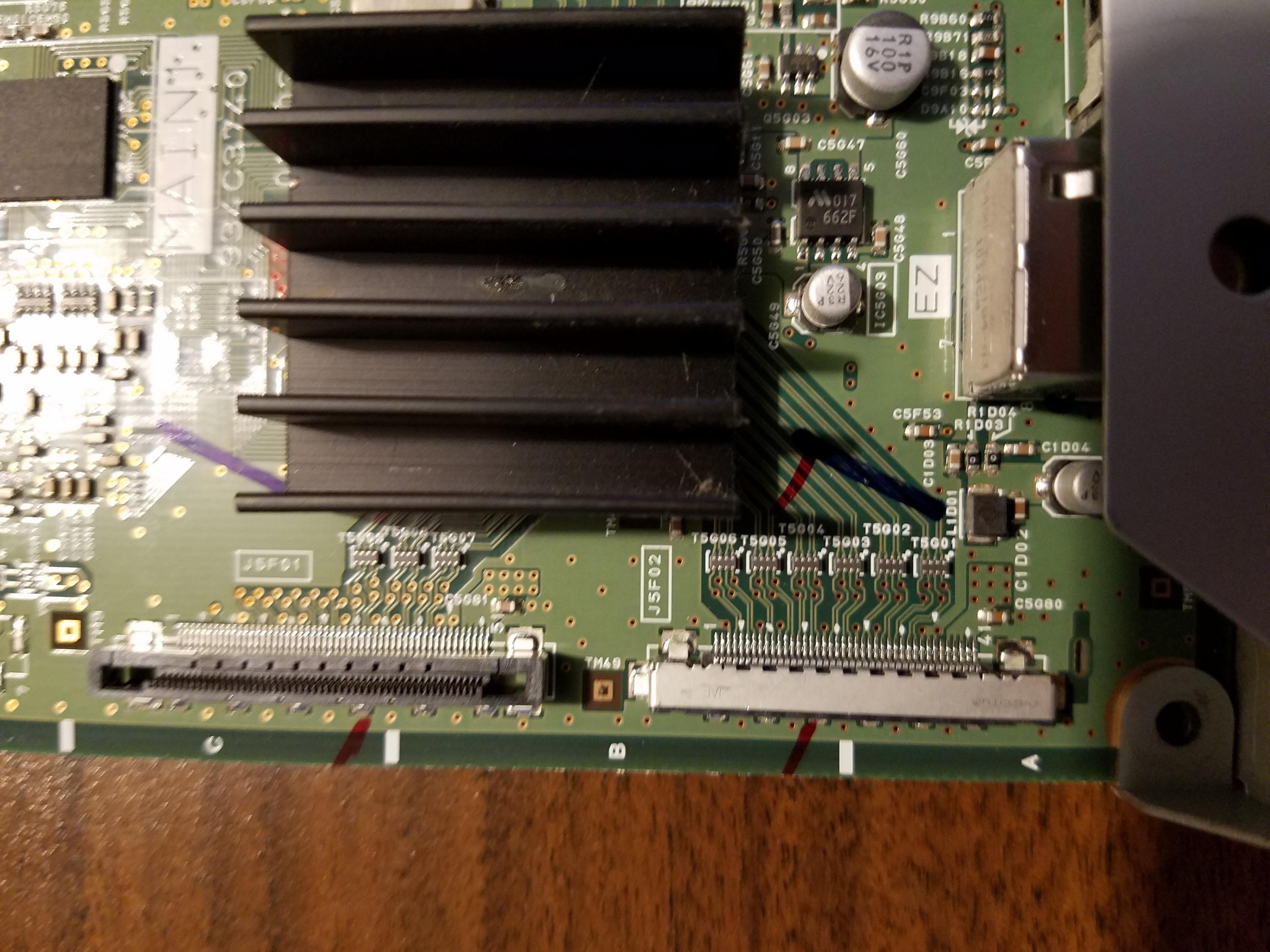

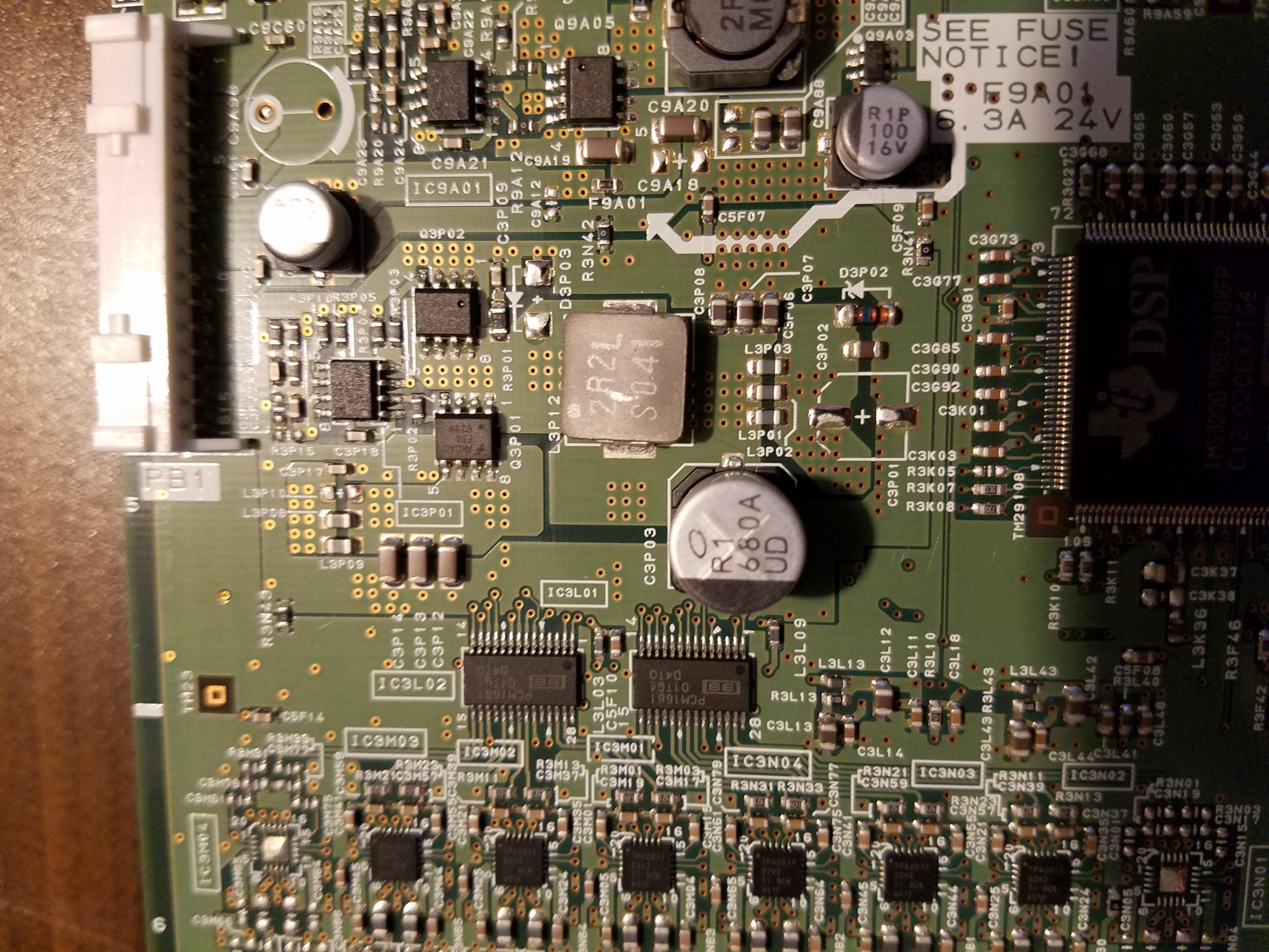

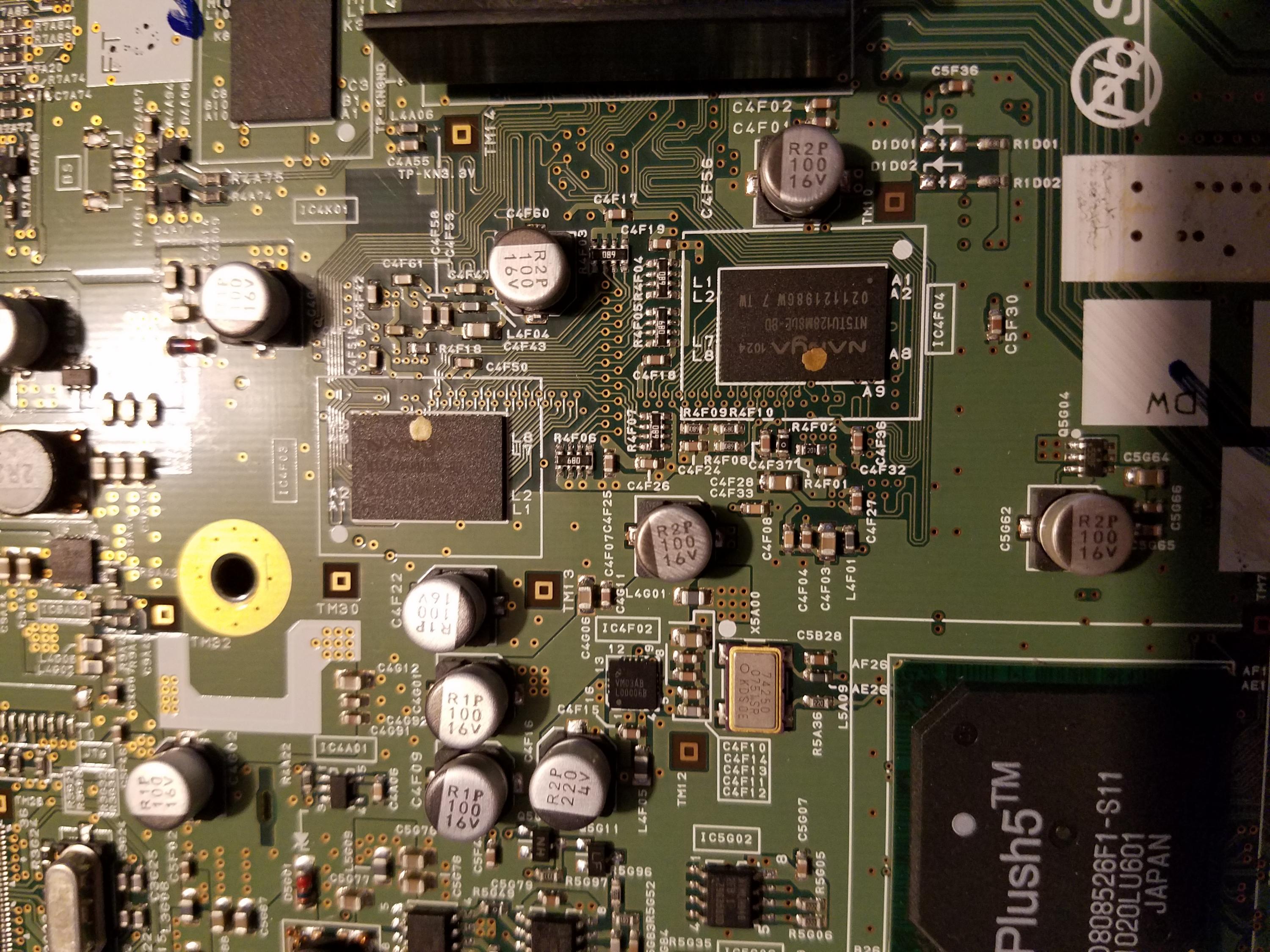

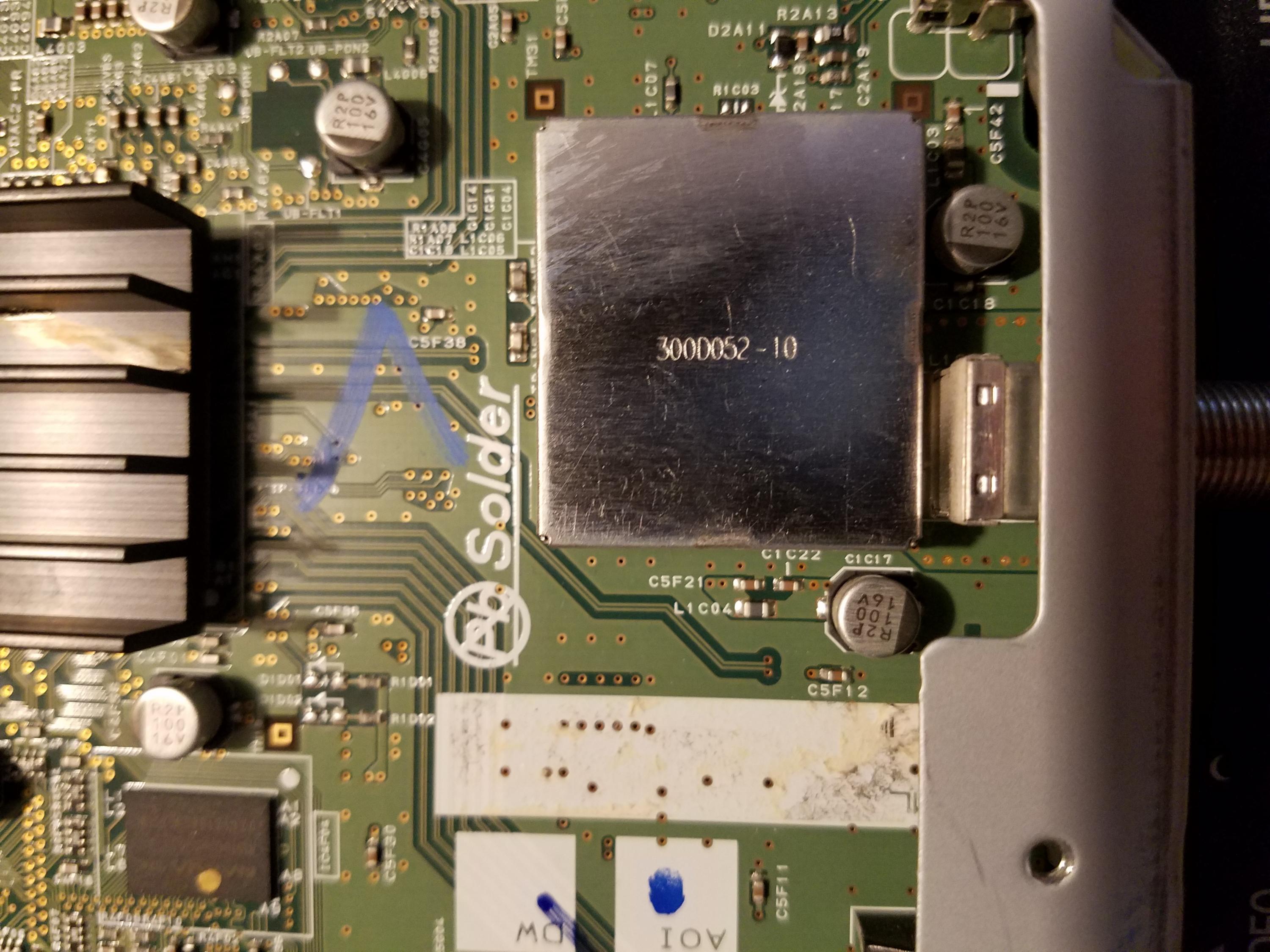

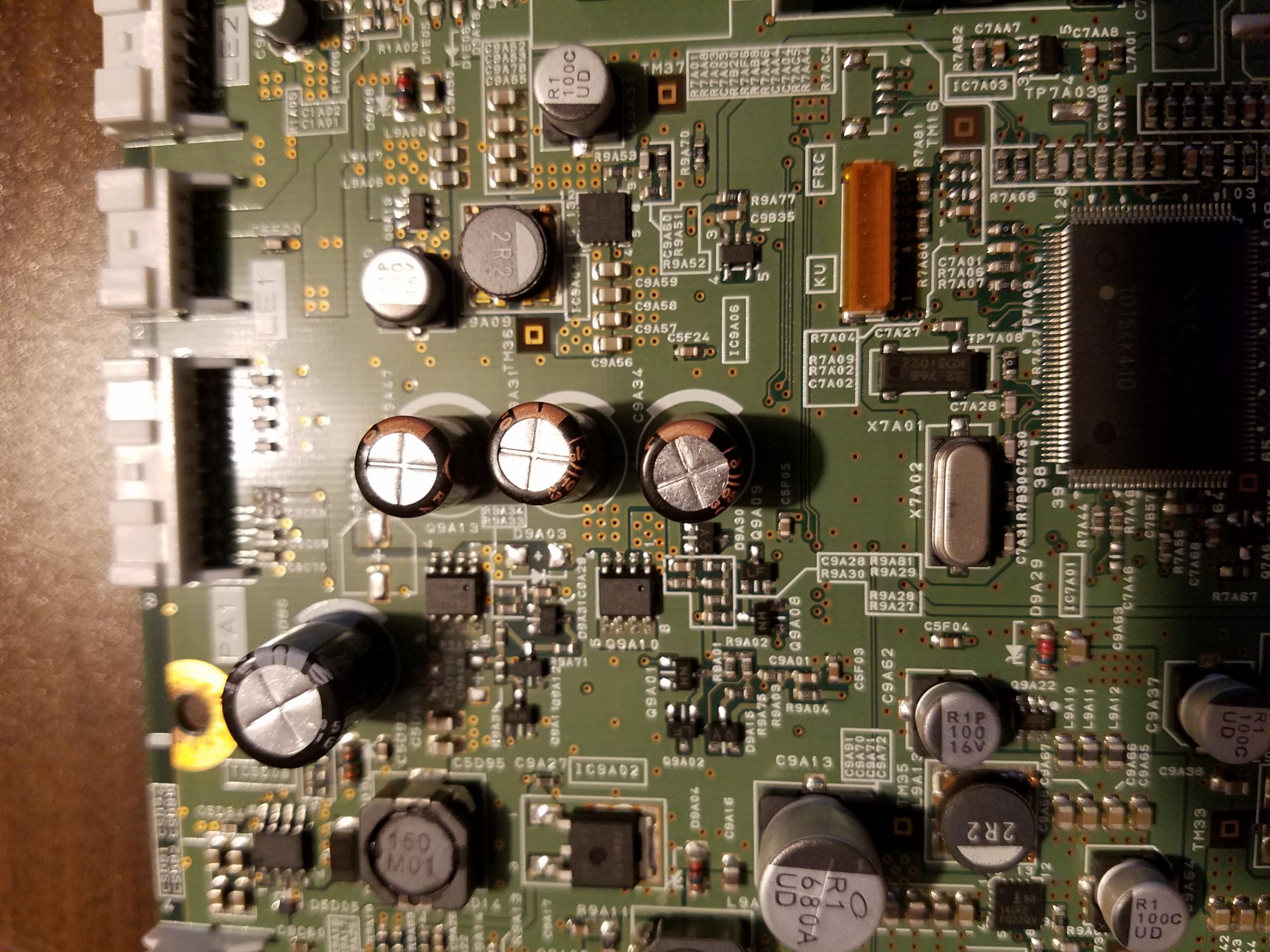

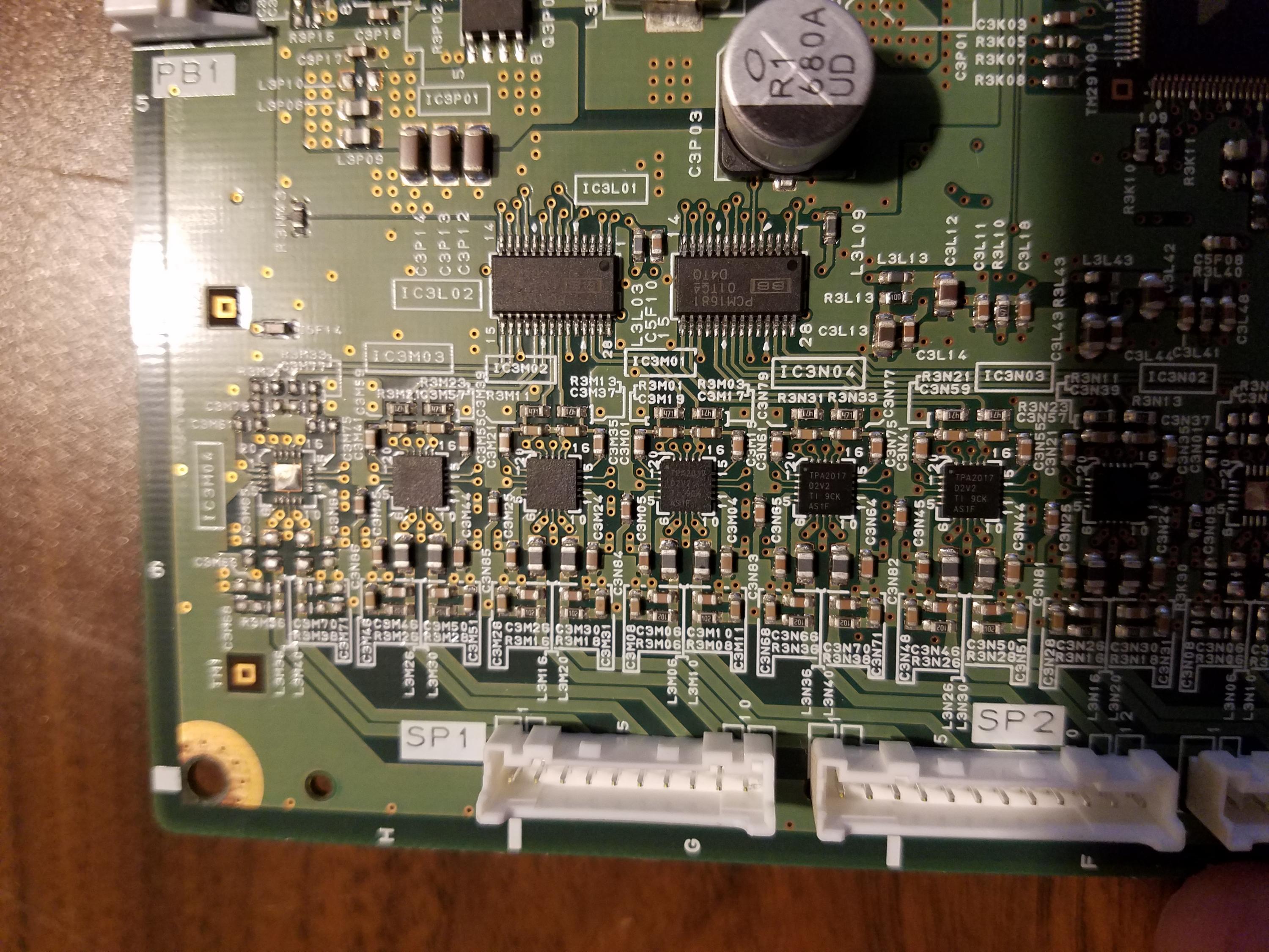

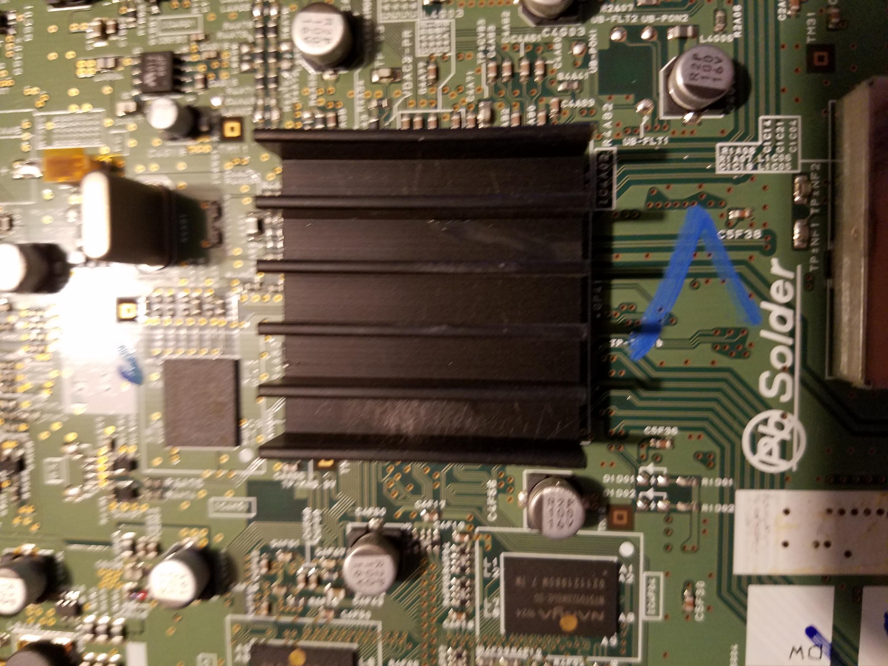

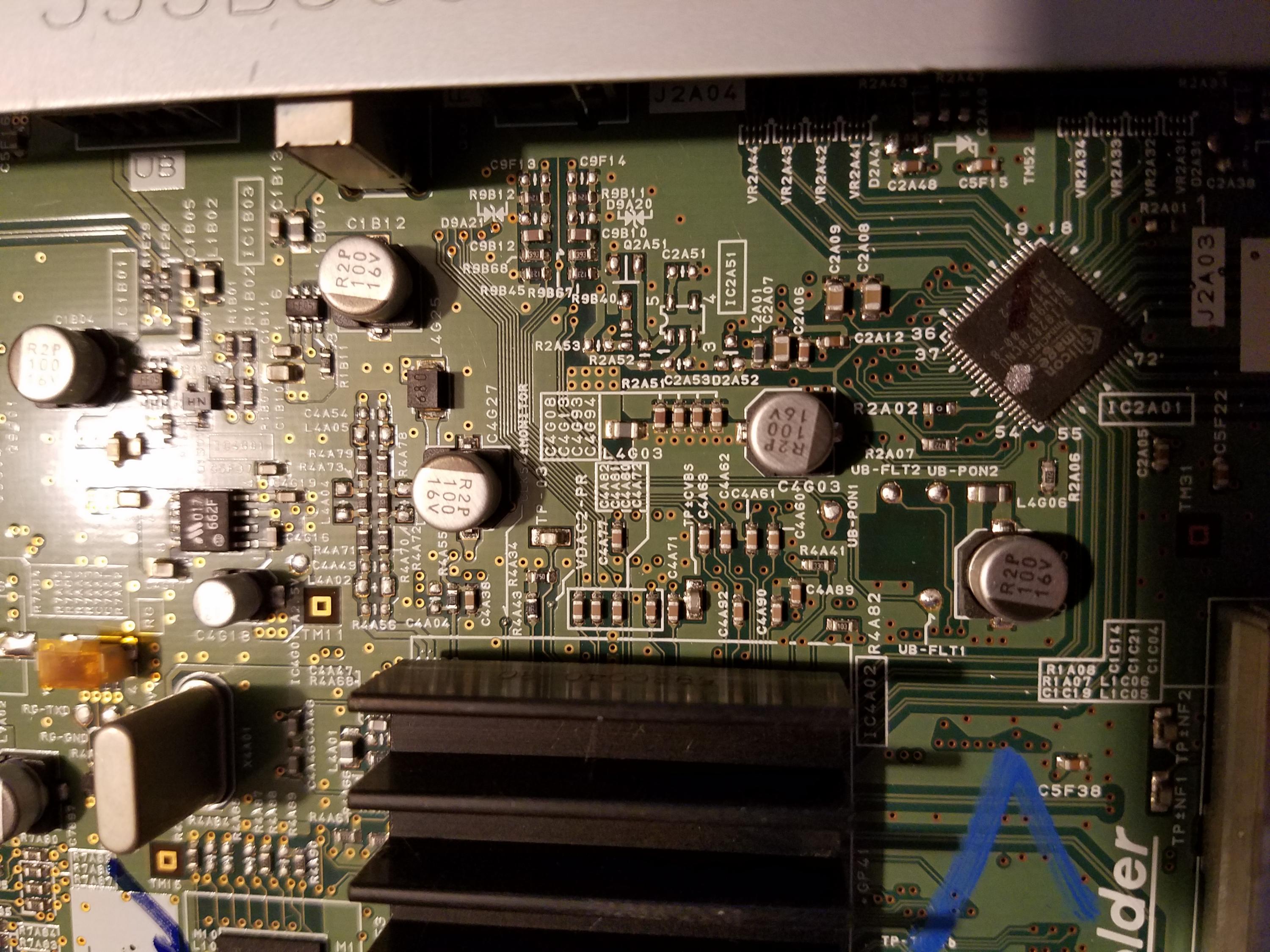

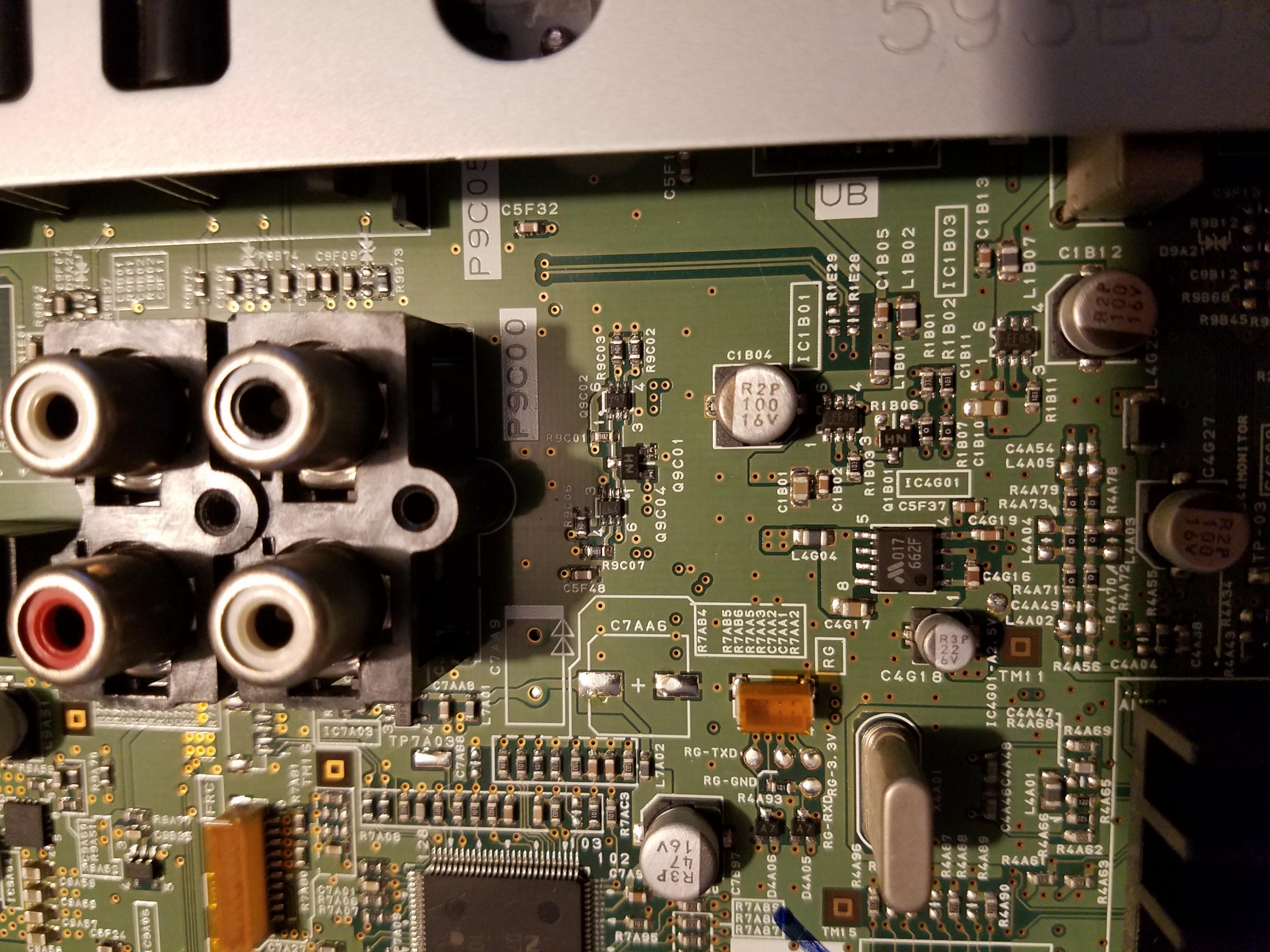

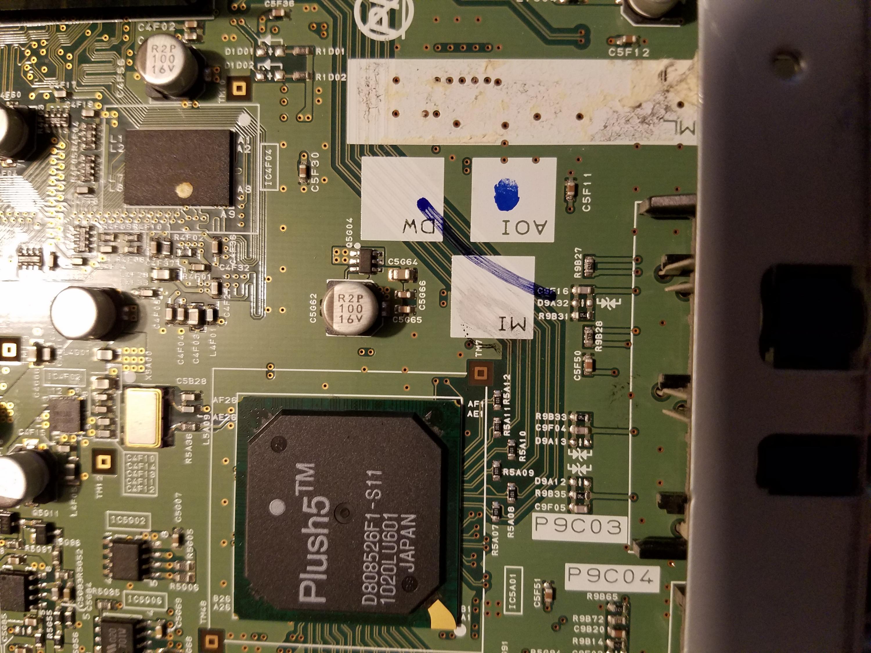

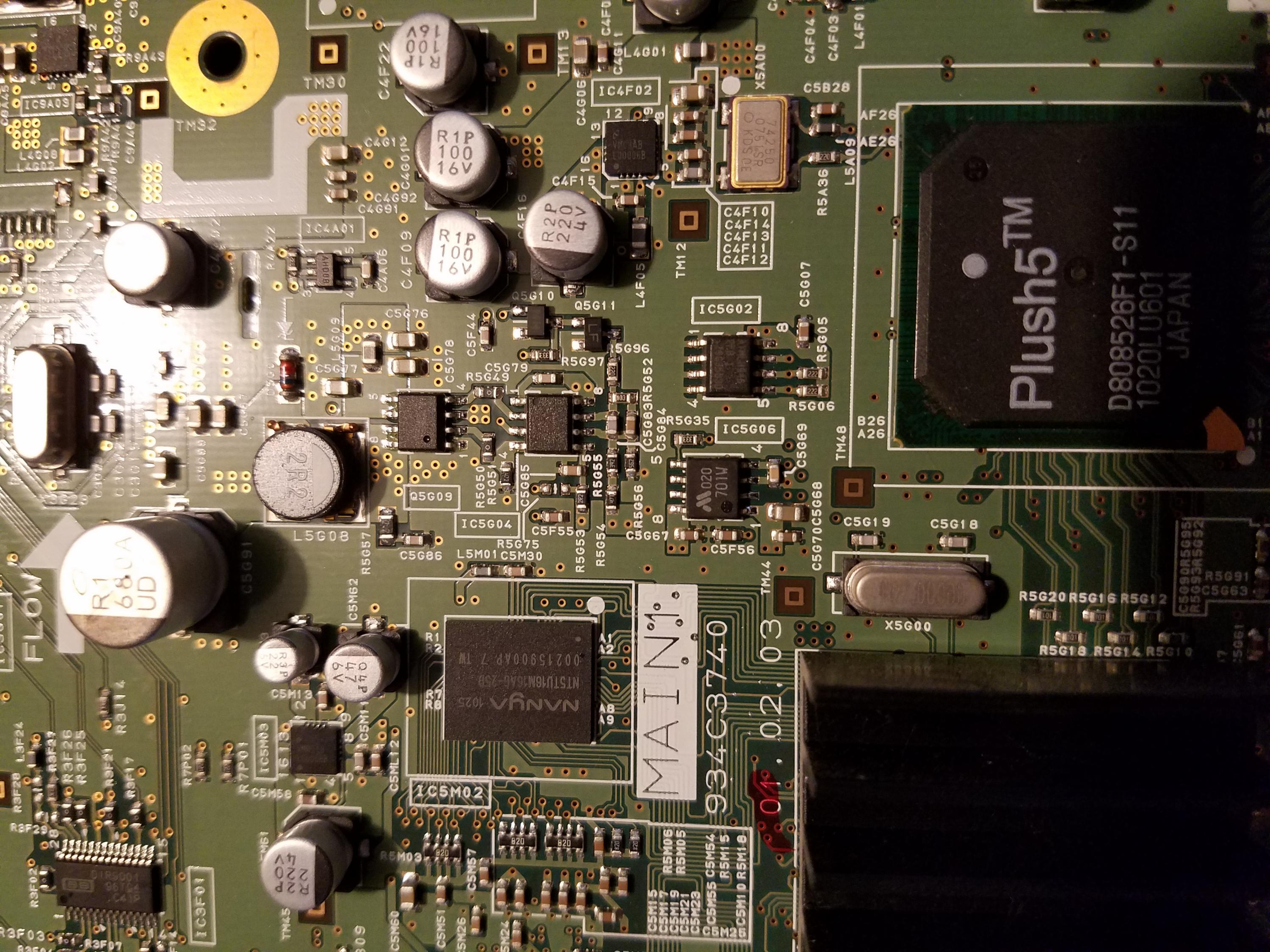

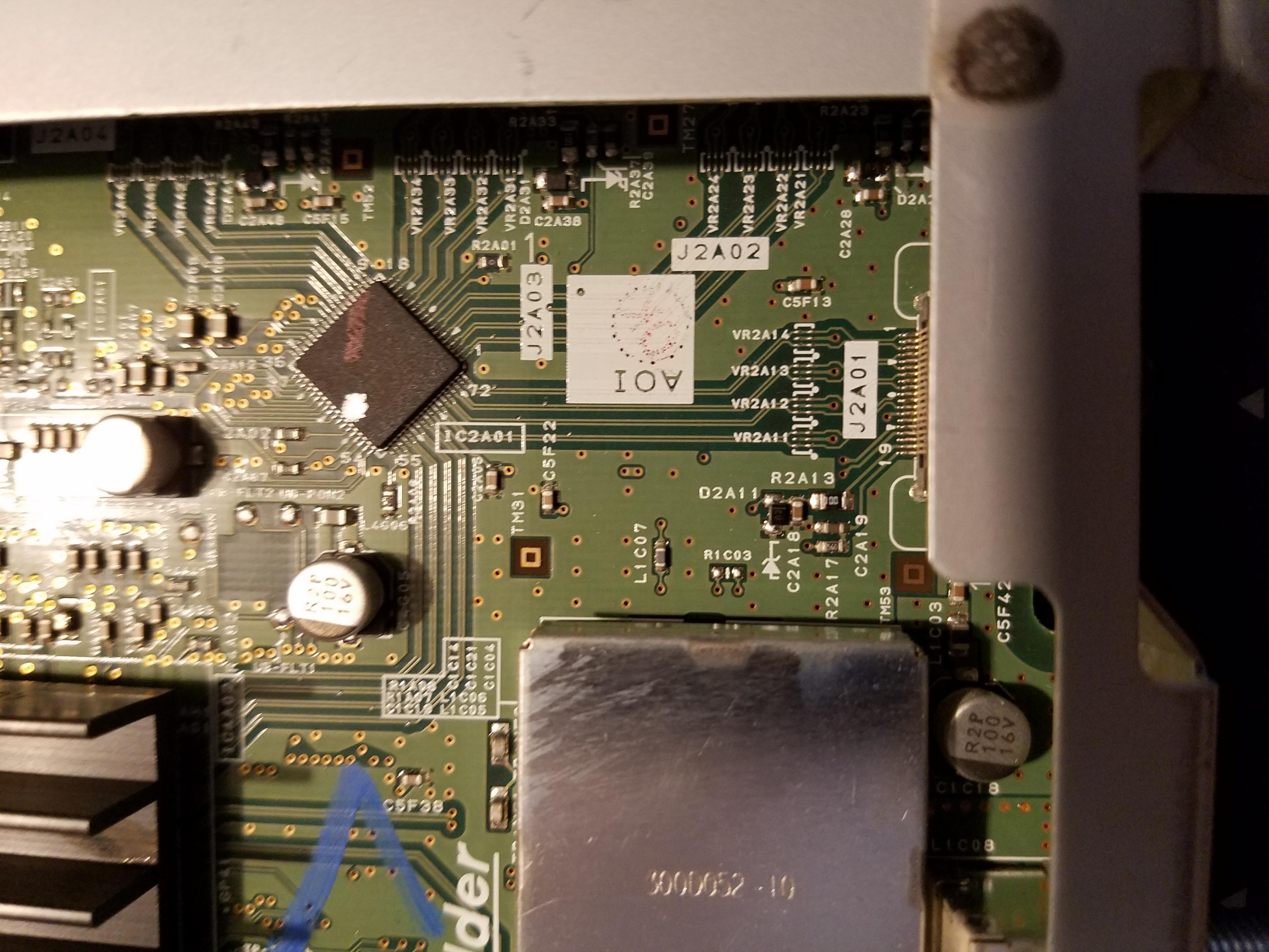

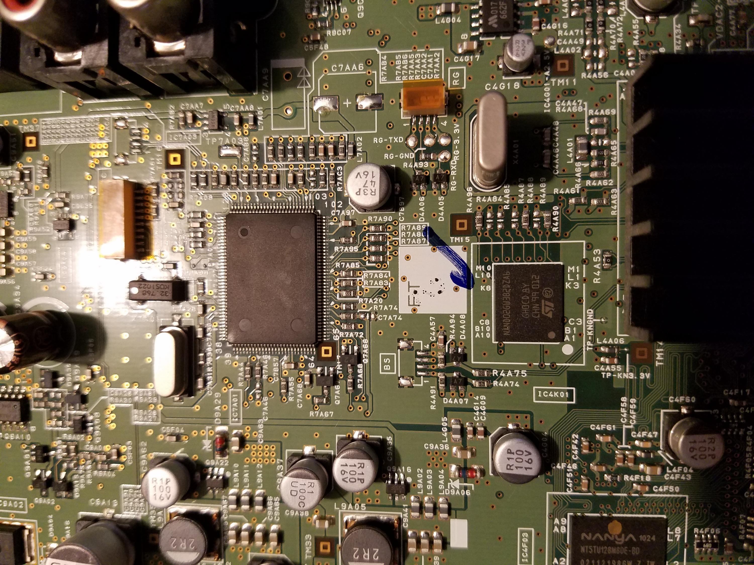

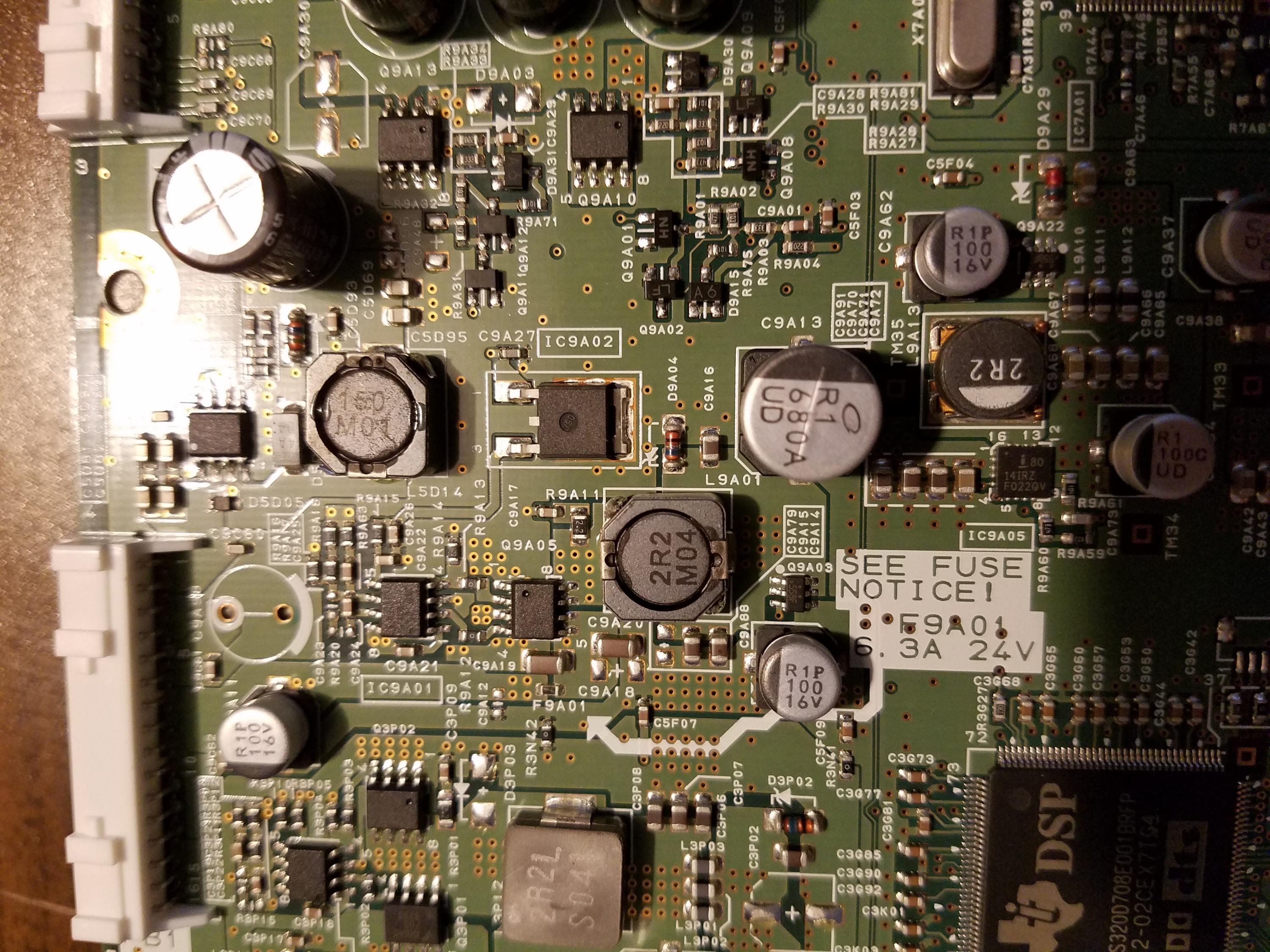

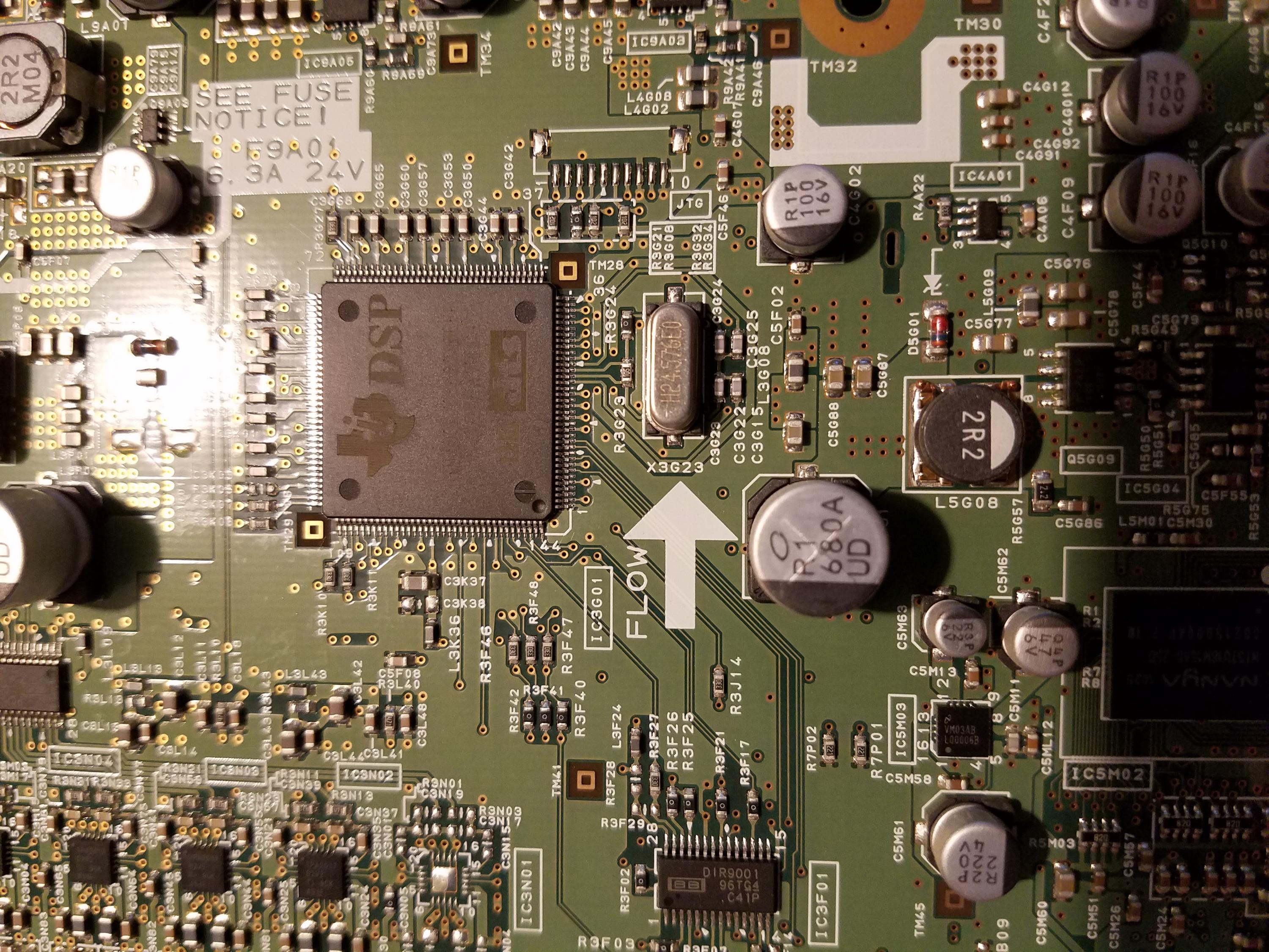

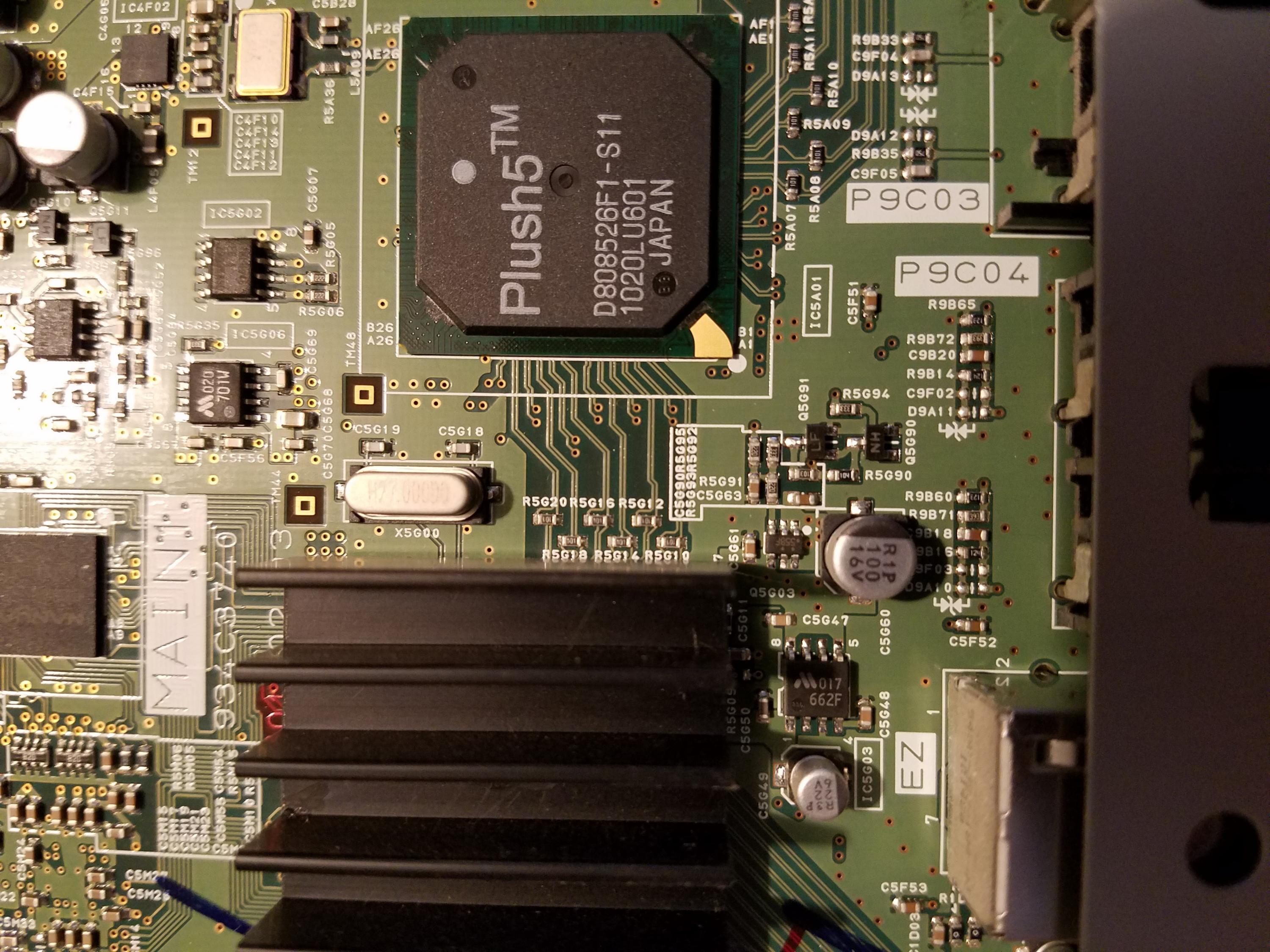

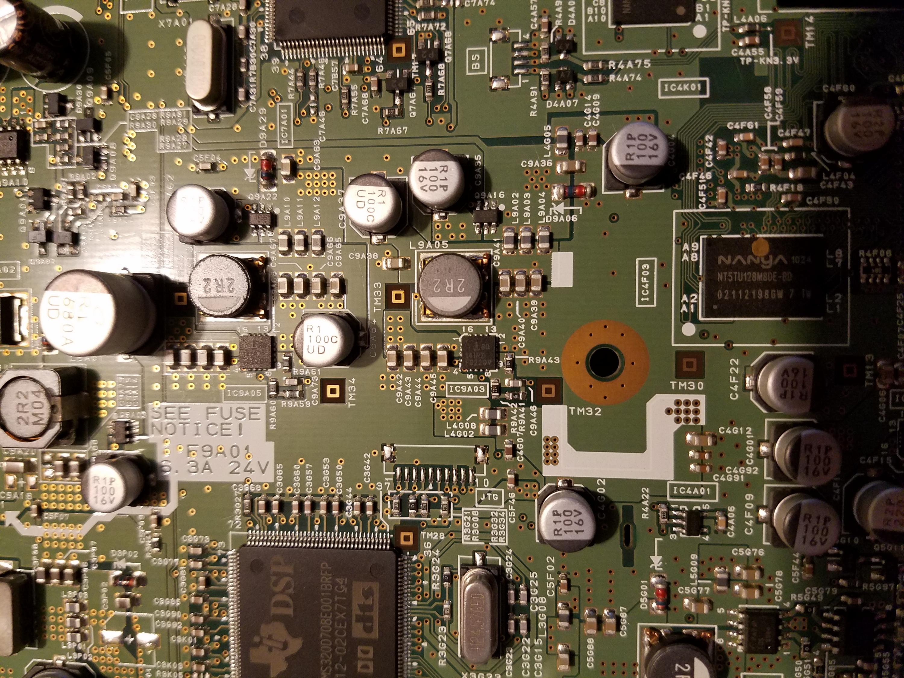

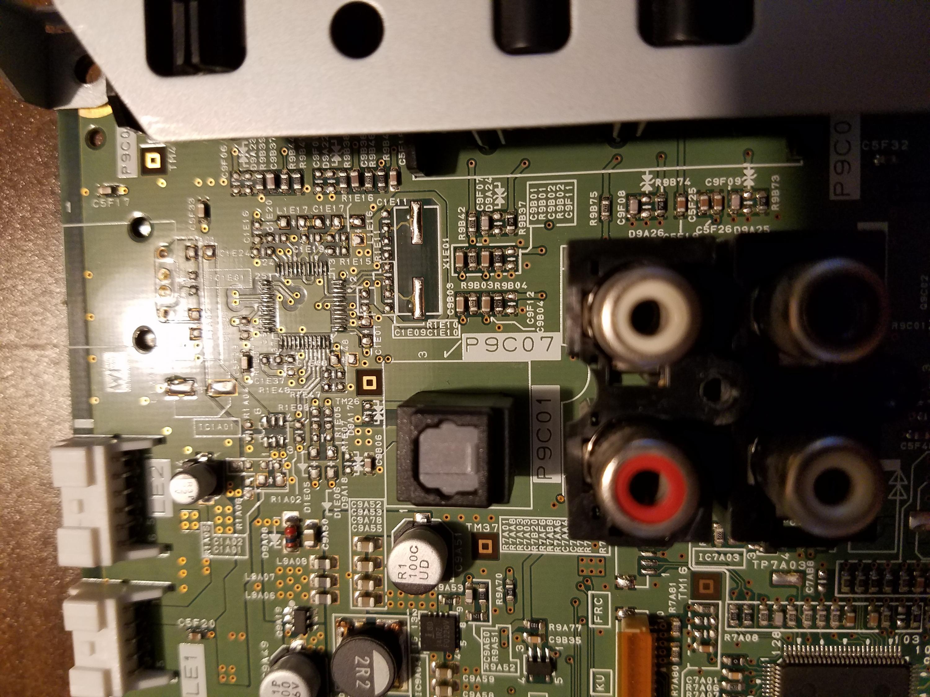

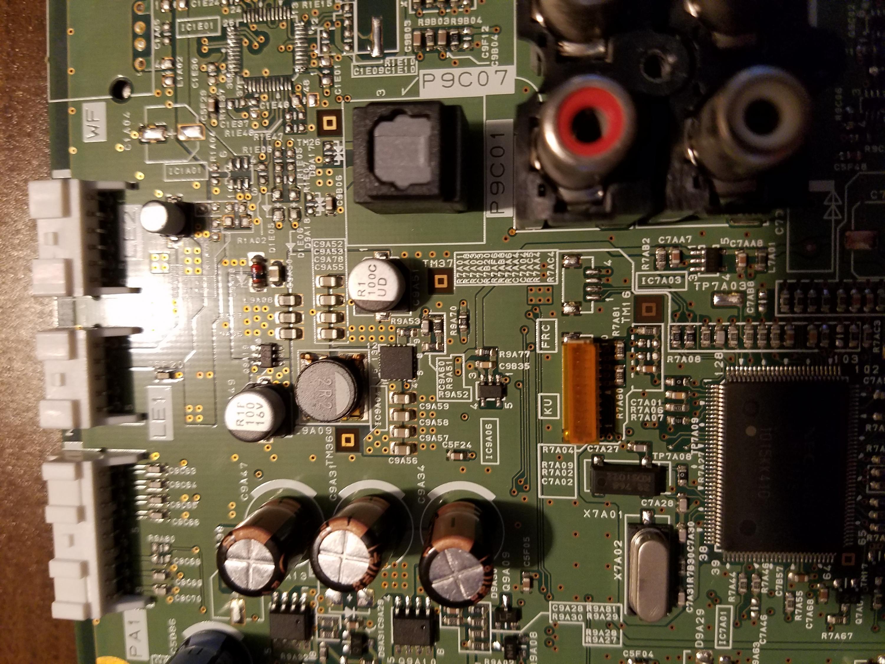

I have a Mitsubishi LT-55154 LCD TV that I recently acquired that will not properly boot and gives a constant blinking green status light. I have made many attempts to fix this problem to no real progress. I have replaced the power and filter boards. attempted to reset the TV by holding the power button for 8 seconds (this will cause a short amber flash then back to blinking green as if it is trying to restart). I have replaced 4 capacitors on the main board none of which appeared bad but it was worth a shot. I have made several attempts to reload new firmware through USB drive onto the TV with various combinations of power cycles and plugging/unplugging the drive also for extended periods of time >30 minutes. I tried to unplug various cables from the main board and power board to see if the error changed. The only result from this was when the cable at the top of the main board that was labeled PA1 was disconnected the status light gave me and error 48 indicated by 4 red flashes then 8 amber flashes, but otherwise no change there. I do have a digital multi-meter and understand a fair share on electronics just need some assistance as to what I should be looking into for troubleshooting this problem. Any advice or guidance would be greatly appreciated I hope with everyone's help I can get this TV functional once again. Thanks.

I have tested the power board and have found all the voltages that should be there I think. 24V, 12V, 5V, and 3.3V. I will look into the voltage regulators on the main board next. Thanks. Any other suggestions greatly appreciated I'm picking at straws here.Comment

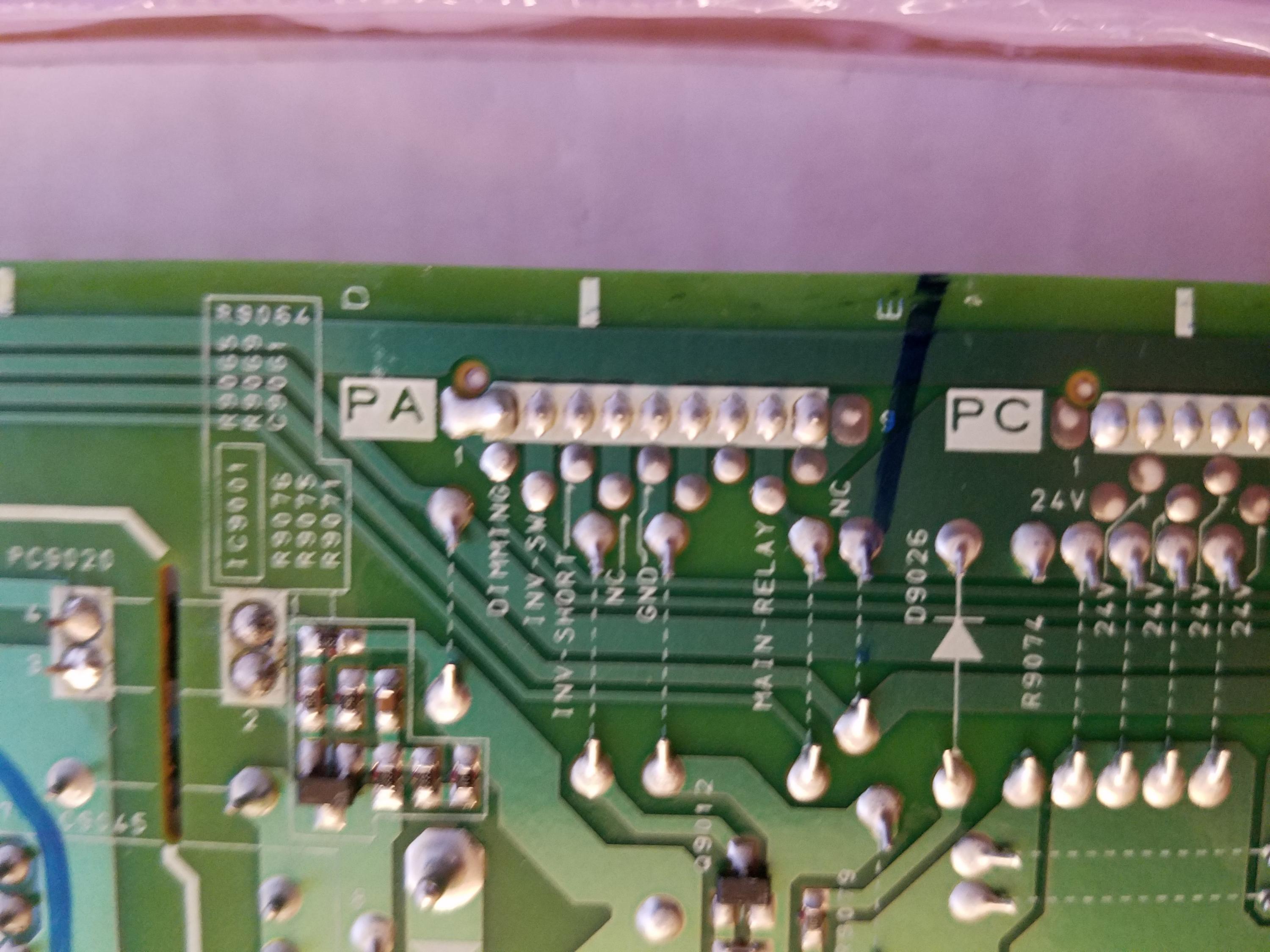

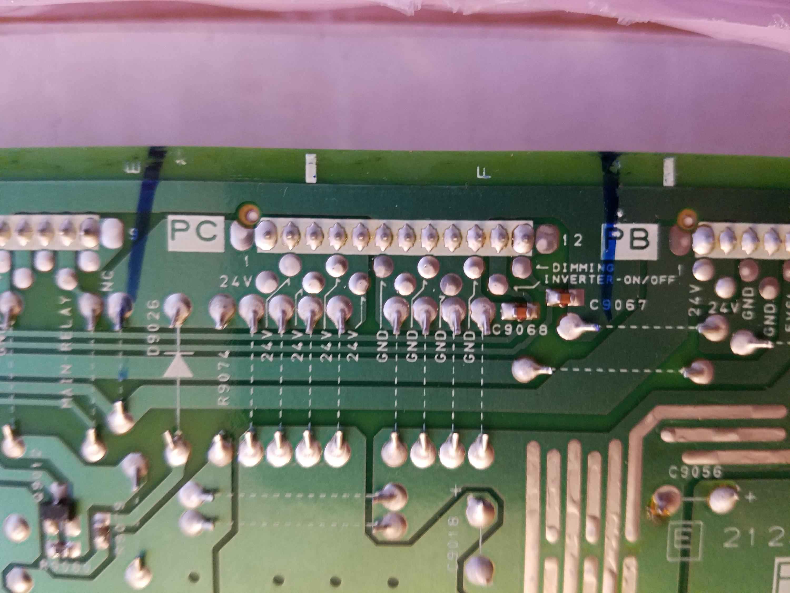

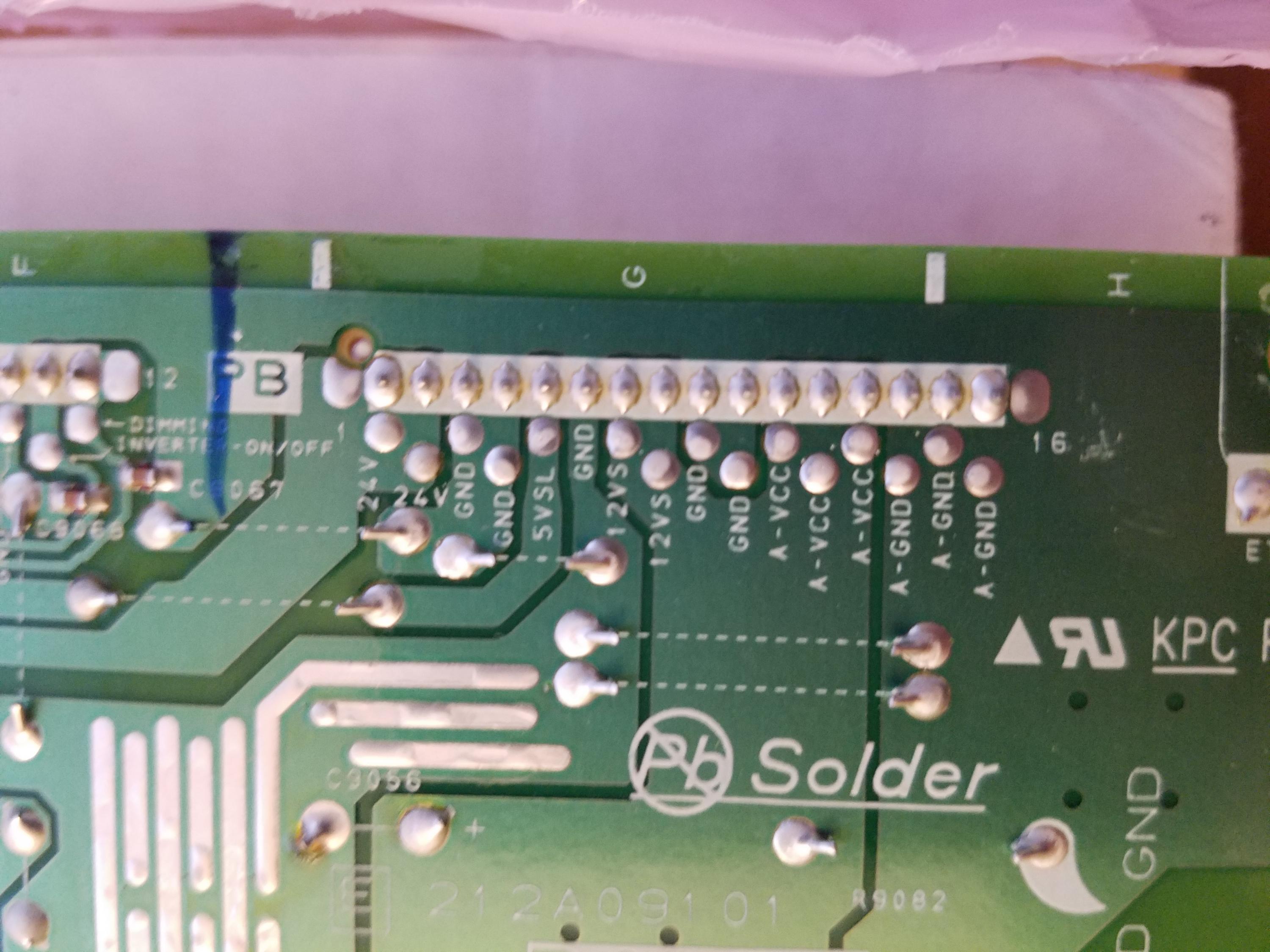

can you upload a picture of the writing by the connectors on the power supply so we can see what each pin does.Comment
Re: Mitsubishi LT-55154 Blinking Green Light?
Just tested the voltages on each pin with a multi-meter, here are the results
PA
(Pin 1-Pin 9)
0, 0, 0, 0, 0, 3.2, 0, 3.2, 3.2
PB
(Pin 1 - Pin 16)
24.4, 24.4, 0, 0, 5.0, 0, 11.8, 11.8, 0, 0, 11.8, 11.8, 11.8, 0, 0, 0
PC
(Pin 1 - Pin 12)
24.4, 24.4, 24.4, 24.4, 24.4, 0, 0, 0, 0, 0, 0, 0Comment

Not sure but I would think 11.8 would be sufficient but I could be wrong. The noise I am hearing is coming from the filter board, but I'm sure that could be caused by a power issue either on the main or PS. Also notice the repair services offered on ebay on the main. Just wish I knew exactly what they are replacing so I could order replacement parts and give that a shot. Wondering if it's an eeprom issue.Can't seem to find a repair kit but will keep searching.Comment

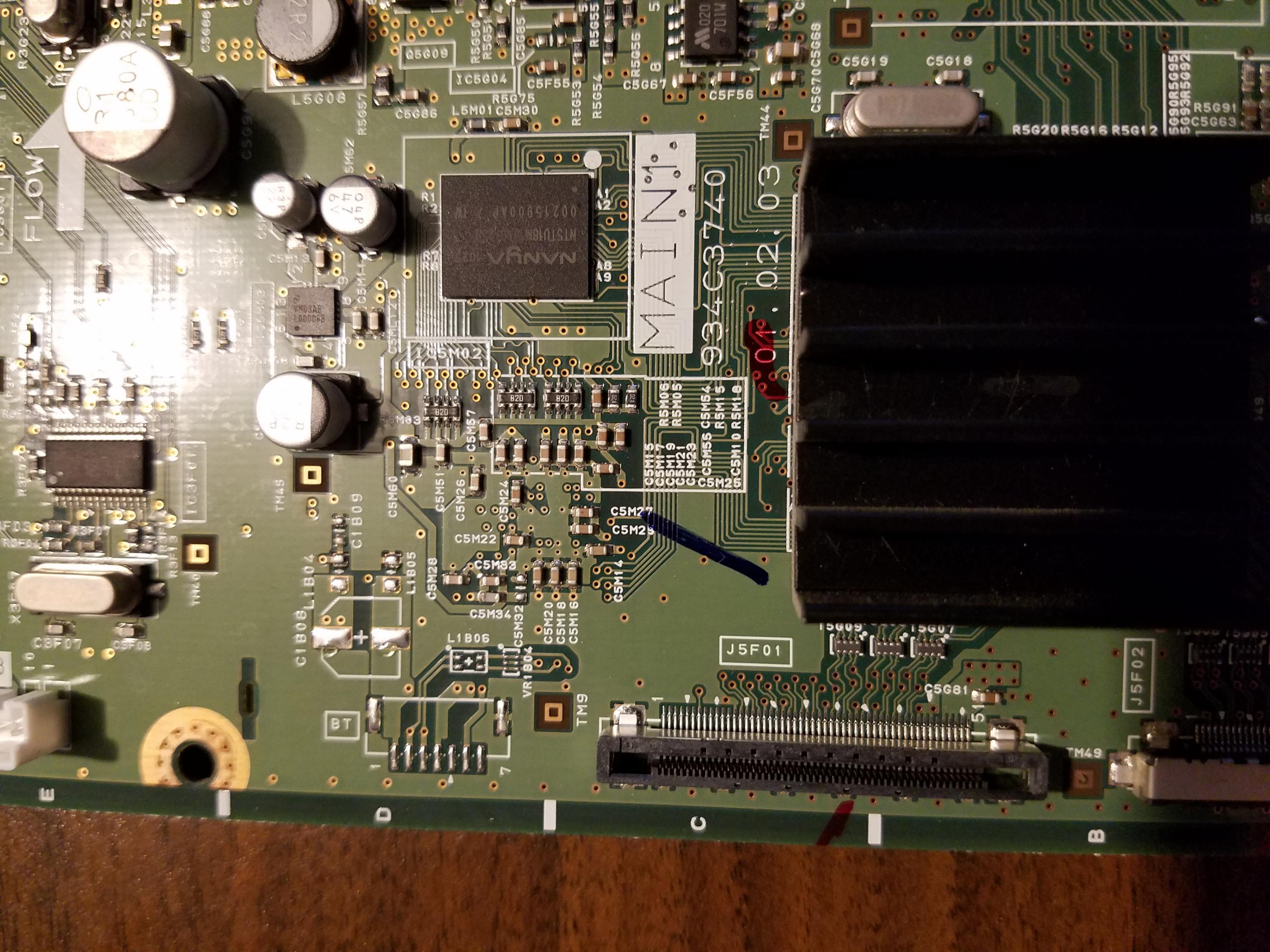

hi,i also have a Mitsubishi LT55164 with a fast blinking light.i traded a local tv repair guy a couple dlp-dmd chipsets for a pwb main, because before blinking light issue,my hdmi inputs were in-op.So i replaced pwb main and got a yellow 4 blink or 44?well it didn't work, tv didn't turn on,yes i plugged all in good.
because by part # has a sub part #of 01,02or03 mine was 02 to an 03. marked off with a marker(yours is 01) shop jimmy said this was the reason why the boards weren't compatiable,so i shoved board back in the box.Until now,
So i pulled out pwb main board.and wala tv booted up and hdmi works also.
thanx for mitsu service manual was helpful.i will send u my old pwb main if u want.
