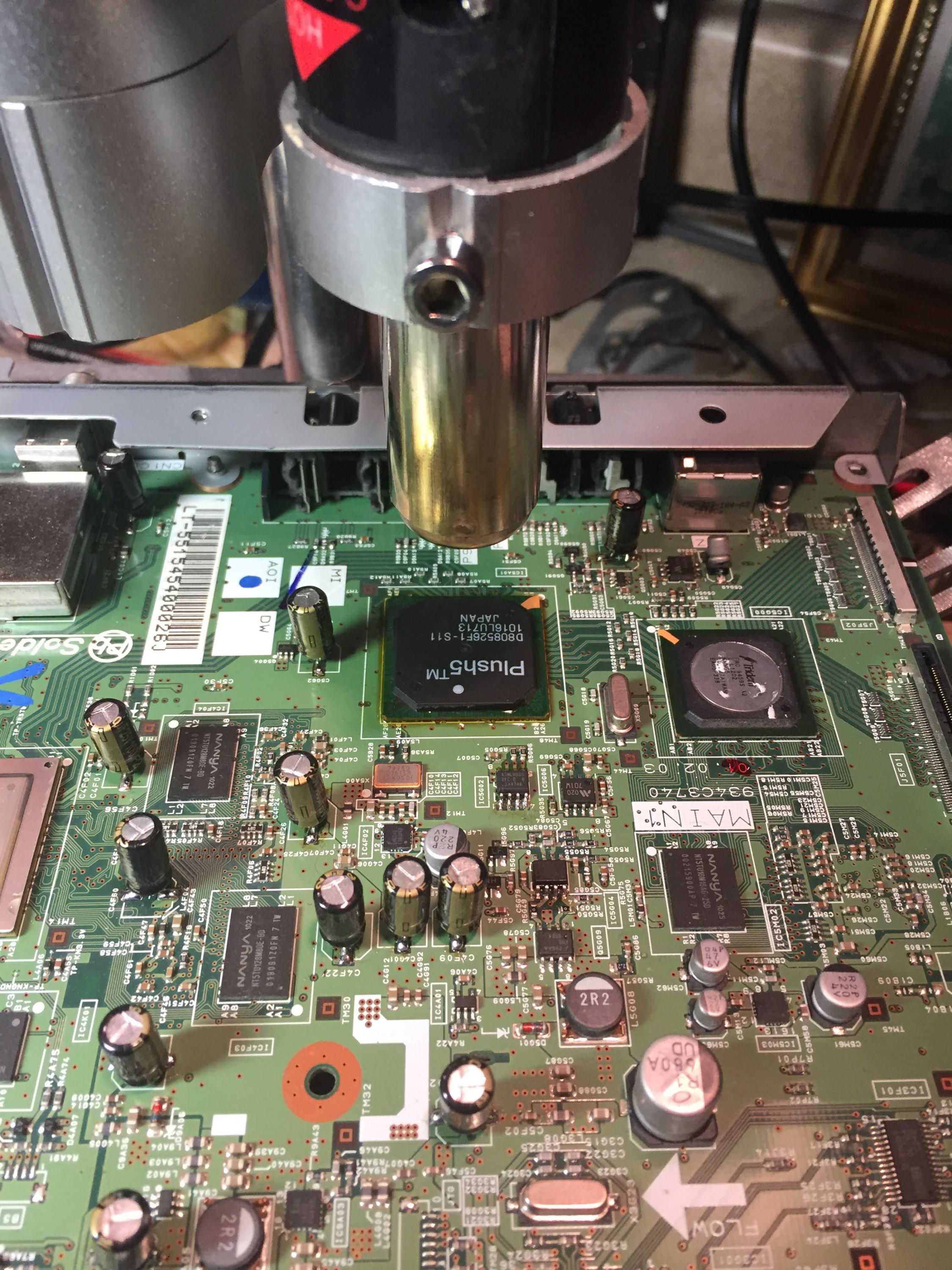

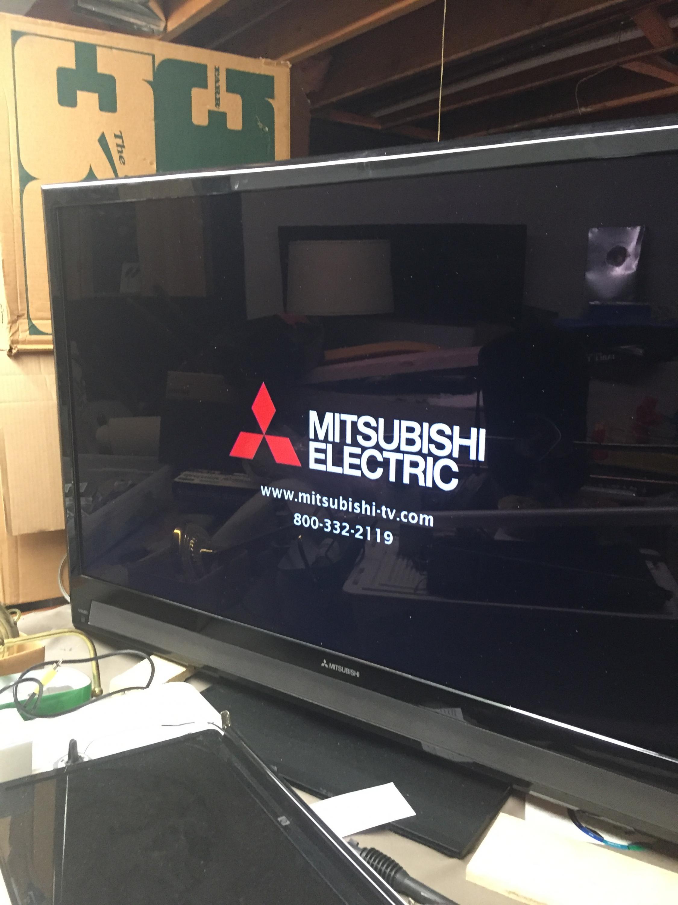

                                          #40
                                          Re: Mitsubishi LT-55154 Blinking Green Light?
                                          Finally Fixed my Mitsubishi LT-55154. The Failure was identified by Nyjetfan21
                                          so lets be sure to give credit where credit is do. I Reflowed the surface mounted GPU on the Mainboard. The suspect chips are under the heat sinks.
                                          The Rig I used was originally used to re-flow GPUs on Laptop Motherboards.
                                          Nyjetfan21 as well as I recommend that the Heat Sinks be Cemented to the
                                          Main Board to avoid the GPU Heat and Heat Sink Weight dragging the GPU off the board when it heats up. Also Active cooling of GPU was recommended.
