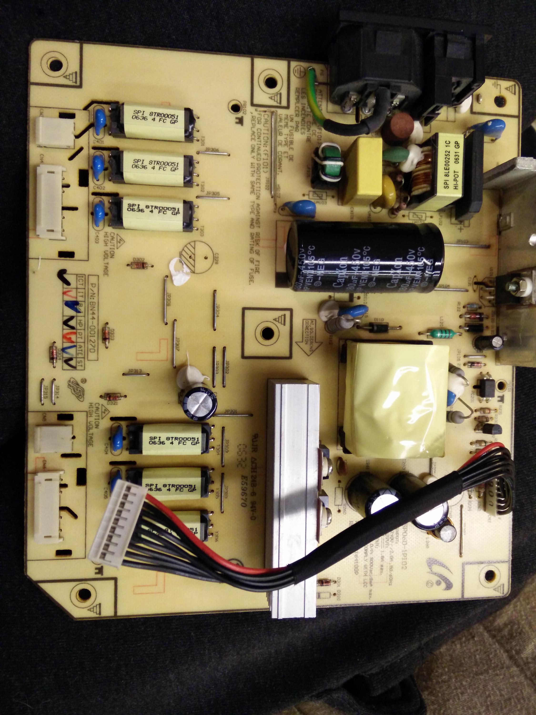

    Pin out help with ccfl inverter.

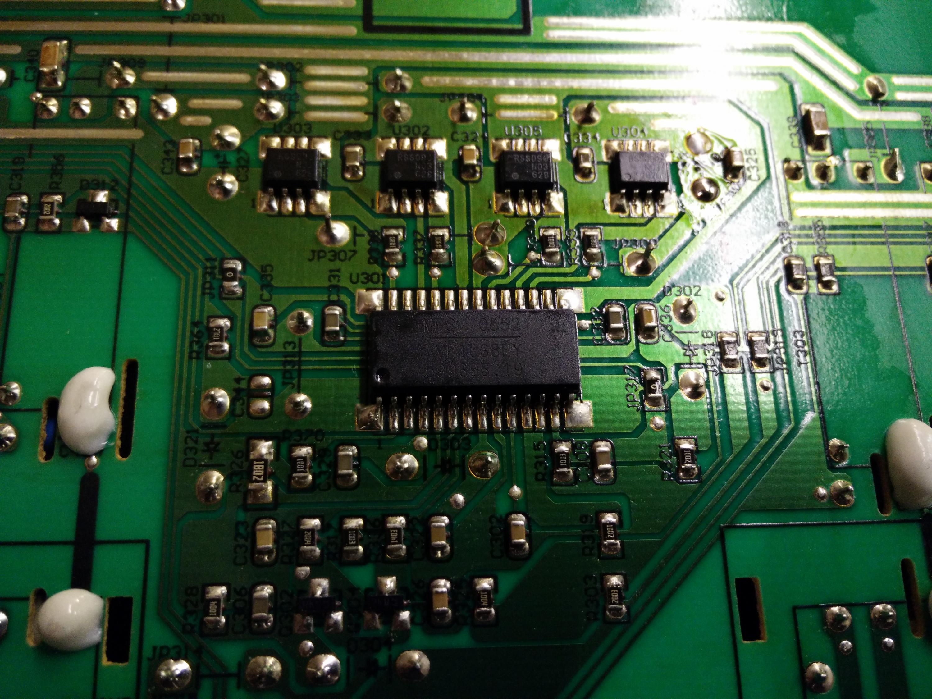

    I have a Samsung ccfl inverter that I'm trying to power on without the main board. The ic controller number is Mp1038ey and the motherboard serial number is BN44-00127D. I'VE been trying to figure this out for about 5 months so help would be very much appreciated!

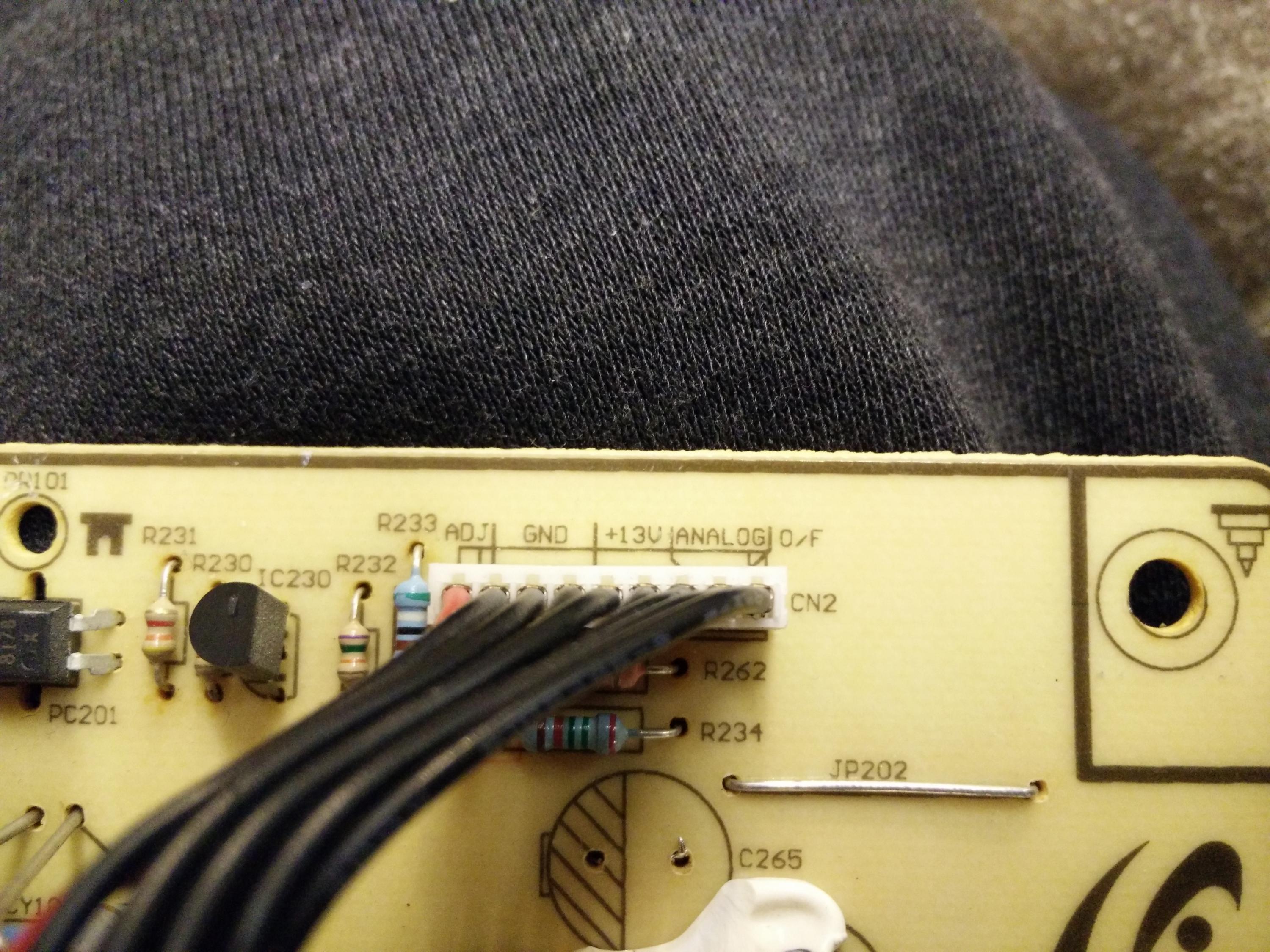

    Can we see the bottom side of the connector?
    It looks like:
    ADJ = DIM ADJUST
    O/F = BL-ON.
