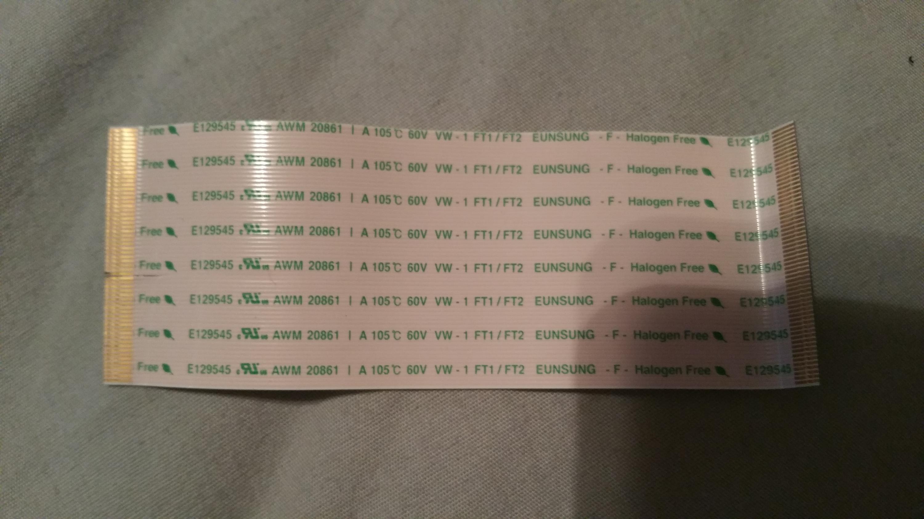

    Does anyone know where I can buy replacement ribbon cable? It's about 3.25" x 1.25" and on the back it reads E129545 AWM 20861 I A 105C 60V VW - 1FT1/FT2 Eunsung - F - Halogen Free." I've attached a picture if that helps.

      Re: LG 47" Ribbon Cable...
      Thanks! I saw that one, was trying to find it domestic (US), but I think I'll have to pull the trigger on that one if I can't find it in the US.
      Does the length of the cable matter? Or just the pins?
      Thanks in advance, you guys are great!
        Just the pins, and the width. The length does not matter
          Does anyone know of dealers in US that would carry this? I'm desperately trying to get this fixed by Christmas for a family member.
          The cable seemed to have worked loose after transporting the TV in my car. This resulted in thin, evenly spaced, horizontal lines across the screen. Tinkering with this ribbon cable seemed to make the lines go away, until it cracked in the middle. I'm really hoping this is a fix, instead of the panel. There were no issues with the TV before transporting so I'm doubting it's the panel or anything other than a loose cable.
