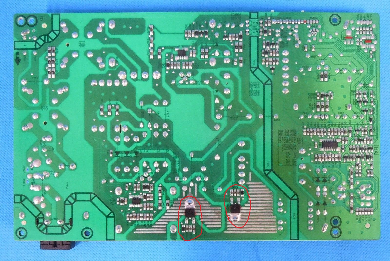

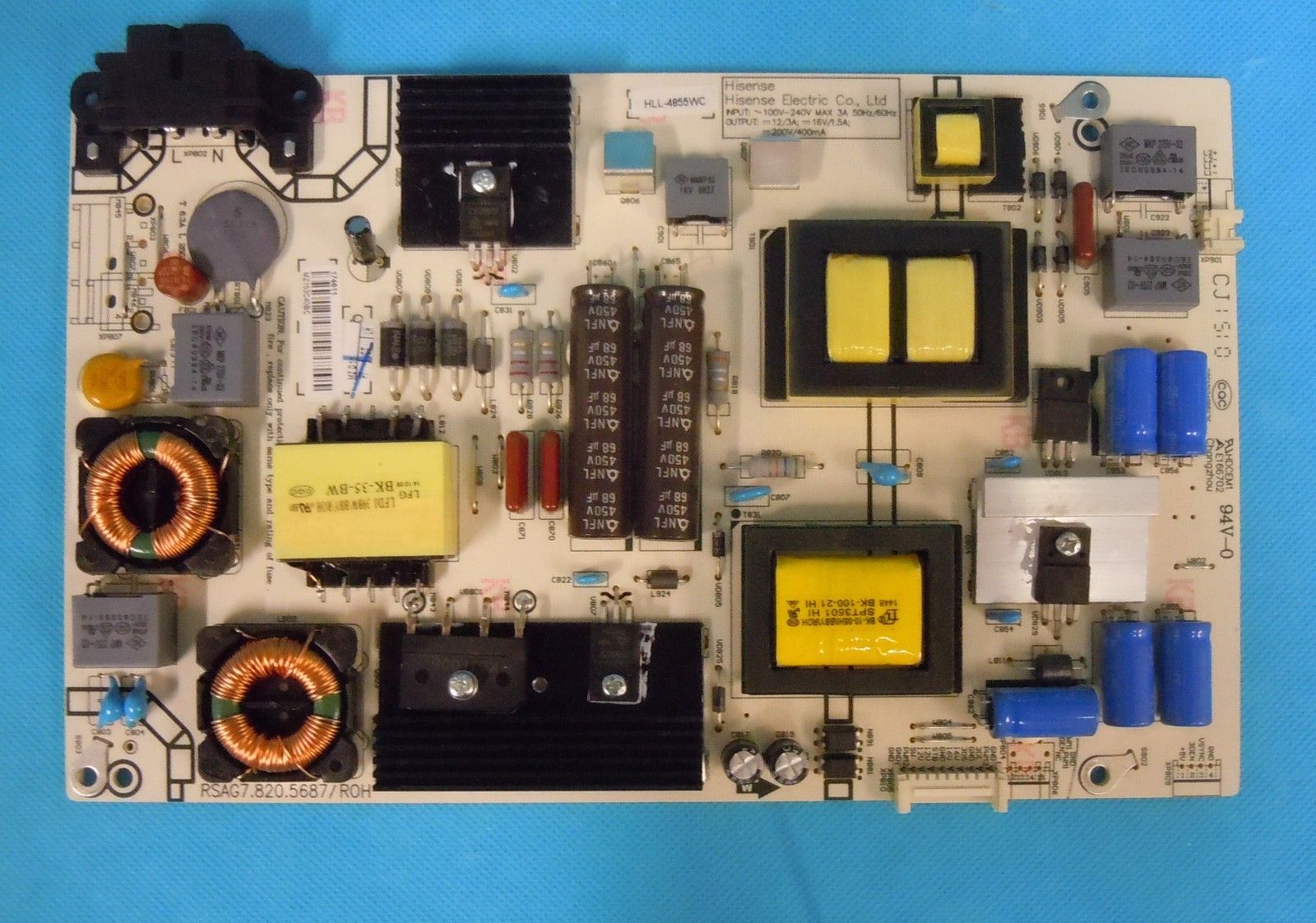

    So I was given a used Insignia TV that had stopped turning on (see attatched picture, Model# NS-48D42NA16). Specifically, when plugged in, the standby light would turn on, then blink red (from what I've gathered, this signifies an error in the powering on process). I took the back off of the TV, and inspected the power board. I checked to see if any capacitors were bulging first, because I've heard that's one of the most common causes of a power board failure, they all looked fine to the naked eye. I did however, find 2 components on the back of the board that appeared to be "fried" (they looked burnt, and one actually had a chunk blown off of it, exposing metal underneath). I later found these to be black square transistors soldered to small heatsinks (I looked up the part# on them. see attatched picture). Some of the small black square components next to them appeared "fried" as well (I think these are small resistors?). I did not think I could successfully replace the transistors, so I simply purchased a new power board (or rather, a used one from a reputable dealer on ebay)
    This is where things went off the rails. $40 and 2 weeks later I had my new power board, which appeared in excellent condition, and installed it. I reassembled the TV, and plugged it in. It immediately came on, defaulted to HDMI 2, and displayed the "no signal" message. Everything worked great... for about 25 seconds. I then leaned the TV ever so slightly against the wall so that I could find the HDMI cable to plug it in, and IMMEDIATELY there was a loud "POP" and the screen went black again.
    I unplugged the TV, plugged it up again, and lo and behold, that same flashing red light. I took the board back out, and wouldn't you know it, the same transistors on the NEW board look fried!

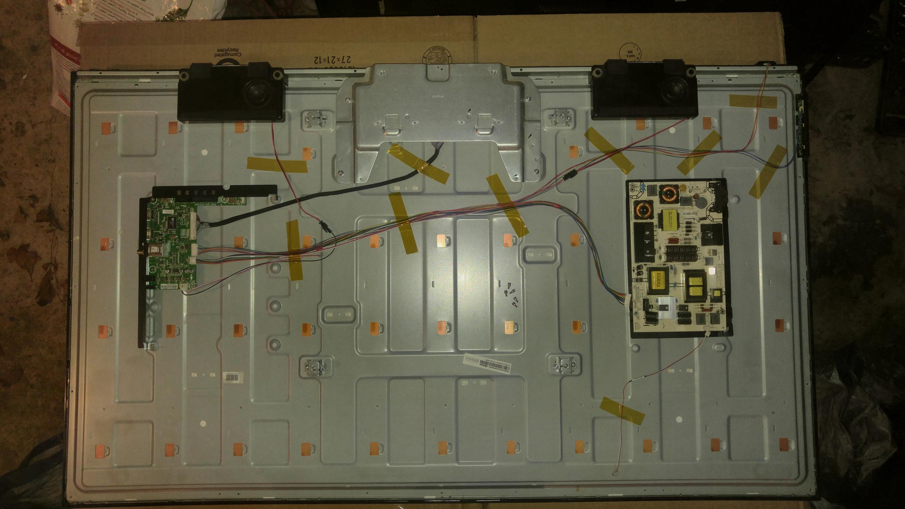

    Last edited by Reepor; 12-10-2016, 08:50 PM. Reason: Edited to include picture of the back of the TV
    Re: Insignia TV fried my NEW power board. PLEASE HELP.
    Can we see the whole back side of the TV showing all the boards?
      Done and done!
          He asked if I could upload a picture of the whole back of the TV, so I edited the post to include one. Sorry, I should have been more clear.
                Where are the fried components?
                The circled one are not fried ,just black as they should be
                    SMD resistors at the feet of those MOSFETs are fried. how can I check the backlight driver?
