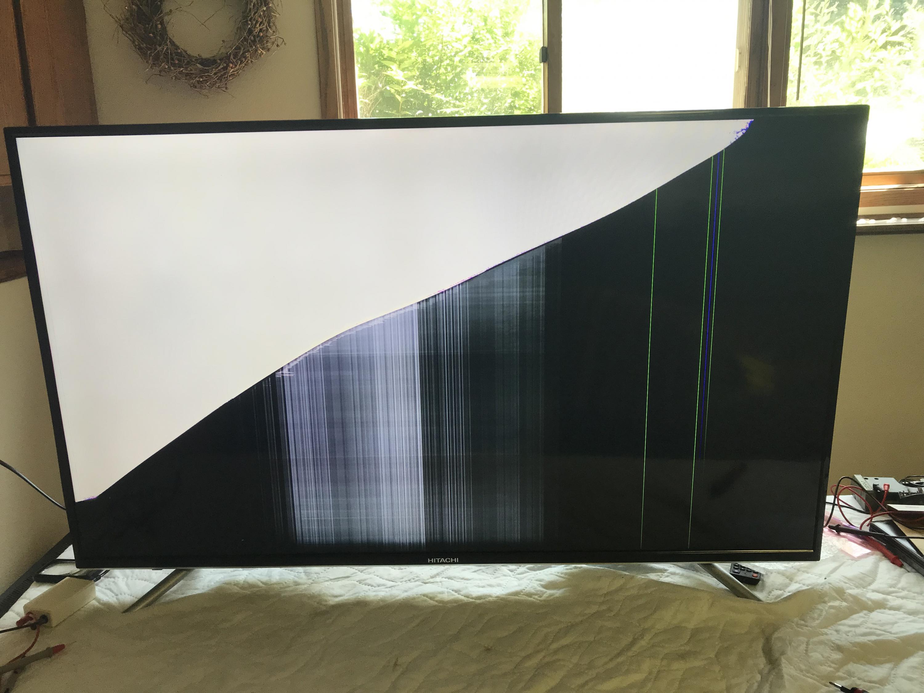

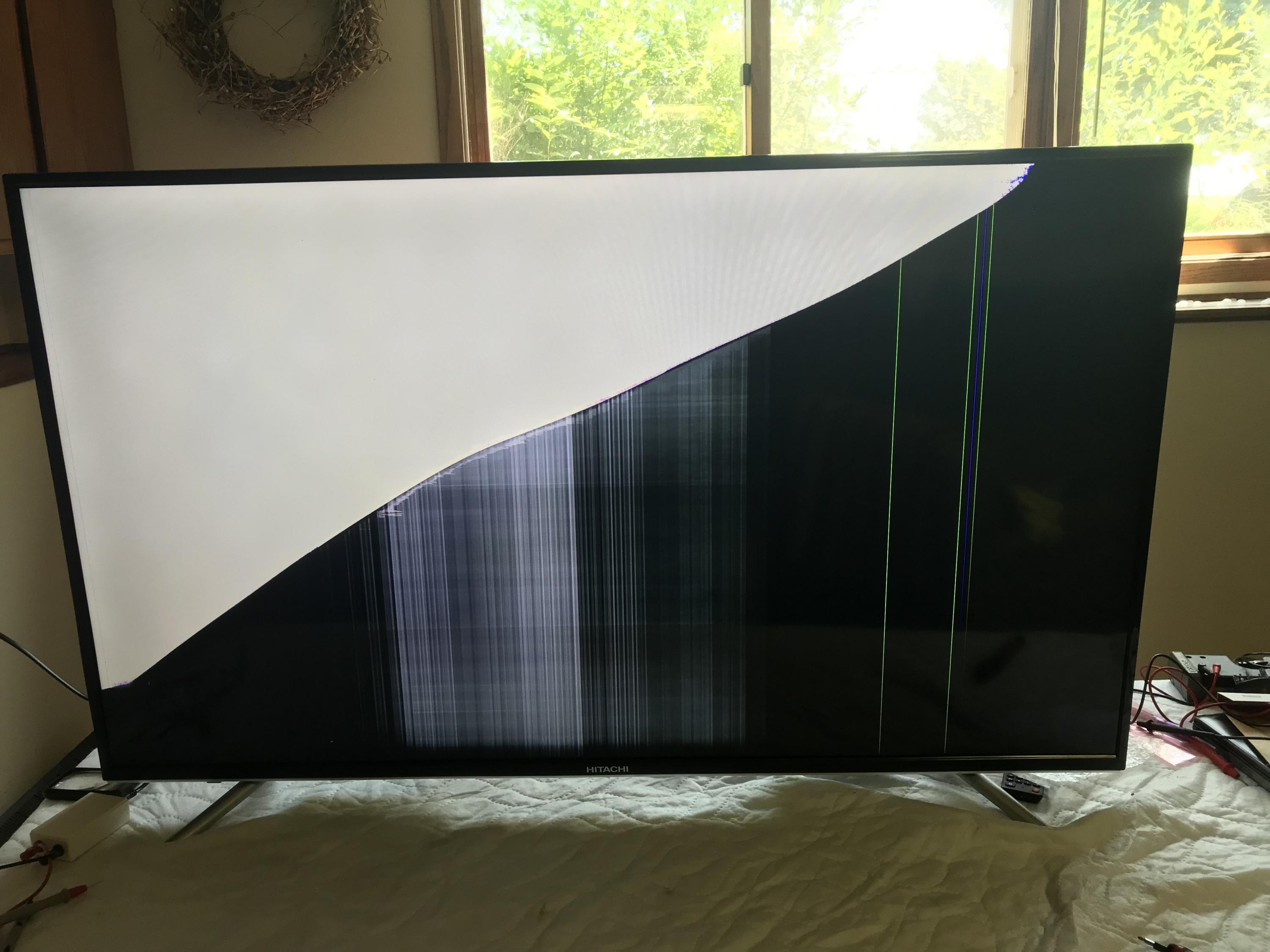

                  #68
                  Re: Hitachi LE55A6R9A - No backlight
                  One of the connectors on the red/black string didn't seat correctly. Now I have all backlights on.CN202 has 202vdc on red and 101vdc on white.CN203 has 101 on the red and 0 on the black. I was very careful removing the screen both times and used suction cups but now I think my screen is screwed. I have all the correct voltages from the PS to the main board and have swapped out PS, main and Tcon and get a display that is whacked. See .jpg. Is this a whacked screen?
                  • diif
                    • Feb 2014
                    • 6978
                    • England
                    #69
                    Sadly, yes, a damaged panel. You can see blue, top right where the black and white meet the edge.
