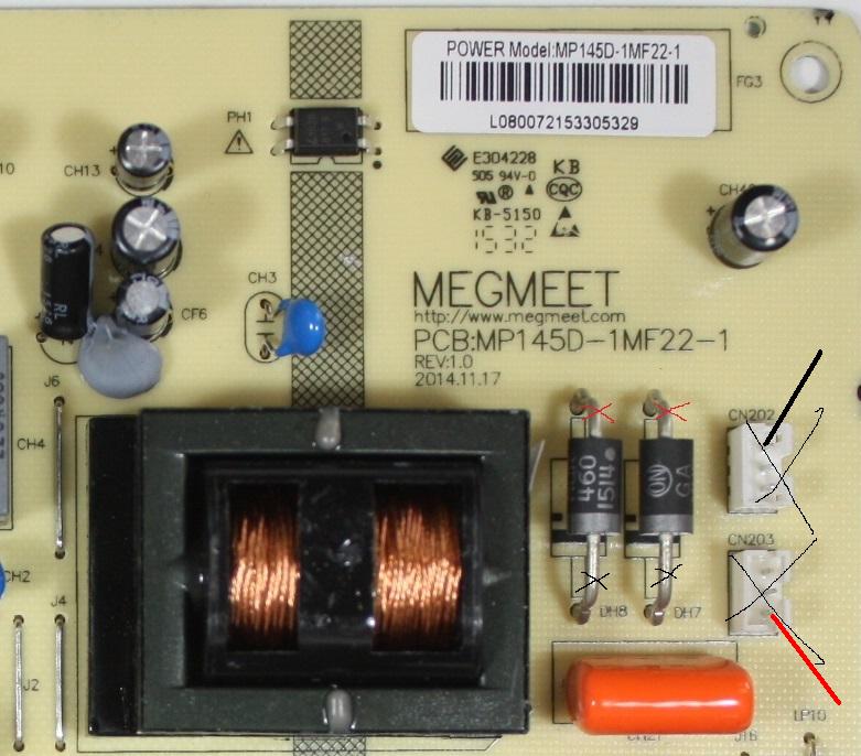

    So this 55" Hitachi 1080p TV, LE55A6R9A came into my possession. It passes the flashlight test and has sound, but there is absolutely no backlight.
    I open it up far enough to get to the power supply board. ( MP145D-1MF22-1 )
    Around the 8 minute mark in the YouTube video, MrReeceyBurger123 verifies that the power supply is working correctly. Now, I can't absolutely rule out that I'm somehow doing something stupid with the multi-meter, but I get absolutely no reading on any of the lines from CN202 or CN203, which it seems plainly obvious are supposed to carry power to the LEDs.
    I plug in the TV, hit power so that the light goes blue, ground the black probe on the metal part of the TV case and jam the red probe down into the "socket" until it must be touching the metal sheath in the plastic plug. I also attempted to touch it to the solder points on the underside of the PCB and that gives me nothing either. I'm getting NOTHING on CN202/CN203!
    Can I go ahead and order a new power board from eBay, or is this inconclusive?

    If you are SURE there in no voltage at those output pins then it would be a power supply fault. If you look at the printed tracks you should be able to see how the circuit is connected and confirm exactly just what the configuration of those output pins are. Sometimes it a series type configuration, sometimes a parallel configuration. It is a very basic circuit at the LED output driver by looks of things. Check those rectifier diodes.
    If you find you have volts then you probably have a failed LED in the string in the panel. USUALLY that means a write-off unless you have the skills to open up the panel and replace an LED.

              You should be able to measure voltage accross these two points, I would leave the leads to the led's connected if you can, the two sets of wires going to the led's in the panel are connected in series.
              I can't tell from the pictures but the led voltage may be isolated from the chassis ground so when you have the ground, (black) probe on the chassis you may not measure the led voltage, but by putting the meter accros the leads going to the panel led's you should get a reading.
              maybe give a larger view of this area

                This is precisely what I was about to report. As far as I can tell, I'm not getting any voltage in that area.
                With it grounded on the case, these were the results. The red marks were reading over 1000 volts, the black marks were reading nothing at all. This is with the TV plugged in and the power button pressed to take it from red light to blue light. Despite the illustration, I was doing this with the wires all plugged in! Just to be clear.
                I'm testing the LED leads by jamming the red probe deep into it and feeling it scrape against the metal in there. That should work, right?
                And sorry for newbing the place up! I promise I catch on quick
                EDIT: When you say across these points, do you mean use the black probe and the red probe on both ends instead of simply grounding the black probe? I can try that.

                      If he measured high voltage on the anode of the diodes, that could be correct as the spikes could be quite high and at a high frequency the meter may give a false reading.
                      Thats why I say to measure the dc voltage accross the two points I indicated

                          You would need to connect the probes where I indicated and then turn on the tv, Its a good chance that if there is no load (ie: open led circuit) the power supply for the led's will shut down. so the voltage may only be there for a couple seconds

                              You need to find out if your meter is good and working or not first, wrong data will not help troubleshooting the problem.
                              If the meter is good then we need to find out if the LED driver circuit is getting the BL-ON signal to turn on that power section on or not and go from there.
                              Hitachi 850118727 Power Supply
                              http://www.shopjimmy.com/hitachi-850...wer-supply.htm
                              BTW, your meter does not have that high of the frequency bandwidth to measure high frequency AC Voltage.

                                  It could be a bad power supply but it could also be an open led in the panel. I have seen more problems with bad panel led's but you would need to check them, they make a small led tester for that purpose.
                                  Thats about all I can do from this far away.
