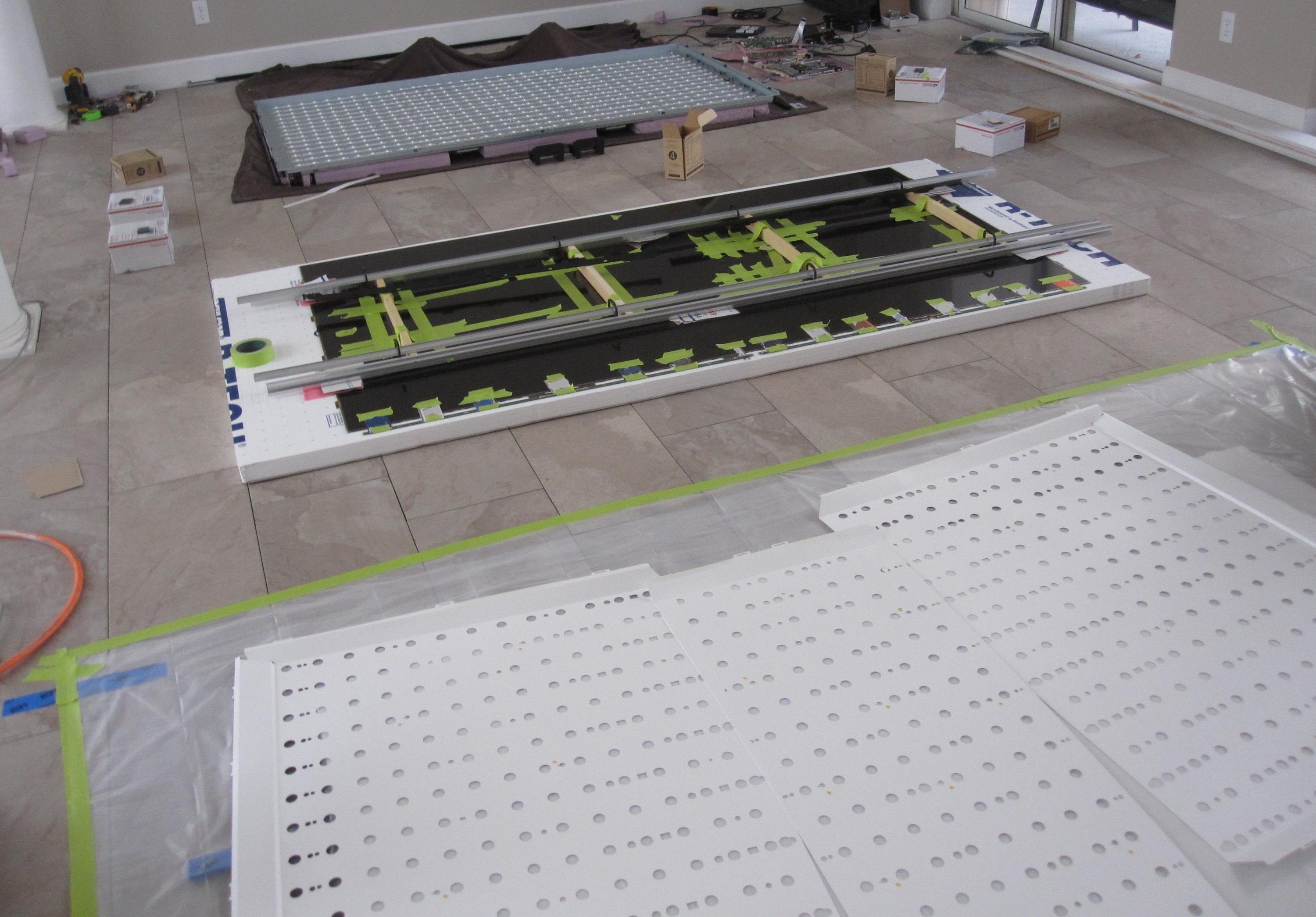

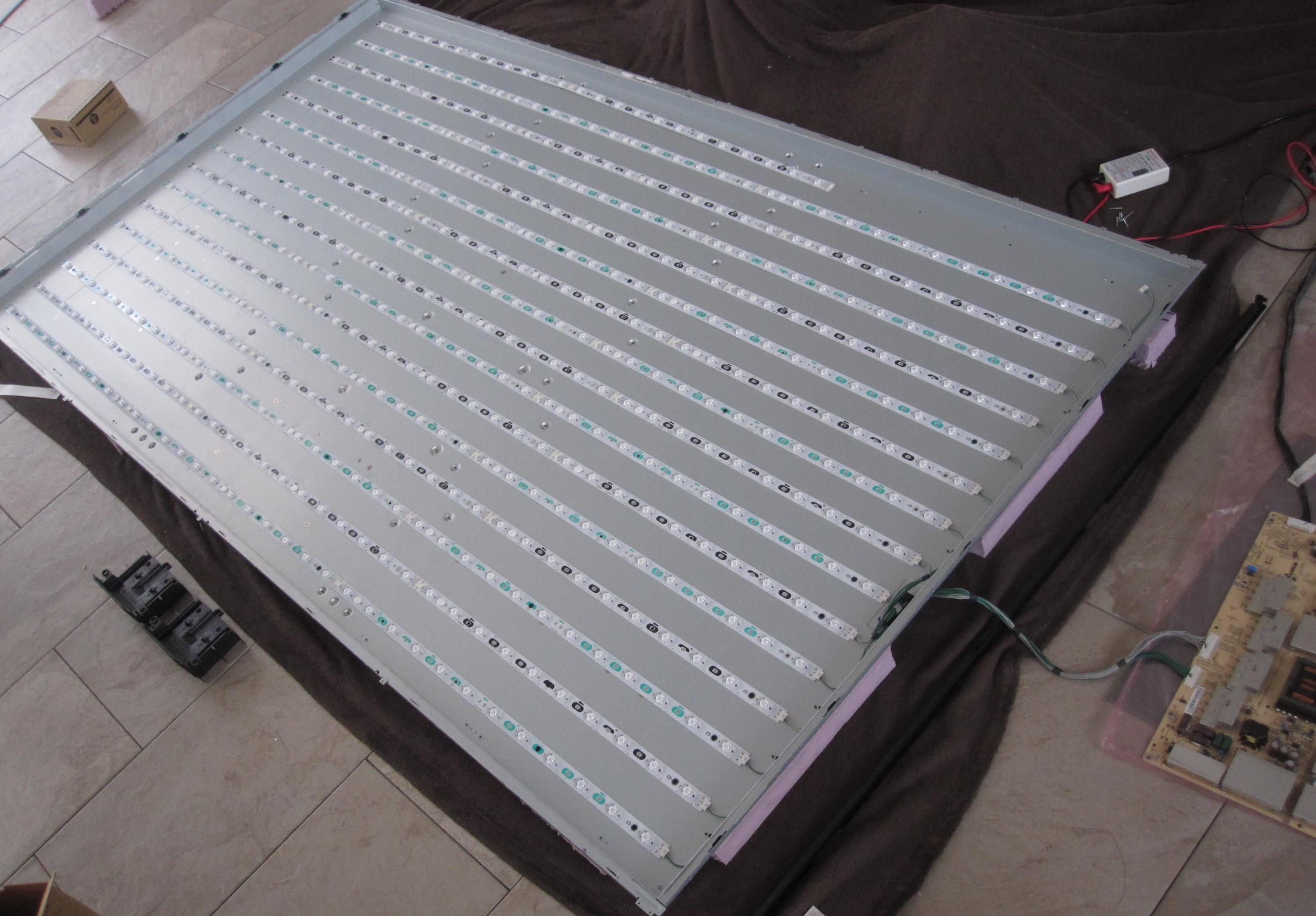

    Does anyone have any general advice for removing a large 90" lcd panel to get at the led strips? One of freakaftr8 posts suggests that he started with the panel face up. Can this be done with the panel evenly supported and facing down and just removing the LED housing while leaving the lcd/diffusers/frame all in place?

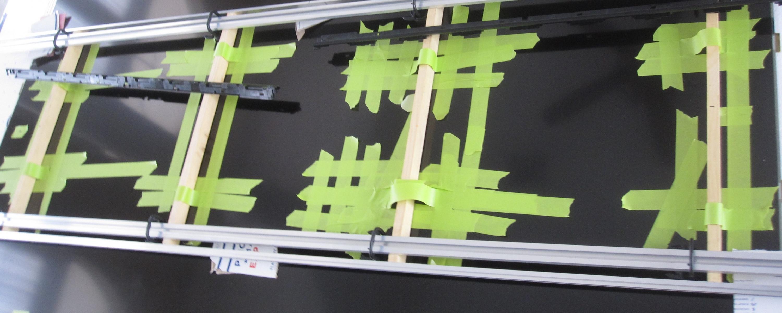

                    Well yesterday I managed to get the LCD panel removed. After disassembling the unit, I determined that the "face down" method would not work as the unit was too heavy to be supported by the black plastic frame which centers/supports the LCD.
                    A suction cup jig was created as in the photo using some cheap HFT suction cups attached to some 1in aluminum slatwall extrusions and 1/2 lumber. The masking tape hooks were just used as a backup in the event one of the suction cups came loose. The screen did not flex as much as I originally thought. The measurements of the panel are 80"x46". Haven't got it back together yet, but it appears the culprit was a cold solder joint on one of the LEDs on the first/top row of LEDs.
