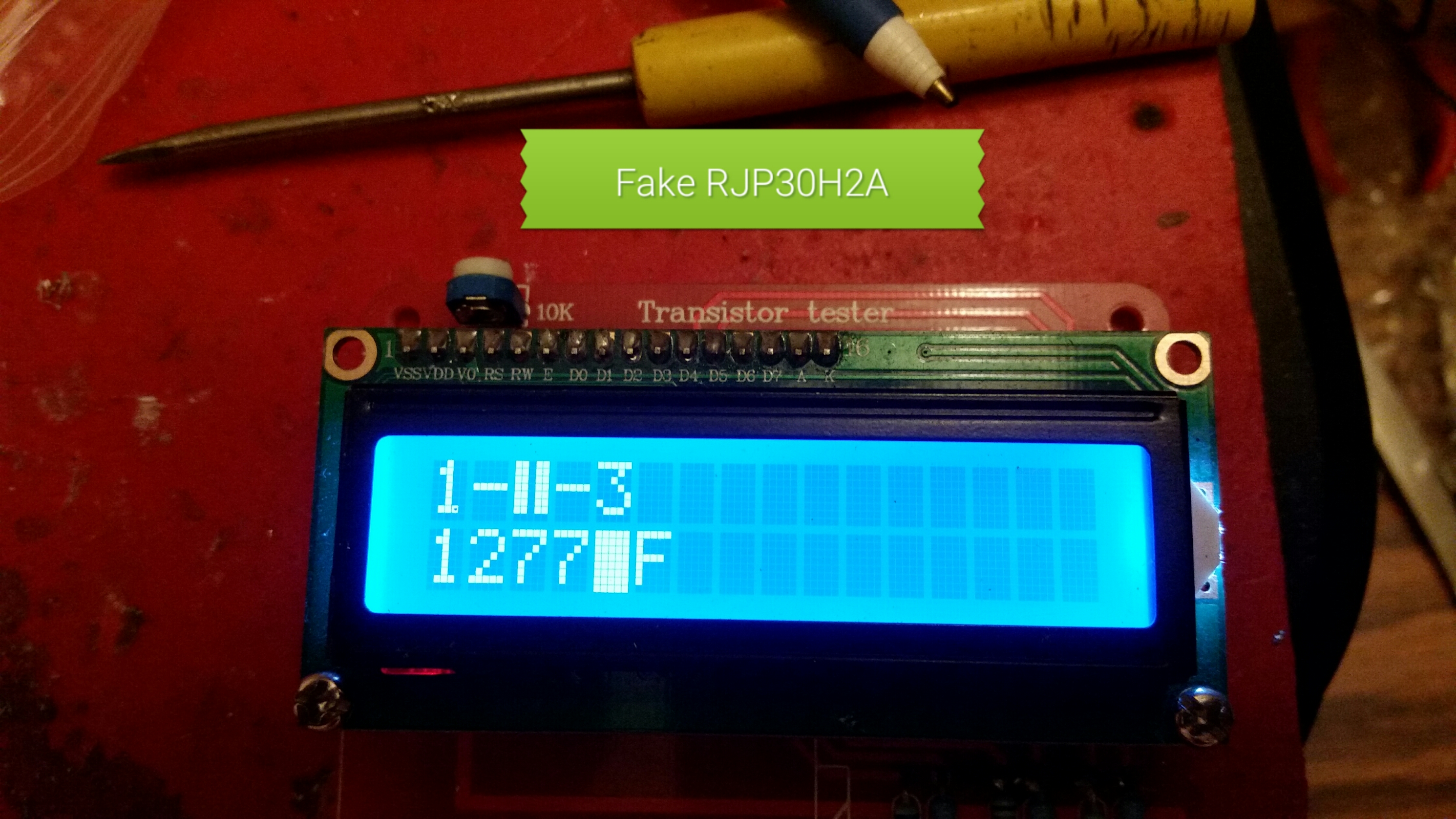

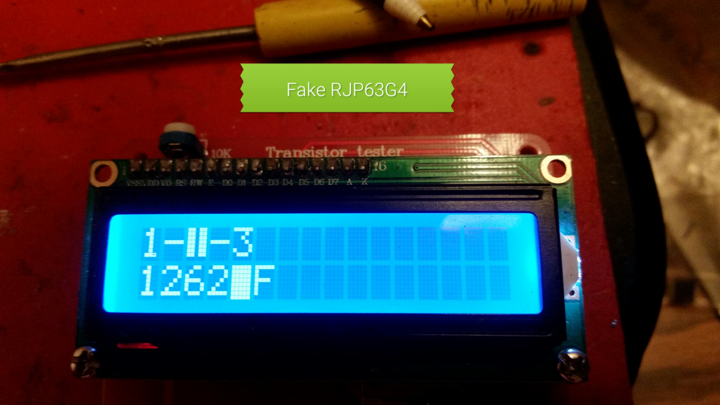

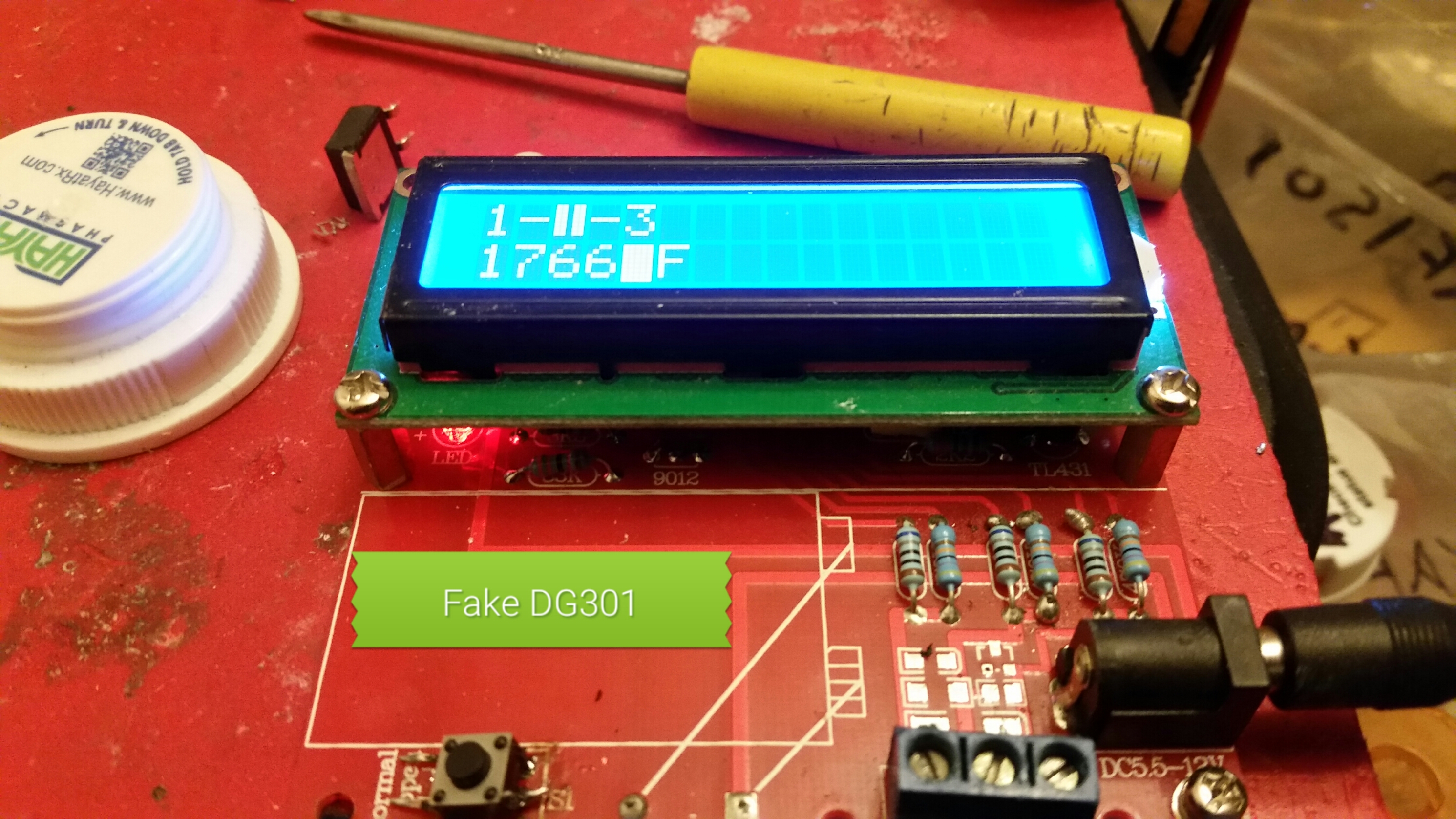

        I have a parts tester that comes in a kit. It is pretty acurate with most parts. When I got a few different orders of IBGT's that I found out were fake, I tested them and they just read as a capacitor.around 1250pf.

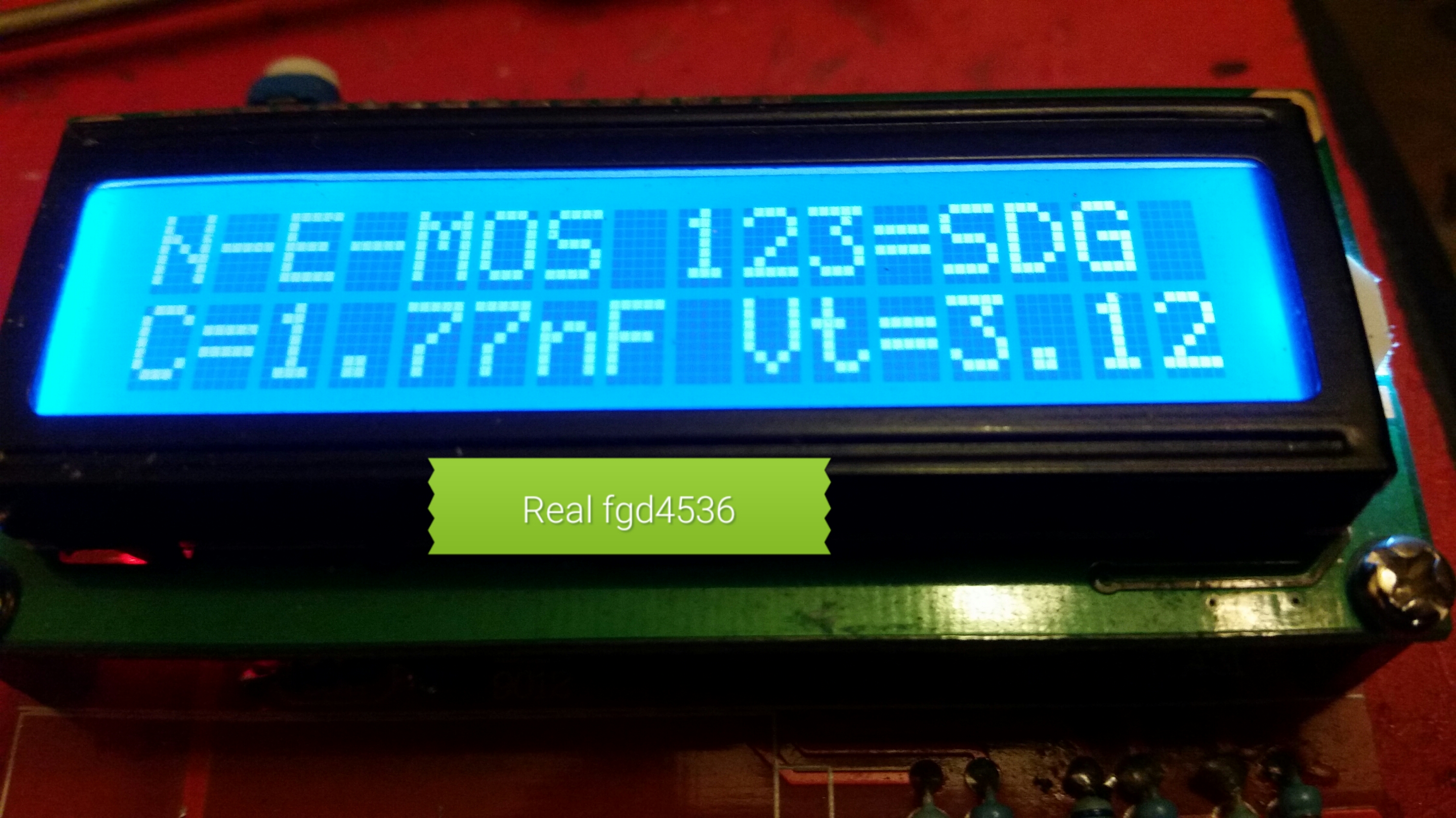

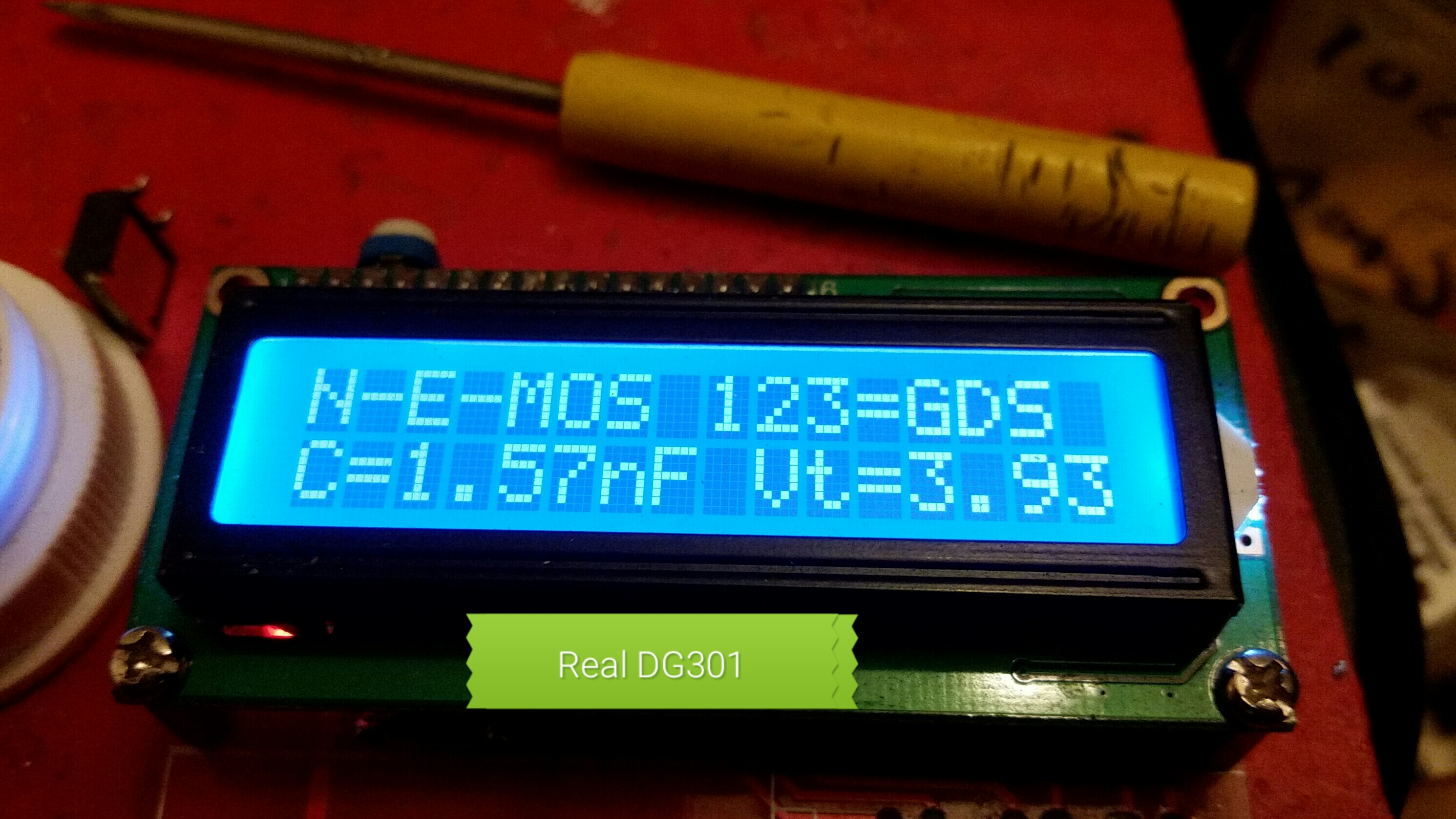

                Re: Chinese supplied IGBTs
                It will read as a capacitor between two of the legs.
                If its good it will say something like n. e. mosfet and give a capatiance and a voltage. I think it is the voltage needed to make it switch. It does NOT come with directions on how to build it, but its not too hard. It looks like they make better ones now.
                        Here are some readings from my cheap ass transistor tester.
                            The tester is thinking it has been presented with a Mosfet not an IGBT this can be seen by the screen showing MOS + G.D.S (gate /drain/ source).being that an IGBT is Mosfet+BJT devise making it a hybrid transistor it is beyond the range of this parts tester.you could build a stand alone IGBT tester, but that again would only test switching (same as using a meter) not under load testing were the fake components let us down.when I have tested any of the fakes they normaly test fine(swithing) as an IGBT should, but will blow under working conditions (load or voltage).
